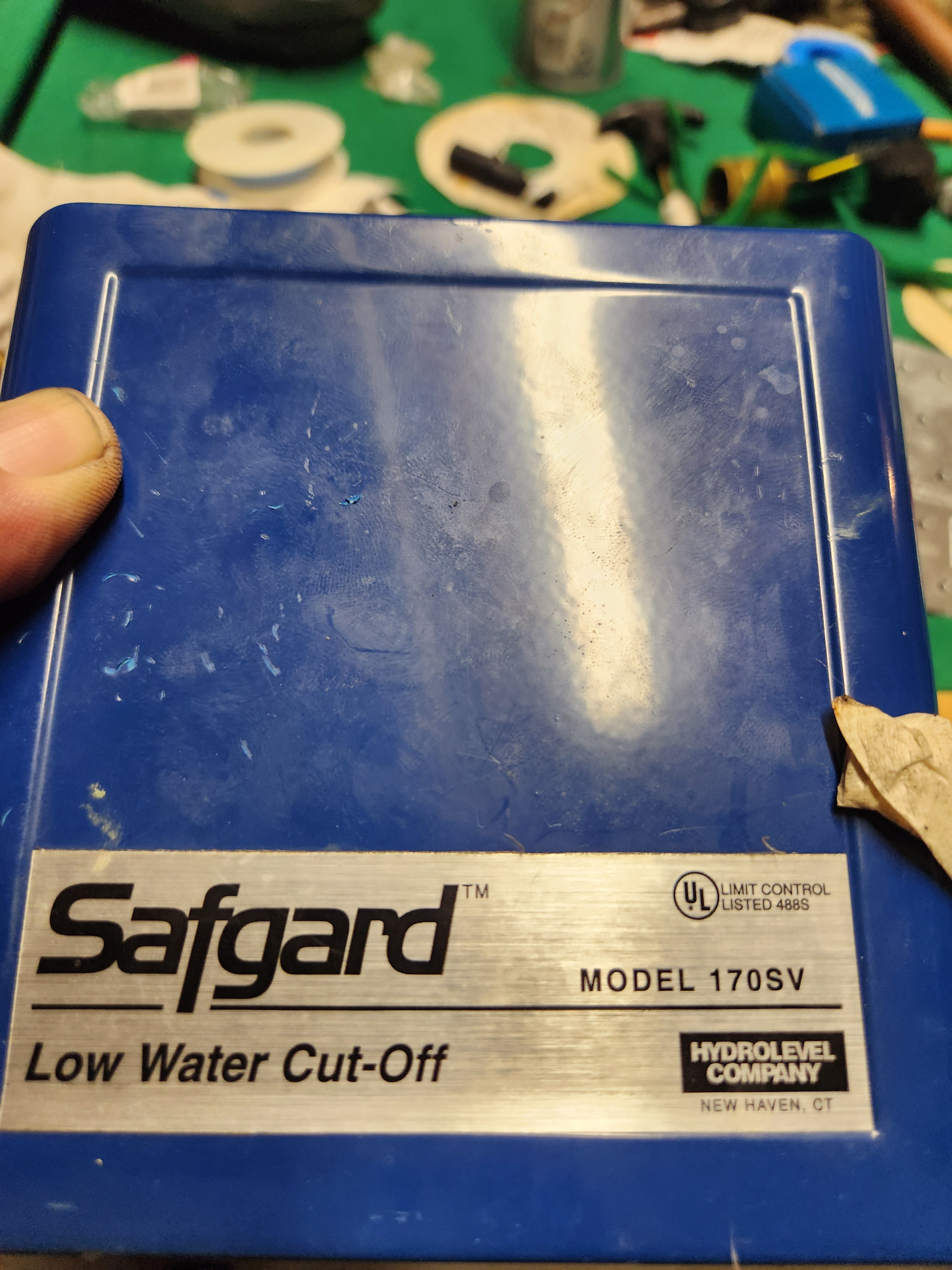

A little more info.. my low water cut off probe slowly drips water onto the bottom of the box. I did some work on it a couple christmases ago and used j.b weld to seal it the best i could to buy me some time. Probably last fall i noticed this repeated / rapid clicking i could here through the floor. It would actually cut the burner off and when it would stop the burner would come back on. I thought it was a loose connection somewhere in the low water cut off box.

It may be the LWCO — it rather sounds as though that needs to either be replaced or completely overhauled. JB Weld is not a suitable repair product or sealant on a low water cutoff.

Forget about sending pictures. I was able to read all the info about your boiler from the previous post from 2024 when we gave you the 3 week crash course on oil burner combustion, hydronics and electrical controls. I think your loosing power at the LWCO. Do you have an electrical meter? Open the LWCO box asd see what terminals you have power to when you touch one of the meter leads to the case (Ground) and the other to each terminal.
Sounds like the power vent is powered but not getting a call since every thing else is dead. I saw you have a meter in one of the photos. Divide and conquer, pick an easy spot like the switch just above the LWCO with the Red cover plate or the LWCO to see where the power stops. Got power go further into the system, no power go towards the power coming into the power vent.
Maybe the corrosion in the LWCO finally had its way with it.

I'm sorry it took me so long to reply. July has been really tough for me and the fam. I really appreciate all the help in here.
So my boiler started working again. I went down and flipped the burner switch on and it worked its way out of it on it's own. I heard a funny little micro sound come from a solenoid or something powering up right before the power vent came on and things started running. Just one look at the LWCO box and you know its gotta be the issue. Crusty!
I just worry. If I dont take care of it now it will come back to haunt me in January.
