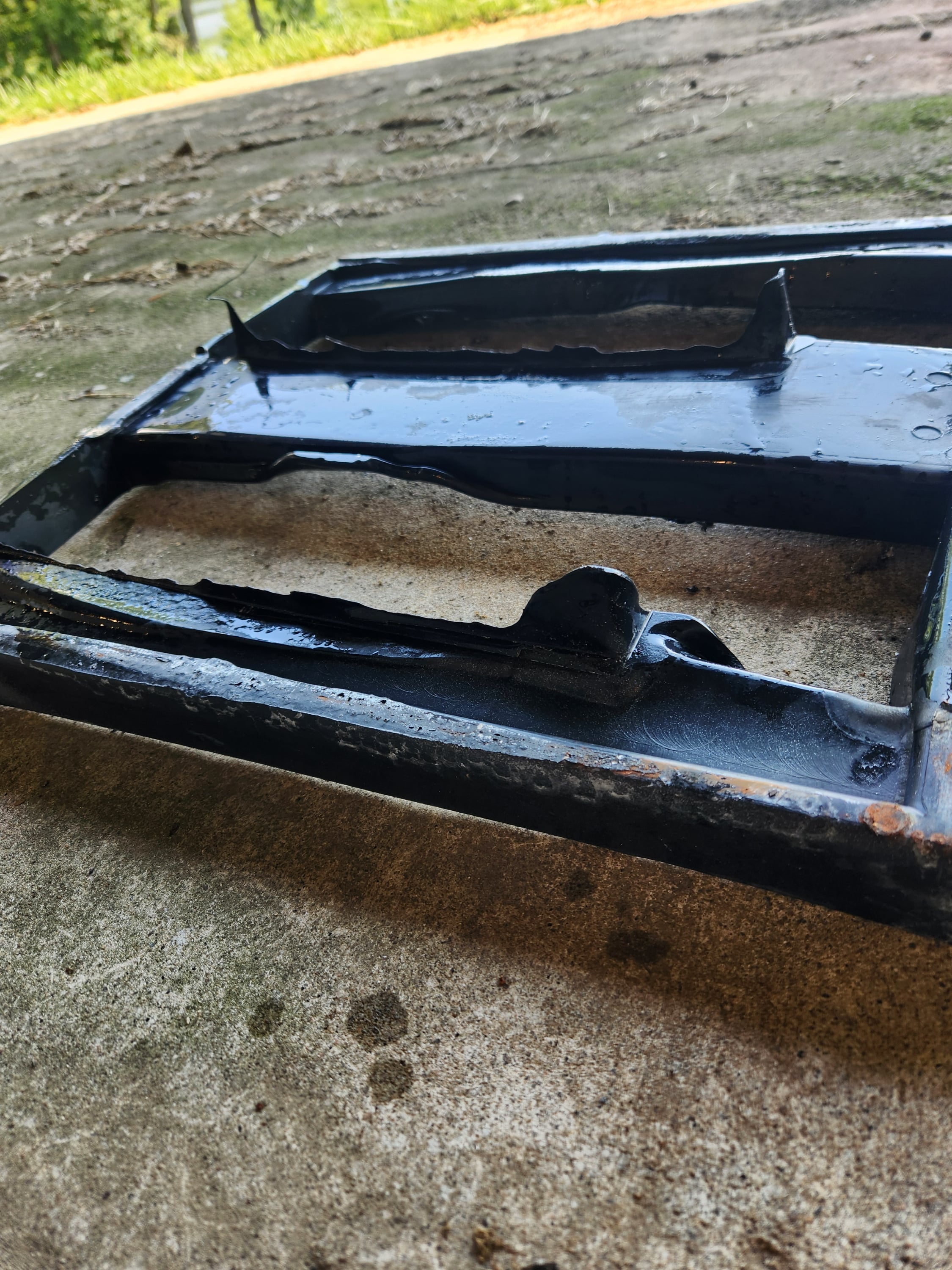

I Went to a "furnace leaking water" call today and it turned out to be a melted condensate drain pan under the coil. First one for me. The new pan won't be here for a week. The person is on oxygen and the sense I get probably end of life scenario. So we couldn't leave it. After getting the drain pan out I patched it up with angled aluminum, flex tape and got drainage to the condensate pump.
The reason I'm actually posting this is because I'm in the "why did this happen" mode and need to get this figured out before winter time rolls around again and the heat comes on. The owner tells me that this happened last summer as well but it wasn't as bad. The rust I see around the base of the Furnace tells me there was a pretty good bit of water around here last year.
I'm thinking there is a control issue where the temperature in the bonnet is being allowed to get too high or was allowed to get too high at some point. This (the high heat) might have possibly even been repaired before we got involved. I serviced this boiler in February and didn't see any issues with it getting too hot (net break temp 410) and had good combustion numbers and nothing to indicate a breach in the heat exchanger.

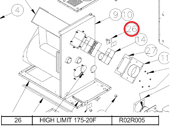

    Restricted air flow (plugged filter or evaporator or other air flow restriction) and an inoperative high limit switch.
    EBEBRATT-Ed Member Posts: 20,507
    Undersized ductwork either supply or return.
    Supply registers closed off.
    Supply or returns blocked by furniture or carpeting

    did you do the basic temp rise? Running wayyy too hot. The monkey will jump on your back if you put in a new pan and it happens again. Gotta get more air or less heat. Is the heat exchanger buggered?
