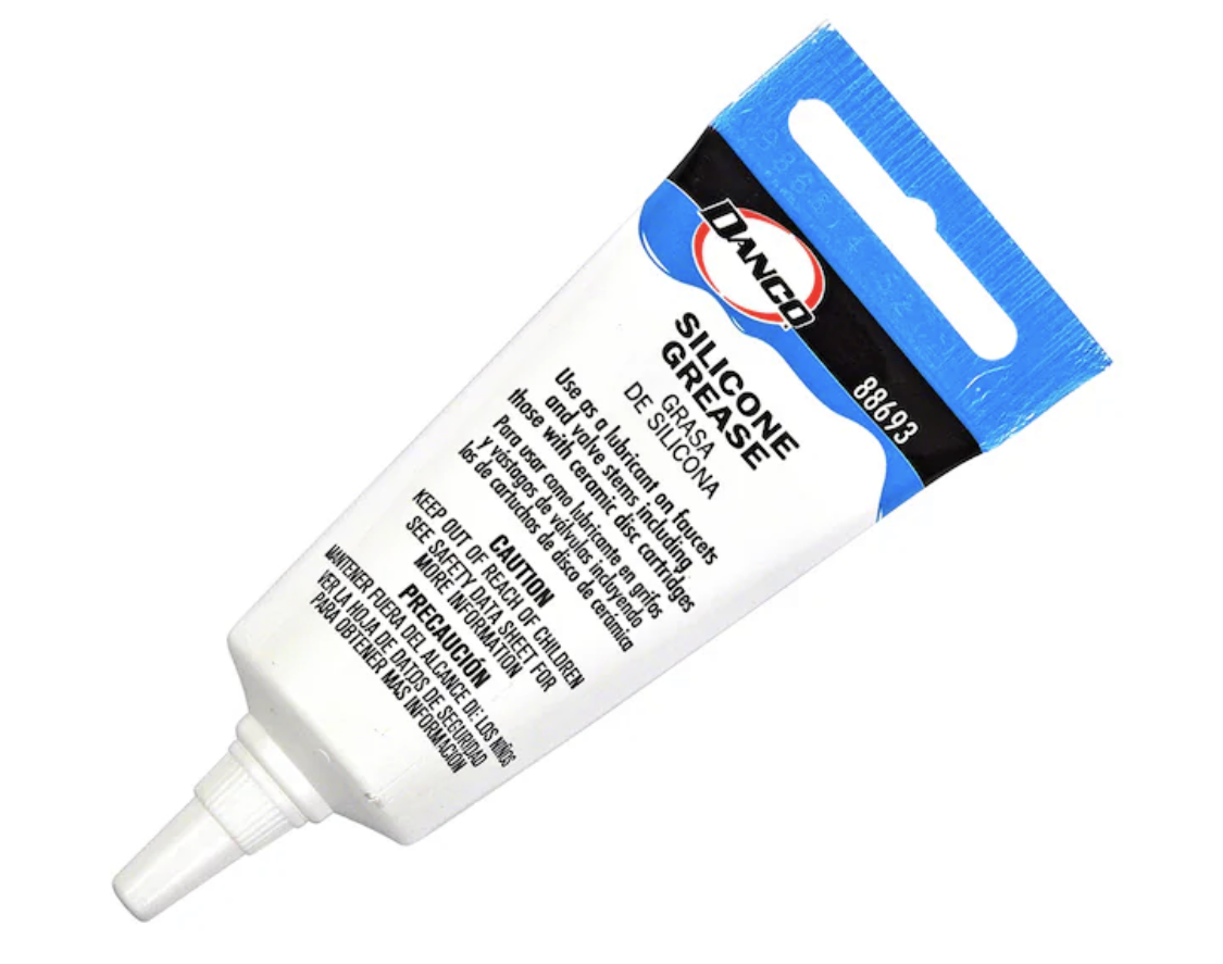

  • jumper
    jumper Member Posts: 2,581
    In XXIst century O rings are often made with flimsy material. I try to grease 'em up with non silicone plumbers' grease. I pray as well.
    PC7060mattmia2
  • kcopp
    kcopp Member Posts: 4,699
    Dont use petroleum based lubes… Vaseline incl. Silicone grease is the best option. The petroleum will degrade the O-ring.
    mattmia2 Member Posts: 17,416
    it isn't flimsy, the compound is just chosen by price instead of chemical resistance. the compound the chose would be fine in some applications.
