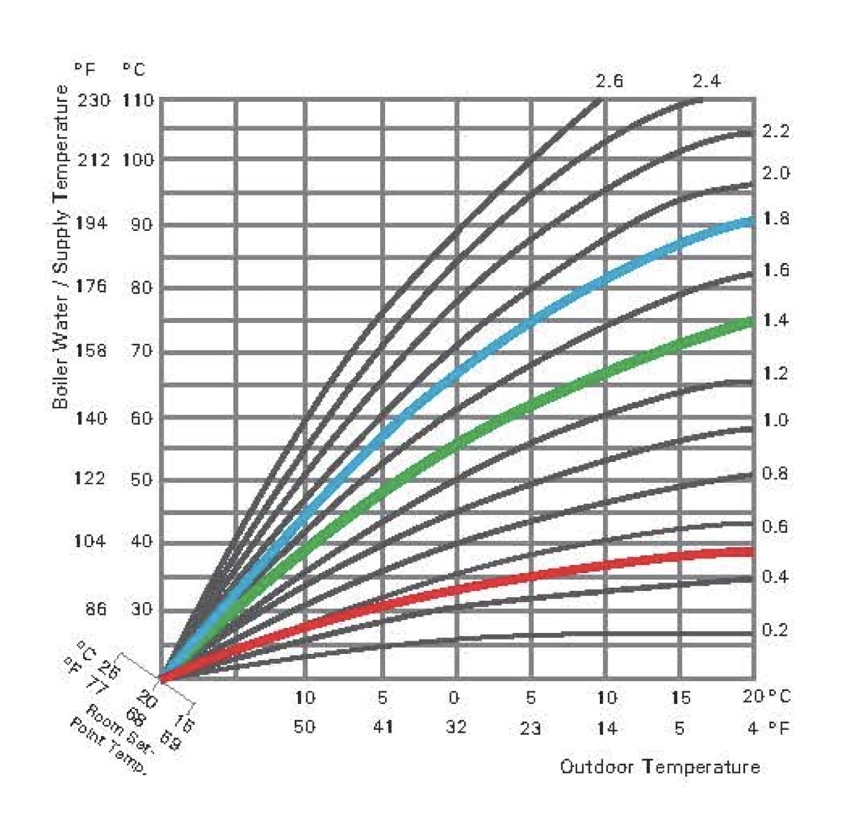

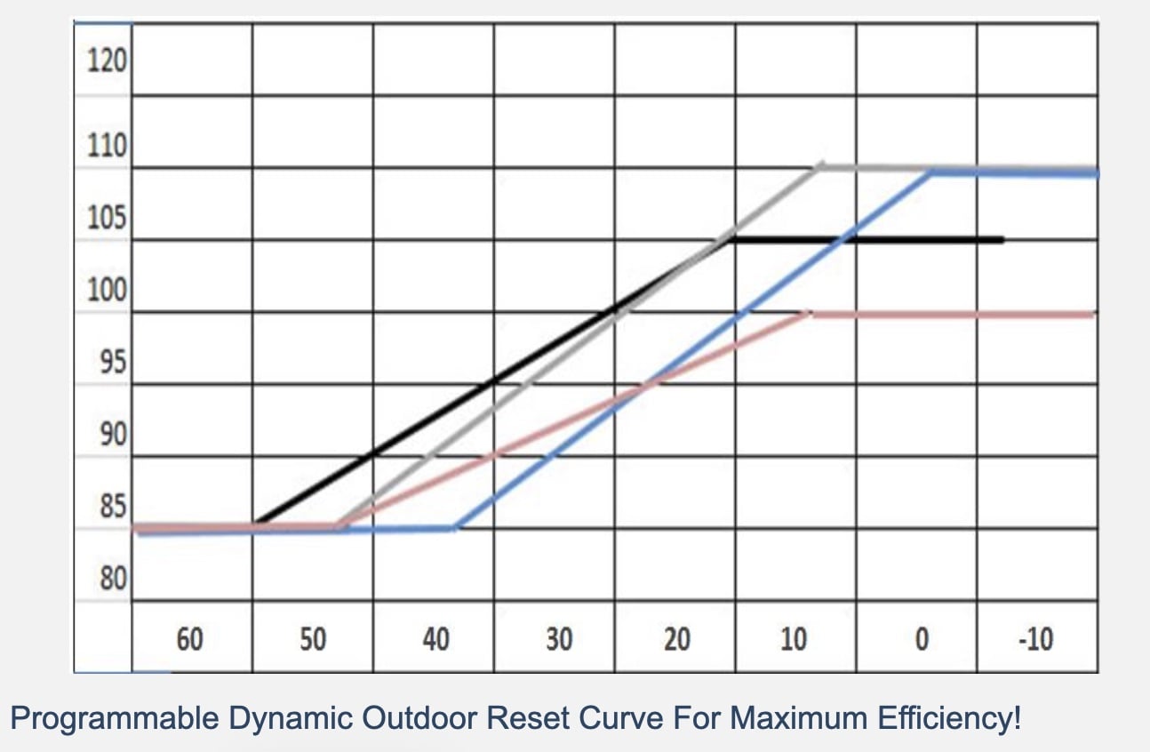

    Nothing new here, but just commenting on HOW LONG it took me to realize that this (from Viessman):
    is just a fancy version of this:

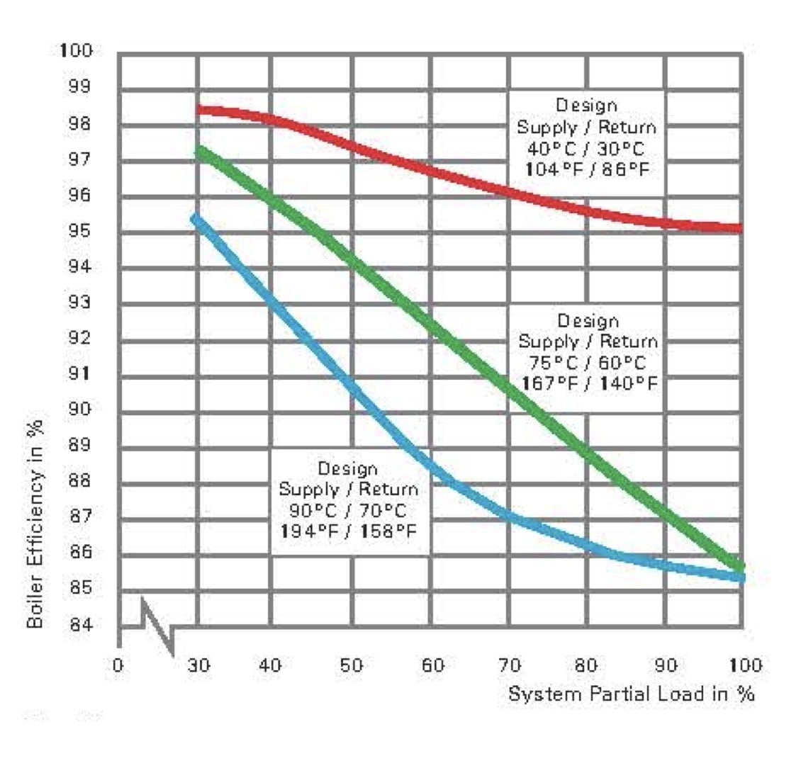

    Because the fancy Wiessman ODR curves are paired with an efficiency curve (below), I thought that that whole family of curves was portraying something intrinsic to the operation of a modcon, instead of a suggested way of doing the ODR. 🤦‍♂️ (Of course, the related message of the efficiency curve shown below is "Design your system so that it is able to run at a low supply temperature for max efficiency." Now I am grateful for oversized emitters in a newly-insulated old building! :) )
