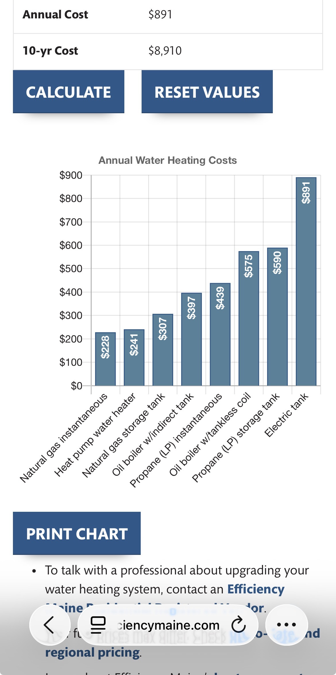

    A tank that age probably has several inches of sediment in the bottom. So efficiency is probably 65% or lower
    There us a place for tankless depending in jow you use hot water. Higher efficiencies, no stored water, endless hot water at the specified gpm flow.
    Efficiency Maine has a calculator

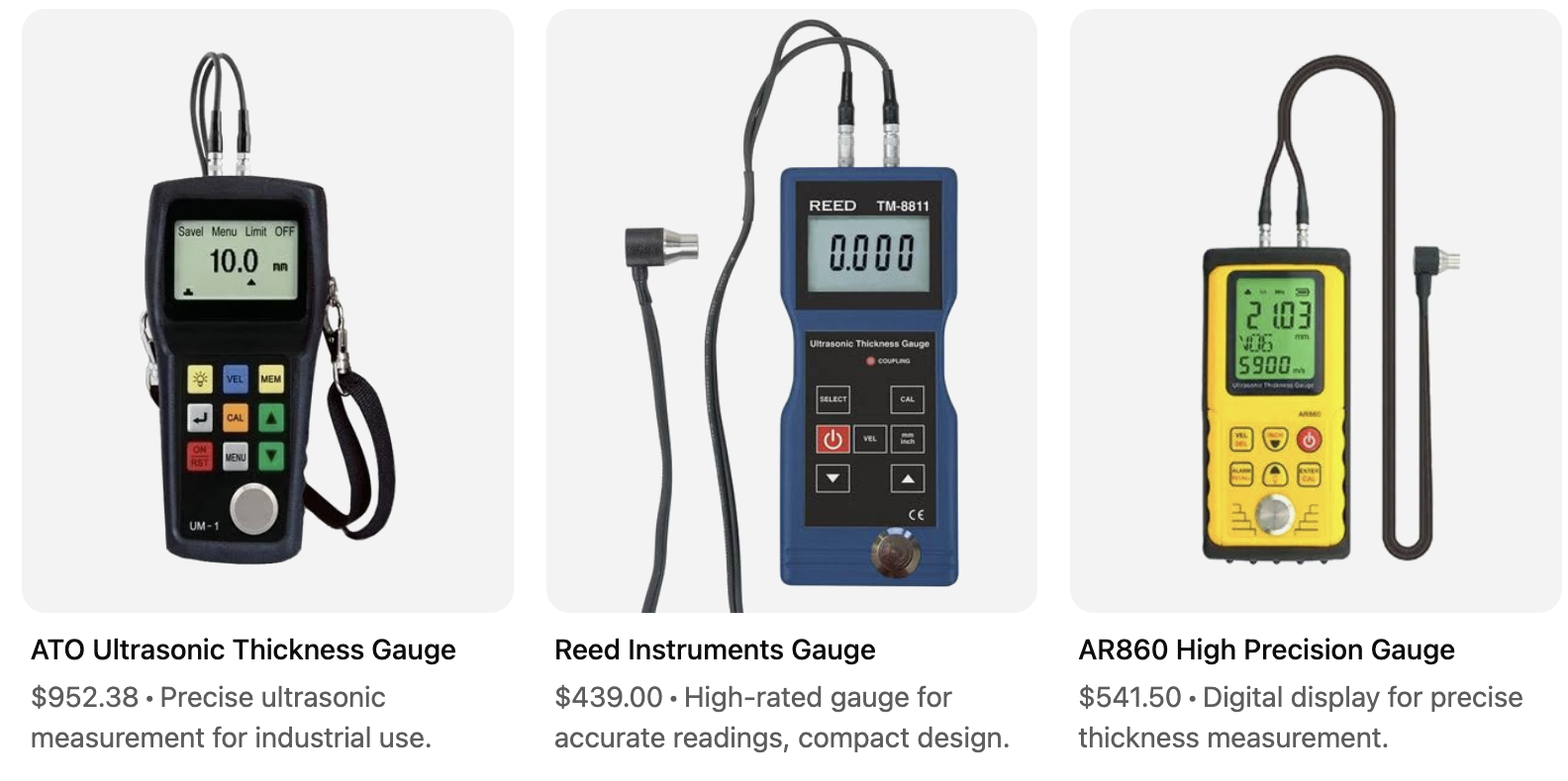

    EdTheHeaterMan Posts: 12,701
    @montek said: I have a great idea- lets make a machine that can diagnose the INSIDE of a water heater like an MRI or XRAY machine of some sort that can tell us what the inside of the unit looks like so we would know if it is going bad…. Not a bad idea Huh??? LOL
    here is your new equipment:
    Now just go out and start measuring old water heaters. LOL.
