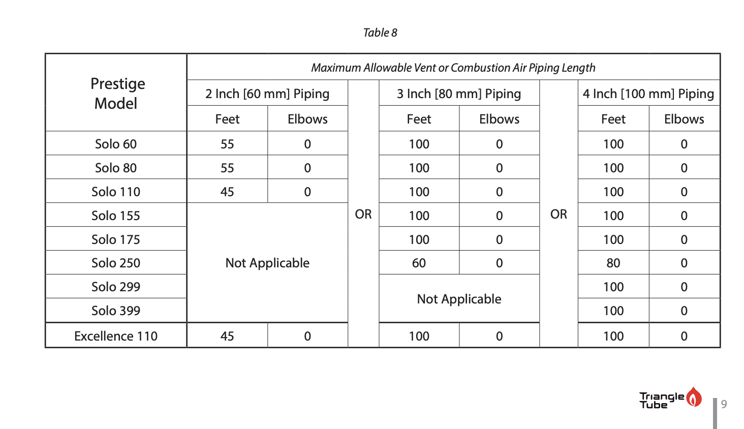

    I'll be returning to the job later this morning to check and replace the burner and venturi as necessary. I will also clock the boiler on high fire and clean the HX. After looking up the installation guidelines for the exhaust/fresh air piping, it's obvious that the actual length exceeds what is permitted for this Solo 250. The combined length is probably 80 feet, not counting any fittings. Three inch pipe.

  • We just finished the service. We clocked the boiler at 250K, so no problem there. The burner and HX were pristine and on first glance, the venturi was in good shape. But then I noticed that the adjustment screw was retracted all the way, so the problem seems that the burner was getting too much gas.
    I could have tried dialing down the venturi, but I had a new one and I didn't want to di*k around with a device that may have something else wrong with it.
    The boiler is working fine now. CO numbers come in at 60-70 ppm on high fire.

    Looks like the installer should have used 4" to start with.
