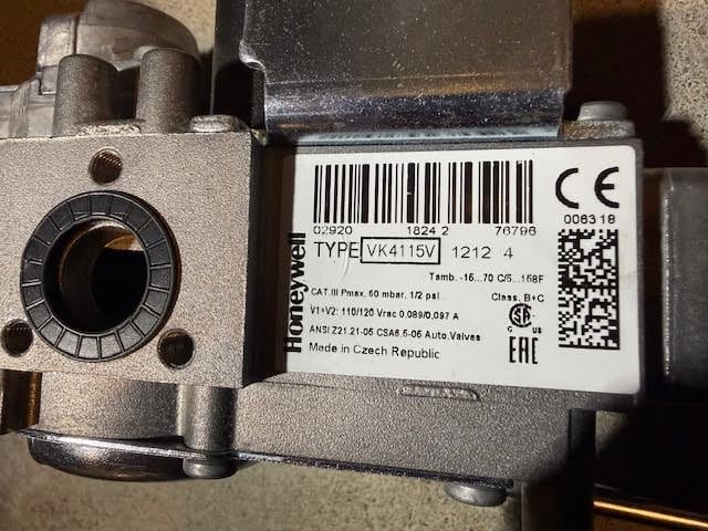

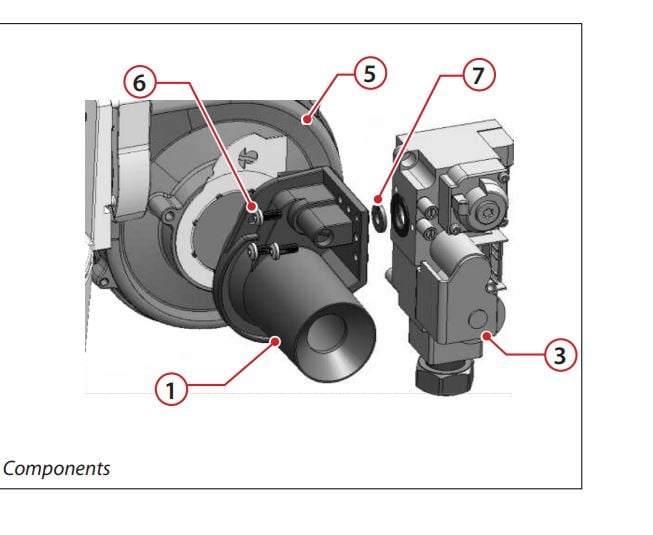

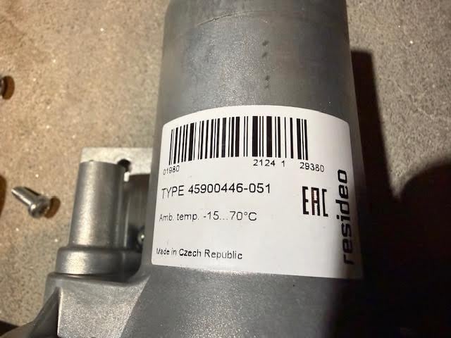

    Gene: Looking at parts diagrams, it was interesting that the same burner and gas valve fit 3 different size boilers. Only the venturi changes.

    That looks like the correct venturi number, 051 at the end
    I think that model added an orifice for propane conversion, I do not think there was one installed for natural gas but i had a lot less hands on time with that exact model
    the propane conversion kit instructions for that one don't mention removing a natural gas orifice, just adding the propane one
  • Thanks, Gene.
    The PA 155, 175 and 250 all use the same burner and gas valve. Just curious, If the wrong venturi was installed on this PA 250 boiler, wouldn't it just fire at a lower rate? It shouldn't have this high CO aberration.

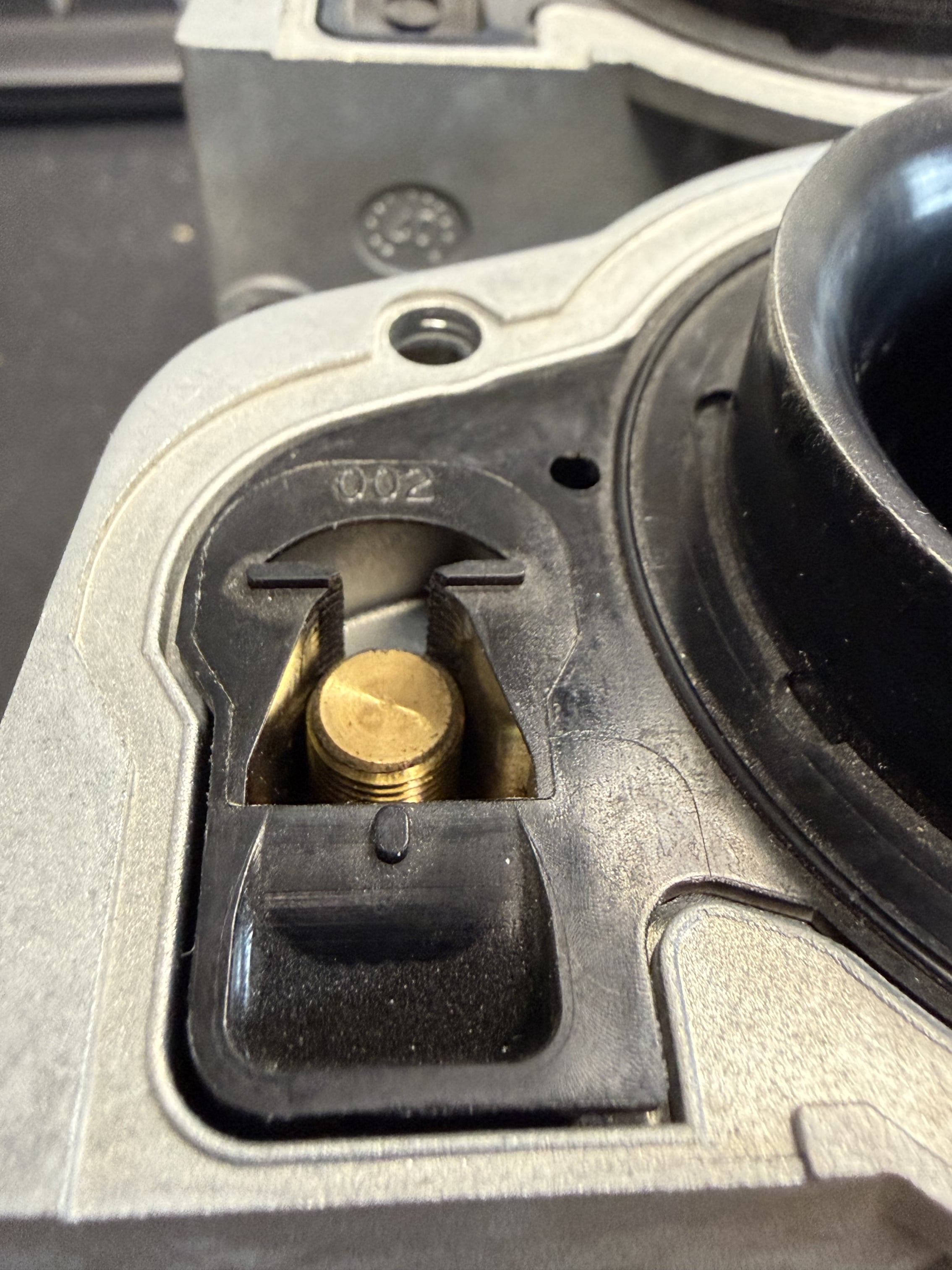

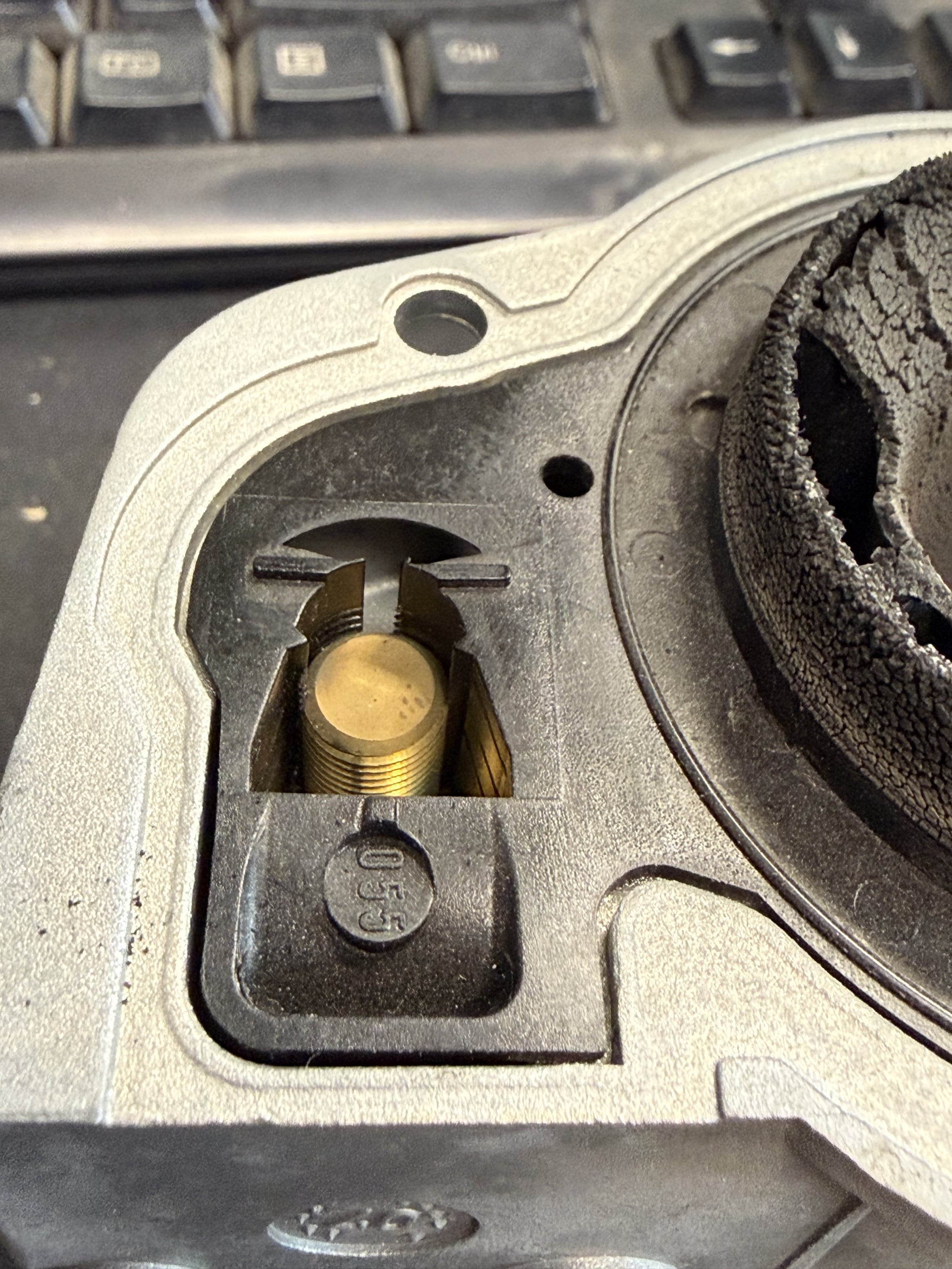

    The little pathway the fuel takes is also different for each model, so in my case I had one that the venturi opening was about 2x what it should be on the air side, and take a look at how much more fuel could probably get through the fuel side (opened these up quite a bit so you can see the opening better) So what I think was happening is that way too much fuel was getting in my burner resulting in very incomplete combustion. Not sure how thats happening with yours though assuming that venturi is correct, and you didn't remove any orifice or orifice gaskets.
    edited March 20
    Yes, I see that the gate is much larger in the first photo. What a difference! I'll check on mine when I go back in April as the owners are away on vacation.
    I see in the second photo that the plastic in the venturi was destroyed.
