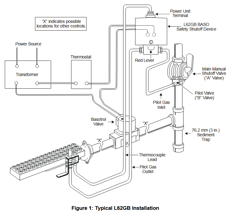

    If the kit has a separate gas valve and ignition control, it isn't all one integrated module and it has a flame rod separate from the high voltage spark output, you could tee both pilots off of the pilot tap on the valve and connect both pilot spark electrodes to the high voltage output, use the flame rod on one pilot for the flame proof on the ignition control and use a thermocouple and this pilot control:
    https://www.supplyhouse.com/Baso-Gas-Products-L61LL-1C-SPDT-Auto-Reset-Pilot-Switch-w-o-100-Shutoff-for-Natural-Gas-Only
    between the ignition control and the main valve terminal of the gas valve to prove the second pilot.
    The only issue here is that it would not shut off the second pilot if it failed to light but it would prevent the main valve from opening unless it proved both pilots.

    look at the instructions for that control, it is an auto resetting baso switch. As soon as the control lights the pilot and the thermocoupel heats the switch closes. gas ranges use parallel spark gaps all the time, most have a couple burners ganged together on one igniter. The thing you have to be careful of is that it doesn't use the spark electrode to prove ignition because if the pilot with the baso swoitch lights and the one with the flame rod does not it coudl still prove.

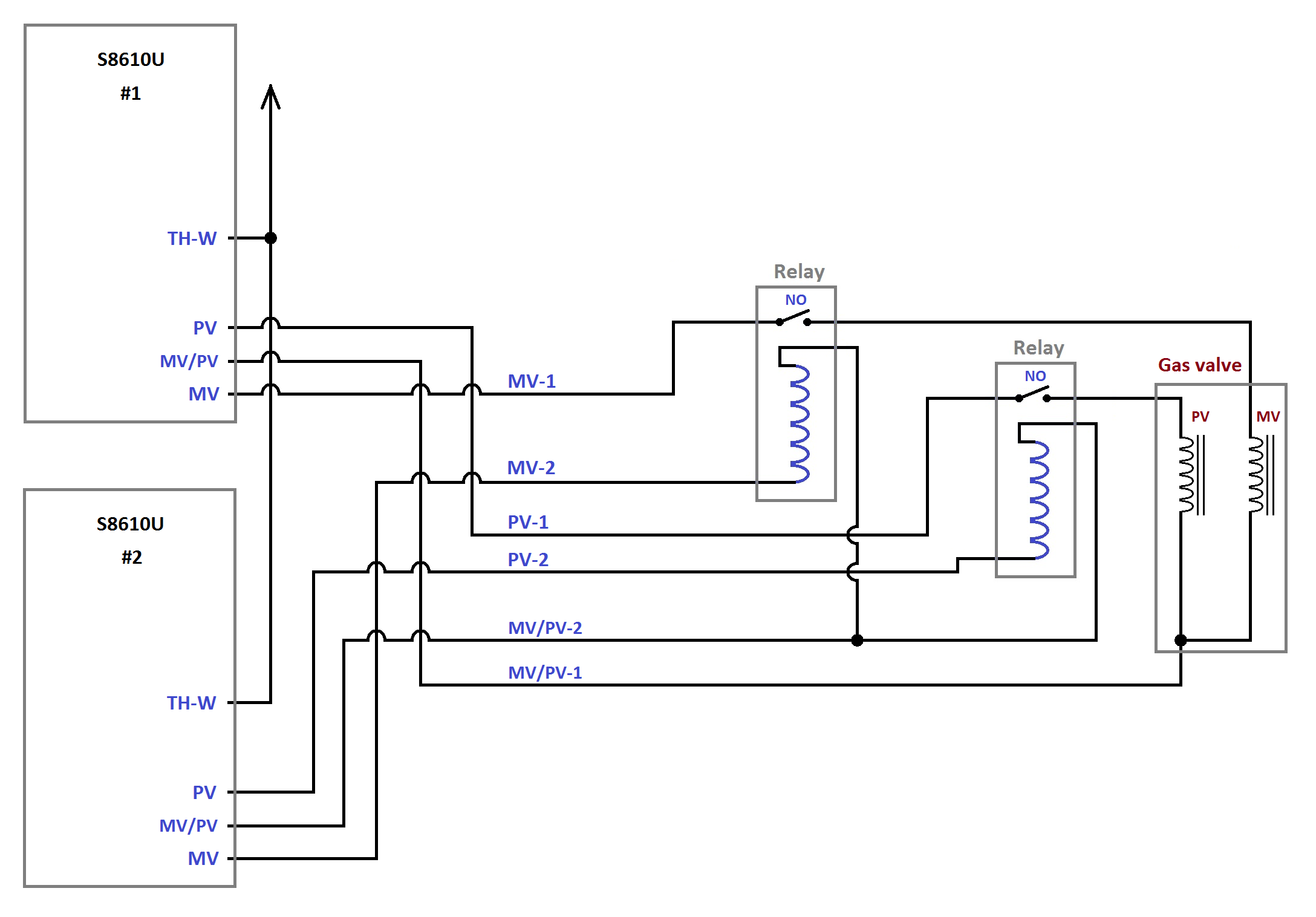

    If I was tasked with building a dual intermittent pilot system, I would do it this way. Since I believe it retains all the functionality of a single Intermittent Pilot Module. Two Intermittent Pilot Modules, both modules 1 & 2 have to be active at the same time for the appropriate gas valve to operate. It requires 2 relays. Module 1 supplies the power for the gas valve. Module 2 powers the relays which have to be active for the gas valve to receive power. The call for heat would be applied to both modules at the same time.
    Again this assumes the gas valve pilot gas circuit can support two pilots from the single gas valve. I would make the tubing to each pilot the same length from the Tee.

    So @triode you did not like the Dual Intermittent Pilot wiring I posted ? No standing pilot. From a wiring point of view it is actually easier than I originally envisioned.
    Seems like it is the second least expensive alternative, just need two relays and a second module of the same model. The least expensive is probably down sizing the boiler. I not sure I'm good with a significant burner reduction.

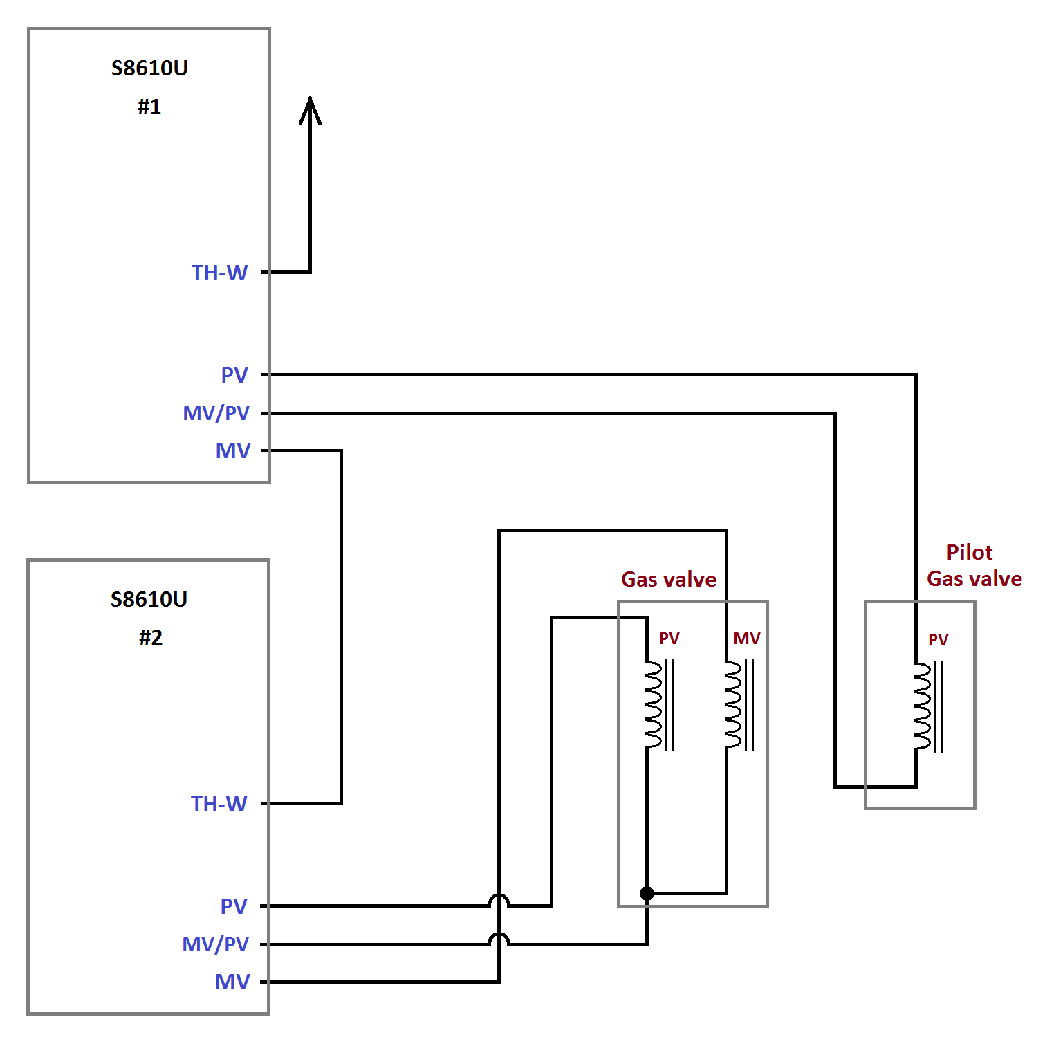

    This is what I'd do, with one change. You would need a solenoid pilot valve for the second pilot such as a Honeywell V8046:
    https://www.supplyhouse.com/Honeywell-V8046C1006-1-8-NPT-Solenoid-Pilot-Gas-Valve-24-VAC-10-psi?utm_source=google_ad&utm_medium=Shopping_Heating&utm_campaign=Shopping_X_Heating_X_SSC_Hybrid&utm_campaignid=22330181706&utm_adgroupid=176927237472&utm_targetid=pla-2435666213279&utm_product_id=V8046C1006&utm_matchtype=&utm_keyword=&utm_adtype=pla&utm_category=Heating&gad_source=1&gad_campaignid=22330181706&gclid=Cj0KCQjwp7jOBhDGARIsABe7C4dH_eIb7FnEIR9U4u68OmtHSNZvHzW2_yIRTzJOCl7d8AVAooTrPPoaAvQdEALw_wcB
    Module 1 would send 24V to the PV terminal on the main gas valve, light the first pilot, prove pilot flame, then send 24V to Module 2 via the MV terminal output on Module 1.
    Module 2 would send 24V to the solenoid pilot gas valve (fed from the pilot tube feeding the first pilot from the main gas valve), light the second pilot, prove pilot flame, then send 24V to the MV terminal on the gas valve. At that point the burner would light.
    This way each pilot would have to prove flame before the main burners were permitted to light, the pilot lines would retain their "redundant closure" status, and failure of either pilot would shut the main burners down as well as the pilot that failed.

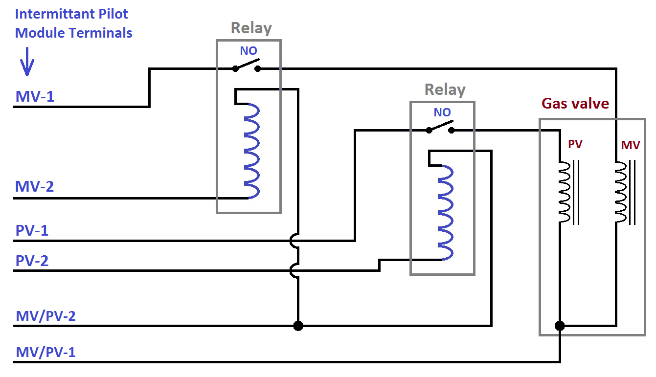

    109A_5 Member Posts: 4,108
    The terminals;
    MV-1, PV-1, MV/PV-1 are MV, PV, MV/PV on Intermittent Pilot Module 1
    MV-1, PV-2, MV/PV-2 are MV, PV, MV/PV on Intermittent Pilot Module 2
    The setup I suggest both modules do the same thing at the same time, basically independently except for the pilot gas source. If either module locks out either can shut the gas valve down.
    With @mattmia2 version (just sequencing), I think sequencing the modules with violate the flame proving logic of the second module. Since a flame will exist before it is expected.
    With @Steamhead 's extra pilot gas valve version I would sequence the modules.
    I just think the relays are less expensive than a pilot gas valve.

    With the relays if either module fails to prove the gas valve is closed. It is a logical AND circuit for both the PV and the MV.
    If the module (say #1) that supplies the gas valve power fails to prove there is simply no power to the gas valve. If module #2 fails to prove neither relay remains energized so the gas valve power is shut off. Which would then fail the proof of Module #1 since the pilot would go out.
    Well I would not use a random relay, that just seems silly. Due diligence could be done and a relay with equal or better specifications to the ones used in the actual module could be chosen.

    Correct, with either method mine with the relays or @Steamhead's with the added pilot gas valve (with or without the relays), I would purchase the exact same Intermittent Pilot module that came with the kit so the timing is the same.
    I believe either method would work. It would satisfy your no standing pilot desire and utilizes both pilot locations.
    So far I have not found a Intermittent Pilot module that has two of everything.
    edited April 3
    A bigger picture showing the connections to the two Intermittent Pilot modules. The relays provide a logical AND circuit for both the PV and the MV. If either module does not prove the pilot it will cause the the gas valve to close PV & MV.
    As @Steamhead suggested you could add a second Pilot only Gas Valve wired in parallel with the PV valve shown. Creating an independent gas path for the other pilot. Or see the configuration below for sequential module / pilot operation.
    edited April 3
    Using the pilot gas valve that @Steamhead suggested may be an easier method to implement (less wiring). The module Grounds, 24 VAC Common, etc. are not shown to keep the diagram simple.
    A call for heat energizes TH-W of module #1 when its pilot proves it energizes its MV which energizes TH-W of module #2. When the pilot of module #2 proves the MV energizes the main gas valve supplying gas to the burner.
