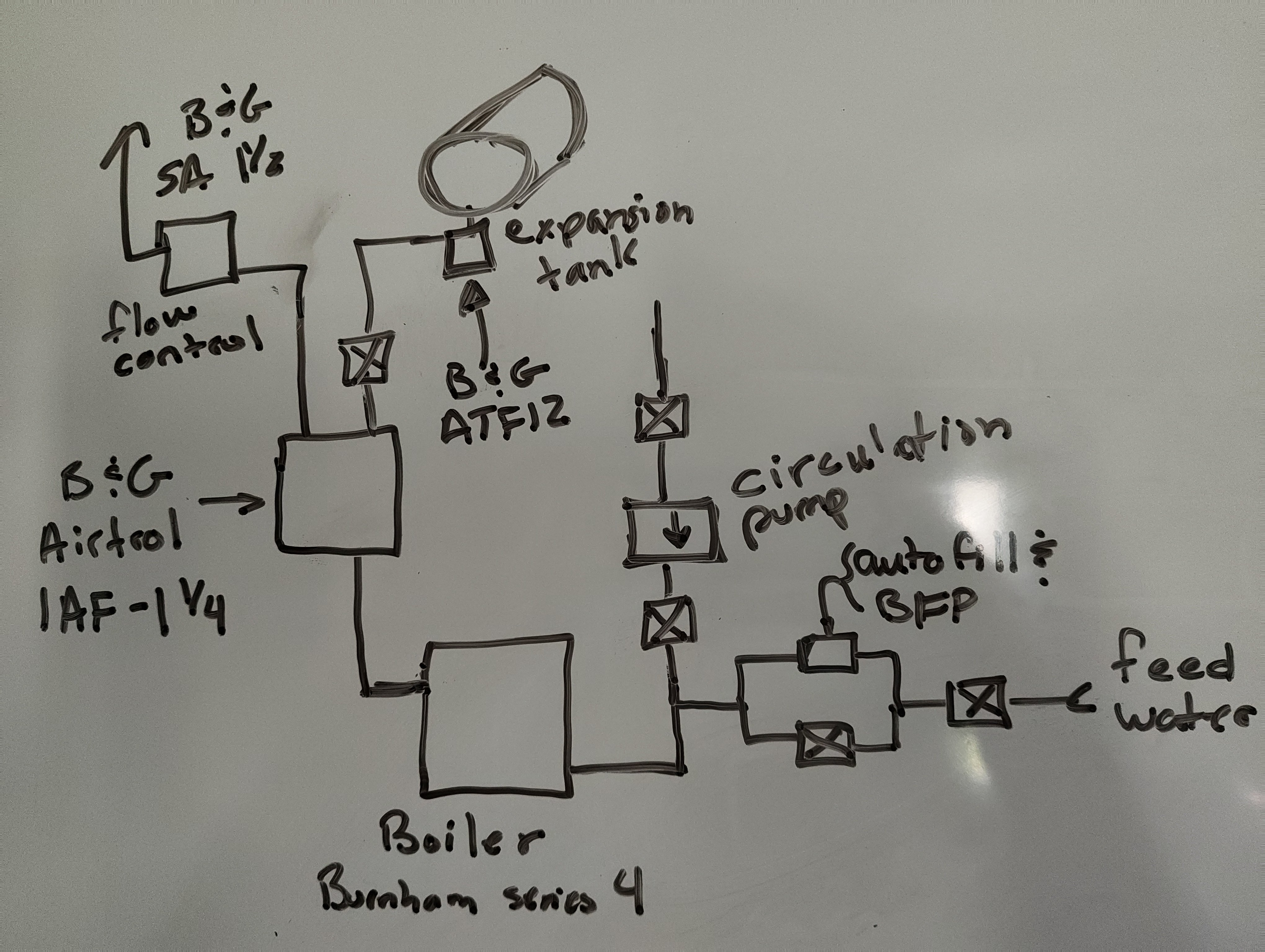

I am attaching a drawing of what I think is the current setup. I am not sure if I would need to change the B&G components: SA 1&1/2, 1AF-1&1/4, ATF12, but I have no idea how to test them. The system was "working" before the valve failure, in that it heated the home nicely, but not sure if it was "correct".
Again, do I spent $1,000, change the valves, auto fill, BFP and gas valve and fill it (would have to read about filling it) and hope for the best, or just call someone and say "take all of my money and then some" and have it replaced?

    PS: free hint: your expansion tank in your drawing looks like the old kind that they strapped up to the floor joists that is just a tank with no bladder. Which is fine, but it's probably flooded so drain it. You can't tell by tapping if it's full of water.

    Yes, the expansion tank is strapped up to the floor joists. It has 18 Gallons, 75lbs working pressure and D-1/86 written on it. I am guessing the drain on it is locked up. It is always amazing to me that most people never exercise a water valve and expect it to work years later. I am still confused about how this tank with no bladder operates (e.g. how does it not fill when you fill the boiler? You must have to shut it off somehow during the fill cycle, or is that what the B&G ATF12 does? It must be, right, otherwise the autofill valve would fill it, or are we just relying on compressed air in the tank for this?)

    I will note that my feed line is after the circulation pump though, just like I drew it.

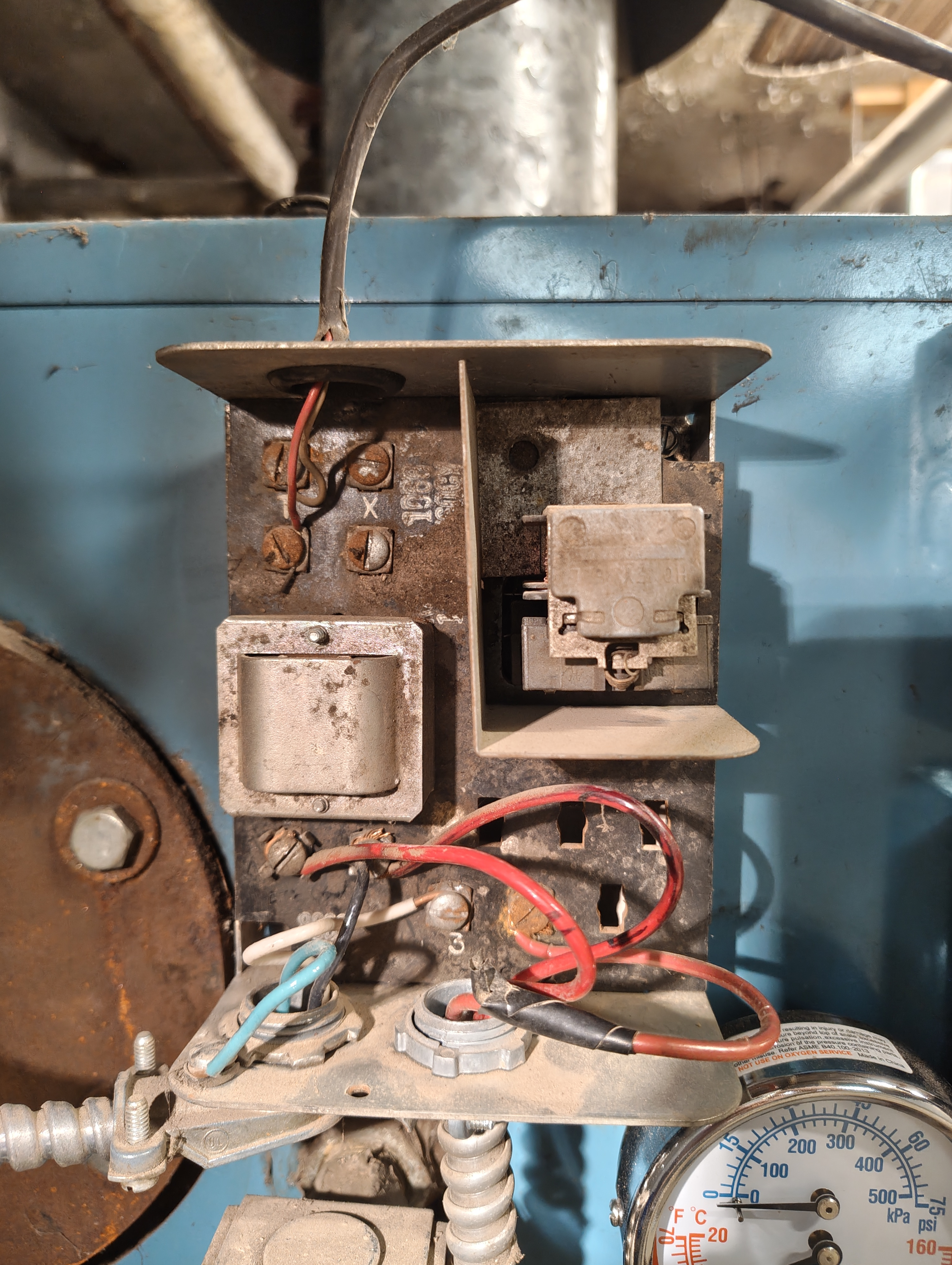

    Some pictures of the burnham.
    And the boiler inside.
  • triode
    triode Posts: 30
    And the tag, and blower setup:
    And two of the radiators downstairs:
    it was a vapor system that was converted to hot water. that radiator valve is a vapor valve, i recognize the specific brand but don't remember what it is, others will know exactly what it is. Syphon I think.
    that boiler has been neglected. it will still clean up and run but it is in rough shape. I think both of those pilots should be connected and should have a dual pilot safety, that is probably what a lot of the rollout is from, from the delayed ignition of the right half of the burner.
    that 100 series b&g could have been replaced with a wet rotor circulator for a lot less.

    The controls look rough, but the cast looks good. I would check with the municipality to make sure the tjernlund is venting in an acceptable location out the window. When replacing the gas valve, @mattmia2 is right, the second pilot should be connected. The tridicator looks like its in an awful location and the wrong angle, and the relay looks like its not long for this world. You can do this though. Straighten out the wiring mess, im sure @EdTheHeaterMan can draw you a diagram.
    edited March 26
    the relay looks like it was in a structure fire…

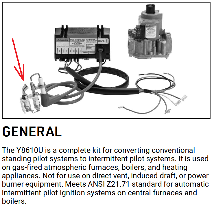

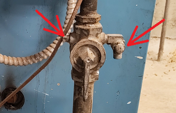

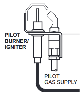

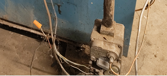

    at least they left both pilots so you know how they screwed it up. i think baso makes ]a device to connect 2 thermocouples to the pilot safety on the gas valve i know they make a standalone safety valve that can take 2 thermocouples.
    you could put a standalone safety valve with a pilot tap before the combination valve. in that case you'd light the pilot on the standalone safety, that would provide gas to the combination valve, then you'd light the pilot on the combination valve.
    one of the pilots was connected here:
    although i'm not 100% sure how, if there was a safety with a switch or what since it would need to interlock the burner and turn off the pilot gas if the pilot went out.
    there may be a schematic inside the front cover that shows what was there.

    I have a strong feeling that you have a Burnham Series 4 boiler
    It was available in both hot water trim and steam trim from the factory. It appears the a Steam trim boiler was purchased and field converted to hot water (badly) The 408 seems to have the correct ratings for that boiler rating plate. With that information in mind you should look for a round plate with a 3/4" pipe thread tapping in the center of it to accompdate a new Aquastat. I would select a HydroStat combination aquastat, relay, LWCO control and mount is there, where the manufacturer designed it to be. It appears the the Tridacator (Boiler presure temperature gauge) was supposed to be mounted where the current Aquastat is located. I might make two change to the circulator location and the water feed location while the boiler has no water in it. as shown here:
    This will make the circulator location pump away from tne expansion tank and place the auto feed valve at the point of no pressure change as described in the book https://www.heatinghelp.com/store/detail/pumping-away-and-other-really-cool-piping-options-for-hydronic-systems/

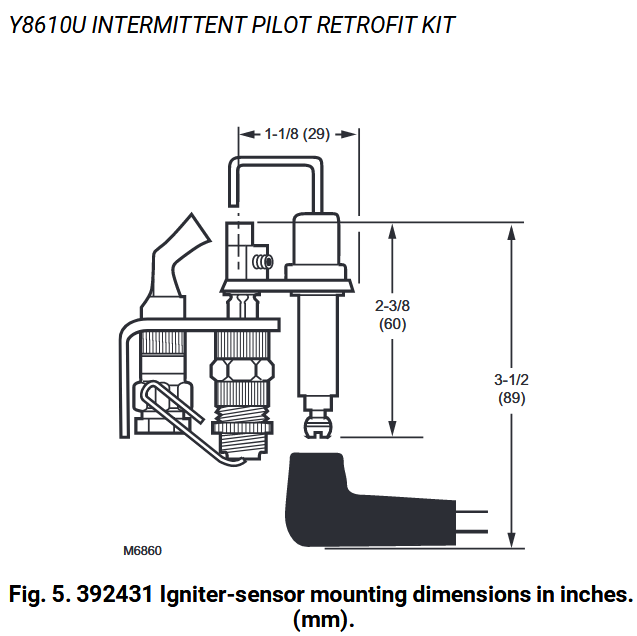

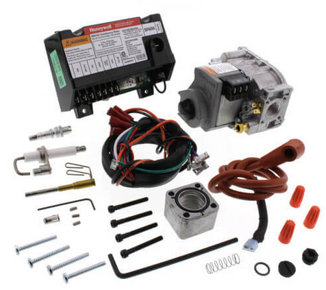

    I am replacing the ancient manual gas shutoff that had the pilot connection with a modern gas shutoff.
    A few boiler techs noted that they moved from 2 pilots to 1, but never noted anything more. I was going to use 1 unless it is a real problem. I was also going to a non-standing pilot (I think it is called pilot ignition) system with the honeywell universal unit.
    @EdTheHeaterMan noted to move the water intake but I would also have to reverse the pump, as right now it is pumping into the bottom pipe in the burnham, meaning (unless I am mistaken) it is pumping into the boiler which is "pumping into the expansion tank" not away from it. Am I wrong? (see my whiteboard for the pump direction).

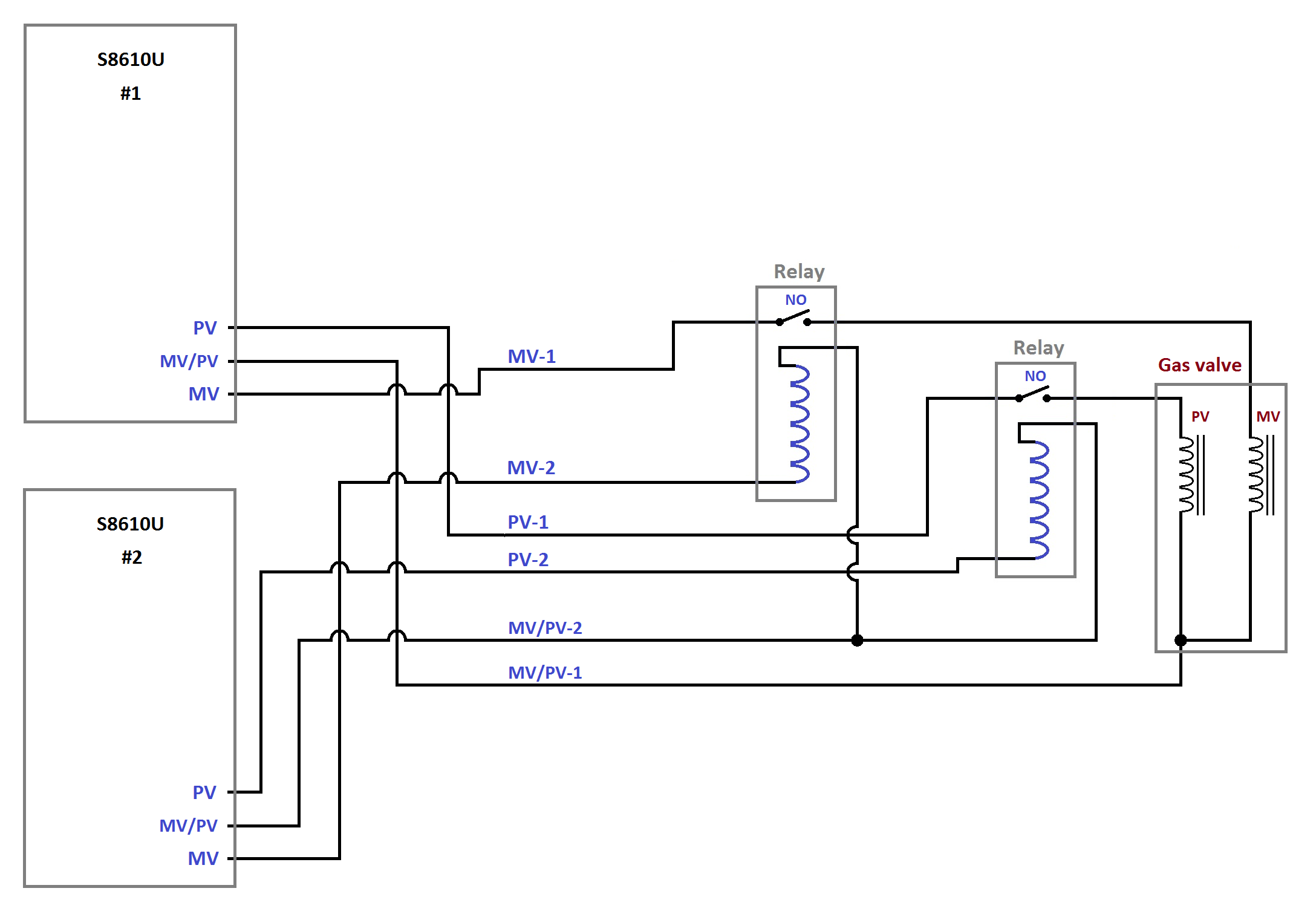

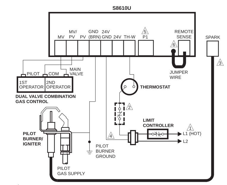

    that gas valve is probably the same age as the boiler. you should replace it with another one with the pilot tap and pressure tap. the 2 pilots are to allow the burners to light smoothly and at the same time. it would be difficult to convert it to intermittent pilot with the needed 2 pilots.
    you need 2 pilots. the way it is now it almost certainly lights with a bang and a puff out the front as the gas builds up enough on the right side to get to the burners that lit off the pilot on the left side. the technical term for that is delayed ignition but it is actually a small explosion. i suspect that is why there is scorching all over the front of it.
    I think the way it was installed originally was with this pilot safety controlling one pilot off the pilot tap on the manual gas valve:
    https://www.supplyhouse.com/Baso-Gas-Products-L62GB-1-Safety-Shutoff-Device-100-Lockout
    and the electrical connection in series with the safety chain to keep the combination valve from turning on if this pilot went out and the other pilot was controlled off of the combination valve.
    this would let you light each pilot independently but it would only fire the main burner if both pilots were lit
  • 4GenPlumber
    4GenPlumber Posts: 176

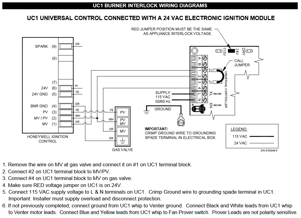

    Dont forget he has an induced fan on this. It probably does everything @mattmia2 said, except actually rolling out. More likely you are just blowing raw fuel out the side of your house without the proper pilot assemblies.
    EdTheHeaterMan Posts: 12,940
    I'm looking at the Y8610 Kit. This has a single stage gas valve but has all the necessary parts to convert the existing boiler's standing pilot design, to the electronic ignition design. This is a good idea but, if you want to try the two stage idea to get the lower firing rate, then you may want to purchase all the components separately in order to get the low fire from the gas valve VR8345Q4563 2 stage valve. then you can purchase all the other parts in the kit separately.
    If you want the manufacturer's wiring harness and other hardware that comes in the Y8610U kit then you will need to purchase that kit and end up with 2 gas valves, a single stage that you can leave in the box and sell on eBay, and the two stage valve that you want.

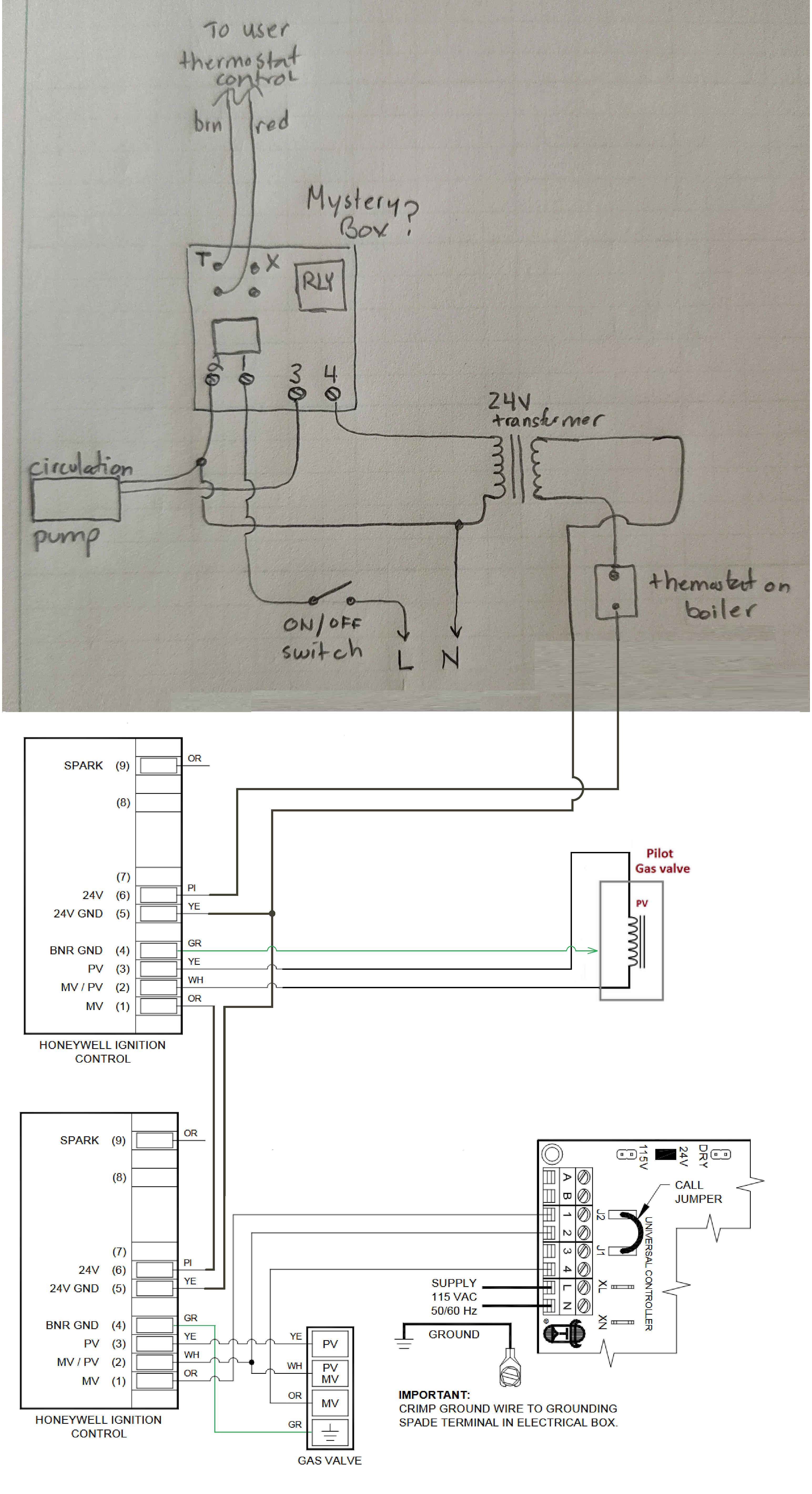

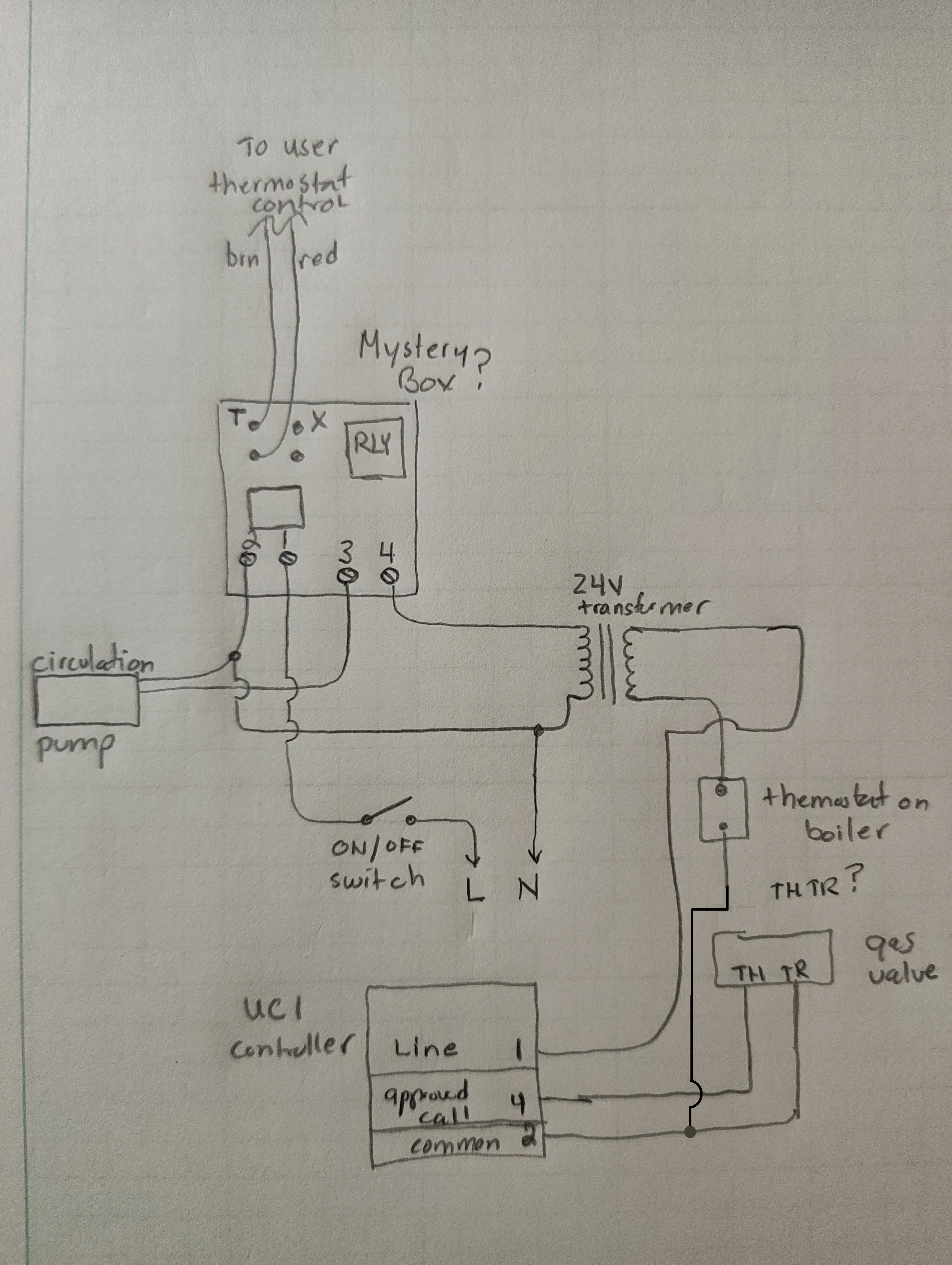

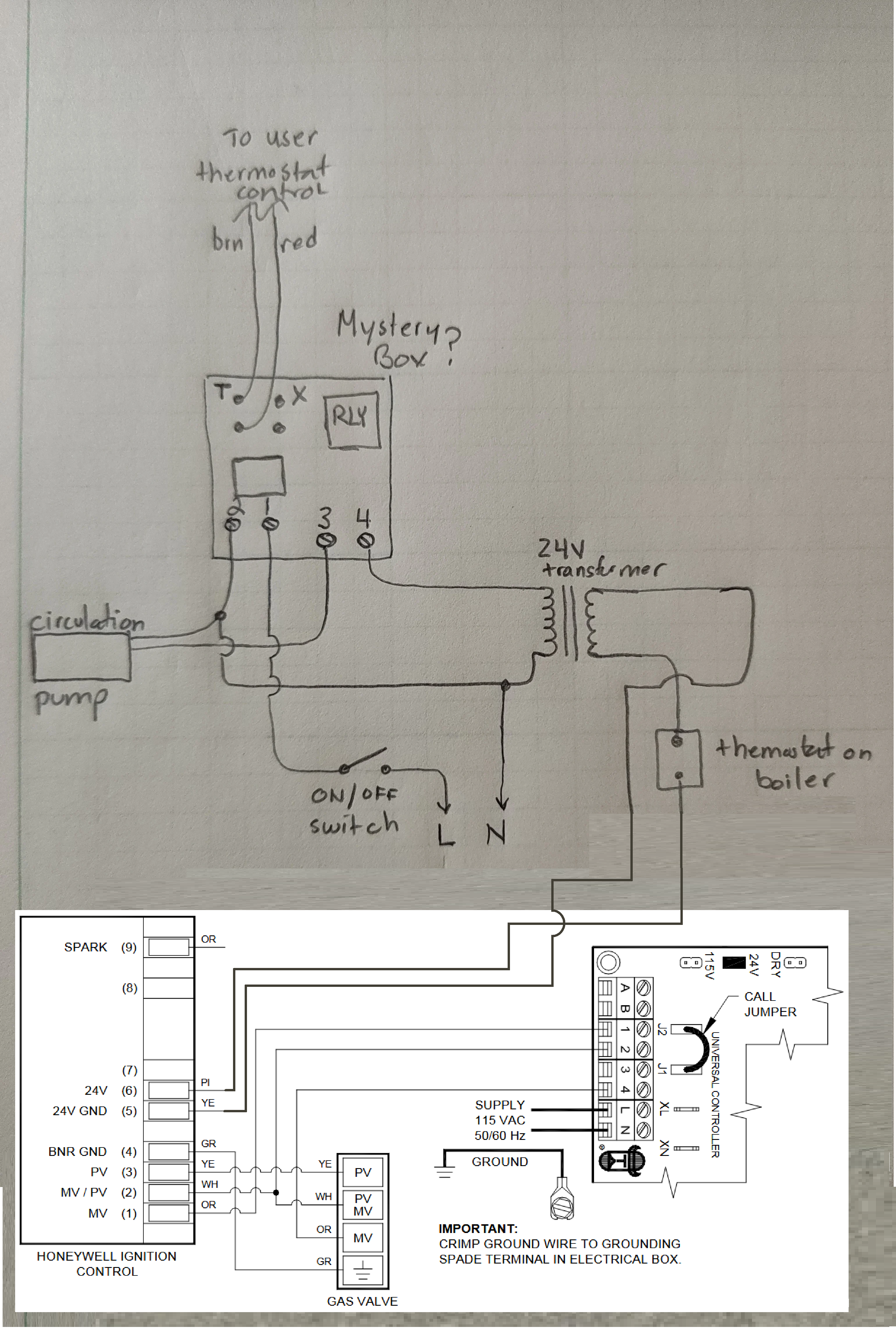

    Small updates:
    Filling out Form-1504WH, I get 134,681BTU, this is with "Loose construction and air leaks" as the infiltration factor, given the bad siding and large gaps in windows that are present. If I use the "Older house good construction" infiltration number, I get 118,236, just doing that for a long term target if I fix the windows and such (that would be a long time in the future).
    As for the delayed two pilot scenario, I was in the basement (for days) working on things when it was turning on and off. I never heard it bang or poof coming on. Quite a few times when I had techs come over to talk about replacement they would open it up and we would call for heat and it seemed to fire up fine. I hear what people are saying, but then they mention there is no way to go to two pilots and have a electronic pilot ignition. I really do not want a standing pilot in the basement, the venting is active, so when the burner is off, all of the pilot burnt fuel goes into the basement and then the house.

    You will need to consider if you plan on using the existing B&G 100 circulator as your system circulator to save on costs. I always include a new thermostat with the job. You can use the existing thermostat and save.
    You need to account some $$$ for venting the system. That will include PVC pipe and fittings. Some Electrical parts like a new switch, and some wire and wire connectors. All this adds up a little at a time.
    PC7060
    109A_5 Posts: 4,759
    The two pilot arrangement may be possible with intermittent pilot operation. I'll have to look at some larger commercial boiler manuals to see how they do it.
    With your claimed loose building construction I would not worry about a standing pilot. Also there may some draft through the active venting even when it is not active.
    I would not use "lots of custom duct tape and bailing wire" to get it running, do a nice job if that is the route you choose.
  • triode
    triode Posts: 30
    edited March 27
    @109A_5 , that would be interesting to have an intermittent pilot on two pilots.
