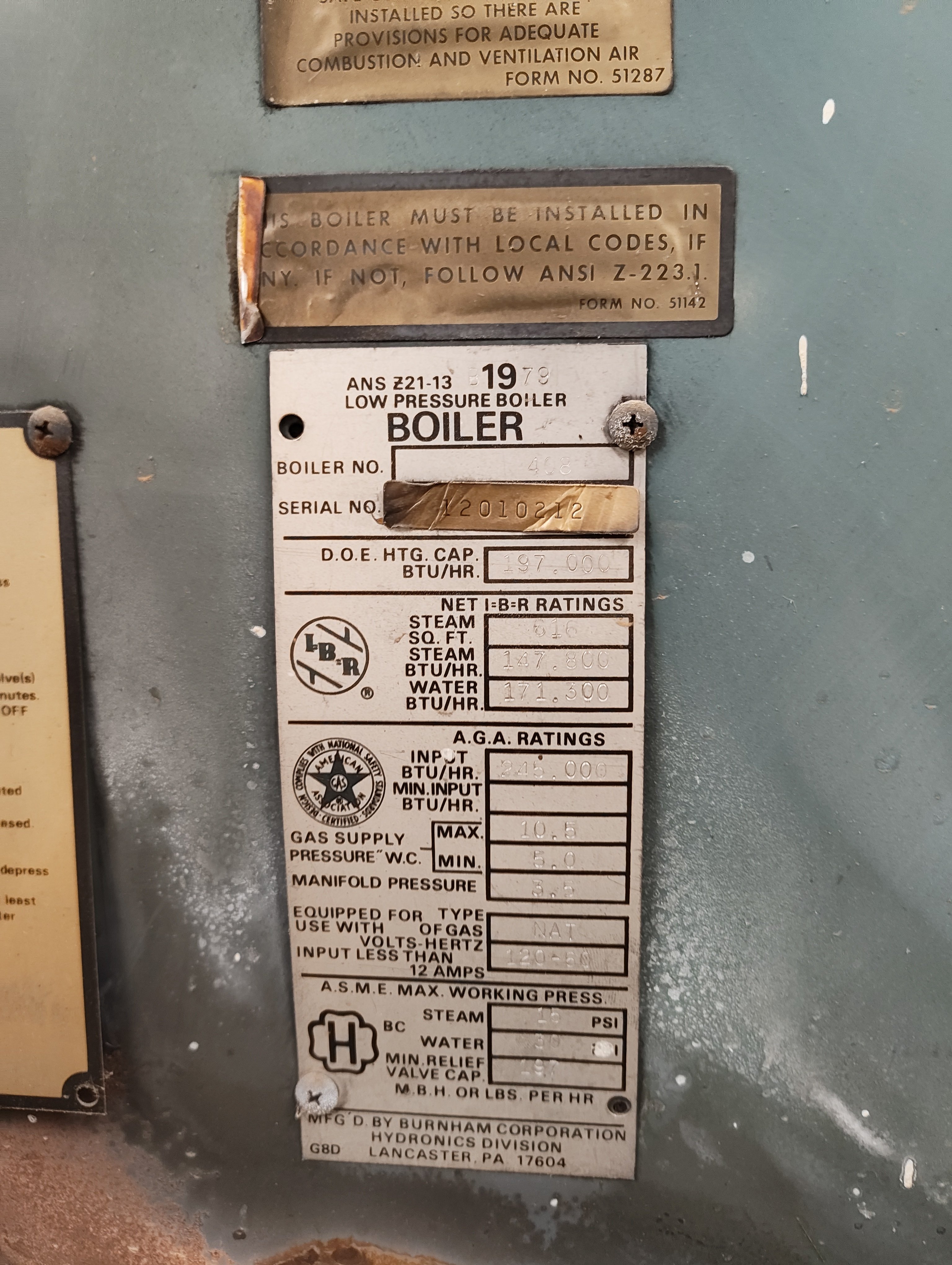

Recently purchased a home (have not yet moved in). It has a 47 (not 52) year old Burnham Series 4 (408), 200,000 BTU boiler. It was steam, and someone (long ago) converted it to water. It was working when we purchased the house, but inspector said "its old, replace it". I called a few people who really wanted to push me to replace it outright, but were quoting me crazy money quotes to replace it.

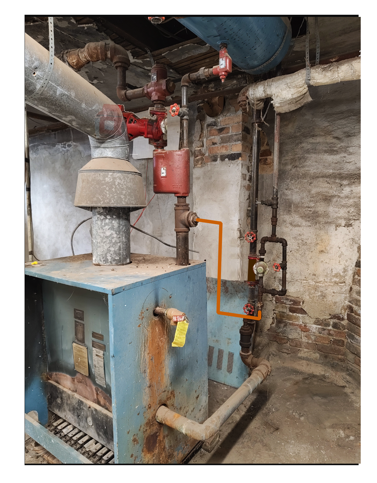

I am attaching a drawing of what I think is the current setup. I am not sure if I would need to change the B&G components: SA 1&1/2, 1AF-1&1/4, ATF12, but I have no idea how to test them. The system was "working" before the valve failure, in that it heated the home nicely, but not sure if it was "correct".
Again, do I spent $1,000, change the valves, auto fill, BFP and gas valve and fill it (would have to read about filling it) and hope for the best, or just call someone and say "take all of my money and then some" and have it replaced?

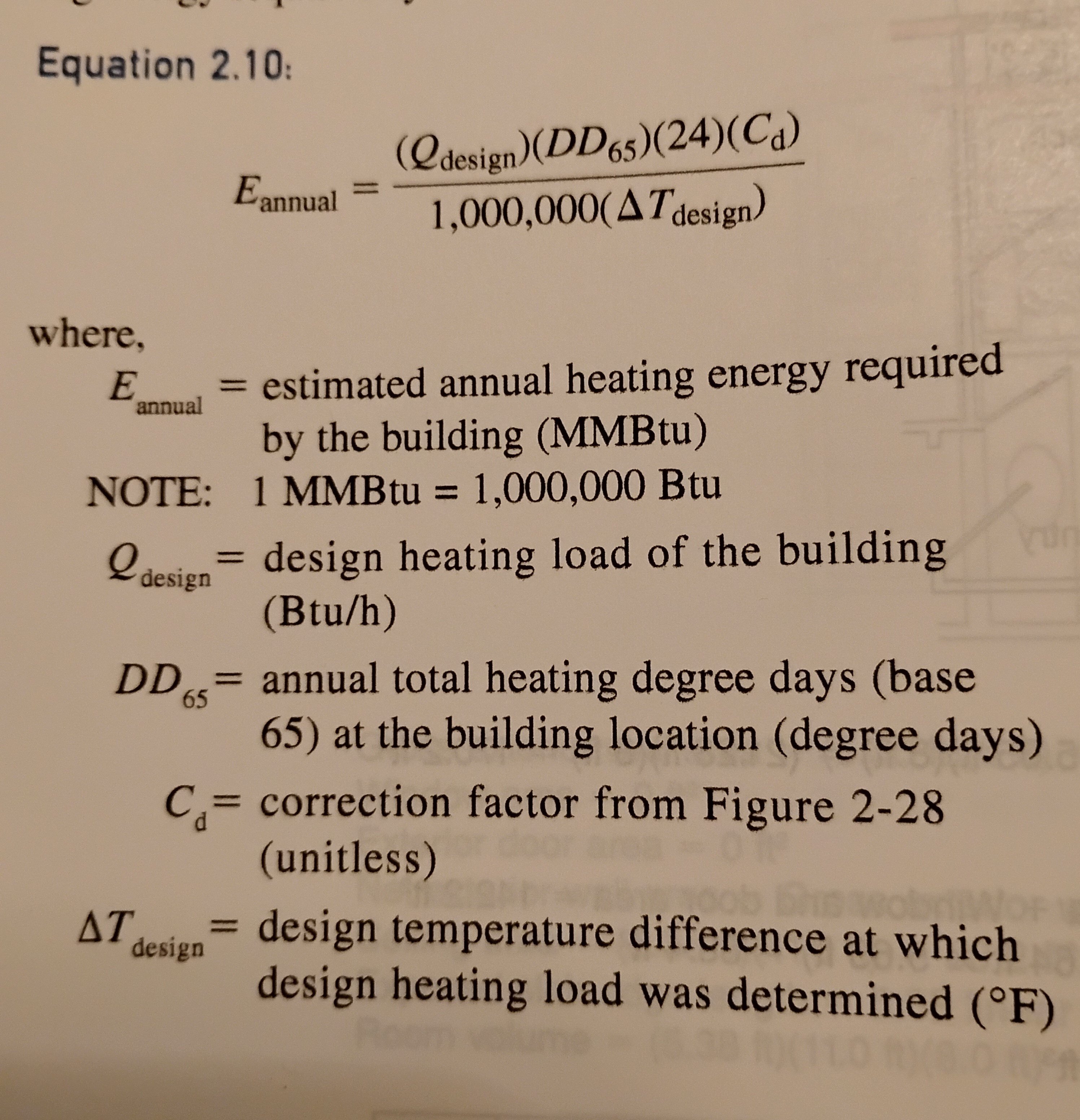

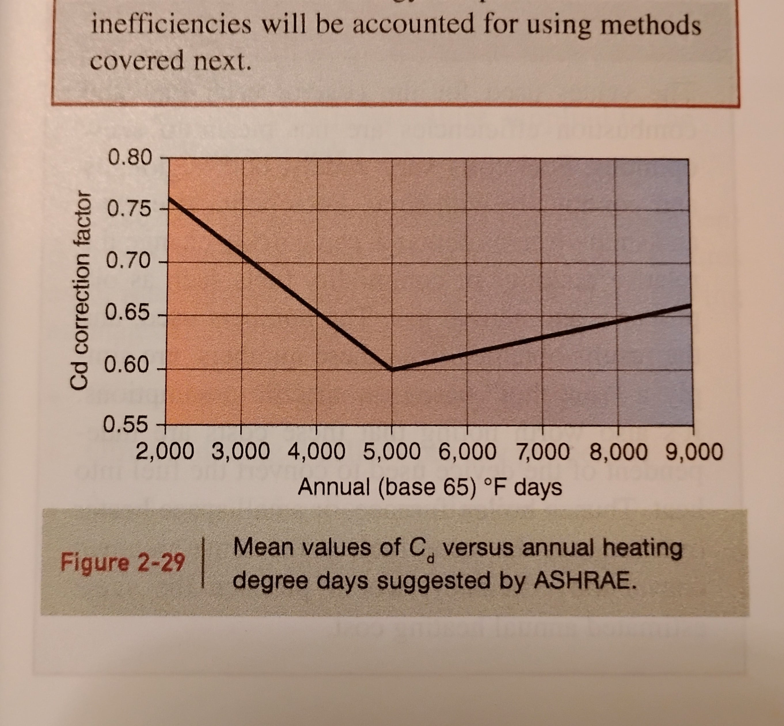

    I'm not a heating pro, just a homeowner/mechanical engineer. But I agree with @hot_rod that your first step should be getting an accurate heat loss number so you can size a replacement boiler correctly.
    One way to do this very accurately is to fix your existing boiler and run it for next year's heating season, while keeping track of the total therms/BTU's it uses. Once you have that number, you can calculate design day heat loss quite accurately with the equation below, using the Cd correction factor for the number of heating degree days in your area. The value "E" in the equation will be the number of BTU's your boiler actually outputs into the house (in millions of BTU), which will be your total BTU consumption multiplied by the total efficiency of your old boiler. For a big old cast iron boiler like that, you'll have to guesstimate the total efficiency, which might be around 0.6 (60%). (Combustion efficiency will be around 80%, but then you have to subtract heat loss up the flue after shutdown, jacket loss, etc. For your boiler, a guesstimate of around 60% total efficiency will get you in the right ballpark.)
    One other point is that your gravity conversion system probably has a massive amount of radiation, meaning you can heat the house with relatively low-temperature water (like around 120 degrees). This is favorable for a mod-con boiler because it means the mod-con will run in condensing mode all season, maximizing its efficiency. So unlike other cases where people have too little radiation that requires higher water temps that prevent the boiler from running in condensing mode, you have the perfect setup for a mod-con boiler.
    So if it were me, I'd fix the existing system, run it for at least a year, add up your total BTU's used, calculate your design day heat loss from it, and plan for a mod-con boiler when the time is right. Meanwhile, you can spend the next year researching mod-cons and local installers.

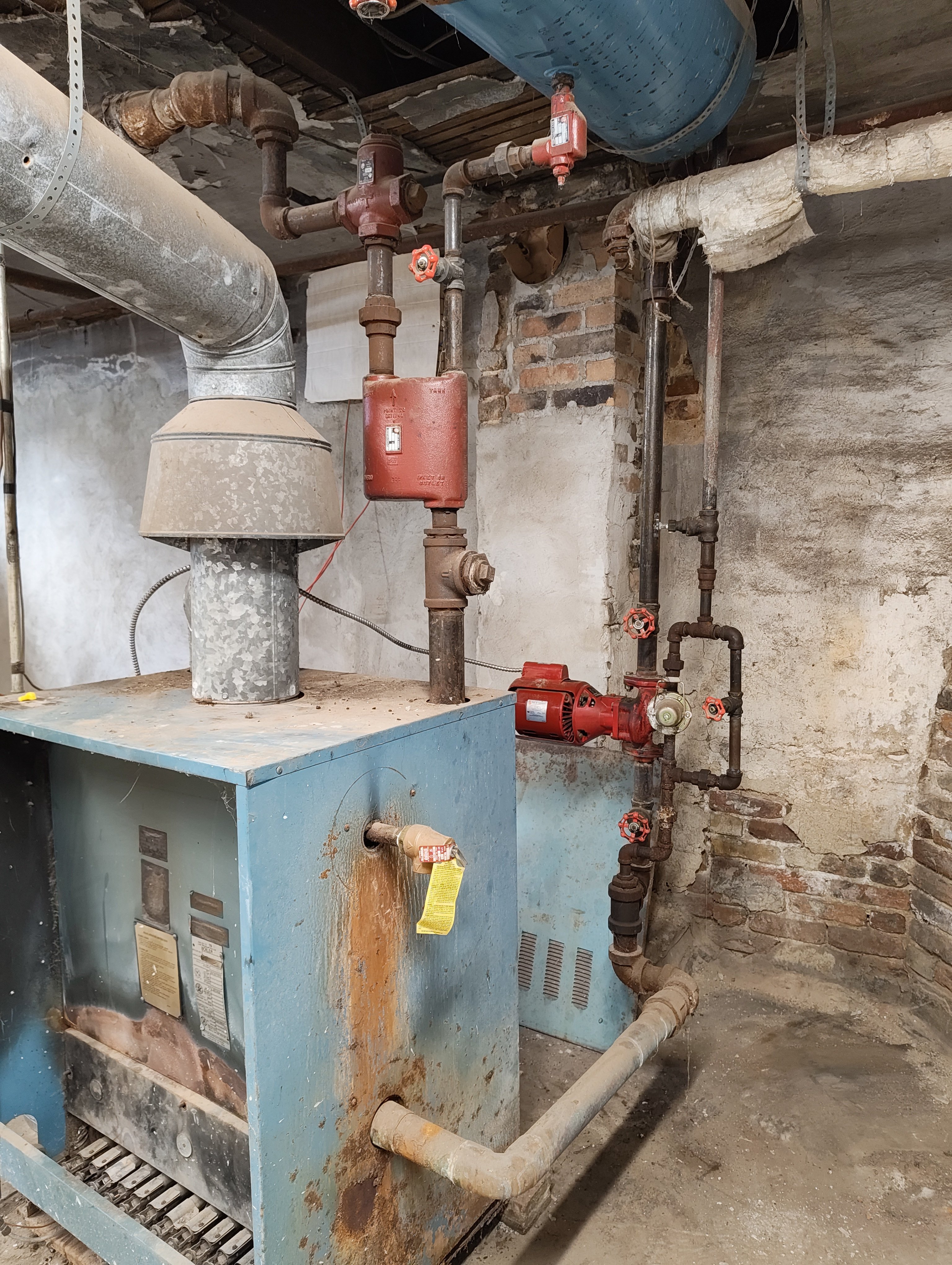

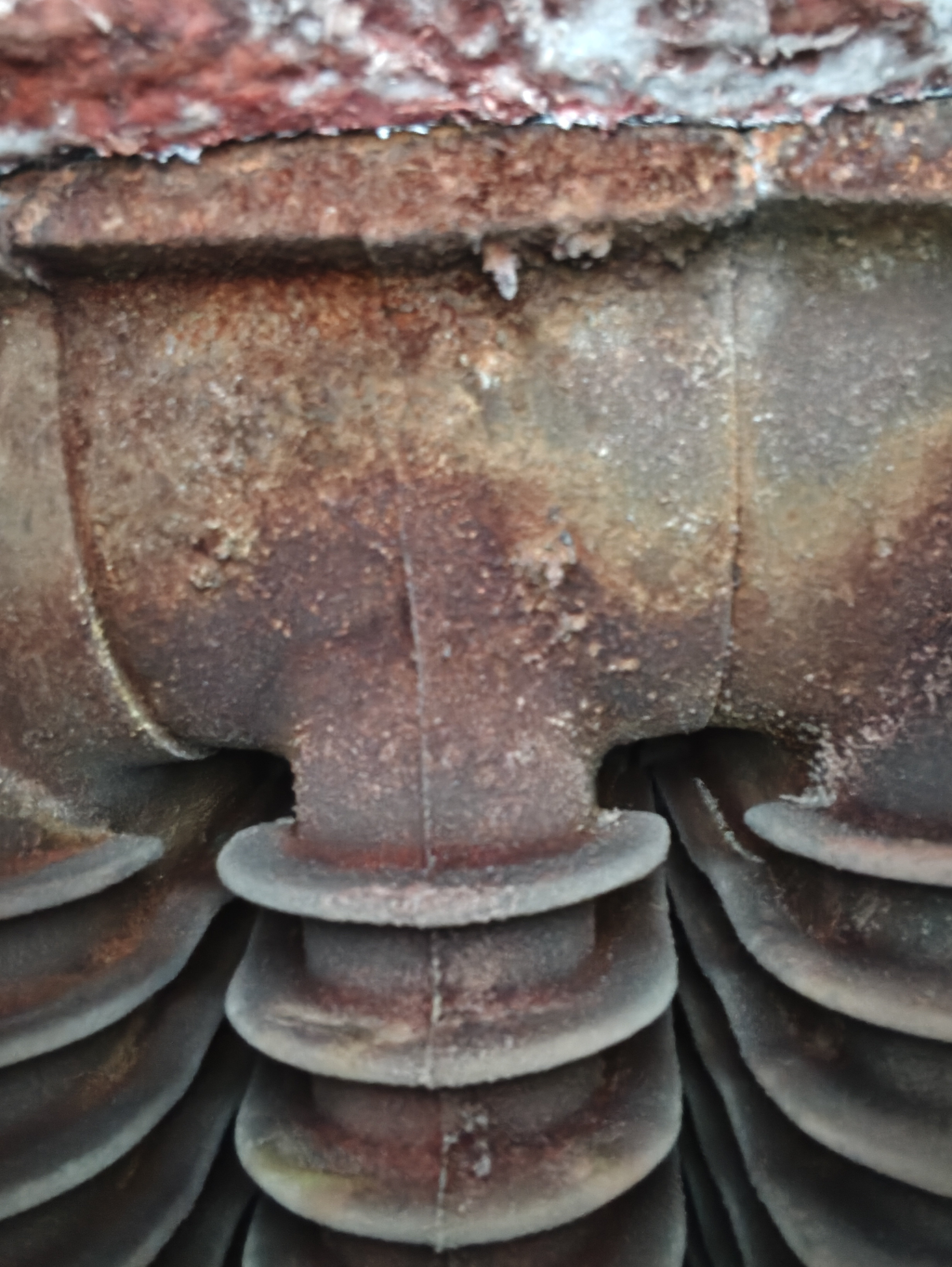

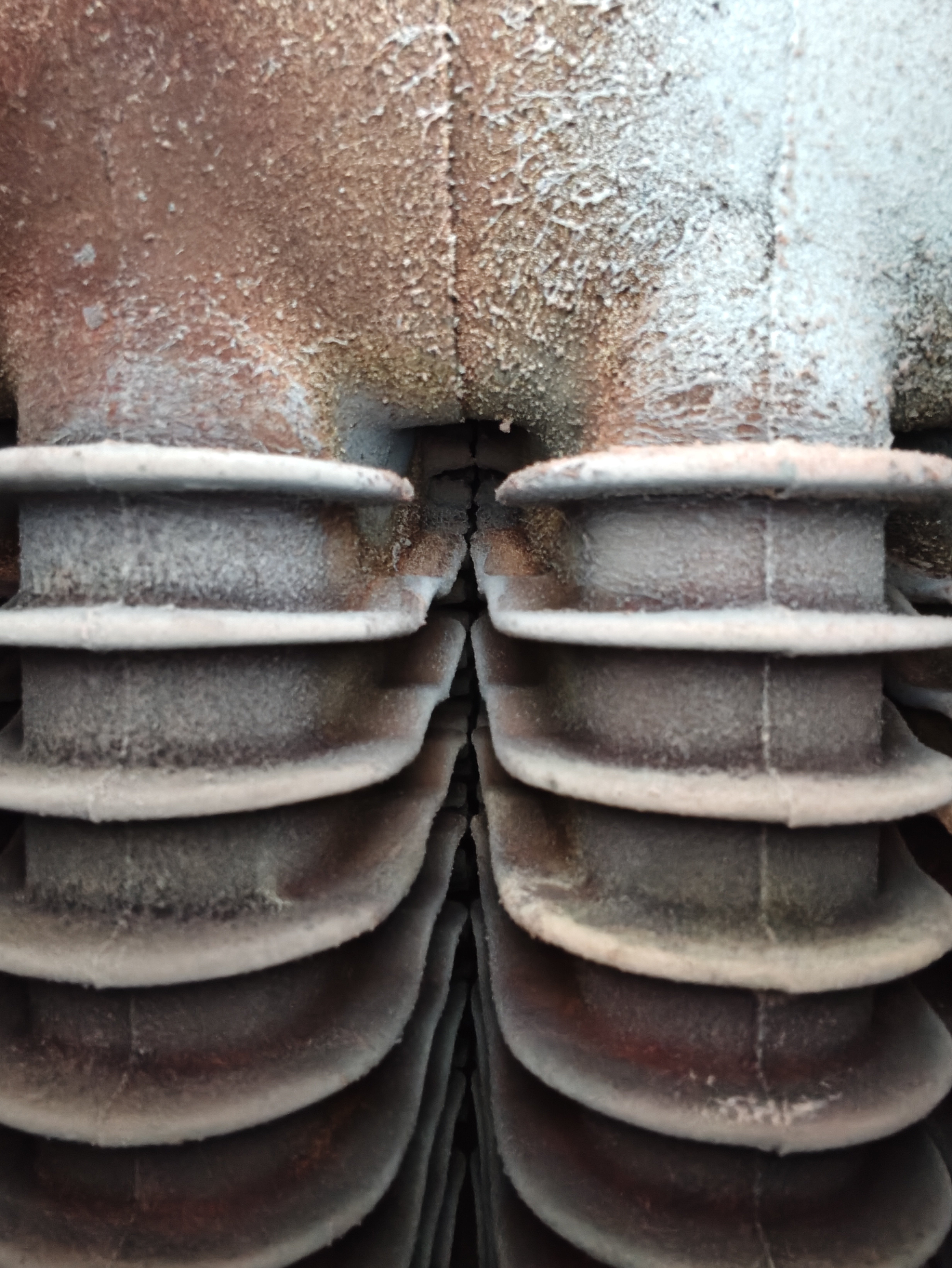

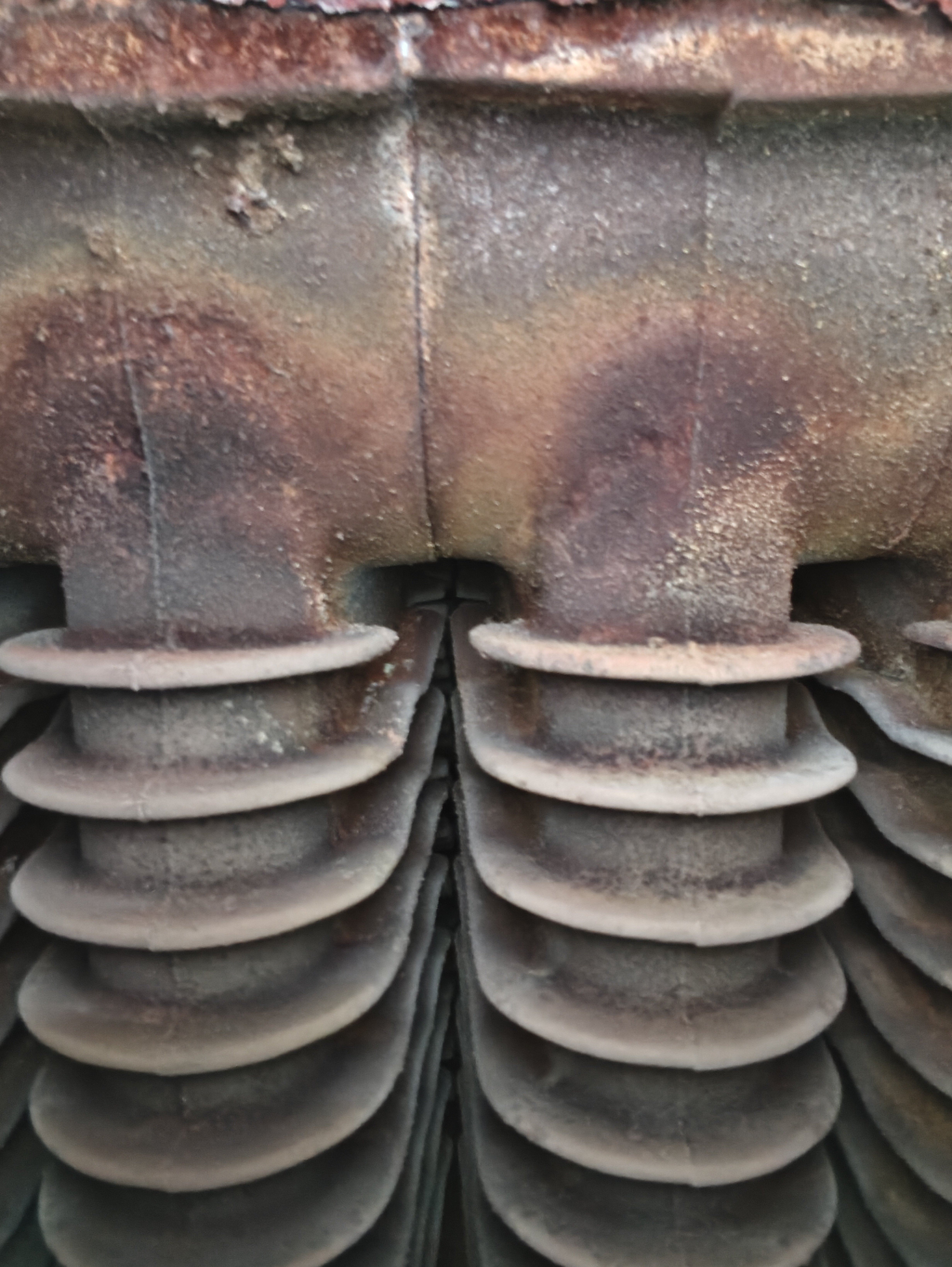

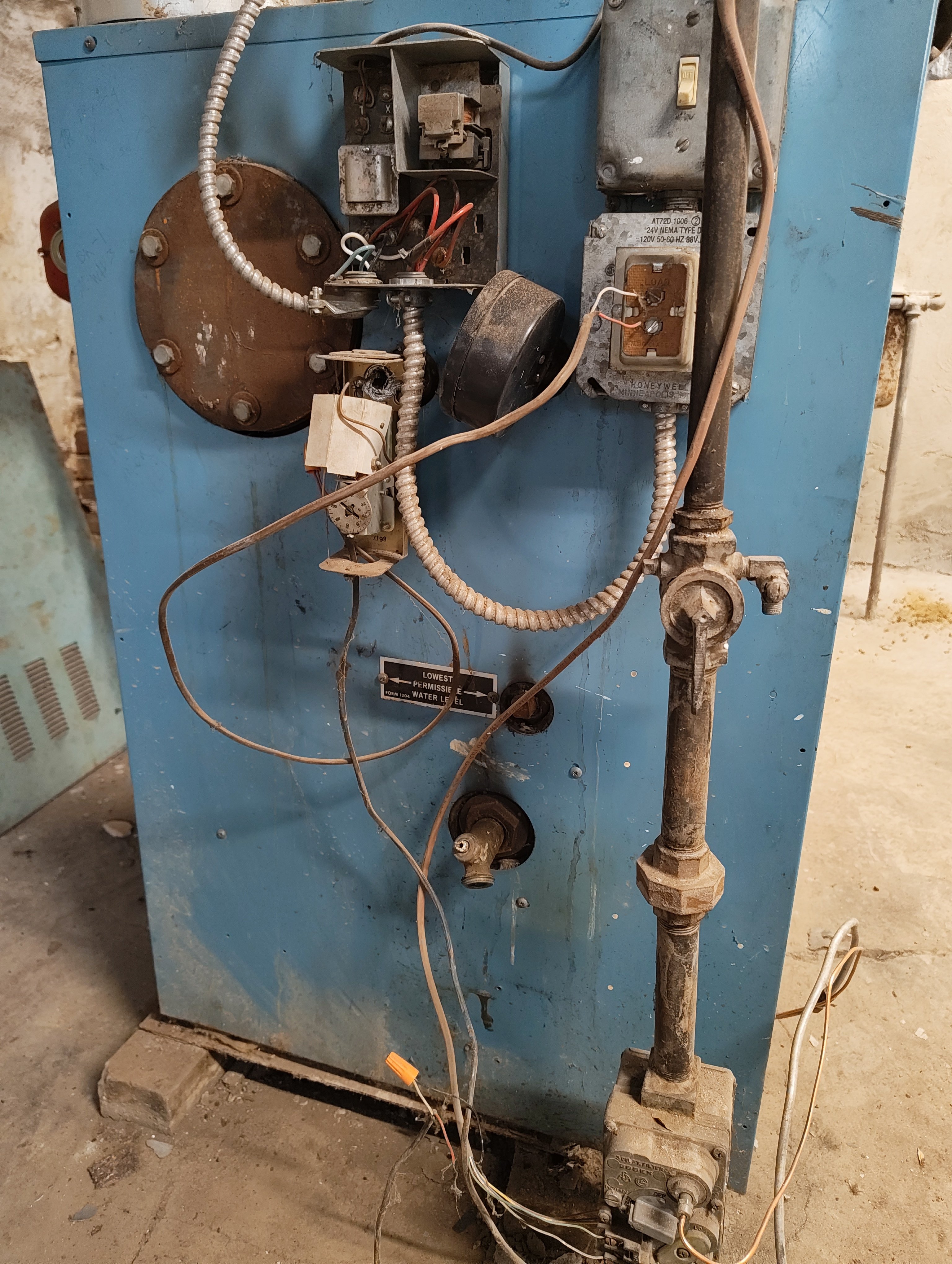

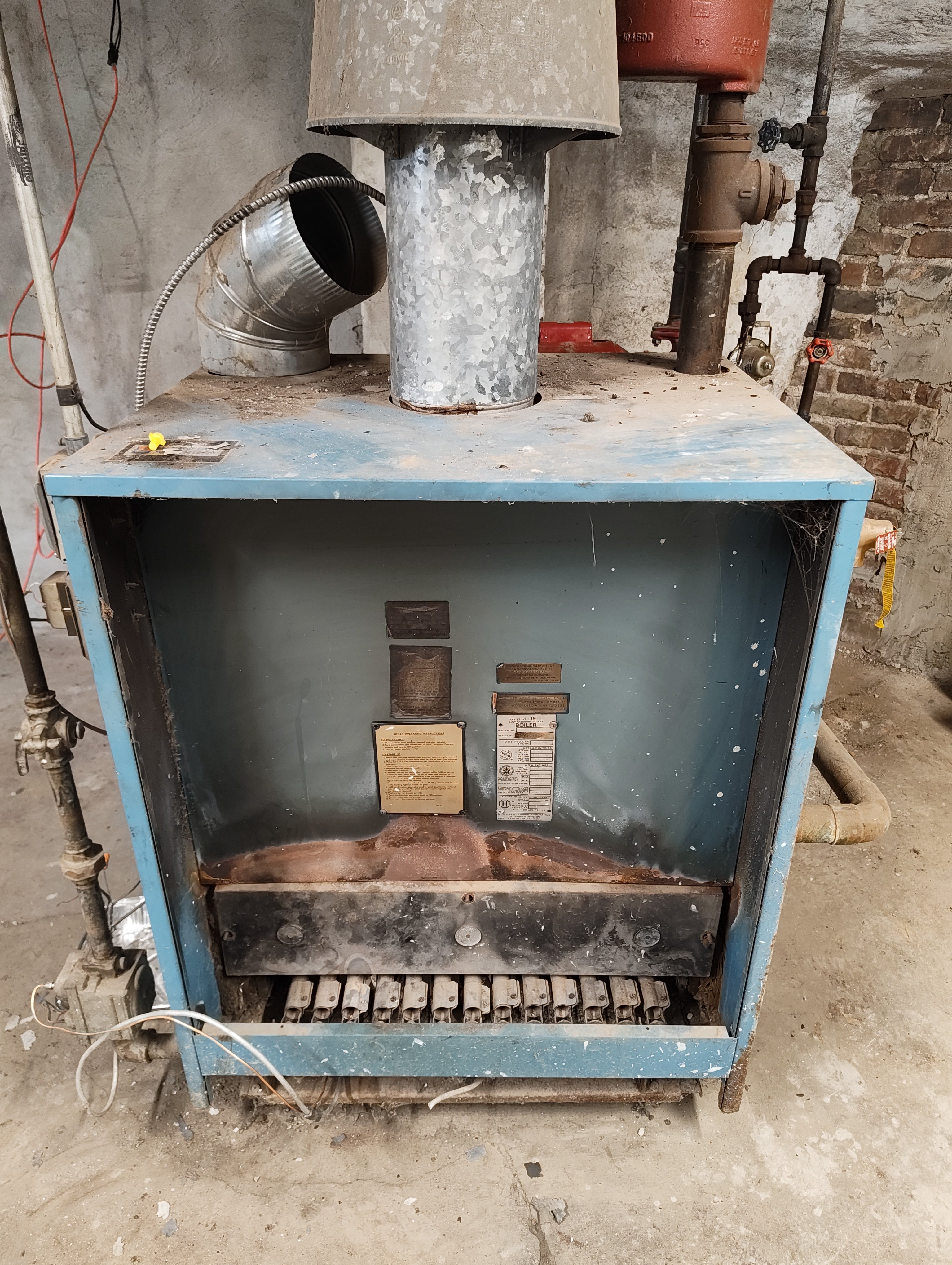

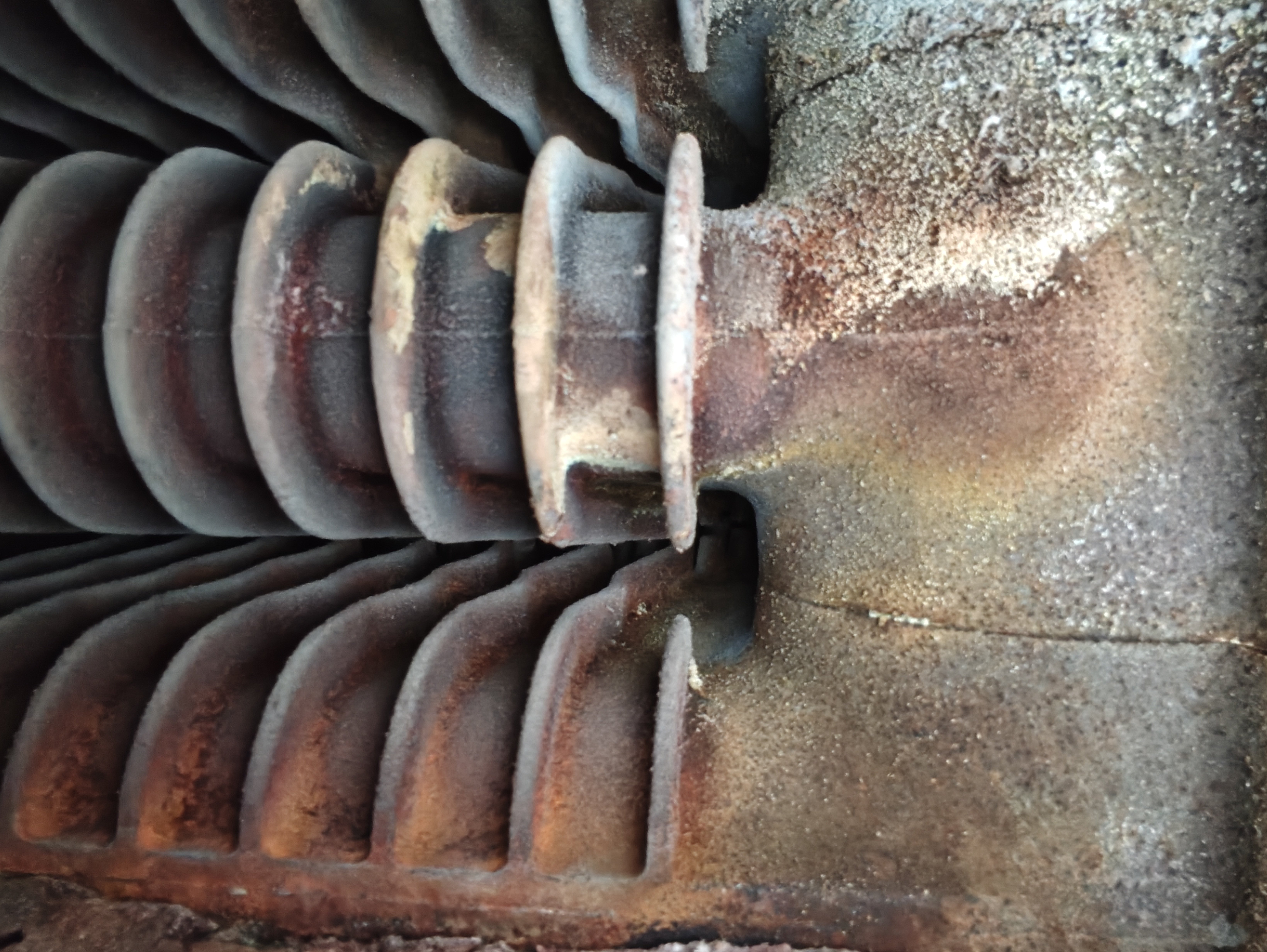

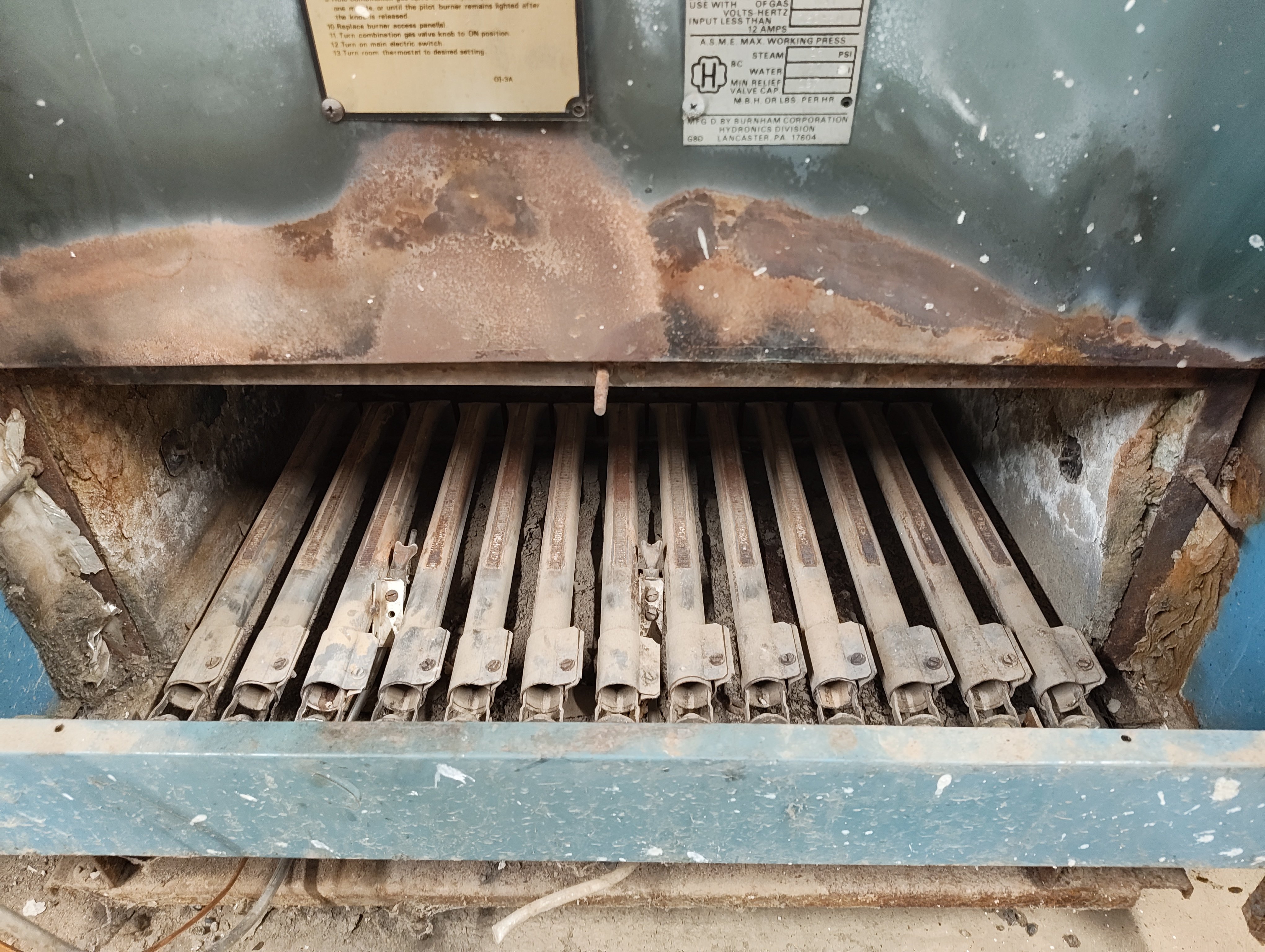

    Some pictures of the burnham.
    And the boiler inside.

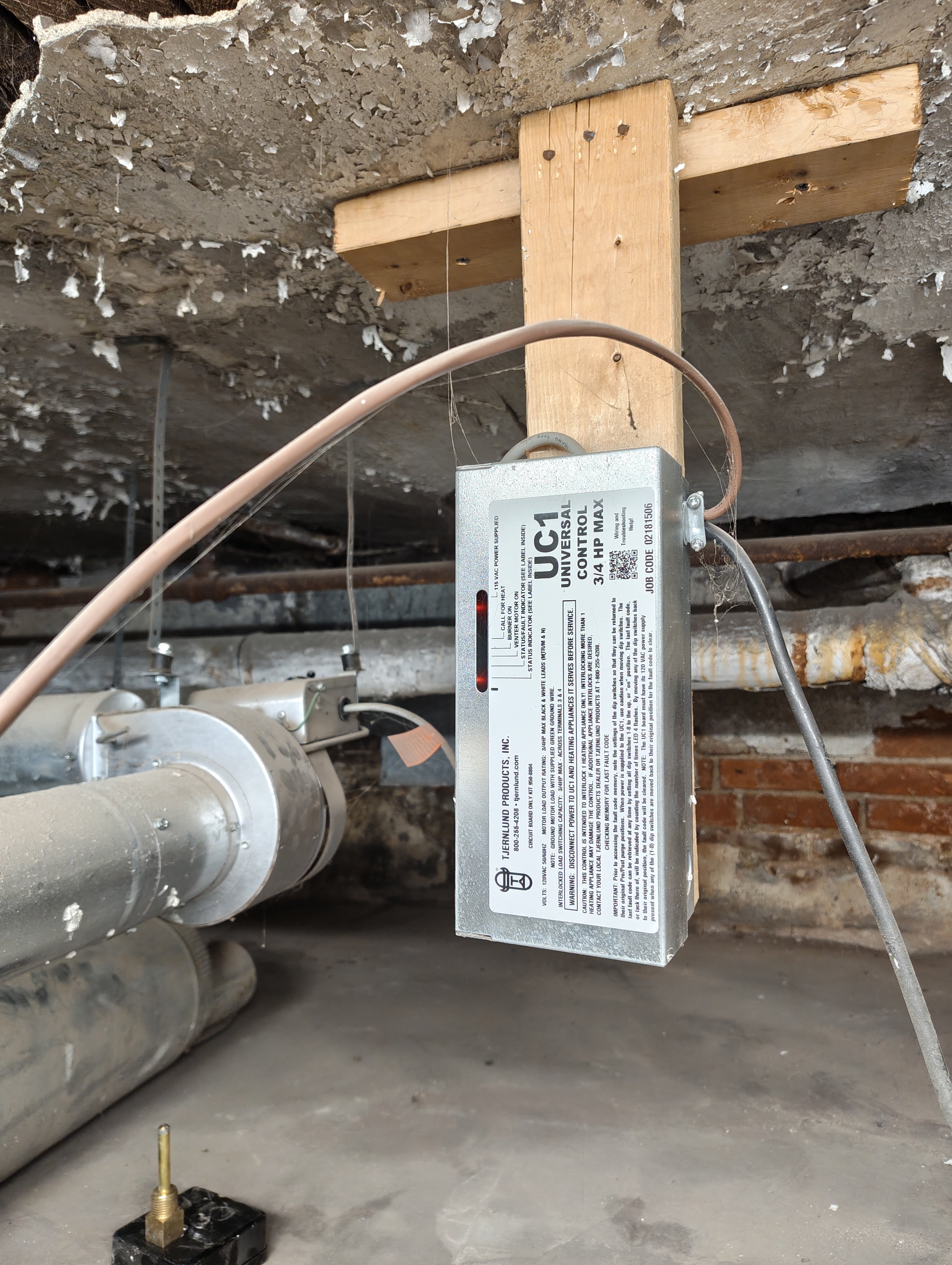

    And the tag, and blower setup:

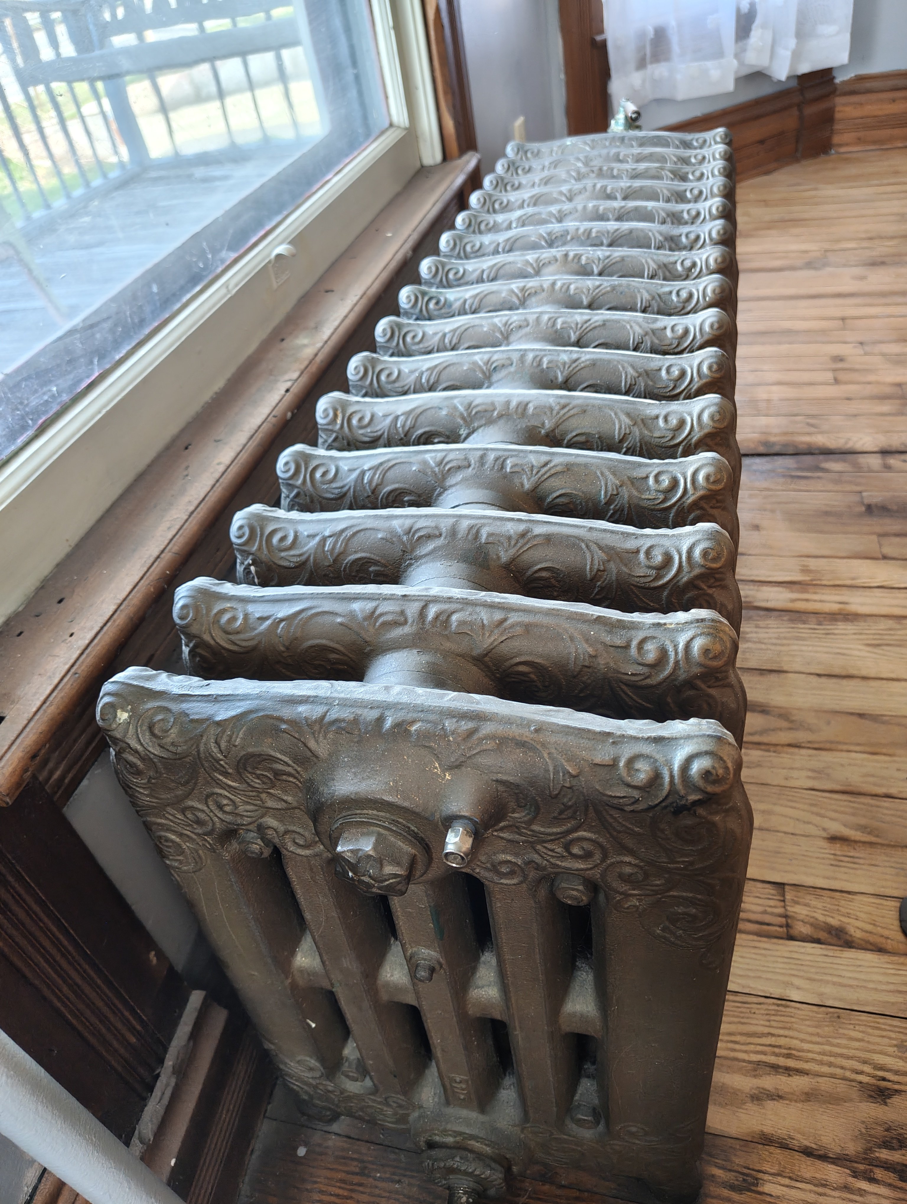

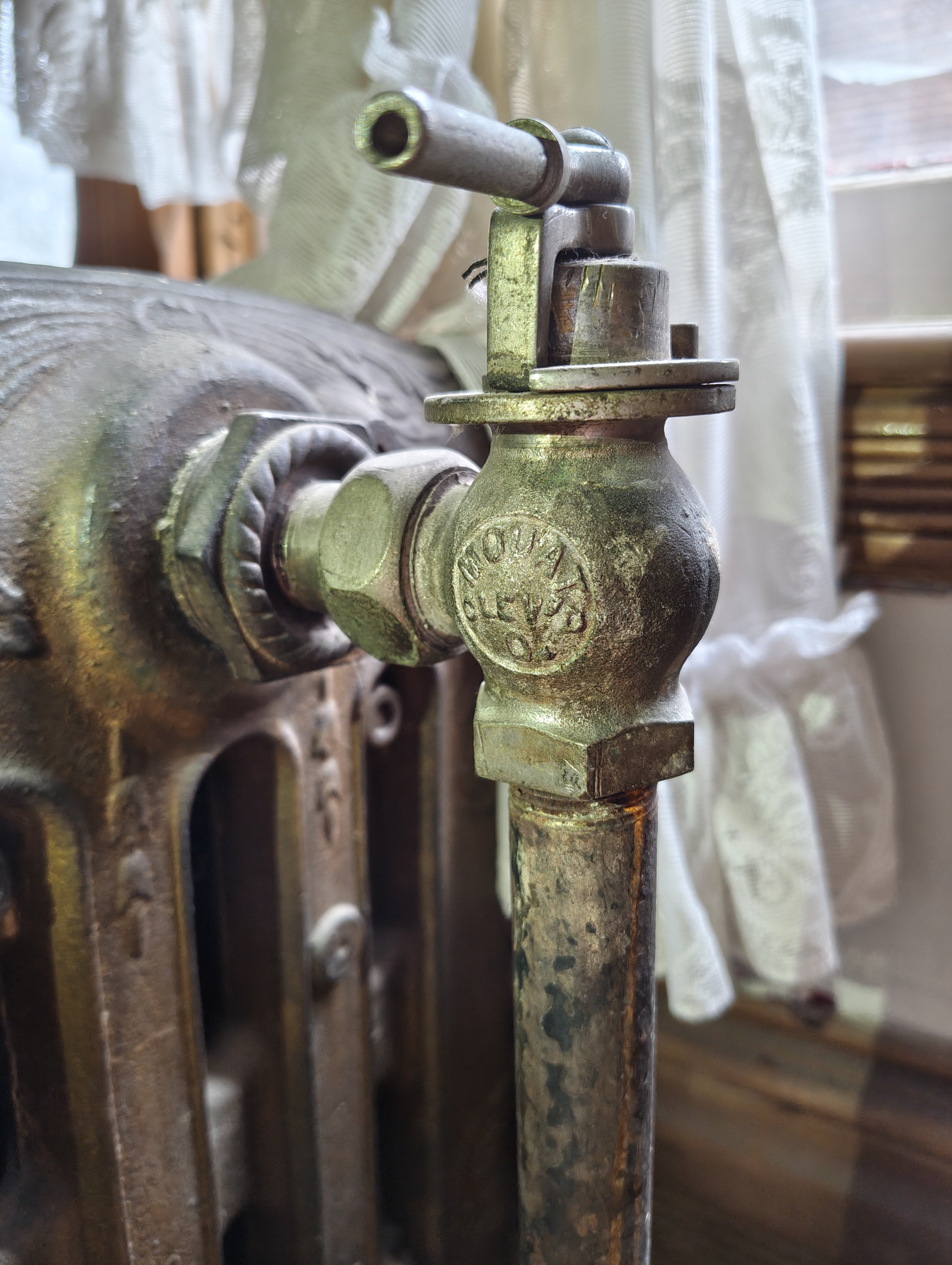

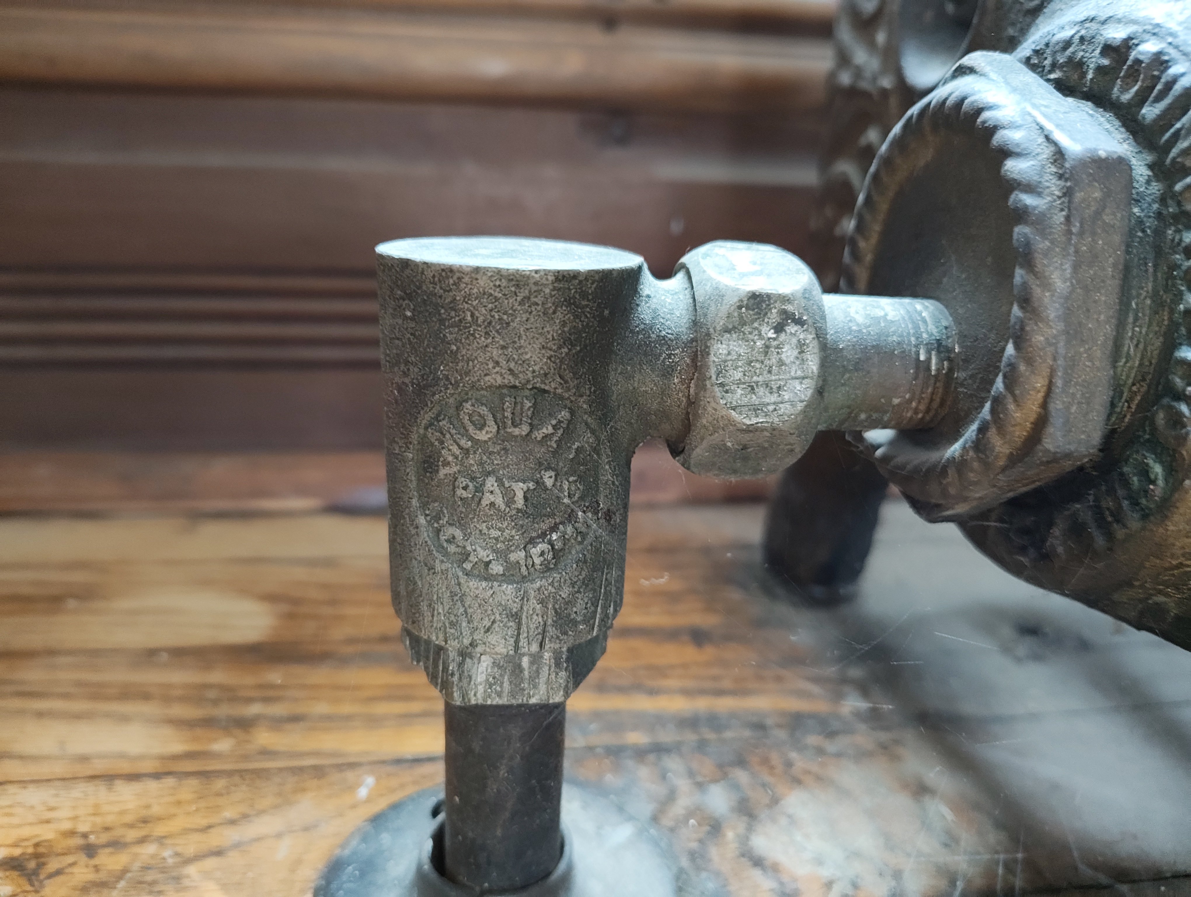

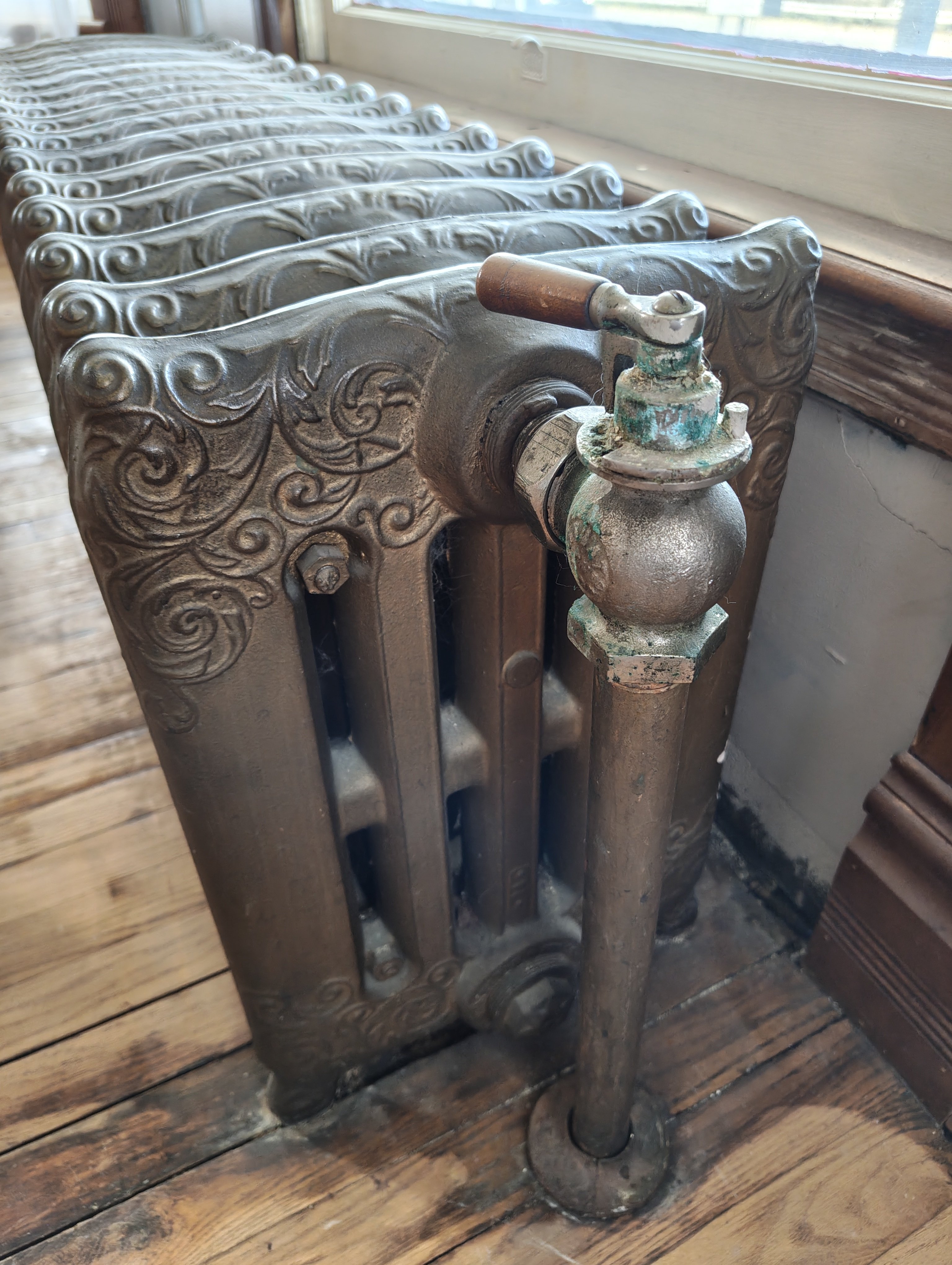

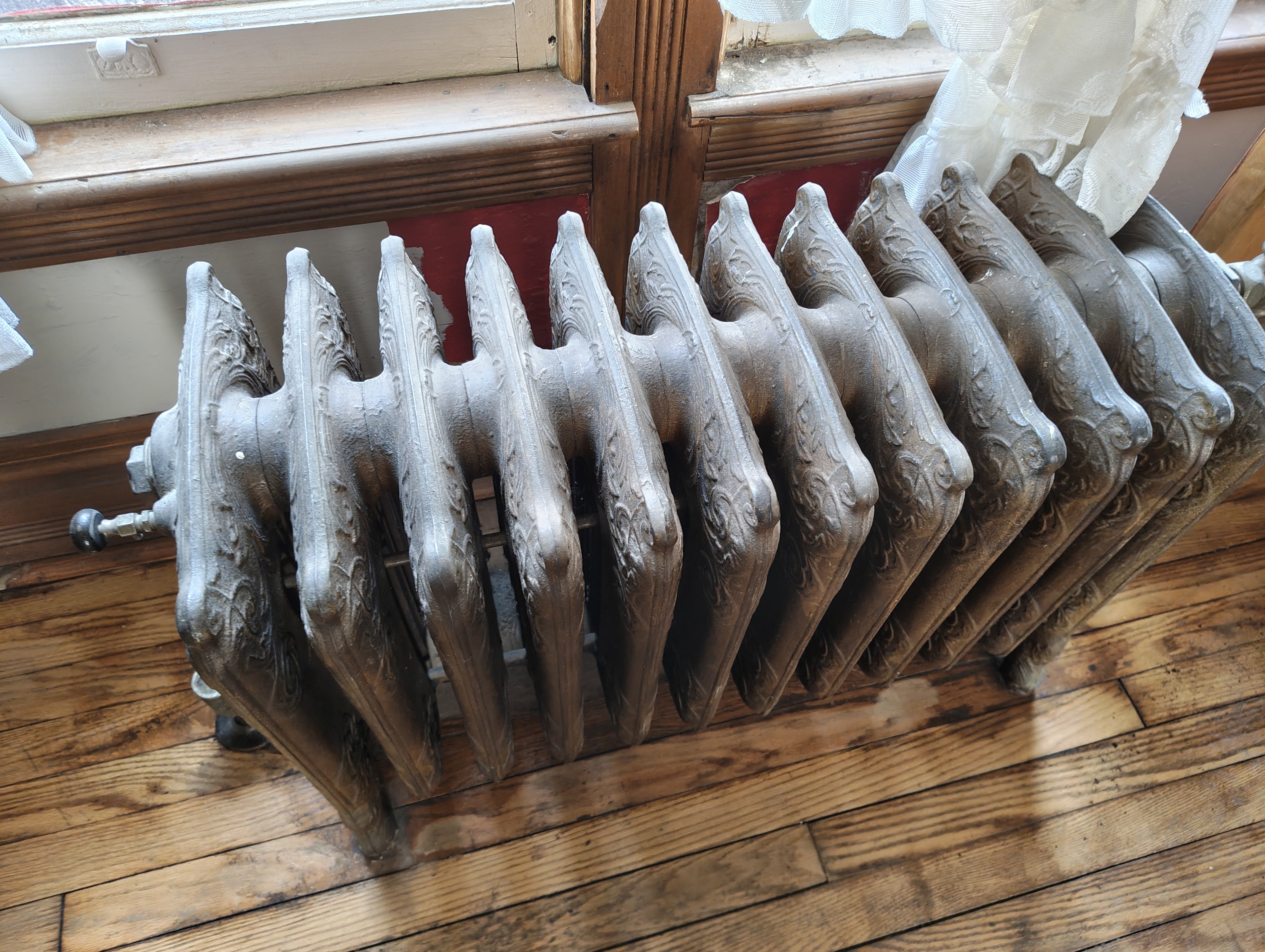

    And two of the radiators downstairs:
    mattmia2 Member Posts: 16,762
    it was a vapor system that was converted to hot water. that radiator valve is a vapor valve, i recognize the specific brand but don't remember what it is, others will know exactly what it is. Syphon I think.
    that boiler has been neglected. it will still clean up and run but it is in rough shape. I think both of those pilots should be connected and should have a dual pilot safety, that is probably what a lot of the rollout is from, from the delayed ignition of the right half of the burner.
    that 100 series b&g could have been replaced with a wet rotor circulator for a lot less.

    The controls look rough, but the cast looks good. I would check with the municipality to make sure the tjernlund is venting in an acceptable location out the window. When replacing the gas valve, @mattmia2 is right, the second pilot should be connected. The tridicator looks like its in an awful location and the wrong angle, and the relay looks like its not long for this world. You can do this though. Straighten out the wiring mess, im sure @EdTheHeaterMan can draw you a diagram.

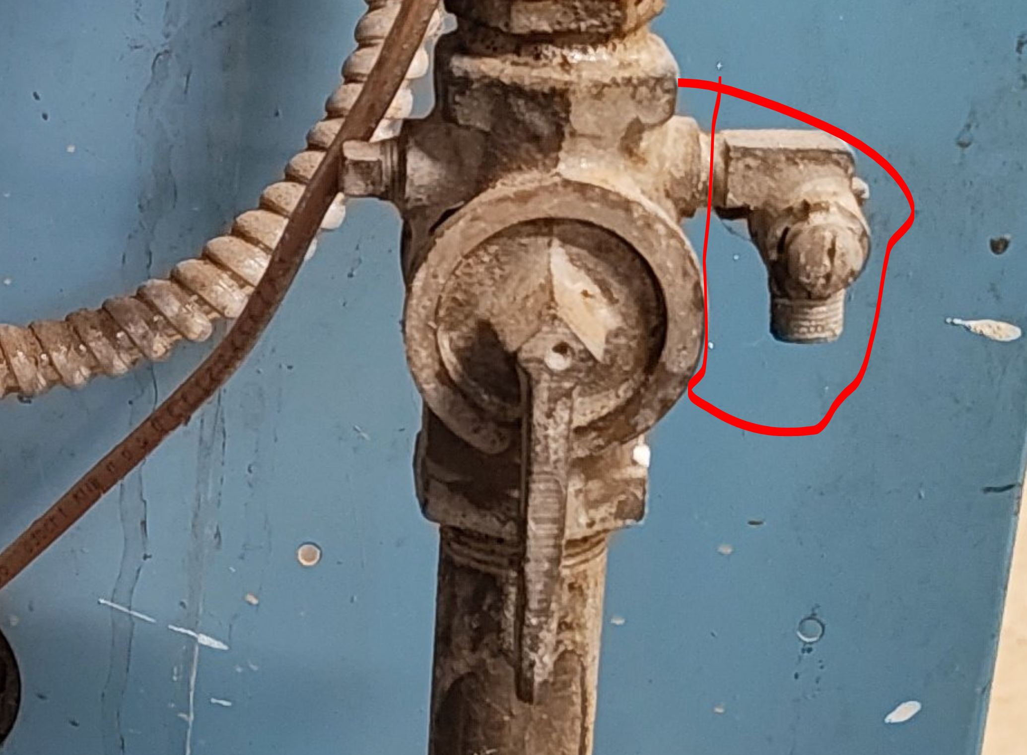

    edited March 26
    the relay looks like it was in a structure fire…
    at least they left both pilots so you know how they screwed it up. i think baso makes ]a device to connect 2 thermocouples to the pilot safety on the gas valve i know they make a standalone safety valve that can take 2 thermocouples.
    you could put a standalone safety valve with a pilot tap before the combination valve. in that case you'd light the pilot on the standalone safety, that would provide gas to the combination valve, then you'd light the pilot on the combination valve.
    one of the pilots was connected here:
    although i'm not 100% sure how, if there was a safety with a switch or what since it would need to interlock the burner and turn off the pilot gas if the pilot went out.
    there may be a schematic inside the front cover that shows what was there.
    EdTheHeaterMan Member Posts: 12,173
    I have a strong feeling that you have a Burnham Series 4 boiler
    It was available in both hot water trim and steam trim from the factory. It appears the a Steam trim boiler was purchased and field converted to hot water (badly) The 408 seems to have the correct ratings for that boiler rating plate. With that information in mind you should look for a round plate with a 3/4" pipe thread tapping in the center of it to accompdate a new Aquastat. I would select a HydroStat combination aquastat, relay, LWCO control and mount is there, where the manufacturer designed it to be. It appears the the Tridacator (Boiler presure temperature gauge) was supposed to be mounted where the current Aquastat is located. I might make two change to the circulator location and the water feed location while the boiler has no water in it. as shown here:
    This will make the circulator location pump away from tne expansion tank and place the auto feed valve at the point of no pressure change as described in the book https://www.heatinghelp.com/store/detail/pumping-away-and-other-really-cool-piping-options-for-hydronic-systems/
    Here are the links to the Tridicator and the Hydrostat 3200 along with the matching 3/4" Well Adaptor. You may drill and tap the existing cover plate for your Aquastat mounting or you can purchase blank plate with 3/4" tapping with gaskets if you don't want to purchase the drill and tap needed for that project.

    Steamhead Member Posts: 18,497
    That was a Mouat system. If you enlarge the pic of the valve, you can see the name. @triode , if we can get a pic of the return fitting on one of those radiators, that would confirm it.

    109A_5 Member Posts: 4,001
    Looks like someone screwed up a perfectly good steam system. Sad.
    Can you take some better pictures of the return side of the radiators ? Maybe a Mouat water seal. How well will that flow hot water ?
    What is this name on the valve ? Maybe Mouat ?

    Yes, it is a burnham 408.
    I am replacing the ancient manual gas shutoff that had the pilot connection with a modern gas shutoff.
    A few boiler techs noted that they moved from 2 pilots to 1, but never noted anything more. I was going to use 1 unless it is a real problem. I was also going to a non-standing pilot (I think it is called pilot ignition) system with the honeywell universal unit.
    @EdTheHeaterMan noted to move the water intake but I would also have to reverse the pump, as right now it is pumping into the bottom pipe in the burnham, meaning (unless I am mistaken) it is pumping into the boiler which is "pumping into the expansion tank" not away from it. Am I wrong? (see my whiteboard for the pump direction).

    Here are the pictures that were requested:
    PC7060
    Thought so. The Mouat was an excellent system. If that were my house I'd go back to the original Vapor configuration.
    @gerry gill is our resident Mouat expert, maybe he'll chime in.

    @Steamhead They are not all Mouat systems, I did not look again, but I think maybe 7 out of the 9 are (9 big radiators, one small baseboard unit). The baseboard radiator is in a back room that was added, but it puts out nearly zero heat compared to the rest of the radiators. I need to fix that also.
    edited March 27
    that gas valve is probably the same age as the boiler. you should replace it with another one with the pilot tap and pressure tap. the 2 pilots are to allow the burners to light smoothly and at the same time. it would be difficult to convert it to intermittent pilot with the needed 2 pilots.
    you need 2 pilots. the way it is now it almost certainly lights with a bang and a puff out the front as the gas builds up enough on the right side to get to the burners that lit off the pilot on the left side. the technical term for that is delayed ignition but it is actually a small explosion. i suspect that is why there is scorching all over the front of it.
    I think the way it was installed originally was with this pilot safety controlling one pilot off the pilot tap on the manual gas valve:
    https://www.supplyhouse.com/Baso-Gas-Products-L62GB-1-Safety-Shutoff-Device-100-Lockout
    and the electrical connection in series with the safety chain to keep the combination valve from turning on if this pilot went out and the other pilot was controlled off of the combination valve.
    this would let you light each pilot independently but it would only fire the main burner if both pilots were lit

    Dont forget he has an induced fan on this. It probably does everything @mattmia2 said, except actually rolling out. More likely you are just blowing raw fuel out the side of your house without the proper pilot assemblies.
