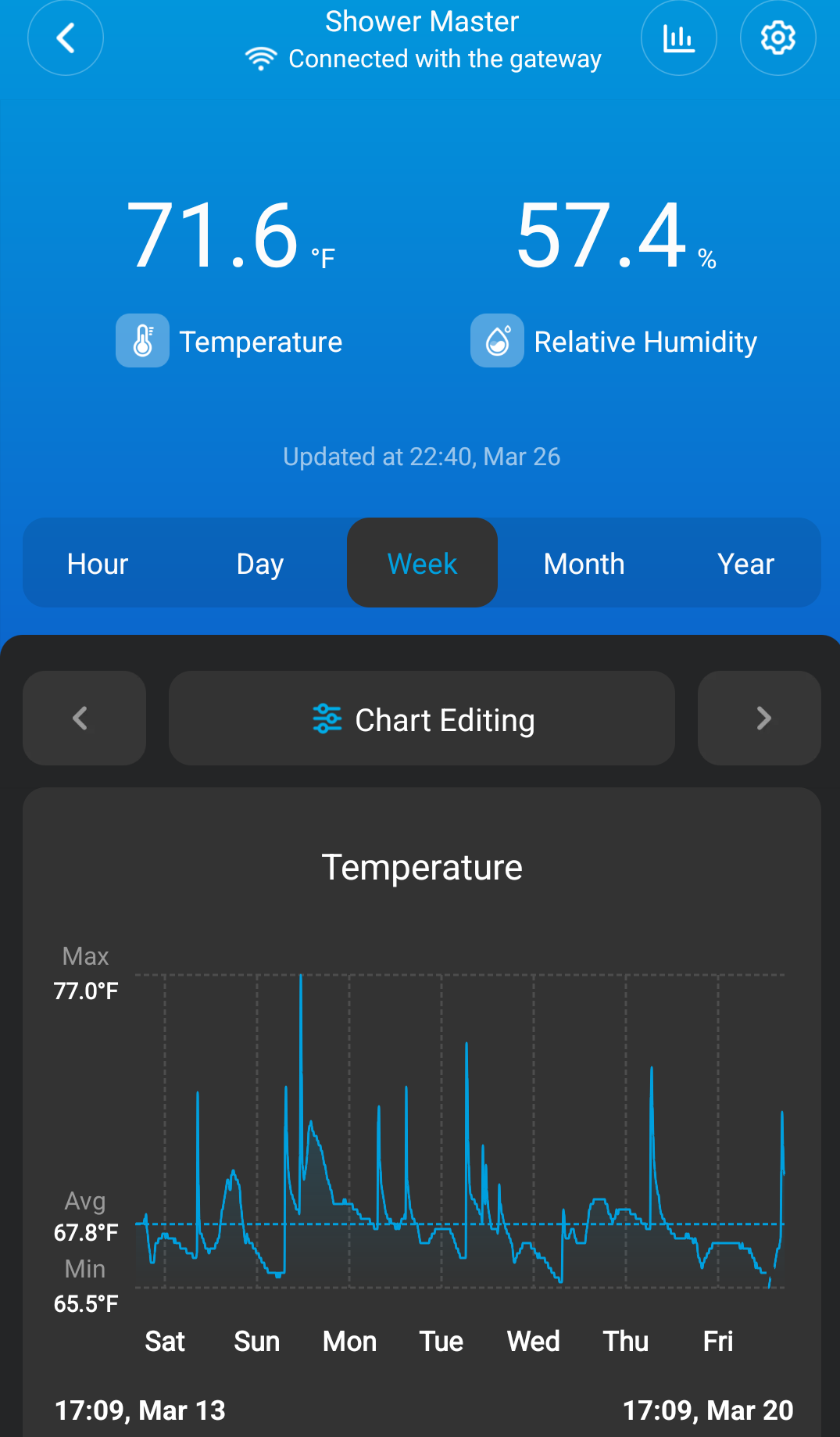

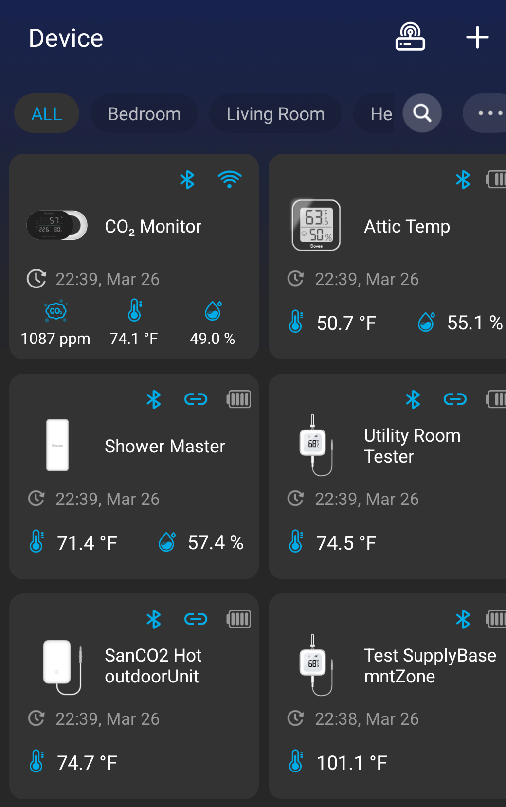

    bjohnhy Member Posts: 208
    Govee is nice. Depending on the model of Govee sensor, it may need the separate hub for wifi access (remote) as opposed to local(Bluetooth). All Govee sensors that I've seen provide historical data that can be graphed highlighting the high and low temp of the time frame you choose to review.
