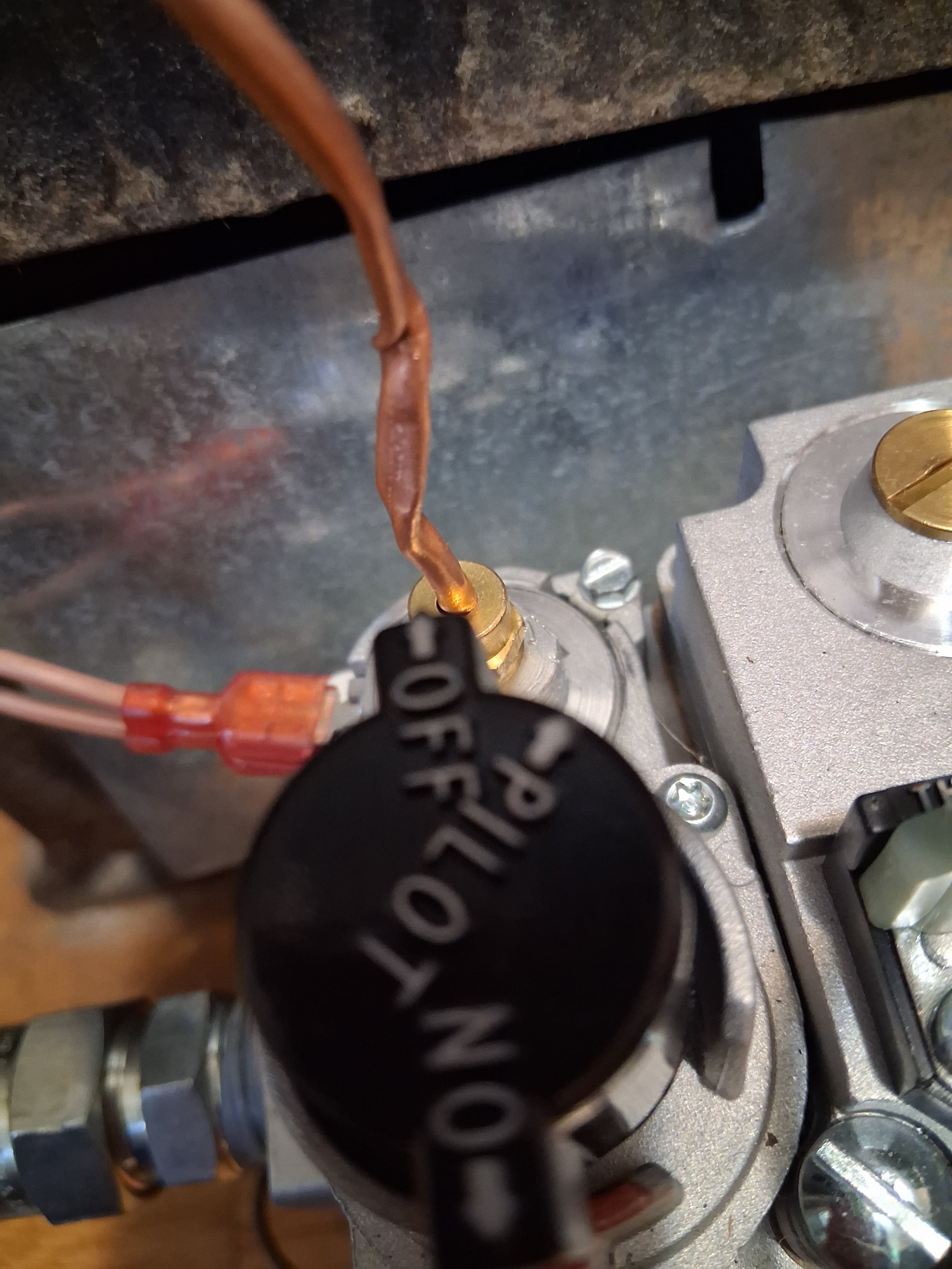

    guzzinerd
  • guzzinerd
    guzzinerd Member Posts: 455
    Ok, so the pilot goes out on it's own after a few minutes, thermostat off. I lit it again and, just for kicks, turned the thermostat on. The pilot went out as soon as the burners fired up.
    The plumbers that installed the new control valve mangled up the, new, thermocouple pretty good. Would that affect it's performance?
    Bryant 245-8, 430k btu, 2-pipe steam in a 1930s 6-unit 1-story apt building in the NM mountains. 26 radiators 3800sqf
  • bjohnhy
    bjohnhy Member Posts: 201
    Yes that could definitely cause issues
    SuperTechkcoppGGrossethicalpaul
    mattmia2 Member Posts: 16,673
    i'm surprised it works at all like that. that certainly would be the first thing i'd try although this doesn't explain why it was doing it with the old valve. does th pilot still go ou if you remove that piece of sheetmetal from the front of the conbustion chamber?
    when the pilot goes out does the safety valve in the gas valve close first or does the pilot go out then the valve closes? you should hear the safety valve click when it closes.
    guzzinerdPC7060
    109A_5 Member Posts: 3,959
    edited March 16
    I was about to mention it, I'm glad to see you caught the mangled thermocouple, running it over with the service truck a few times then installing it is not best practice.
    You may have multiple issues, I'd replace the thermocouple, see what it does, if it still acts up then measure the gas pressure at the inlet side of the gas valve in all modes and off.
    Maybe the original issue was ONLY a bad thermocouple, they changed it with road kill, and then thought the gas valve was bad. Too much bad repair technique IMO.

    I put in the new thermocouple myself before having her call the plumbers to try the new gas valve, it made no difference.
    I was very careful not to kink it and definitely didn't touch the wire with pliers (as seen in original pic above).

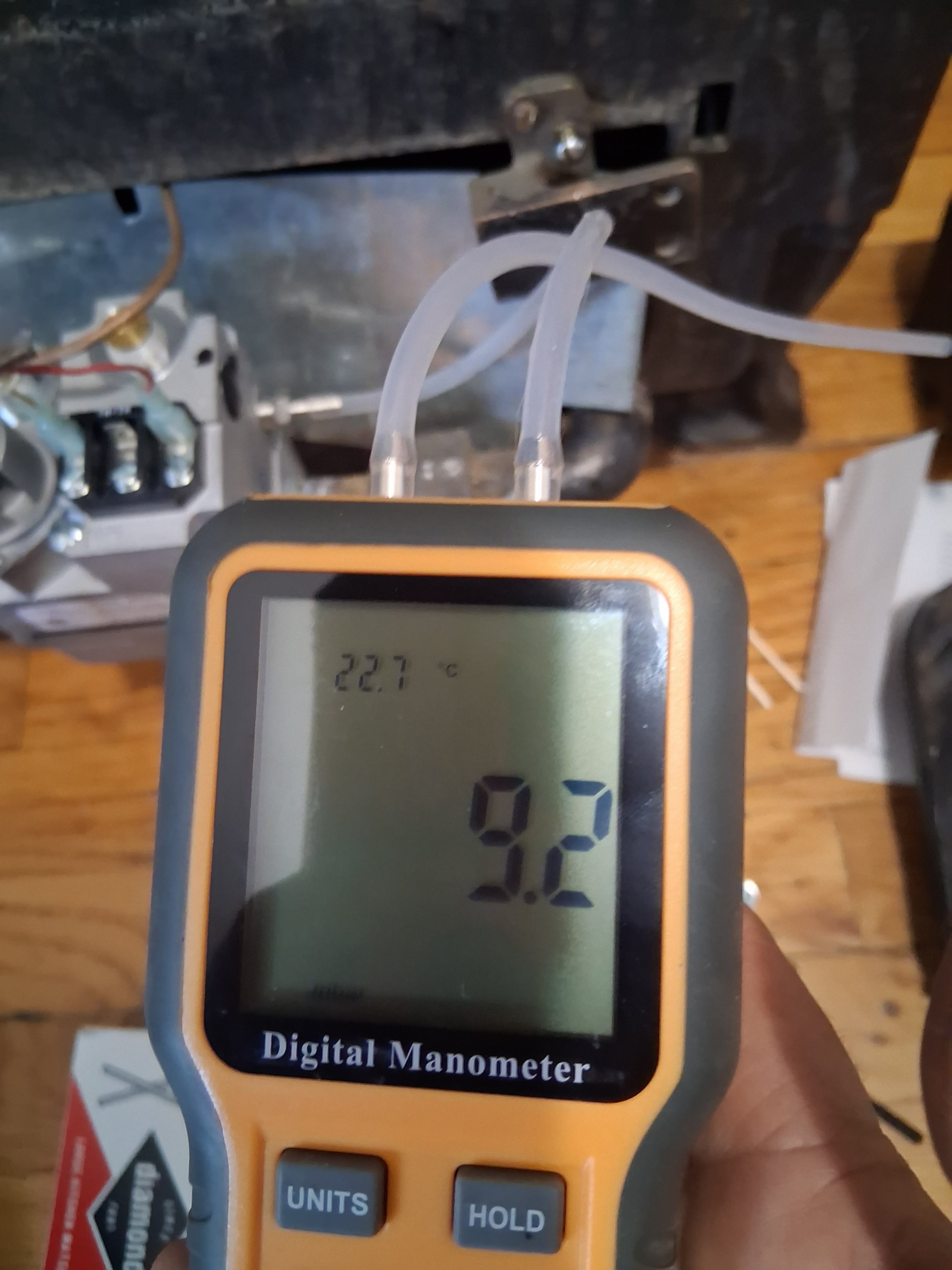

    Ok. I put the original thermocouple back in. It's turns on for a minute then the pilot goes out followed by the burner via the gas valve click. Video:
    https://youtube.com/shorts/J_5pTMM0FgE?si=UA9WiaVC8TcO1Jal
    The pressure goes from 0.1 to 9.2 mbar when the burner kicks in..then back down to 0.1 when it's shut off

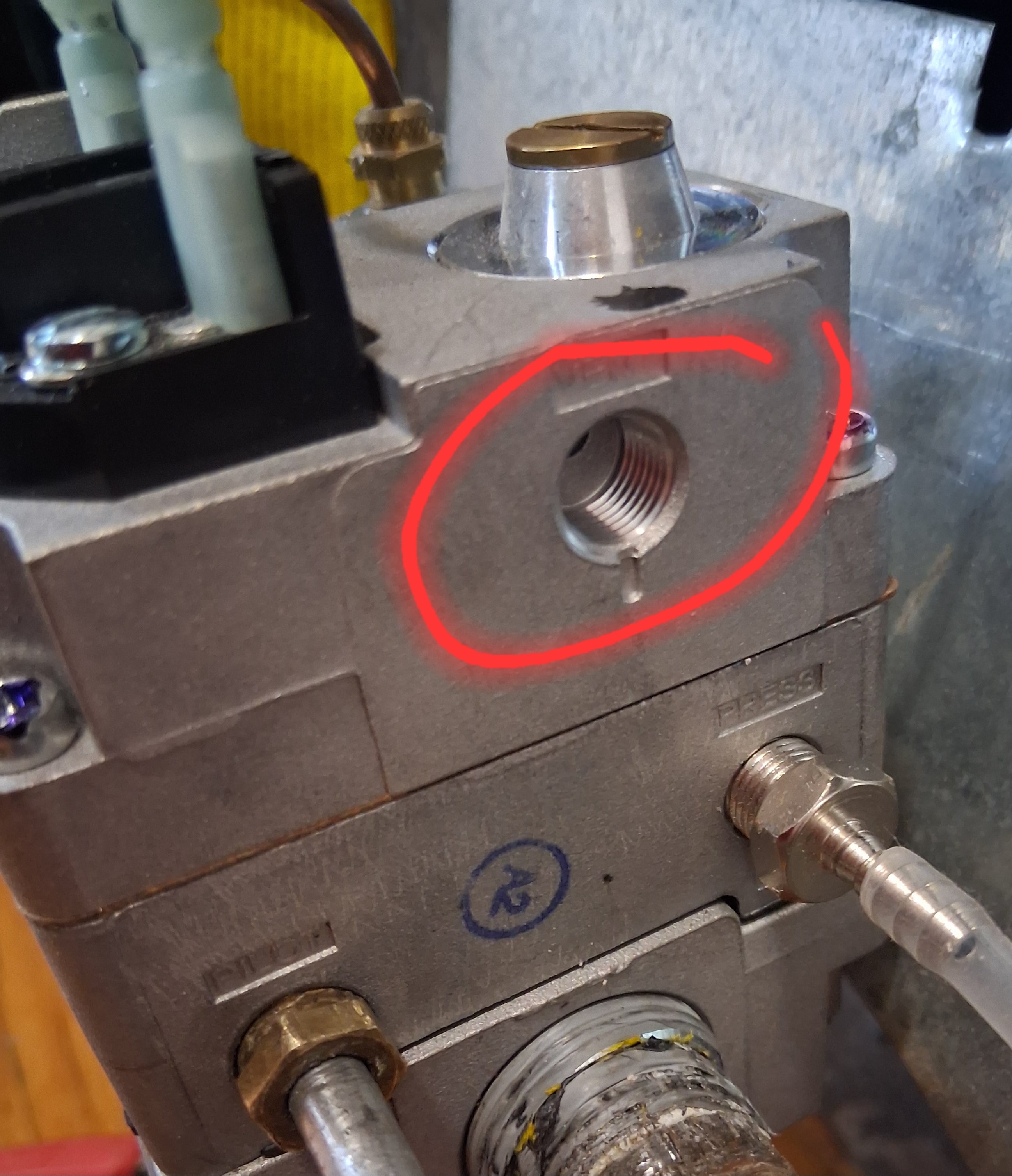

    What is the gas input side pressure of the gas valve doing ? Should be a test port there too.
    If you continuously hold the knob in pilot lighting mode (position), will the pilot run indefinitely ? If so try a new thermocouple.
  • guzzinerd
    edited March 16
    Actually, don't see an input port...edit.. is it this?
