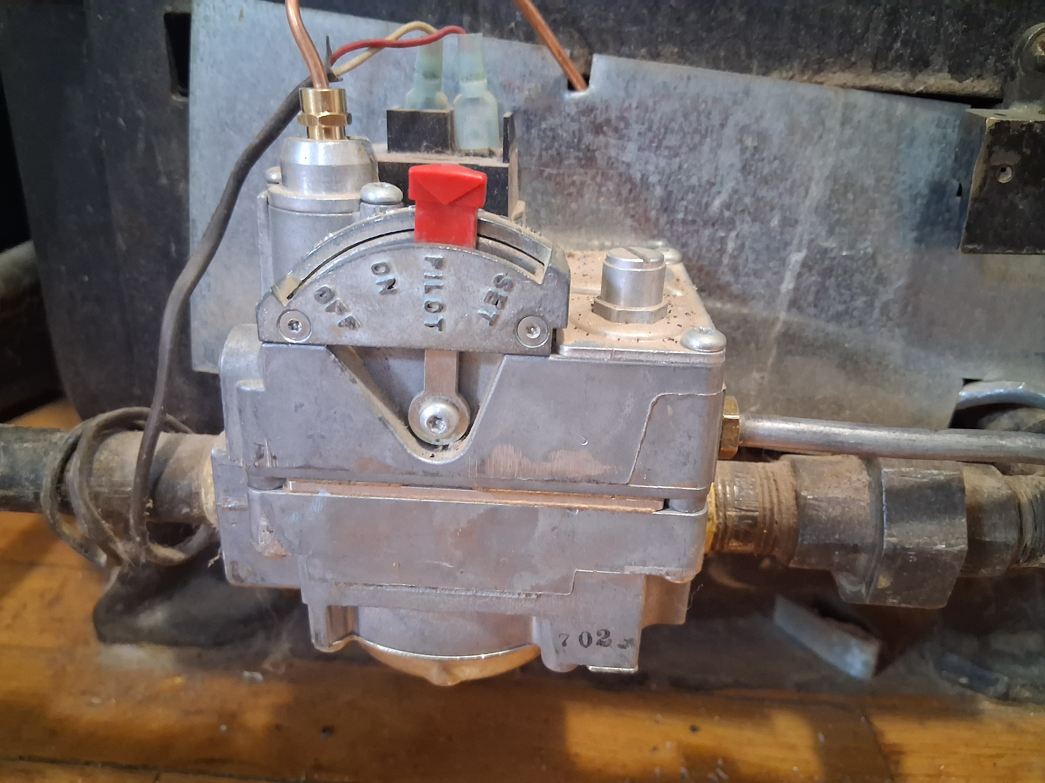

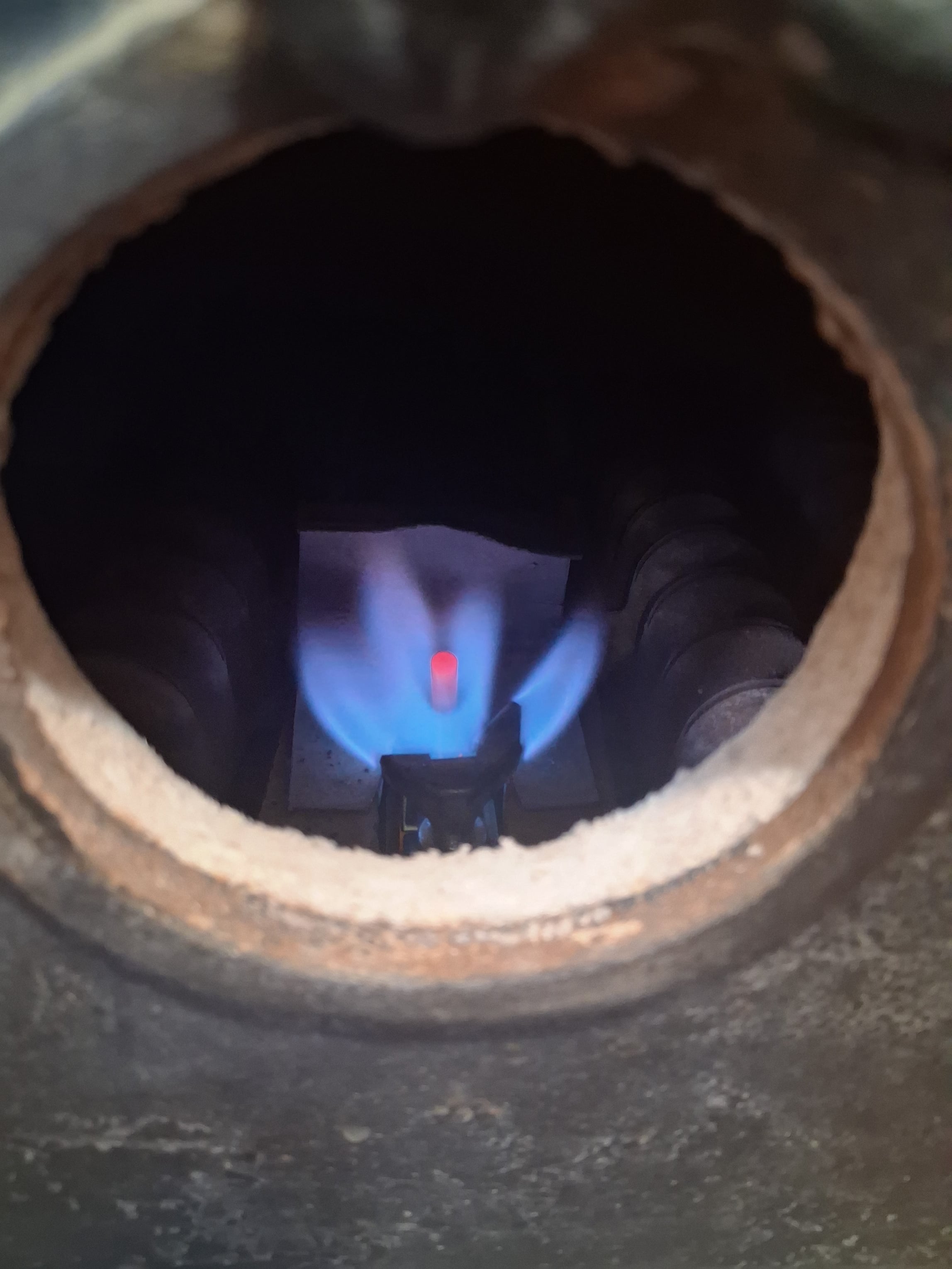

My neighbor's old gravity feed gas boiler has been running fine as long as I've known her.
A couple weeks ago the pilot went out. It would light and the boiler fire up again but go out after a minute or two (both pilot and main flames).
She has the thermocouple replaced, no improvement. Then she had the gas valve replaced with the same model (robertshaw). It worked for about 5 hours and then went out again. I dont think it's the thermostat because the pilot goes out as well.
She's had the same company (local plumbing) go out twice, each time with 2 different guys. After billing her 5 hours they can't figure it out.
Ideas? Thanks

    This is natural gas supply? Was the gas valve set up for NG or propane? Did they check the gas pressure at boiler ? Static pressure? dynamic pressure? I don't see a sediment trap in that piping? I wonder if the line is obstructed?
    rick in Alaska
    what is the line pressure when it goes out? sounds like it might be a bad service regulator or something like that.
  • 4GenPlumber
    4GenPlumber Posts: 176

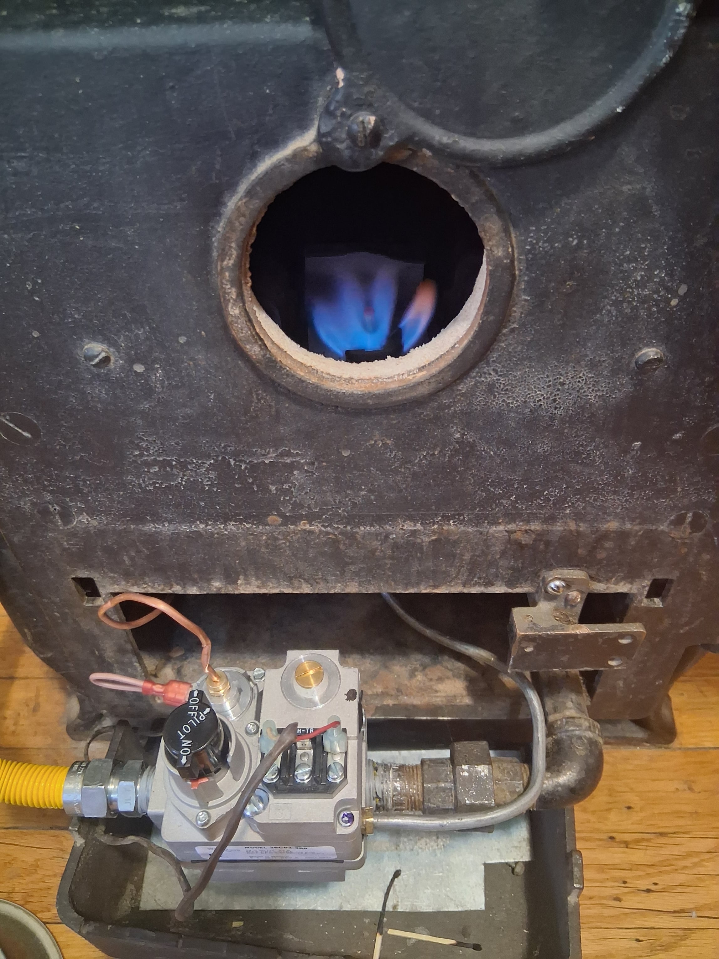

    That is beautiful. More info please. I assume the pic is the old gas valve, pic of the new?
    SuperTech

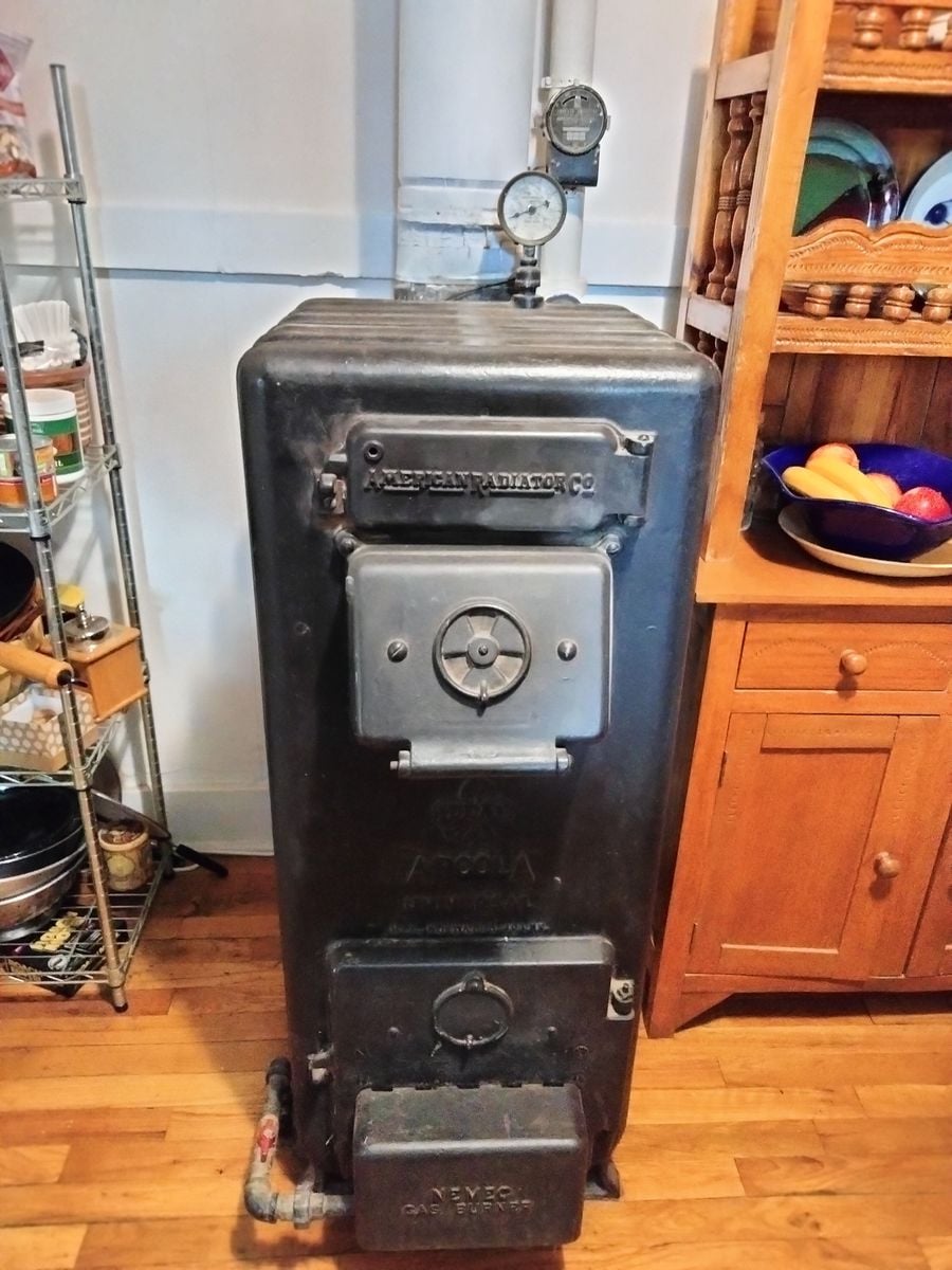

    Boiler on a wood floor?
    is that piece of sheet metal in front of the combustion chamber supposed to be there?
    bjohnhy
    109A_5 Posts: 4,759
    Restricted (contaminated) pilot orifice. Not enough pilot flame.
    if the pilot burner was clogged it would go out when it wasn't firing too.

    The combustion chamber is actually above that, behind the area with the central metal circle. Has always been there. Tomorrow I'll try lighting it after removing that sheet.

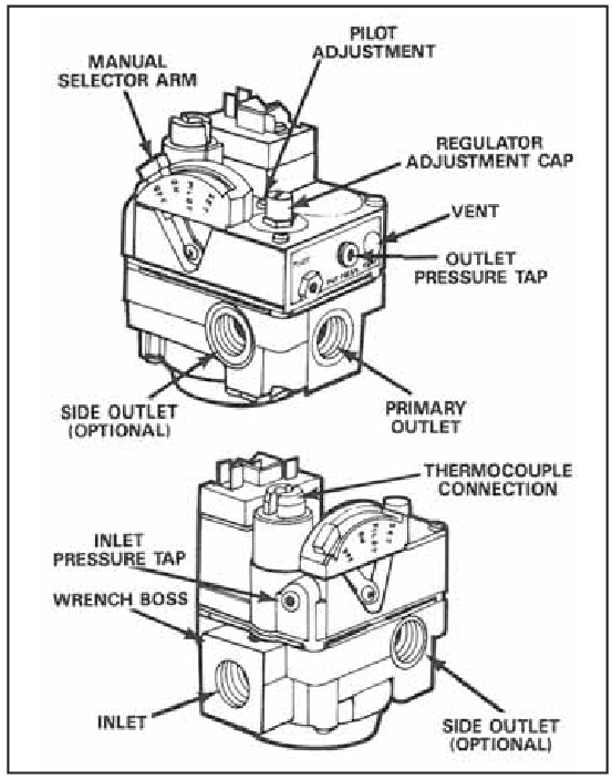

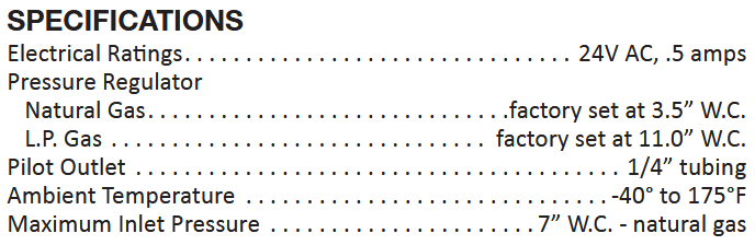

    I'd be curious about the inlet pressure during all modes of operation and when off.
    https://www.pscia.com/ASSETS/DOCUMENTS/ITEMS/EN/1-489.pdf

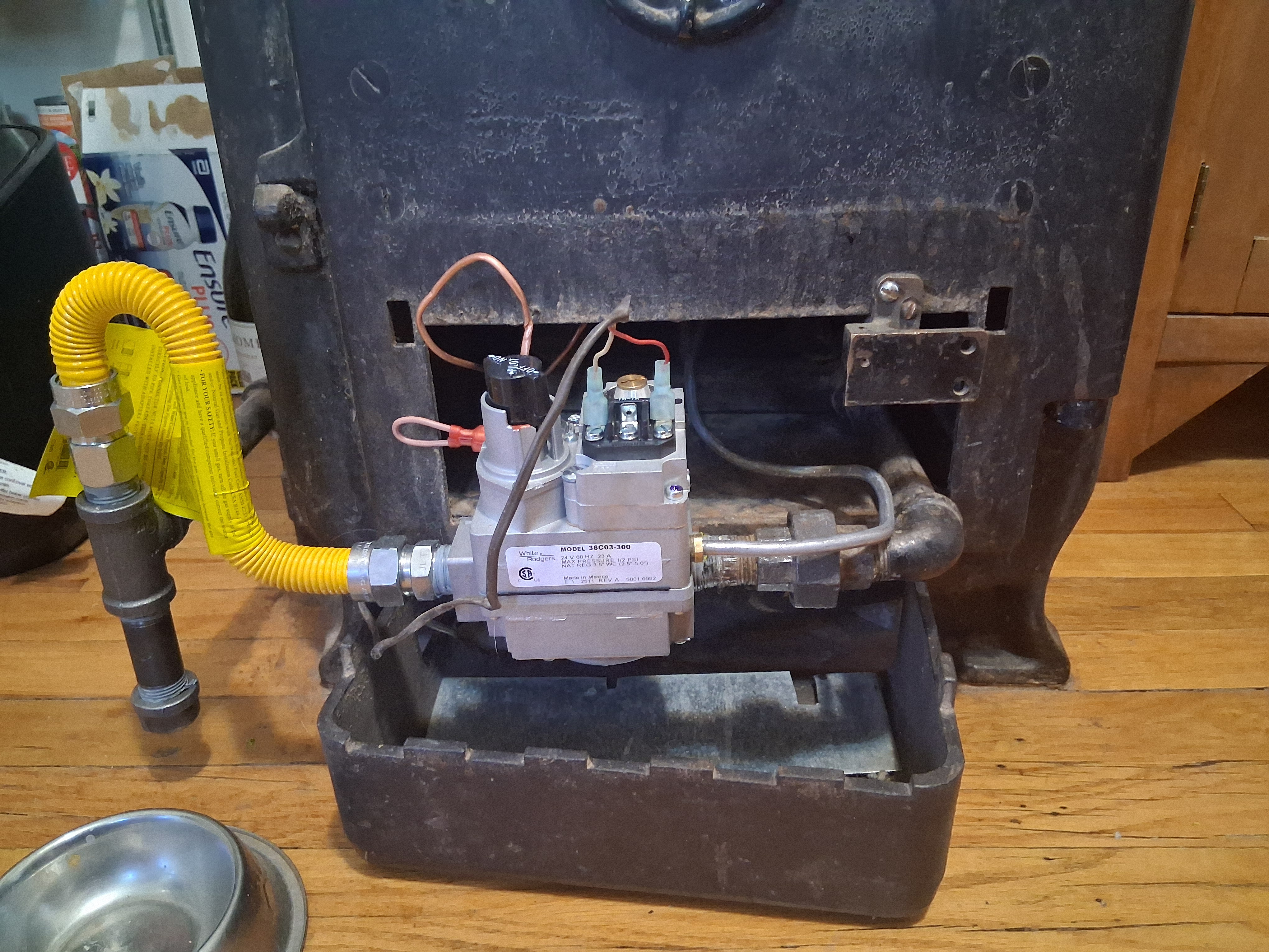

    Here are pics showing the new gas valve and pilot, which I've just lit, thermostat off. Will see if it stays lit until tomorrow

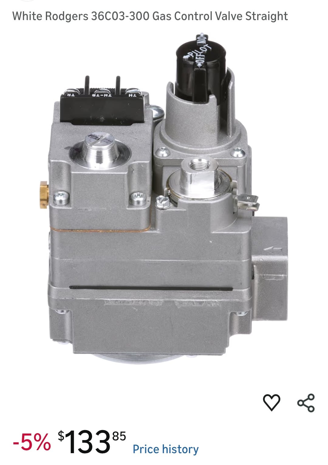

    At less than $150 they were, relatively, cheap parts. I would have done the same. Now she has spares :).
    Bryant 245-8, 430k btu, 2-pipe steam in a 1930s 6-unit 1-story apt building in the NM mountains. 26 radiators 3800sqf
    that combination valve alone is around $300-$500.
    unless the draft from the main burner is moving the pilot burner the issue isn't the pilot burner being dirty.
    those doors being the way they were when whoever replaced the valve adjusted the combustion is important to the combustion. They affect how much primary and secondary air the burner gets.

    Glad to see the gas piping was fixed and sediment trap added in. Although having a flex gas pipe exposed in middle of kitchen/pantry is not exactly safe. HOpe you are able to figure this out.

    Ok, so the pilot goes out on it's own after a few minutes, thermostat off. I lit it again and, just for kicks, turned the thermostat on. The pilot went out as soon as the burners fired up.
    The plumbers that installed the new control valve mangled up the, new, thermocouple pretty good. Would that affect it's performance?

    i'm surprised it works at all like that. that certainly would be the first thing i'd try although this doesn't explain why it was doing it with the old valve. does th pilot still go ou if you remove that piece of sheetmetal from the front of the conbustion chamber?
    when the pilot goes out does the safety valve in the gas valve close first or does the pilot go out then the valve closes? you should hear the safety valve click when it closes.
    guzzinerdPC7060
    109A_5 Posts: 4,759
    edited March 16
    I was about to mention it, I'm glad to see you caught the mangled thermocouple, running it over with the service truck a few times then installing it is not best practice.
    You may have multiple issues, I'd replace the thermocouple, see what it does, if it still acts up then measure the gas pressure at the inlet side of the gas valve in all modes and off.
    Maybe the original issue was ONLY a bad thermocouple, they changed it with road kill, and then thought the gas valve was bad. Too much bad repair technique IMO.

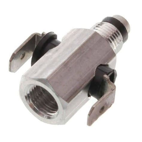

    What is the gas input side pressure of the gas valve doing ? Should be a test port there too.
    If you continuously hold the knob in pilot lighting mode (position), will the pilot run indefinitely ? If so try a new thermocouple.

    Actually, don't see an input port...edit.. is it this?
