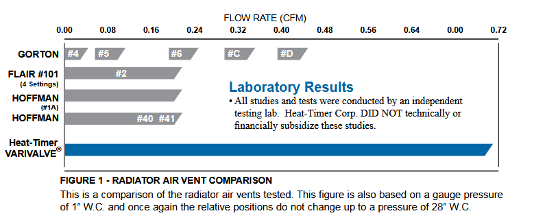

    @Captain Who Every year there are several discussions about vent valves and when Varivalves are mentioned there isn't much said about them not fully shutting off. I don't know how popular the Gill/Sajek report is to participants and the devil is in the details to find "truth" in the data tables.
    I created the venting chart several years ago when I was learning the hard way about balancing. I hope it is worthwhile to anyone looking at it, but it's not front page news.

    When I wrote that I had forgotten that their own website implied zero flow when fully closed. I'm sure it was a mistake by whoever designed that online brochure but it doesn't say much for the thoroughness of the company that it never got corrected.

  • Captain Who
    Captain Who Member Posts: 848
    They still didn't fix it. That chart shows a range of 0.0 to 0.80 CFM.
  • SteamingatMohawk
    SteamingatMohawk Member Posts: 1,119
    Duh, I was looking for words and completely ignored the chart. The Gill/Pajek report lists 0.065CFM at 1 oz pressure, see below. And there is plenty of space in the chart to show that as the minimum, instead of 0.0.
    Even us old guys can learn…if we pay attention. Thanks.
