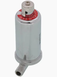

What brand of radiator air vent do you suggest/avoid ?
Here are two that I've heard mentioned:
925005-00 Angle VARI-Valve (Heat Timer)
Vent-Rite #1 VR1 VR-1 Adjustable Steam Radiator Vent 1/8″ Male 3 PSI

    I hate Vari-Valve
    I've never used Vent-Rite but some people seem to like them OK.
    I use Maid O Mist and sometimes Gorton
    Some people like Hoffman
    Just never buy any vent at a big box store. Buy them at supplyhouse.com is my recommendation

    On the cheap maid of mist ,bear in mind the quality has gone down from what i ve seen do not get from big box . Personally i use gortons yeah u may end up w a bad one but over all the better vent and if going adjustable possible hoffmann 1A

  • For fully adjustable vents we use Ventrite #1 almost exclusively. On a budget, we use Maid o Mist #4. #5, and In rare instance #6 (huge church size radiators and really screwed up condo systems) with removable orifices. We will use Gorton, #4, #5, #6 for people that are looking for higher quality fixed venting rates ( like in rentals) People tend to remove the orifice on the Maid o mists. Maid o Mist also makes fixed orifice type vents too.
    We like the ventrite because even when set for the highest setting, they are still a much slower vent than others…so a system is not thrown out of balance by excessive radiator venting. The Hofmann adjustable are not very repeatable….2 different vents set for the same number will vent at very different rates. …so we stopped using those many years ago. Anything that can vent real fast like the Maid o mist or Gorton C or Ds, and the Heat Timer varivalves (equal to 16 conventional vents) will tend to cause the system to go out of balance and/ or the radiator to spit.
    We also recommend people stay away from Big box store vents….we have seen several case (and others here have reported) seeing them split open. We had one condo building run into several thousand dollars of emergency repair calls for the boiler and then a unit owner came home from a vacation to find about 1/3 of thier unit totally destroyed by steam and water damage due to the vent splitting open.

  • @ethicalpaul @STEAM DOCTOR Why do you hate Vari-Valve brand?
    ethicalpaul Posts: 9,100
    it’s too fast, hard to adjust and spits if I recall correctly

  • Anyone need my bucket of failed Heat-timer Vari-Vents?
  • Fail by leaking ?
  • Long Beach Ed
    Long Beach Ed Posts: 1,851
    edited October 2024
    No, the Heat-timers fail closed when the bellows deforms and dismounts from the cap, fouling the orifice it controls. About 25% of several hundred did this in the 18 months. A nice loss for us.
    A well-made valve with a flawed design.
  • Long Beach Ed
    edited October 2024
    We loved them at first for our properly piped jobs with dry steam. Then the calls began coming. Removed them from probably 40 jobs, again and again. Eventually we'll probably revisit every job. Call backs every month.
    When they work they are silent, very fast venting and slow closing, which use some water. Many fail and remain closed.
    Opened some and found the problem. Shared an engineers' report with the manufacturer. We really wanted them to work reliably. They're little beauties — with a flaw.

    These are cjinese lmpckoffs os a once viable ventgave a history not really being adjustable and having a bad reliability reputation They used to be dirt cheap but I see they are now asking a premium, pride - I recommend staying away from them.
    I've used maid o mist and had good luck with them (no failures in a decade or so). Recently there has been talk of reliability problems of both maid o mist and gorton; the gprton's cost a lot more for no apparent reason - make sure you buy either from someone who accepts returns. Heat timer Varivent are getting a bad rep on reliability, zero quality control.
    Hoffman makes reliable vents but some have problems with them on systems with long tadiator runouit pipes.
