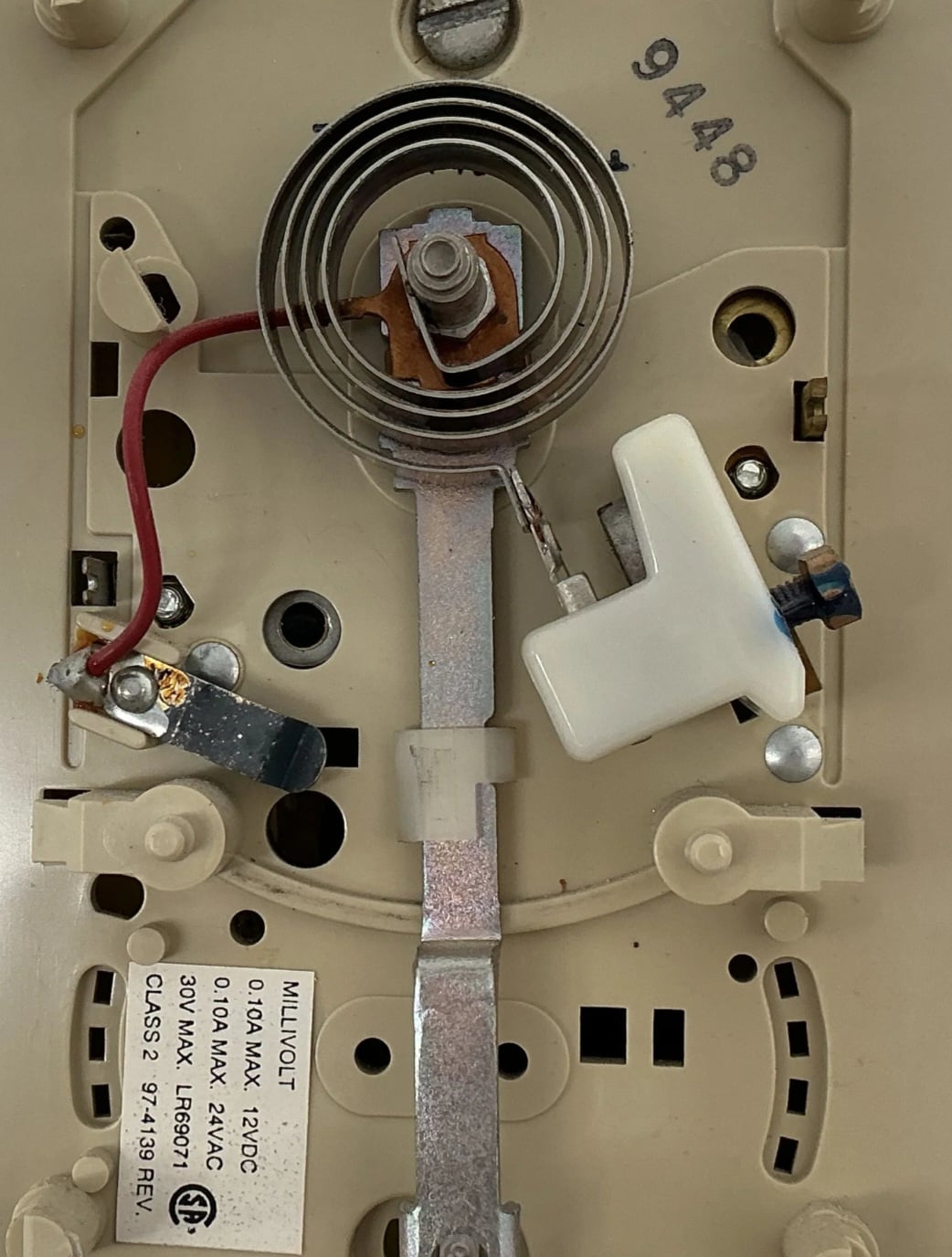

    Maybe you need to take the cover off and adjust the anticipator setting. Is this a mercury thermostat? IIRC they have a variable resistor heating element near the mercury glass bulb that heats up the bimetallic coil. If that is set to a slower heating setting the burner should run longer.
  • geemalar
    geemalar Member Posts: 99
    edited February 28
    Unless I’m missing something it appears to be an on / off style thermostat. Nothing in the way of additional setting capabilities other than the temperature. Or is the screw on the white L shaped portion it……….i thought that was just a micro adjustment of the metallic spring
  • Captain Who
    Captain Who Member Posts: 883
    edited February 28
    That looks like a snap switch type with no mercury and no anticipator (or at least not an adjustable one). Typical adjustable anticipator heater would draw too much current for a "millivolt" thermostat. This one was designed to be powered by a thermopile only. Date code may be 48th week of 1994.
    I think that varnished adjustment screw is just for factory calibration of the switching temperature.

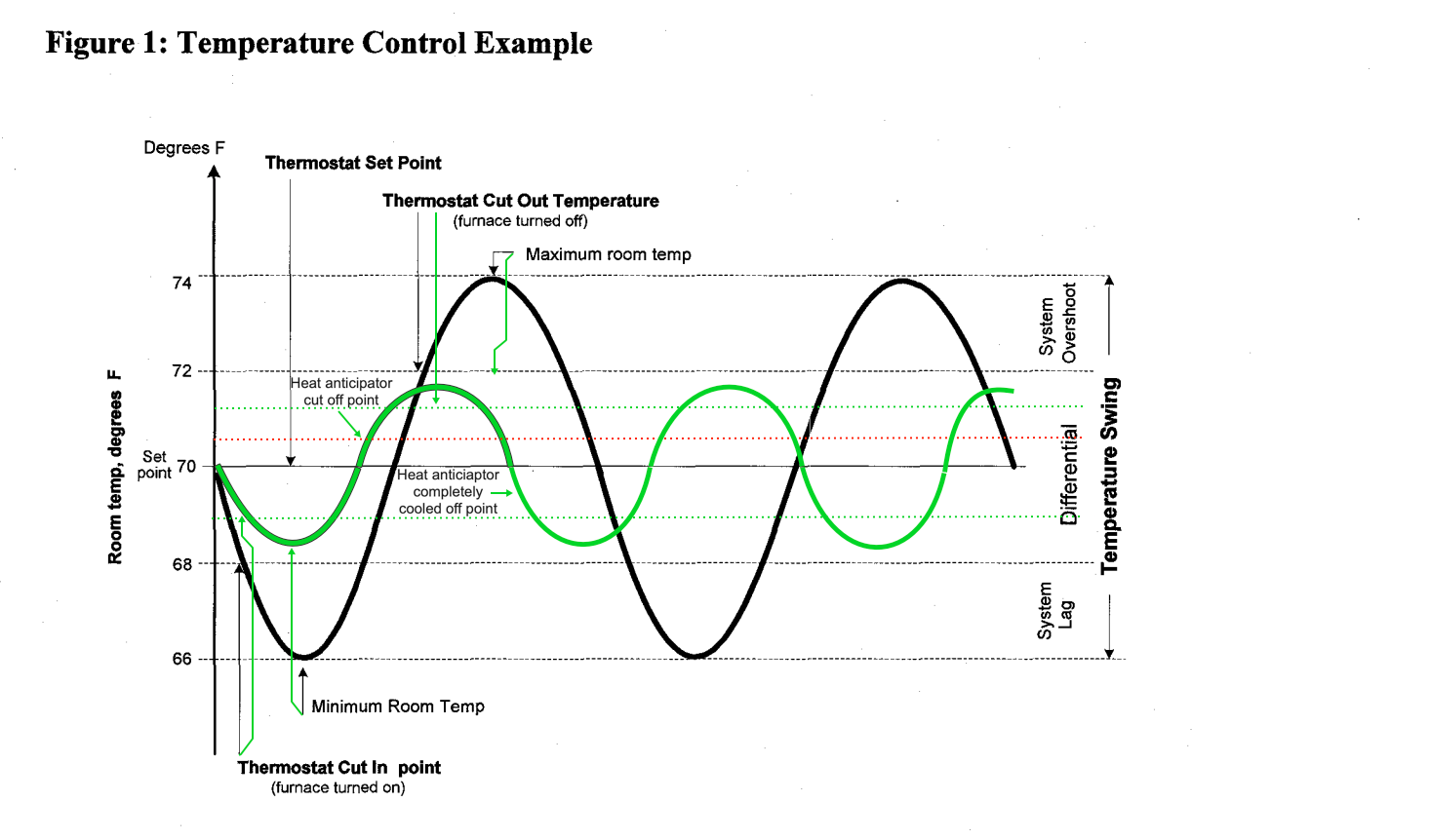

    I think you are asking how the existing thermostat that is not equipped with a heat anticipator is causing the longer off time as part of the cycle.  If I have misread that, I apologize but I will answer that question.
    When you do not have a heat anticipator to turn off the burner early, you can get large temperature swing as shown in this graph
    When adding a heat  anticipator and tightening up the thermostat differential to about 1.5° to 2° you end up with a room that stays within the comfort zone of the thermostat setting. As shown in this graph overlay in green.
    If not properly set to match the controls connected to the thermostat equipped with the heat anticipator, that can happen.  In other words if the heat anticipator gets the thermostat too hot too quickly and the call for heat stops too soon, then the room temperature may not get high enough to allow the room temperature to rise above the cut out temperature.  This will cause the thermostat to short cycle off of the heat anticipator.
    This happens when a thermostat equipped with a heat anticipator is connected to Taco 570 series zone valve.  That valve draws a full amp or more of power from the 24v thermostat and overheats the bimetal causing the call for heat to stop before the room gets any heat from a baseboard radiator.  Then you find that the zone valve opens and closes about 2 times every 5 minutes  and the room never gets enough heat.   (ask me how I know this?)

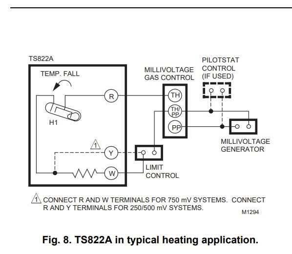

    Here's a TS822A with mercury switch where I think the anticipator is visible and attached to the white wire and looks burnt up

    @SteamingatMohawk , under the white piece is the load side contact of the thermostat.
    The Red wire connects to the metal coil. The coil expands and contracts with the temperature and moves the White plastic piece to make or break the circuit. The White wire is under it.
    The coil design isn't very accurate at keeping even temperatures. Its usually good for at least a 2° swing. That painted screw in the plastic piece looks like some kind of adjustment screw. But I'm not gonna touch it.

    Hard to find info. on the snap switch TS819 but the TS822A mercury switch one was also for millivolt only use and it shows a non adjustable anticipator resistance in this diagram. I'm "assuming" the TS819 had one as well
    https://cdn.designair.com/Resources/HNYWLLE09863_1-5.pdf

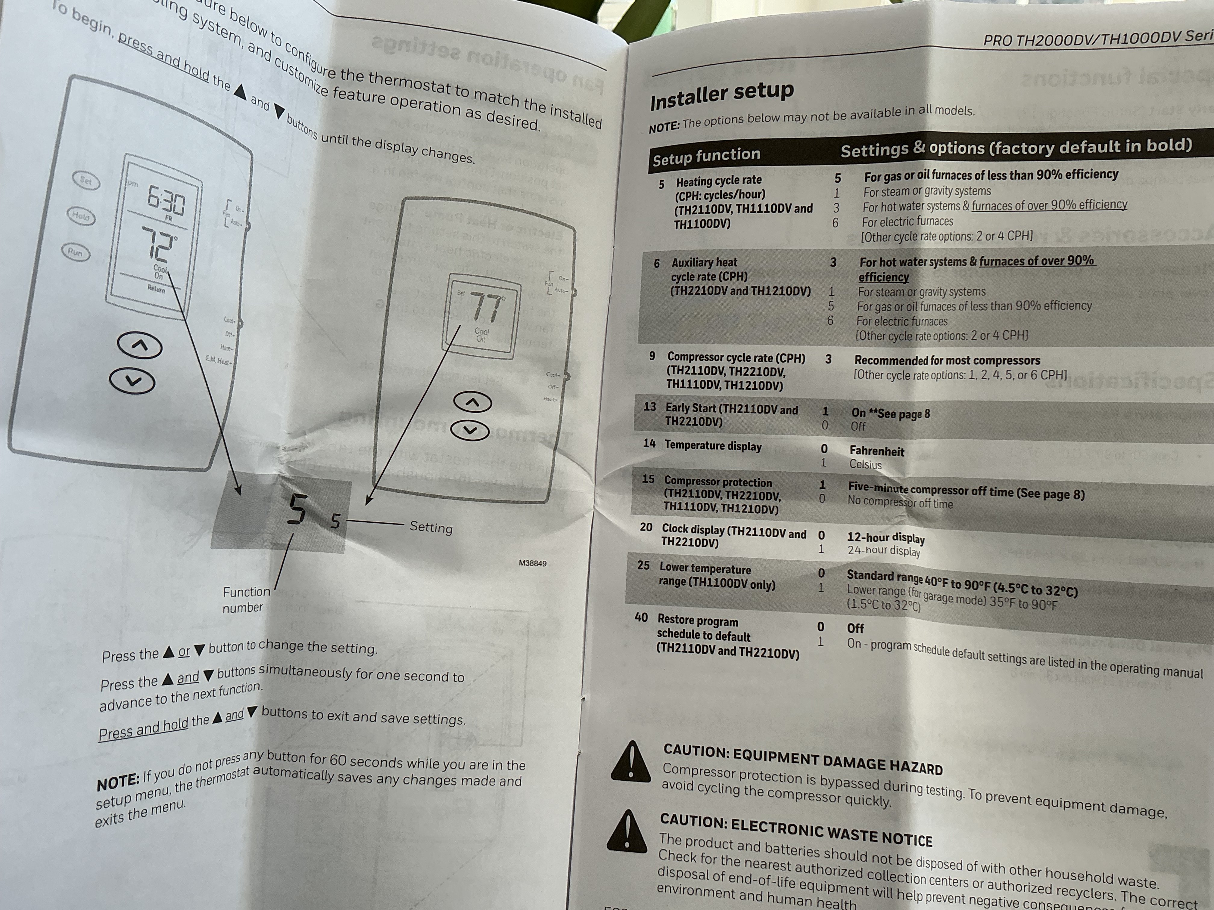

    So just wanted to report back on this………installed a Honeywell TH1100 DV non programmable heat only vertical thermostat about an hour ago. Heat appears to run continuously longer than previously. Doesn't appear to short cycle like it did before. I had to eventually shut it off as it's finally warmed up here in northern NJ. I'll keep an eye out on it tonight when it gets back down into the 30's.
    There was a previous mention of setting this thermostat to one cycle per hour……I just want to make sure that in setup function #5 I need to have it set to setting number 1 for steam and gravity systems. I just want to make sure it's set correctly.

    Yeah use 1 or maybe 2 if that is an option. Try 1 and if it feels cold before it fires again bump it up to 2.
    Steamhead Member Posts: 18,489
    I find if the system is well vented, 3 works well. Not all thermostats have an option for 2.

    the lower the cph is the slightly more efficient it will be but it isn't much. i wouldn't freeze at one to have an extra $500 when i die if it doesn't have enough mass to keep the heat even at 1.
  • geemalar
    Can someone please explain to me the CPH strategy………I currently have the thermostat set to 1. Does that mean the system will only cycle a maximum of one time per hour? Im trying to understand how the CPH functions in relation to the system.
