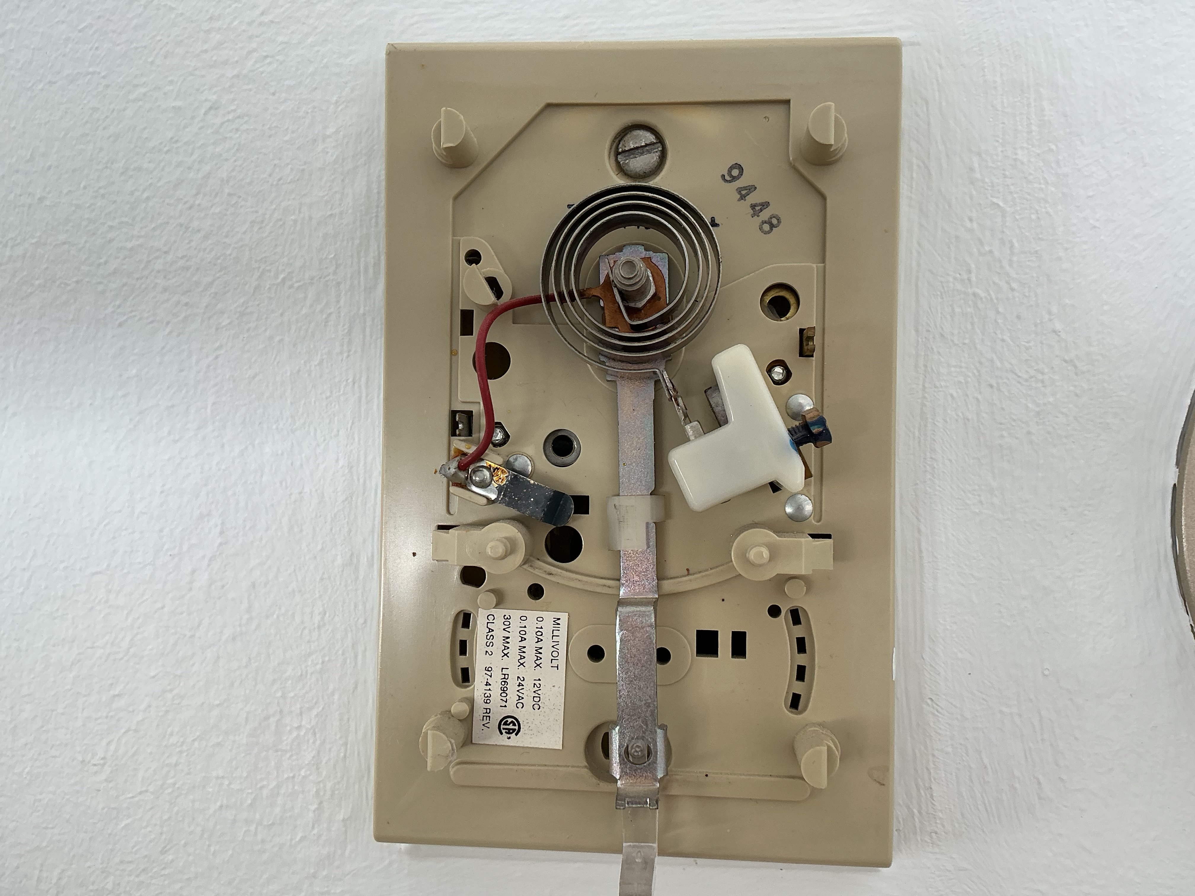

    Apologies on any confusion on what I stated………to clarify:
    My heat seems to be fine, the house is mostly comfortable. The pressure is typically low, so low that I don’t think the system is ever shutting off from the Ptrol registering significant pressure except when it’s really cold out. It seems to be shutting off by the thermostat. But I’m just wondering if the thermostat is cycling the system too often. The system will run, I’ll get little heat from the 2 closest radiators to the thermostat and then shut down. 5-10 minutes go by and the system cycles again.
    Heres what I currently have………..been here for the 25 years I’ve been in this house. Maybe I’m over reacting and everything is working fine. I just wanted to be sure the cycling of the system was ideal. From what I’ve read here, longer cycles are ideal. Maybe the cycling its running at is normal and I’m just over thinking it.

    Maybe you need to take the cover off and adjust the anticipator setting. Is this a mercury thermostat? IIRC they have a variable resistor heating element near the mercury glass bulb that heats up the bimetallic coil. If that is set to a slower heating setting the burner should run longer.

    Unless I’m missing something it appears to be an on / off style thermostat. Nothing in the way of additional setting capabilities other than the temperature. Or is the screw on the white L shaped portion it……….i thought that was just a micro adjustment of the metallic spring

    That looks like a snap switch type with no mercury and no anticipator (or at least not an adjustable one). Typical adjustable anticipator heater would draw too much current for a "millivolt" thermostat. This one was designed to be powered by a thermopile only. Date code may be 48th week of 1994.
    I think that varnished adjustment screw is just for factory calibration of the switching temperature.
    Do you have a millivolt boiler or is there a 24V transformer?
    You definitely need a more sophisticated thermostat.
    Hmm. No, that's one of the REALLY simple thermostats! And, in my view anyway, your "on" cycles are a little short for steam — and a little frequent. Again, in my view, you might be well served to replace it with almost any one of the battery powered modern digital ones — they're available Amazon of at the Big Box home stores. It would take the same two wires, but they do need a battery (there are ones which don't — but with just two wires your life will be much simpler with a battery powered one) and is easy enough to hook up.

    Jamie Hall had selected a thermostat that is compatible with a millivolt gas valve system. You should post a photo of the gas valve that operates the burner. If you have a millivolt gas valve operating your steam boiler, you have a power failure proof heating system. You do not need electricity from the grid to operate that boiler.
    That said, you must replace that thermostat with one that is compatible with 750 millivolt systems. If you use a 24v. thermostat, there is a possibility that the thermostat contacts will have too much resistance to reliably make the connection on every heating cycle. That could leave you with no heat at times until you cycle the thermostat to reestablish the contacts (off then on)
    If, however, you have a different system, and that is the old thermostat from a previous boiler, then that is the wrong thermostat for your system, and that may be the problem with your system cycling problems.

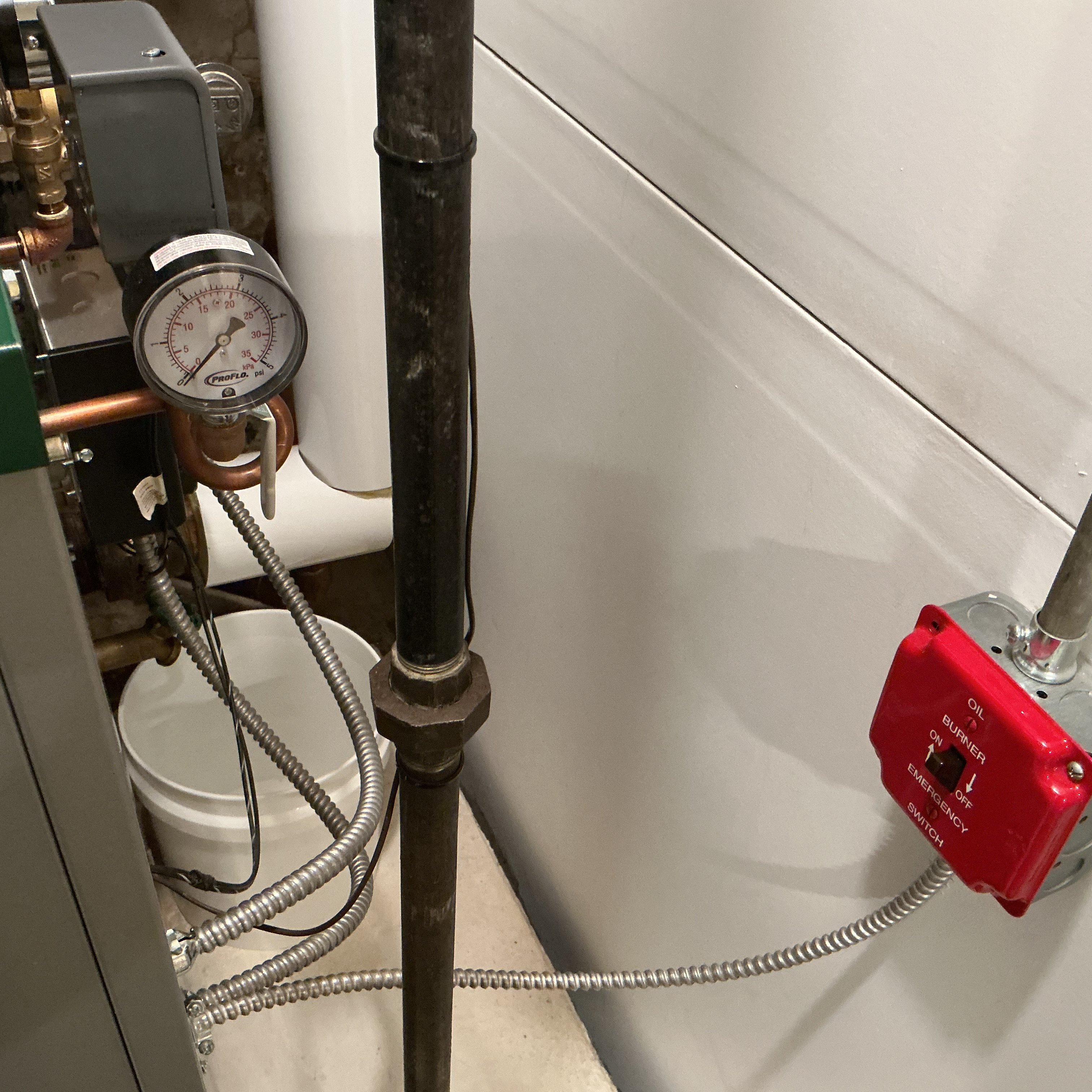

    Here’s a picture of the power to the system…..if I need to take a picture of the gas valve that will have to be tomorrow.

    That boiler looks brand new. It couldn't be a millivolt gas valve and you have AC power to the boiler. That thermostat you have has a snap switch in it where the contacts are only rated for 100mA at 24VAC. It is probably in series with controls that are drawing far more than that, unless it is just driving a relay. If it is driving a relay that relay itself may draw more than 100mA.
    We would need to see the circuit diagram.

    @geemalar Said: "It’s as if it’s cycling on its own, the heat isn’t sufficient enough to trip the thermostat. But it must be the thermostat as the system hasn’t generated any pressure to trip the Ptrol."
    With the photo of the boiler having a power switch connecting it to the 120v. house power I know exactly what your problem is.
    You have the wrong thermostat. that thermostat is from the older boiler that your existing boiler replaced. You can not expect a millivolt thermostat heat anticipator to operate properly when 24 VAC is applied to that thermostat. You need a different thermostat. Just about any thermostat rated at 24 VAC will do what you need without the short cycles you are experiencing with the T822? thermostat you have now.
    Replace the thermostat and set it to 1 cycle per hour and see of that solves your problem. This would be a good one to try: https://www.supplyhouse.com/Honeywell-Home-TH1100DV1000-PRO-1000-Non-Programmable-Heat-Only-Vertical-Thermostat

    pretty sure new peerless's usually come with a cyclegard type lwco that stops the burner every x minutes to check the water level. they can be wired 2 ways, one to start the timer when the burner starts firing, and the other is for the timer to continuously run with no information about when the burner is firing. it sounds like yours is wired to do the latter so it might get to its 10 or 15 or 20 minute count 2 minutes after the burner stared.

    I think you are asking how the existing thermostat that is not equipped with a heat anticipator is causing the longer off time as part of the cycle.  If I have misread that, I apologize but I will answer that question.
    When you do not have a heat anticipator to turn off the burner early, you can get large temperature swing as shown in this graph
    When adding a heat  anticipator and tightening up the thermostat differential to about 1.5° to 2° you end up with a room that stays within the comfort zone of the thermostat setting. As shown in this graph overlay in green.
    If not properly set to match the controls connected to the thermostat equipped with the heat anticipator, that can happen.  In other words if the heat anticipator gets the thermostat too hot too quickly and the call for heat stops too soon, then the room temperature may not get high enough to allow the room temperature to rise above the cut out temperature.  This will cause the thermostat to short cycle off of the heat anticipator.
    This happens when a thermostat equipped with a heat anticipator is connected to Taco 570 series zone valve.  That valve draws a full amp or more of power from the 24v thermostat and overheats the bimetal causing the call for heat to stop before the room gets any heat from a baseboard radiator.  Then you find that the zone valve opens and closes about 2 times every 5 minutes  and the room never gets enough heat.   (ask me how I know this?)

    I think it is a TS819A (or TS819 with no dual needle/thermometer?) because those didn't have the mercury switch. It probably has a fixed anticipator somewhere that isn't easily seen, just like in the TS822A which was a mercury switch model.
    I still wonder why it ran for 2 minutes, switched off for an hour, when obviously it wasn't enough time for the room radiators to even get steam, although if the pipes in the basement are uninsulated that heat could've made it's way into the thermostat room.
    I get that this is not to be used with 24VAC and 750mV or less only and 24VAC will heat the anticipator too fast, causing early burner shutdown. It seems like it would normally behave more like he earlier described with lots of cycles close to each other where it didn't shutdown for very long between the short burner on runs.
    Maybe since it is only rated for 100mA it is simply drawing so much current that the contacts have become damaged and is acting flaky.
    https://www.ebay.com/itm/186426380376
    Here's a TS822A with mercury switch where I think the anticipator is visible and attached to the white wire and looks burnt up

    @SteamingatMohawk , under the white piece is the load side contact of the thermostat.
    The Red wire connects to the metal coil. The coil expands and contracts with the temperature and moves the White plastic piece to make or break the circuit. The White wire is under it.
    The coil design isn't very accurate at keeping even temperatures. Its usually good for at least a 2° swing. That painted screw in the plastic piece looks like some kind of adjustment screw. But I'm not gonna touch it.
    is that anticipator free or does it have an anticipator that works on millivolt or 24vac if the 24vac is under 100 ma? the common fan center they use for isolation of newer boilers has a relay that draws about 375 ma so that would cause the anticipator to end the cycle very early if that is what it has.

    So just wanted to report back on this………installed a Honeywell TH1100 DV non programmable heat only vertical thermostat about an hour ago. Heat appears to run continuously longer than previously. Doesn't appear to short cycle like it did before. I had to eventually shut it off as it's finally warmed up here in northern NJ. I'll keep an eye out on it tonight when it gets back down into the 30's.
