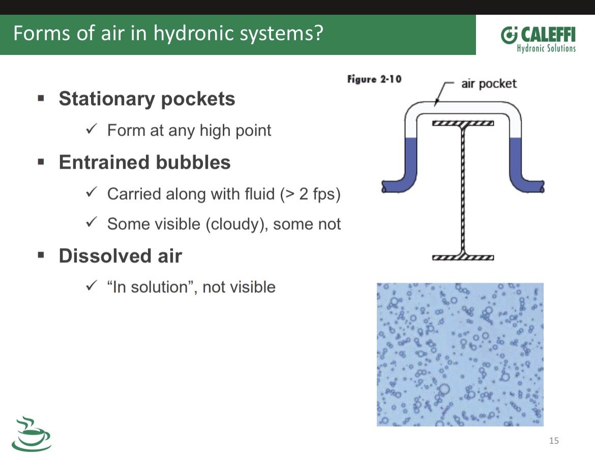

if you look at piping examples of gravity systems the piping always slopes up to the radiators. This also helps the purging as the air rises into the top of the pipe and up into radiator , any droops or low points in the piping, or changes that created high points will make it much harder to purge.

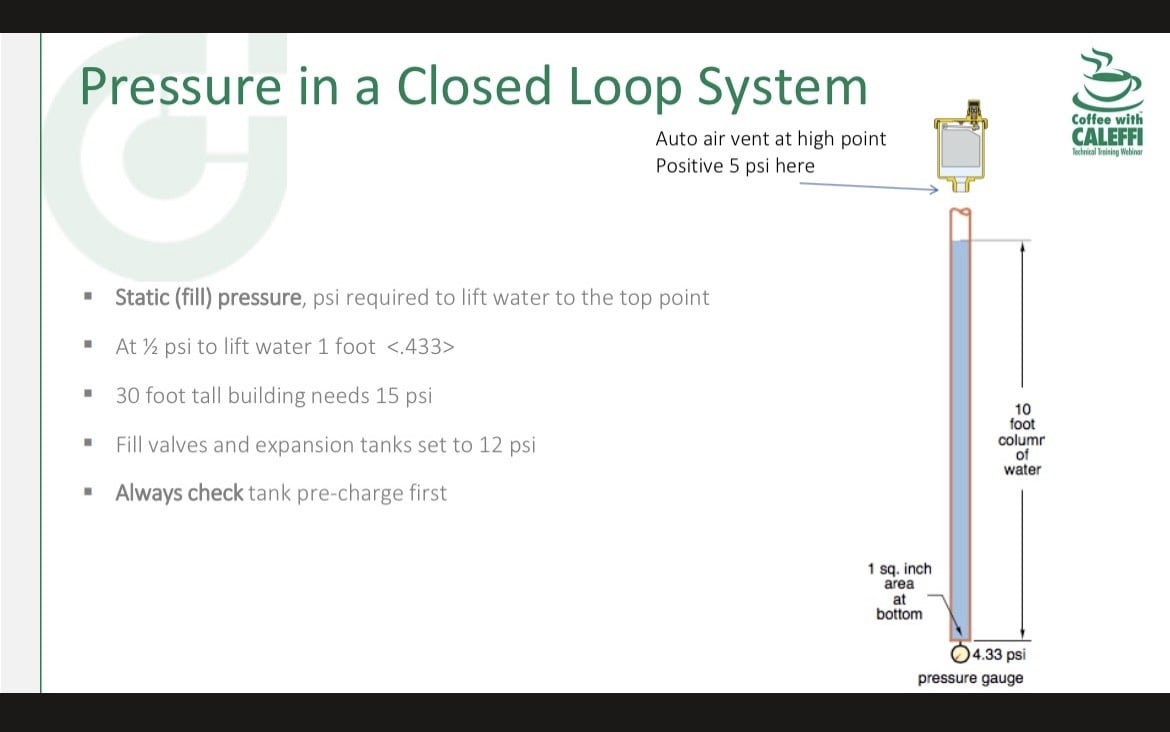

Boosting fill pressure is another trick to help expel air, you always want 5 psi at the highest point in the system. Boosting fill for a few hours to maybe 20- 25 psi basically squeezes the bubbles smaller and can assist the bubbles to move with the flow.

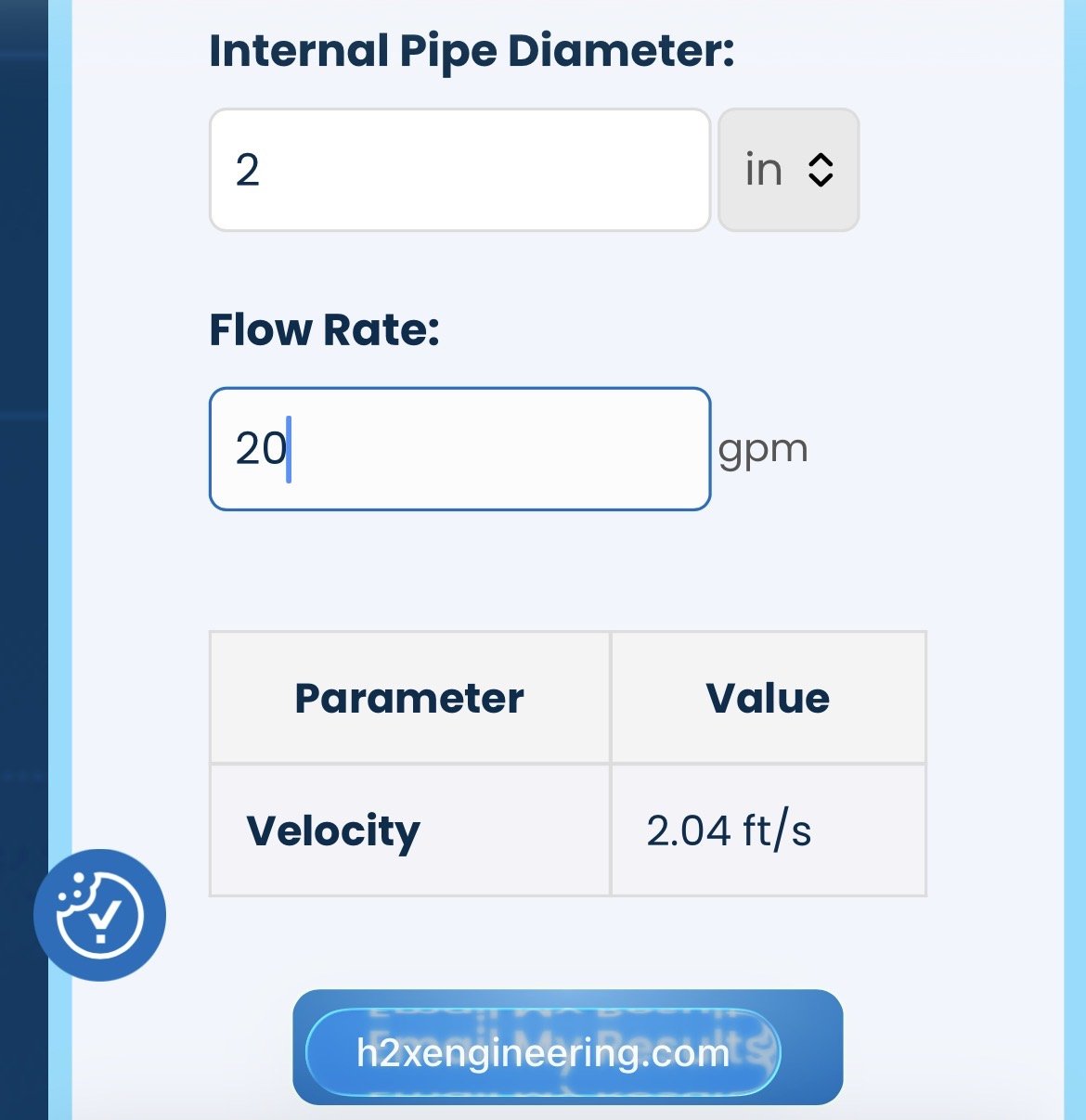

You need 2 fps velocity for air to move along with the water. In 2” pipe you need about 20 gpm. Here is an online calculator for gpm/ fps calculation
