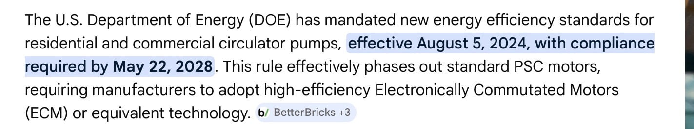

    2028 is when all circs will be ECM, that is why you see the manufacturers stepping up their ECM product offerings. The U.S. may be one of the only places where PSC are still being used.
    1/3 of all electrical energy consumed in the world spins a pump, of some sort. So reducing that consumption by at least 50% with ECM technology could be a big deal.
    Although AI server farms, giving us instant answers like this, will gobble up that savings I imagine😏
