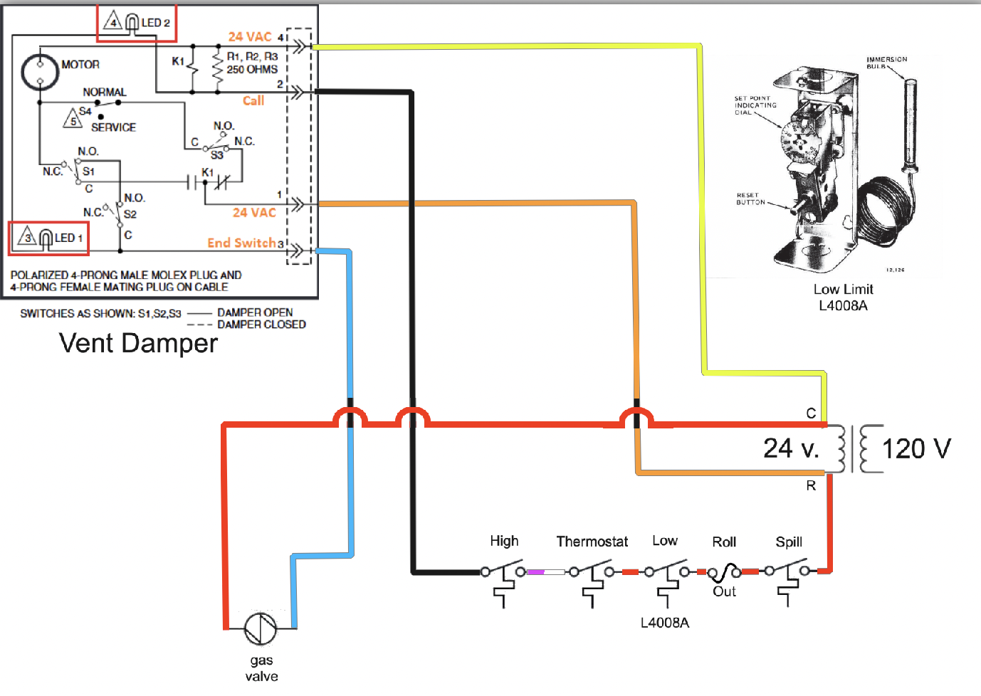

I recently purchased a building with a 250.000 btu Slat Fin Galaxy cast iron gas fired boiler installed in 1994. during demolition of the building the low level aquastat was accidentally removed (it was located outside the mechanical room). When we went to fire up the boiler this winter it was apparent something was missing and a new Resideo model L4008A was installed along with a new temp/pressure gauge. Because the previous immersion probe was seized in the well tube and we didnt have a new one on hand, we installed the immersion probe to the side of the hot water supply line and wrapped with insulating tape. I have the high limit aquastat set to 180 and the low level set to 160 with a 20 degree differential. The boiler has never reached 180 and the low level aquastat never seems to call for heat when the water temp dips down, sometimes nesr 120 degrees.
THE BOILER ONLY FIRES WHEN THE THERMOSTAT CALLS FOR HEAT, NEVER WHEN LOW LEVEL TEMP DIPS BELOW DESIRED TEMP.
Im hoping the issue is becuase i have an immersion style aquastat probe not properly installed inside the well. however i still feel like the low level shouuld be calling for heat, even if its not accurate.

    What does it say on the inside of the cover? There's only 2 terminals, so its SPST. If it says "R-B opens on temperature rise" then you've got another High (A) Limit. You need a B Limit. An L6008B might work. You could also get an L6006C strap on if its feasible.
    EdTheHeaterMan Member Posts: 11,992
    This is your wiring diagram to the best I can see from the pictures:
    There is no control that will operate a circulator. So I guess that is constant operation.   The operator or low limit, the high limit, all the other safety switches,  and the thermostat need to be closed (turned on) for the vent damper to operate.   Any one of them opening will keep the vent damper closed.   Once the vent damper is open and the end switch inside the vent damper closes to indicate the damper is open, then the gas valve will get power to operate the burner.
