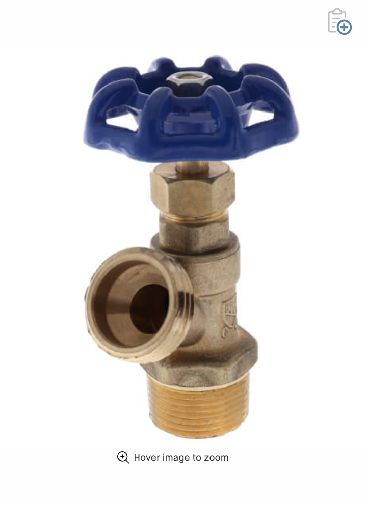

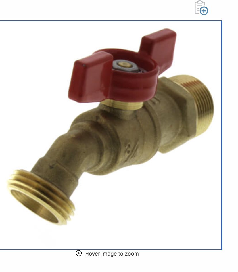

    1. I see 2 types of boiler drains that could work. Is one preferred over the other? See pics.

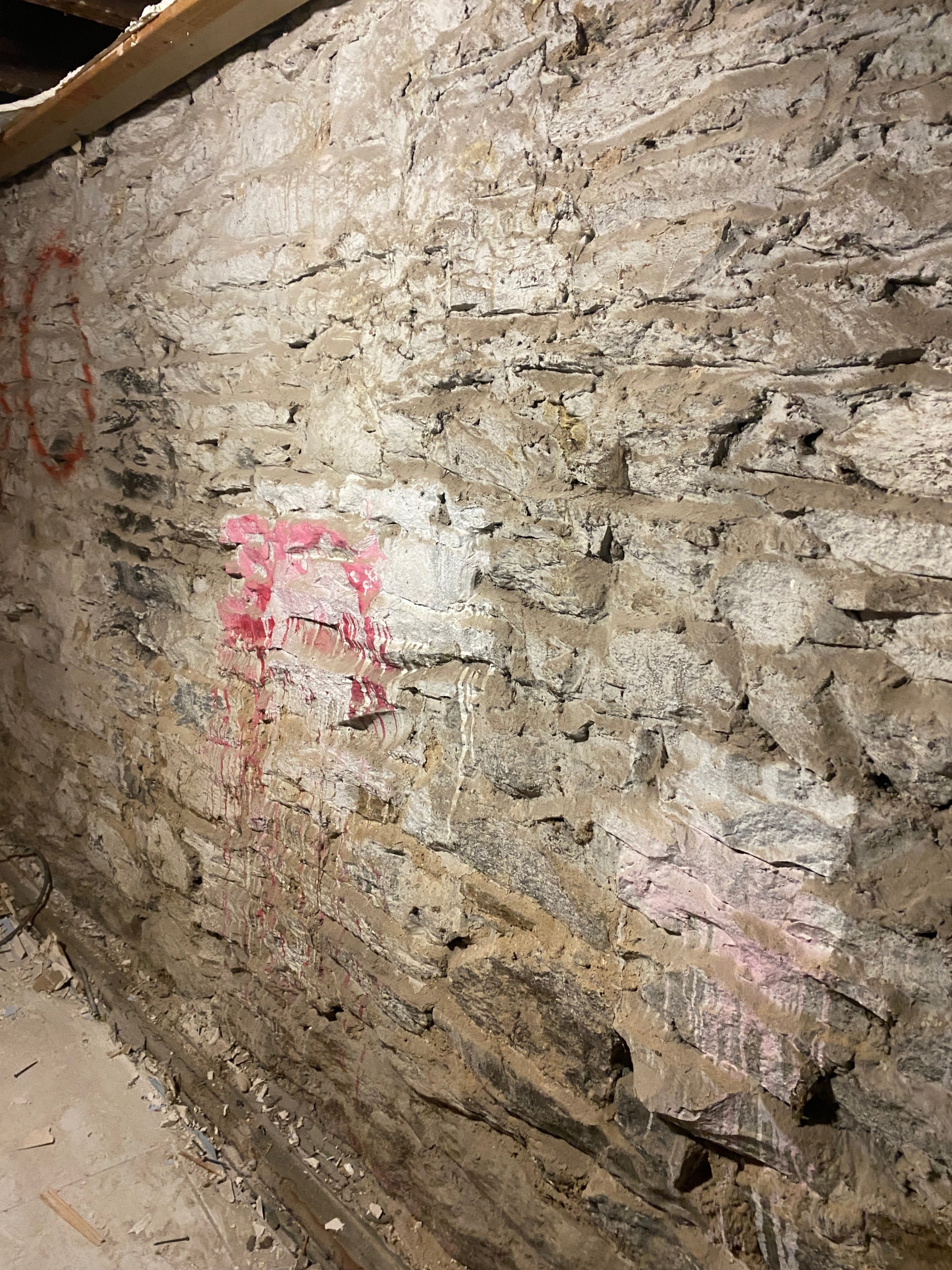

    2. Supporting the pipe. How far should I space my supports? I have an old stone wall, which will be difficult to drill into I'm guessing. Here are some support ideas
      1. Install 2x3 on the walls with tapcons and then use split ring hangers to support horizontally.
      2. use split ring hangers and attach to joists overhead. I'll need a lot of threaded rod but will be MUCH easier.

    Jamie Hall Member Posts: 27,572
    How high off the floor do you want that pipe? If it were mine, first I'd do it in copper — mortar is kind of tough on black iron, but copper doesn't mind — and second I'd set it a brick or two off the floor and support it every 10 feet or so. On bricks. Slope isn't relevant for wet returns.

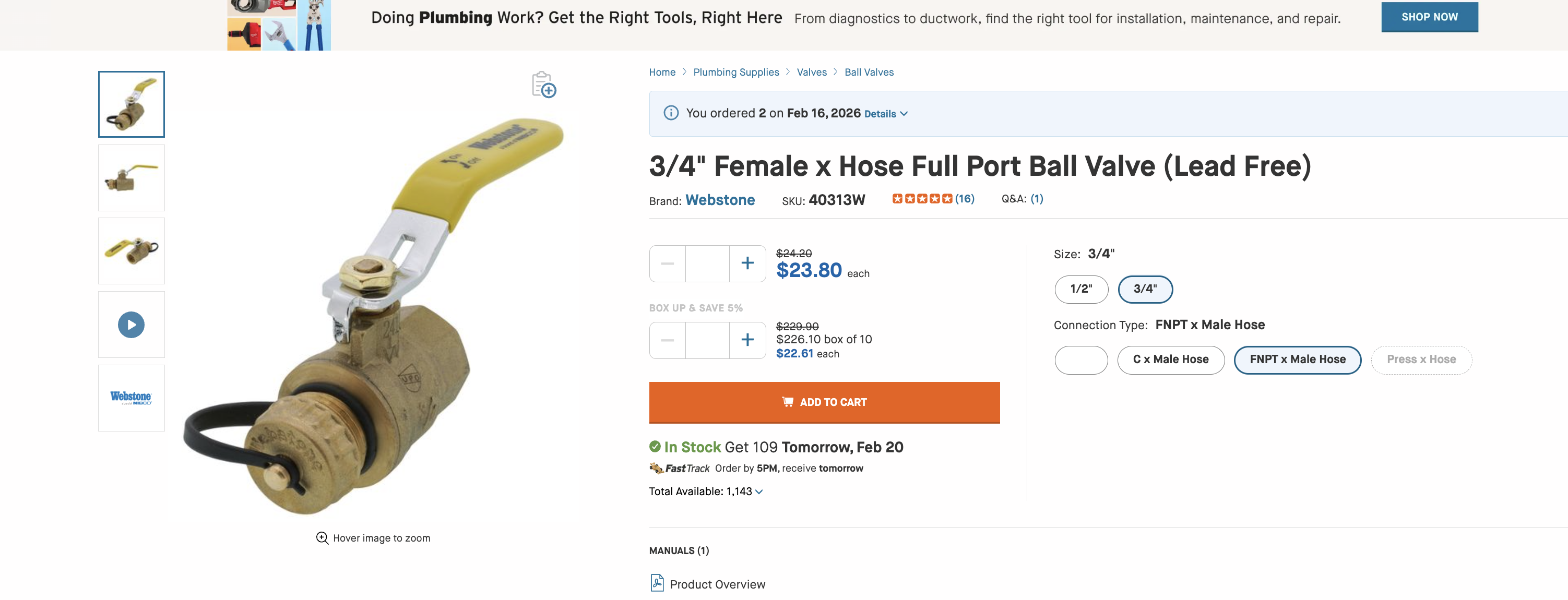

    I like to use this type of boiler drain because it is full port and built a bit better than most:
    https://www.supplyhouse.com/Webstone-40313W-3-4-Female-x-Hose-Full-Port-Ball-Valve-Lead-Free
    I would use a threaded version so if the valve fails it is easy to replace it.

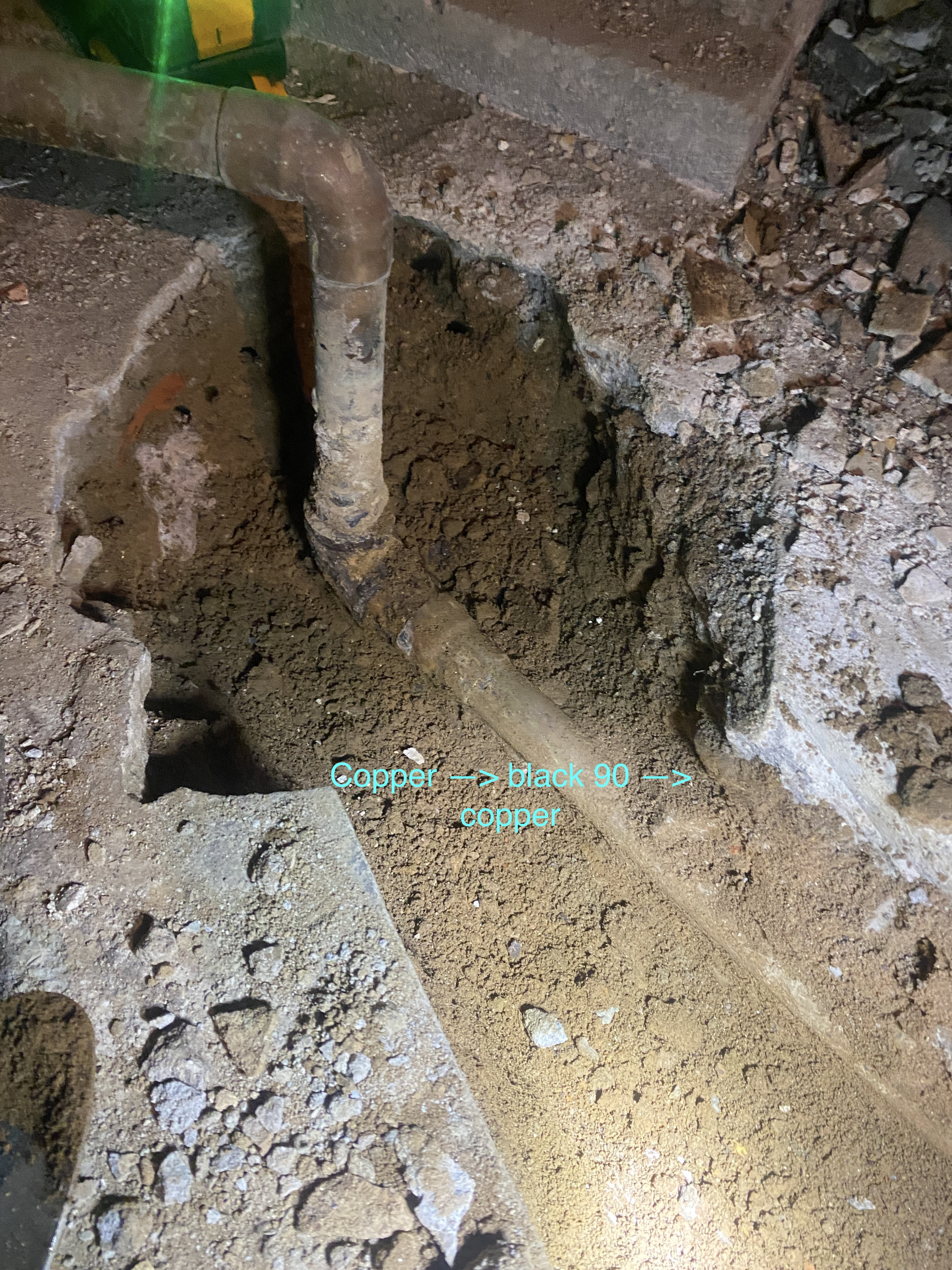

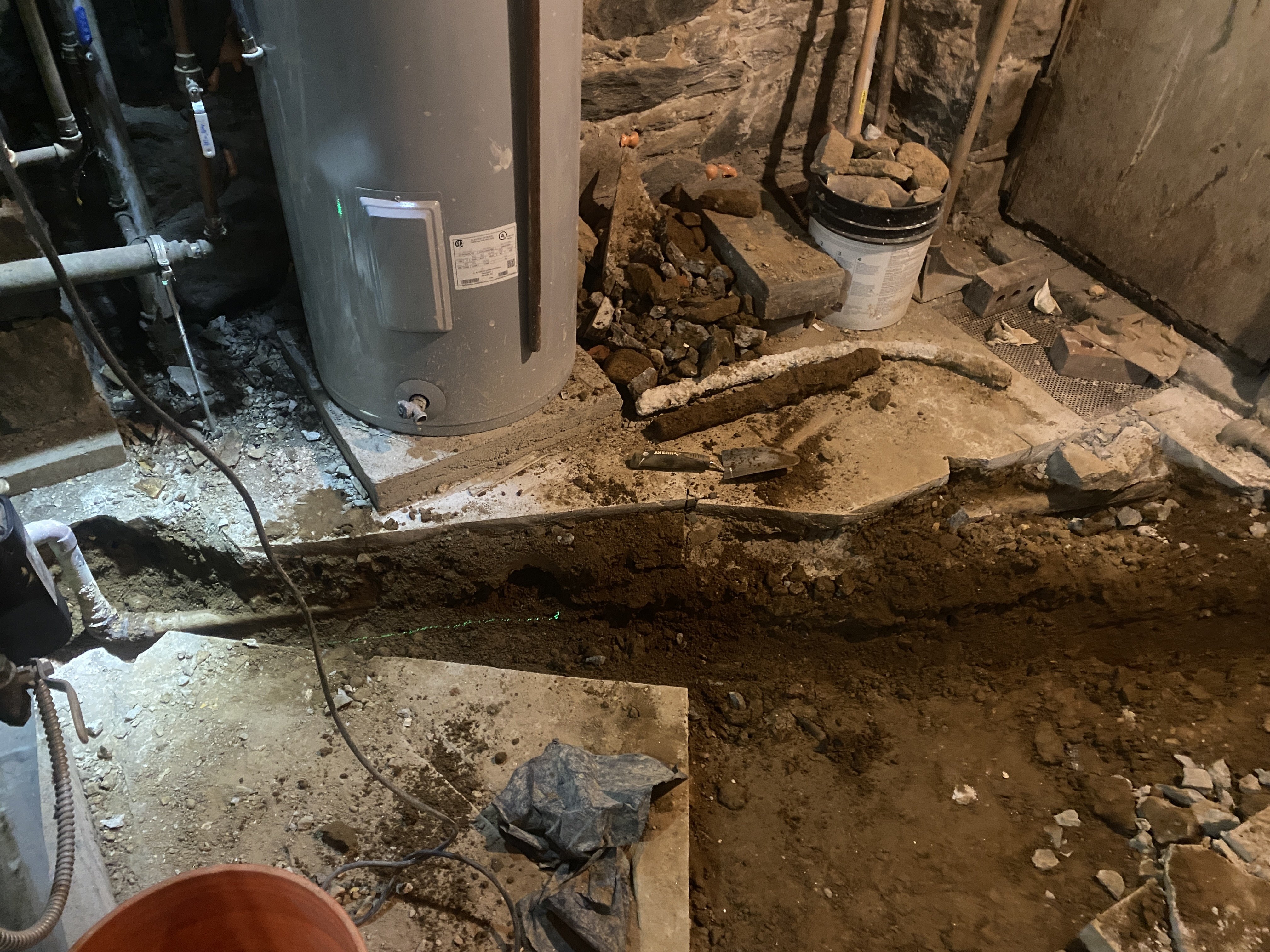

    I dug up the underground section near the boiler. Looks like they went copper to a black 90 back to copper and back to black pipe underground. It is what it is.
    I've read the copper pipe doesn't need to be sleeved underground, but should be sleeved when it comes up thru the slab.
  • KC_Jones
    KC_Jones Member Posts: 5,938
    I would have probably just abandoned in the ground and run the new pipe above the floor and eliminate all the underground hassles and digging up the slab.

  • AdmiralYoda
    AdmiralYoda Member Posts: 798
    Do you absolutely need to bury the new pipe underground? It will cause a problem eventually and someone will be here asking where all the missing water from their boiler is. Might be our grand-kids or great grand-kids but it will happen.
    Keep it above ground if you can. Maybe route it behind the water header and along the foundation?

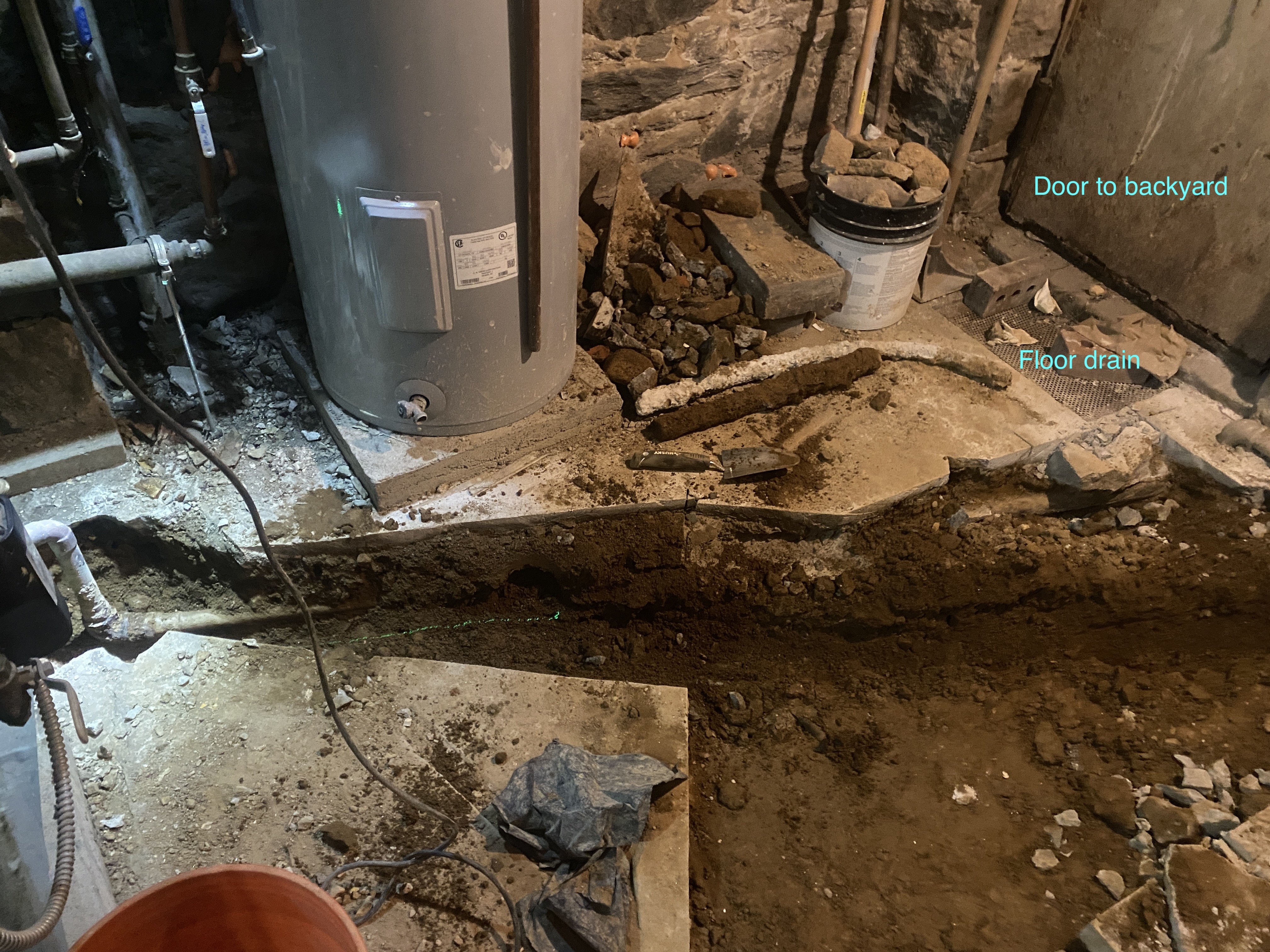

    mattmia2 Member Posts: 17,431
    i thought there was a doorway involved here somewhere.
    when I buried some pipe in concrete I got some of the collapsible discharge hose and sleeved the pipe in that. If I were burying pipe in the ground like that I would probably sleeve the whole thing, not just where it goes through the slab. If the soil attacks it or not depends on the chemistry of the soil.
    branimal
  • branimal
    branimal Member Posts: 301
    Theres a door to the backyard in the back there.
    I'm going to bed it in sand to protect the pipe.

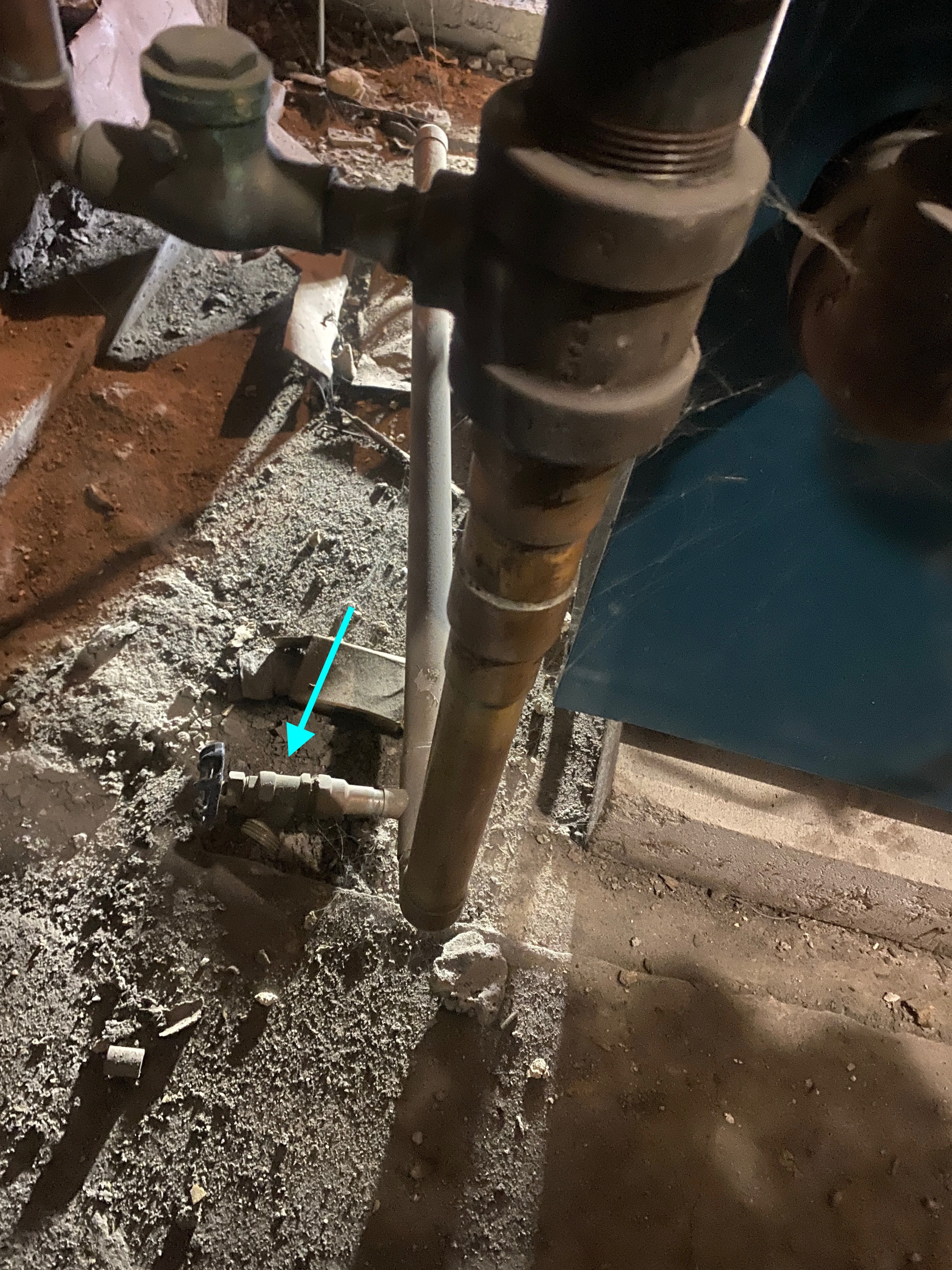

  • branimal
    I just want to verify this is the valve to drain the wet return so as to minimize the amount of water leaking once I cut the line. I'm going to drain it until almost empty on the sight glass.
    I got the full port drain valves mattmia suggested. I'd like to sweat the 1 1/4 x 1 1/4 x 3/4 tee with the 3/4 leg facing up so I minimize the space lost once I frame a new wall w/ access panel around wet return. I don't want to face it down, b/c that's where my baseboard will be. Am I going to regret that later when I drain the wet return with a hose. + bucket? It's going to be a finished basement.
    looks good. Go for it.

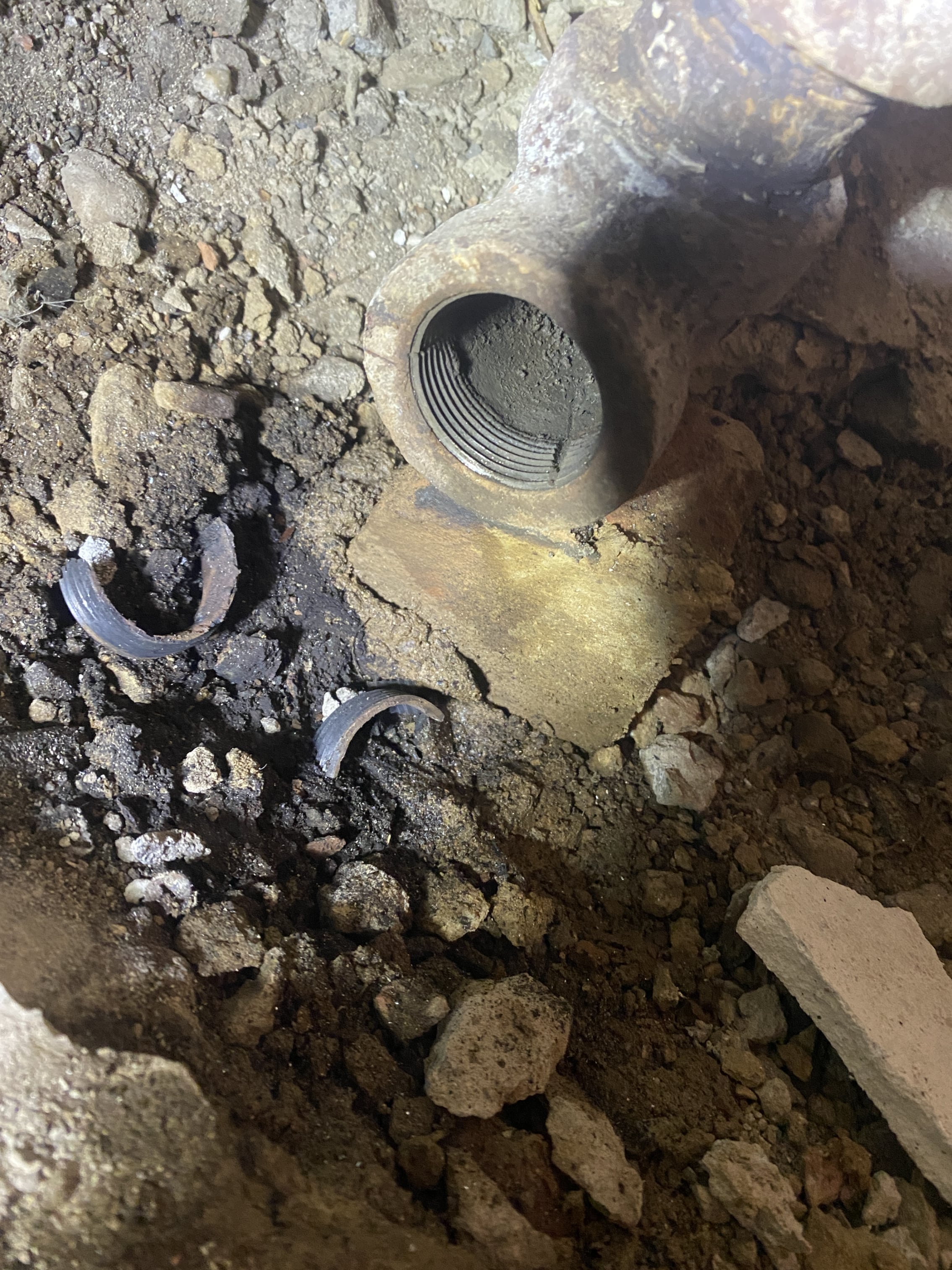

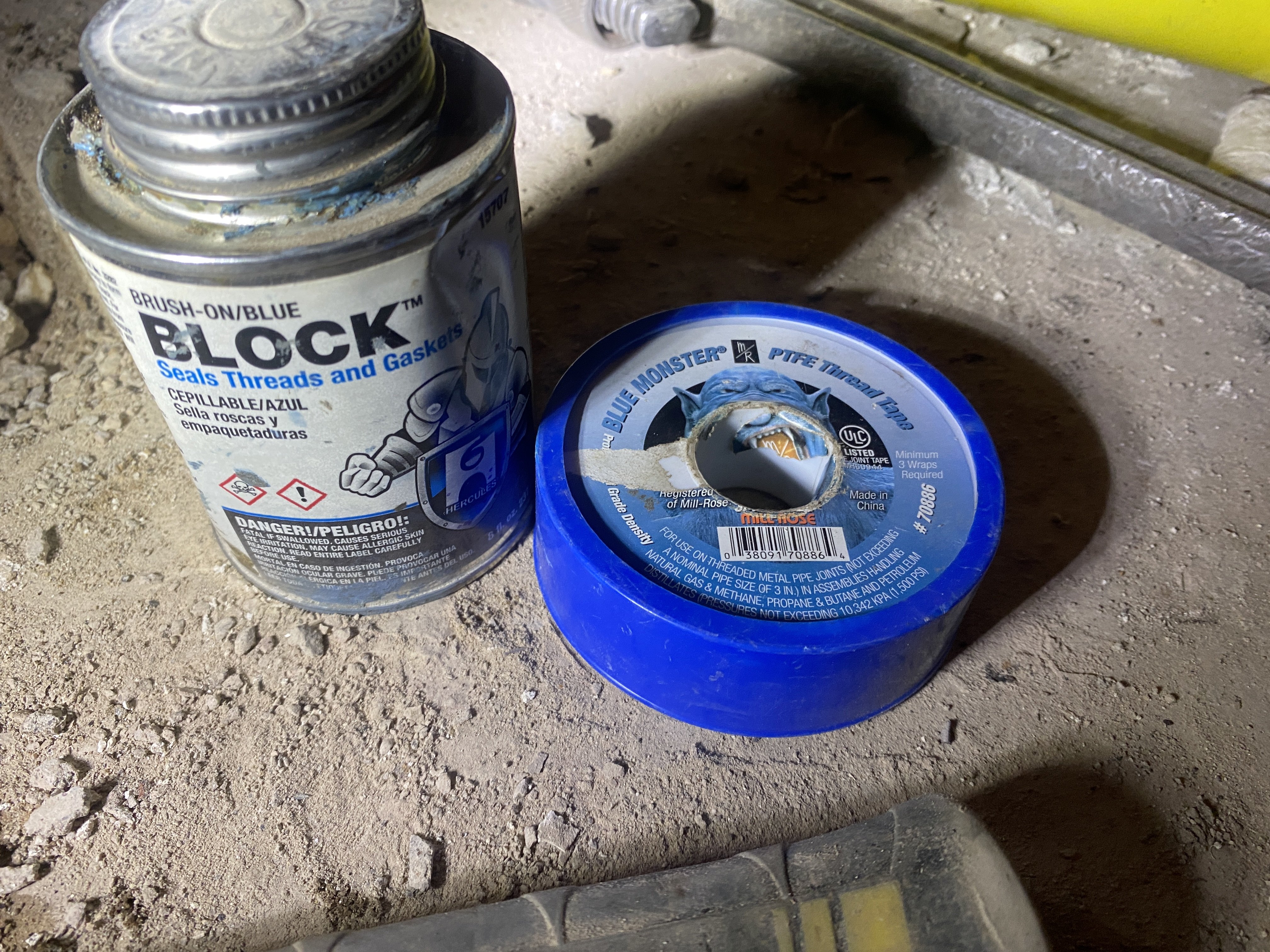

    First mishap right at the starting gate. 😥 I nicked the threads right thrue on the old black tee on the ground. Usually when I've done this on steam fittings in the past, I use Blue Block on it and I've never had a leak. Will the block be adequate or do i need a better solution.
    not sure what blue block is but rtv or hardening sealer or ball wicking should do it, there is little pressure there.
    branimal
  • Captain Who
    Captain Who Member Posts: 883
    Clean it with alcohol, spray the nipple that is going in there with dry lube, let it dry, put a noodle of JB Weld Epoxy putty in there, screw in the nipple about 1 or 2 turns past the finger tight point (premarked on both pipes), let it cure and disassemble. That's what I'd do because that is a pretty deep cut.

    It's in his picture lol. I did not say your method wouldn't work but everyone has easy access to jB Weld epoxy putty and dry lube. He could use "hardening sealer".
    I'm not saying for sure it won't work but I have had RTV rubber end up in my boiler when using that to repair my steam main, for example. Not real keen on that where air can't get to it or allow it to cure through escape of acetic acid, which is corrosive to steel.

    EBEBRATT-Ed Member Posts: 20,465
    You got that one pretty deep. I think I would change the tee.

    Yeah, sorry, too deep. Blue Block may work since it does harden, but i wouldnt take the chance.
    I might have to change the tee. Before I go that route, I was considering:
    Options:
    1. Rectorseal #5 along with ball wick or even loctite 55 (its a string type thread sealant). Thread in the brass nipple. Put a 90 el and a long nipple on the brass. Creating a stand pipe. Fill it up with water. See if it holds. The static pressure from a standpipe should re-create the pressure in a wet return.
    2. JB weld epoxy + dry lube to create the threads as per @Captain Who . I guess this re-creates the threads
    IF I have to replace the tee, I'm thinking a 2 brass couplings to replace the tee and the 90 above it. Then shift to copper. Is that the most efficient way to do it?
