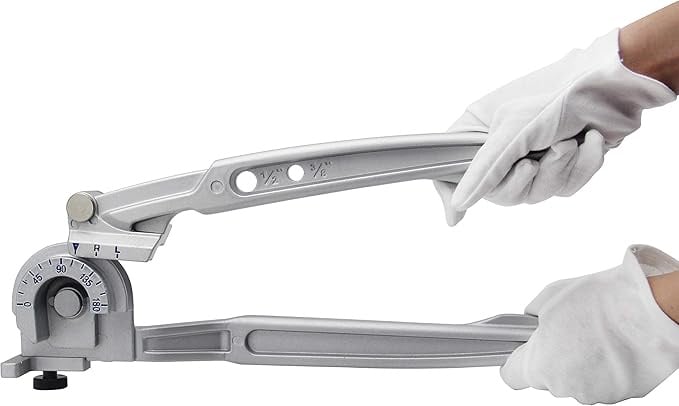

How do you bend coated fuel line? so far I gotten away with bending around a piece of pipe or a can etc. So I figured I would up my game and picked up a Kline roll bender "Klein-Tools-51006-3-in-1-Tubing-Bender"
The plastic gets beat up a bit and it just one radius.

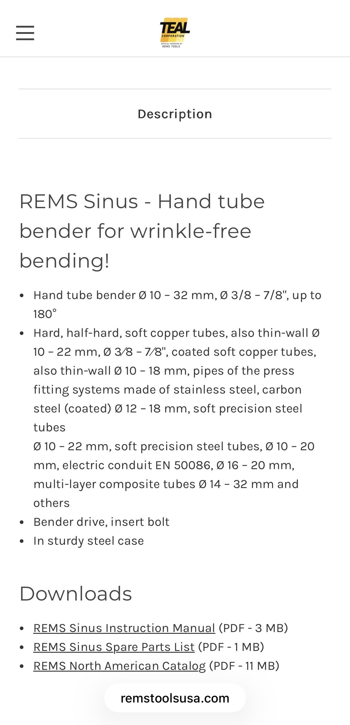

thanks, but where do I find a tubing bender that is 3/8 plush that jacket?
"the groove needs to match the od of the tubing and coating." yes, but who makes this?
a little bit bigger is probably ok. a little small is going to tear up the plastic which its probably just a cosmetic issue.

I have that set @HVACNUT but the bending forms are all black plastic like the clamp die. I like your pretty colors!
