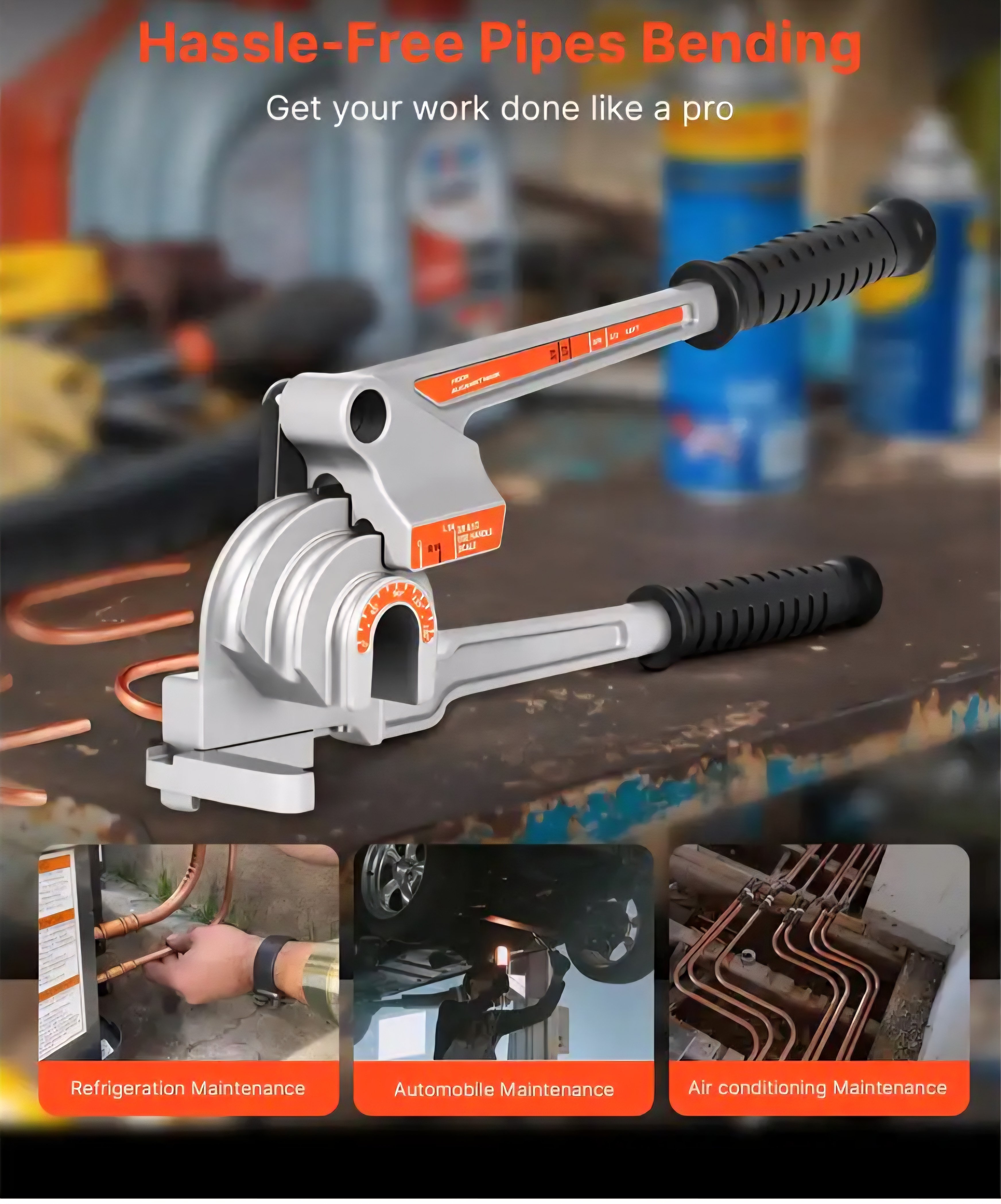

How do you bend coated fuel line? so far I gotten away with bending around a piece of pipe or a can etc. So I figured I would up my game and picked up a Kline roll bender "Klein-Tools-51006-3-in-1-Tubing-Bender"
The plastic gets beat up a bit and it just one radius.

a little bit bigger is probably ok. a little small is going to tear up the plastic which its probably just a cosmetic issue.

I use the 1/2" block to bend 3/8" coated oil line. I have this mostly for refrigerant piping.

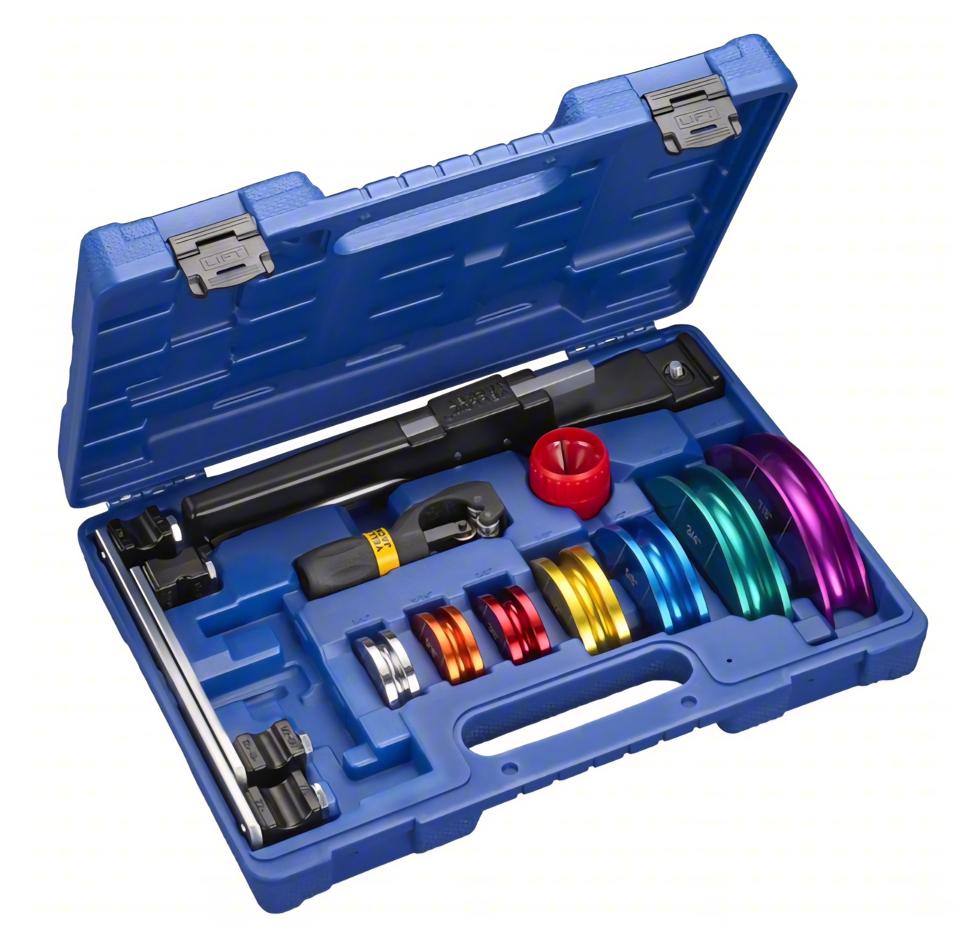

While I was looking for a pic of that one, a came across this.
This was on the HD website.
1 -
I have that set @HVACNUT but the bending forms are all black plastic like the clamp die. I like your pretty colors!
