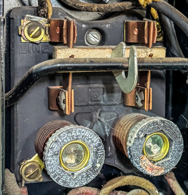

Can my vintage boiler wiring be updated to modern wiring?

    In this case it is really easy to wire the Neutral so it is un-switched and not fused, just not a big deal.

    EBEBRATT-Ed Posts: 21,027
    NEC 404.2(B)
    Grounded Conductors
    Switches or Circuit breakers shall not disconnect the grounded conductor of a circuit.
    Exception:
    A switch or circuit breaker shall be permitted to disconnect a grounded circuit conductor where all circuit conductors are disconnected simultaneously or where the device is arranged so that the grounded conductor cannot be disconnected until all the ungrounded conductors of the circuit have been disconnected.

    EdTheHeaterMan Posts: 12,750
    So the 1930s square D fused disconnect is a NO!

    ChrisJ Posts: 17,675
    edited February 18
    Maybe it's intended to be used with 240v coming from a larger circuit.
    That would make a lot more sense.
    Otherwise it doesn't make sense to have fuses at the appliance nor does it make sense to have two fuses on a 120v appliance.
    I vote improper use of equipment. Hacks aren't a modern creation.

    109A_5 Posts: 4,497
    Why ? Just replace the Neutral side switch and fuse with a wire and two wire nuts or just one wire nut if the existing wires reach. Since the connection of the fuse to the switch looks embedded in the insulation block. Now you have a spare fuse.
    mattmia2 Posts: 18,101
    in this application. it would be fine in a circuit with 2 ungrounded conductors.(ignoring the other 100 changes in the ul standard in the past 95 years)
    Fusing the neutral was ok in the old days. From David Shapiro's book "Old Electrical Wiring" "Before the adoption of the 1923 NEC it was ok to fuse the hot and the neutral"
