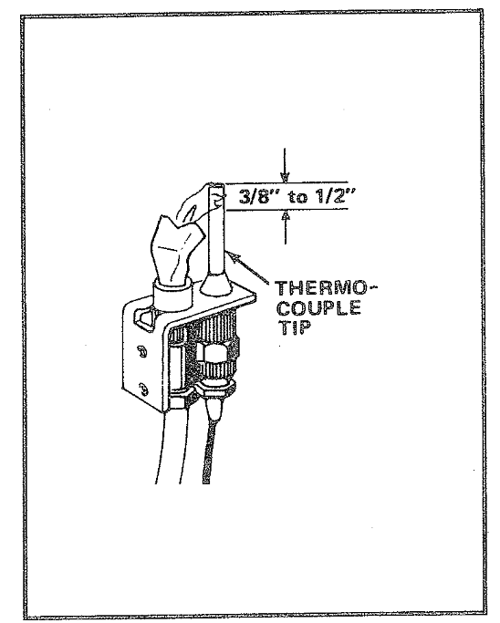

    Well if the flame seems consistent and is sufficiently engulfing the end 1/2 inch of the thermocouple until the instant 'it just goes out', I try a different thermocouple, probably the least expensive thing commonly available. No kinks in the thermocouple cable.
    Image from an old boiler manual.

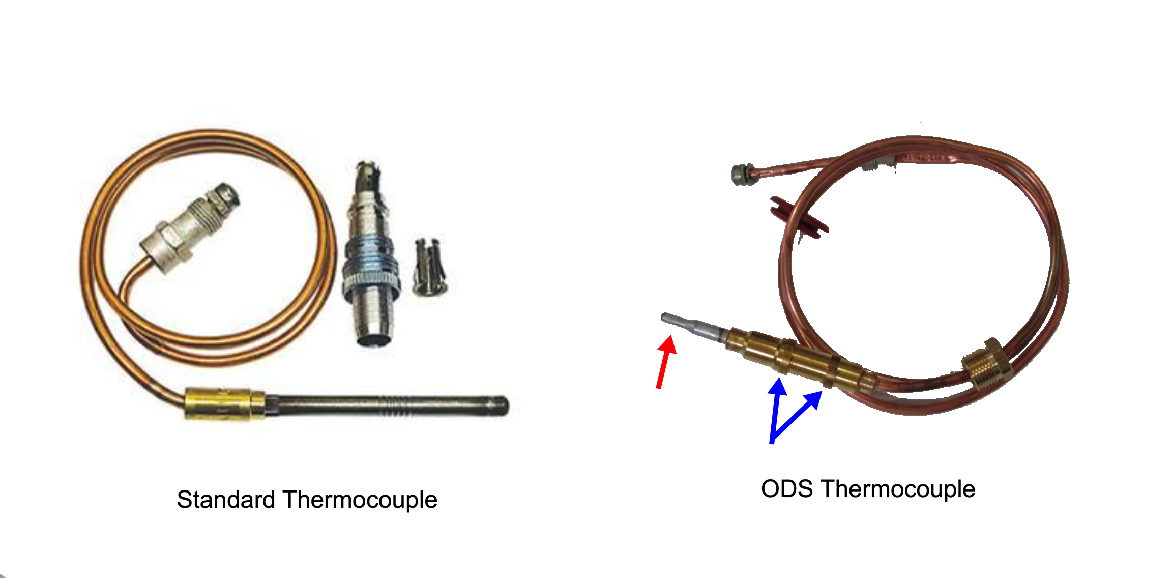

    The part number you referenced is, in fact, an ODS pilot thermocouple assembly. There is a distinct design difference between a standard pilot assembly and an ODS pilot. The ODS pilot is specifically engineered with a calibrated air intake and orifice to respond to changes in ambient oxygen levels.
    The difference is noticeable: the thermocouple on the left is smooth and allows for adjusting how far the tip can be pushed up into the pilot flame. The one on the right has a precise dimension on the sensing tip (Red Arrow) and two machined ridges (Blue Arrows) to ensure that thermocouple insertion can NOT be adjusted.

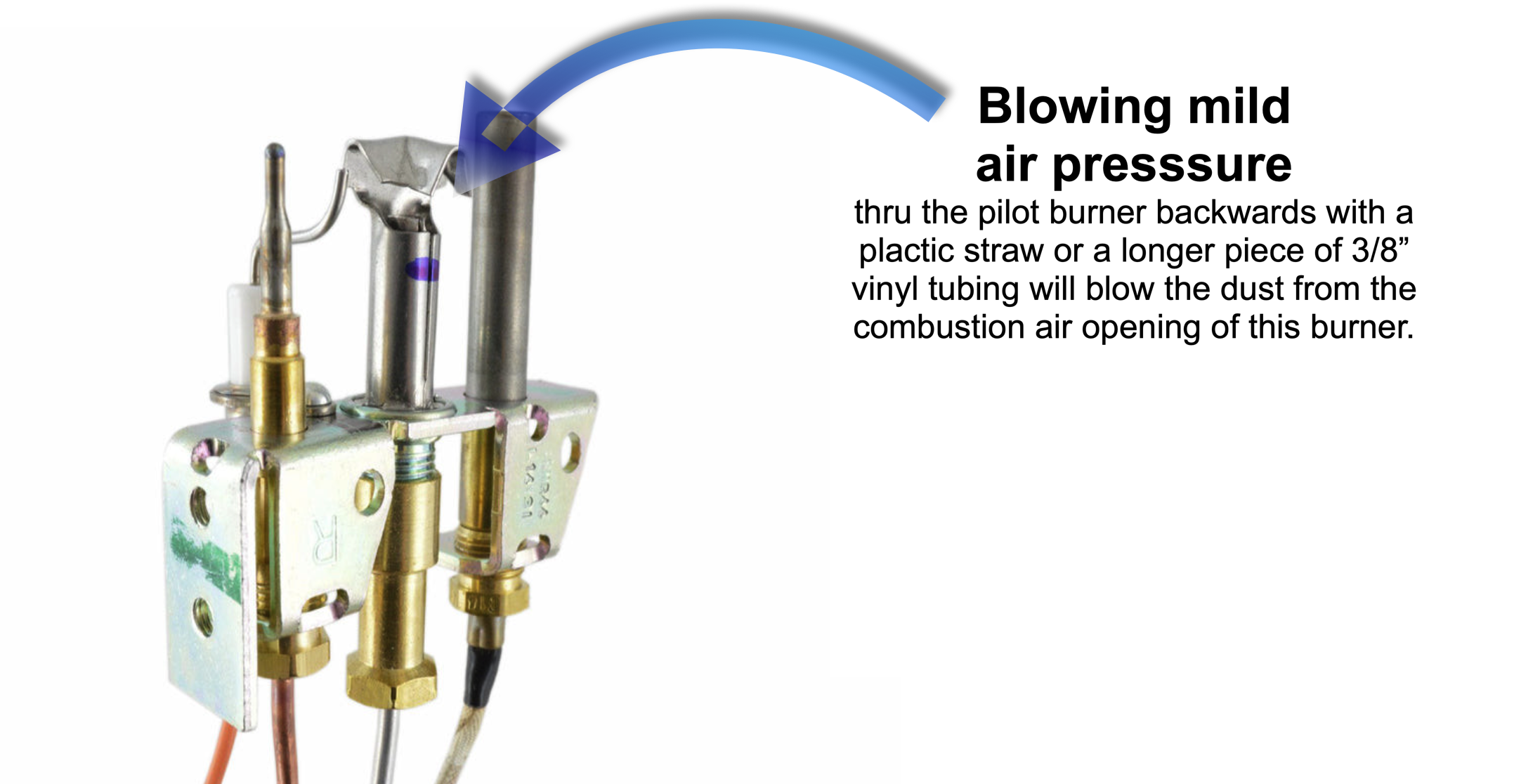

    Based on the model number you provided, your appliance is equipped with an ODS system. Given the symptoms you are describing, it is very likely that the unit is shutting down due to oxygen depletion or restricted pilot combustion air.
    One common cause of this condition is lint or dust accumulation in the pilot air intake opening. Even minor debris can alter the pilot flame characteristics enough to reduce thermocouple output and cause nuisance shutdowns.
    I recall resolving a similar issue for a customer by carefully clearing lint from the pilot’s combustion air opening. by blowing the lint away with a plastic straw. In that particular case, the issue recurred approximately every two years due to environmental dust buildup. The customer called it the McDonalds straw procedure
    You might ask: "Then why did appliance operate properly for 30 years and has only recently begun exhibiting this problem?" That suggests an environmental change in the room. Possible contributing factors could include:

    The noisy pilot may be a sign of the partially clogged pilot combustion air inlet. The gas pressure may also be a little high causing the noise. But I do remember those pilots can be a little noisy.

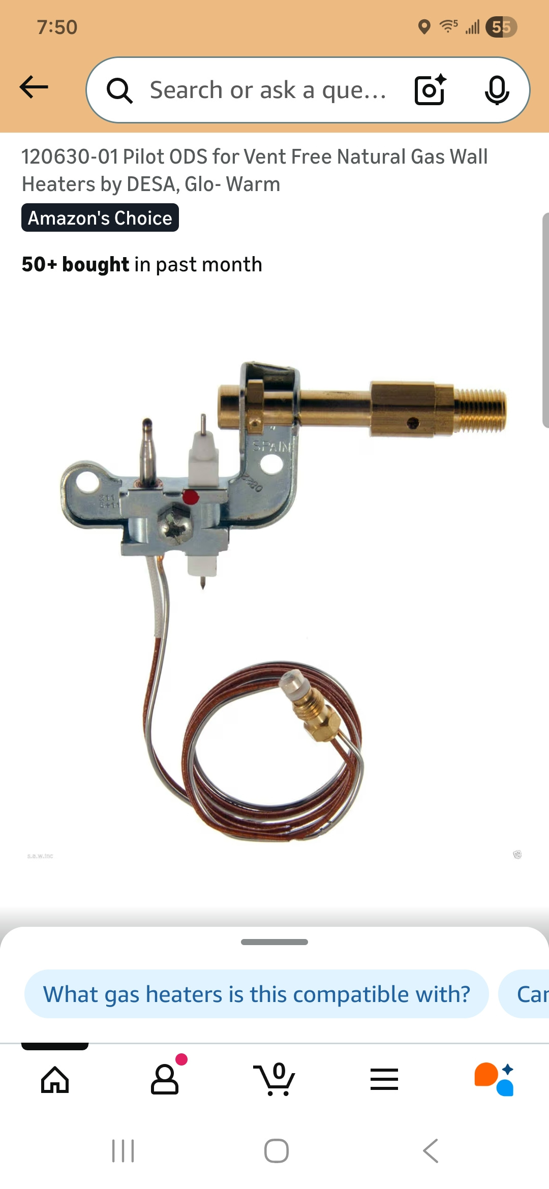

    My question for you is if it is an ODS thermocouple why is it dropping millivolts with a good constant pilot flame on the sensor? If I'm correct the thermocouple is not going to detect lack of oxygen? I have tried running the fireplace with the glass open which should indicate a good flow of oxygen along with the fact the pilot flame never lifts at all off the thermocouple.
    I know its not a reliable source but whenever I look up an ODS pilot assembly this is what I find. I understand it may be an ODS compatible thermocouple but with good pilot flame on the thermocouple just curious why it would still lose millivolts considering the thermocouple doesn't register oxygen levels.
