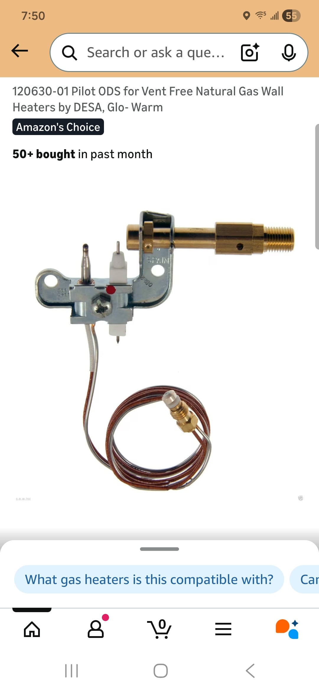

    The part number you referenced is, in fact, an ODS pilot thermocouple assembly. There is a distinct design difference between a standard pilot assembly and an ODS pilot. The ODS pilot is specifically engineered with a calibrated air intake and orifice to respond to changes in ambient oxygen levels.
    The difference is noticeable: the thermocouple on the left is smooth and allows for adjusting how far the tip can be pushed up into the pilot flame. The one on the right has a precise dimension on the sensing tip (Red Arrow) and two machined ridges (Blue Arrows) to ensure that thermocouple insertion can NOT be adjusted.
    Based on the model number you provided, your appliance is equipped with an ODS system. Given the symptoms you are describing, it is very likely that the unit is shutting down due to oxygen depletion or restricted pilot combustion air.
    One common cause of this condition is lint or dust accumulation in the pilot air intake opening. Even minor debris can alter the pilot flame characteristics enough to reduce thermocouple output and cause nuisance shutdowns.

    Thanks for clarifying things better on the ODS, that is the thermocouple installed on this unit. Does the fact that the pilot is abnormally loud help solidify this? I'm new to working on fireplaces everything is helpful! Usually work on boilers and furnaces.
    EdTheHeaterMan Posts: 12,948
    The noisy pilot may be a sign of the partially clogged pilot combustion air inlet. The gas pressure may also be a little high causing the noise. But I do remember those pilots can be a little noisy.
    The first time that I ever worked on a space heater with an ODS pilot, I could not figure out why the pilot flame was not reaching the tip of the thermocouple. (it was probably dust or lint). I also knew that when that happens you would just push the thermocouple up to the pilot flame on a regular pilot burner. So I destroyed the pilot burner so the bracket let me push the thermocouple closer to the flame. That fixed that problem!!!

    My question for you is if it is an ODS thermocouple why is it dropping millivolts with a good constant pilot flame on the sensor? If I'm correct the thermocouple is not going to detect lack of oxygen? I have tried running the fireplace with the glass open which should indicate a good flow of oxygen along with the fact the pilot flame never lifts at all off the thermocouple.
    I know its not a reliable source but whenever I look up an ODS pilot assembly this is what I find. I understand it may be an ODS compatible thermocouple but with good pilot flame on the thermocouple just curious why it would still lose millivolts considering the thermocouple doesn't register oxygen levels.

    I would ask you to look closely at the pilot flame. This is a precision-machined pilot burner with a precision-machined orifice and a precision-machined combustion air opening designed to produce a very specific pilot flame that just touches the tip of the thermocouple.
    Unlike the pilot flames you might find on a gas boiler, furnace, or water heater—where the thermocouple is completely engulfed in the flame—only a very small portion of the thermocouple is actually in contact with this flame. Look carefully at the pilot flame and the tip of the thermocouple. Then observe the shape of the pilot flame when the meter reading begins to drop.
    In the following photos of two different burners, you can see a distinct difference in the flame patterns. The top two photos are from a YouTube video showing what the flame looks like when the combustion air opening is unobstructed. When the man blocks the combustion air opening with his fingers, the pilot flame actually becomes larger but pulls away from the thermocouple. As a result of the reduced combustion air, the millivolt output drops and eventually the gas valve closes. This demonstrates how, even in a room with plenty of oxygen, problems can occur if the combustion air opening to the pilot flame becomes blocked by lint or dust.
    In the lower two photos, showing a different burner, the oxygen level in the room itself is depleted. You can see the flame lifting and jumping off the pilot burner as it searches for more air to burn. The flame lifts so far away from the burner that it is no longer near the tip of the thermocouple. As the millivolt signal decreases, the pilot flame drops out and the gas valve shuts off.
