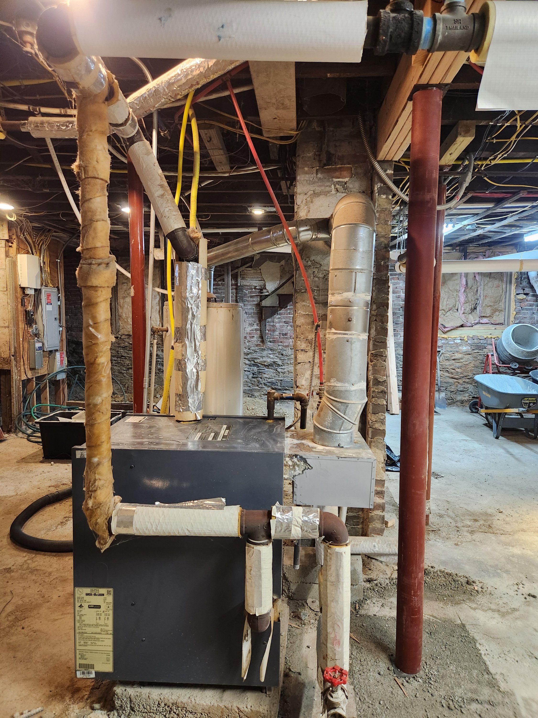

does this near boiler piping look right?
haro1
haro1 Member Posts: 9
edited 1:07PM in Strictly Steam
Thanks @mattmia2 and @EBEBRATT-Ed for your help with my question last month about moving a steam riser! The job's done, everything is working great, true to form I was more worried than I needed to be.

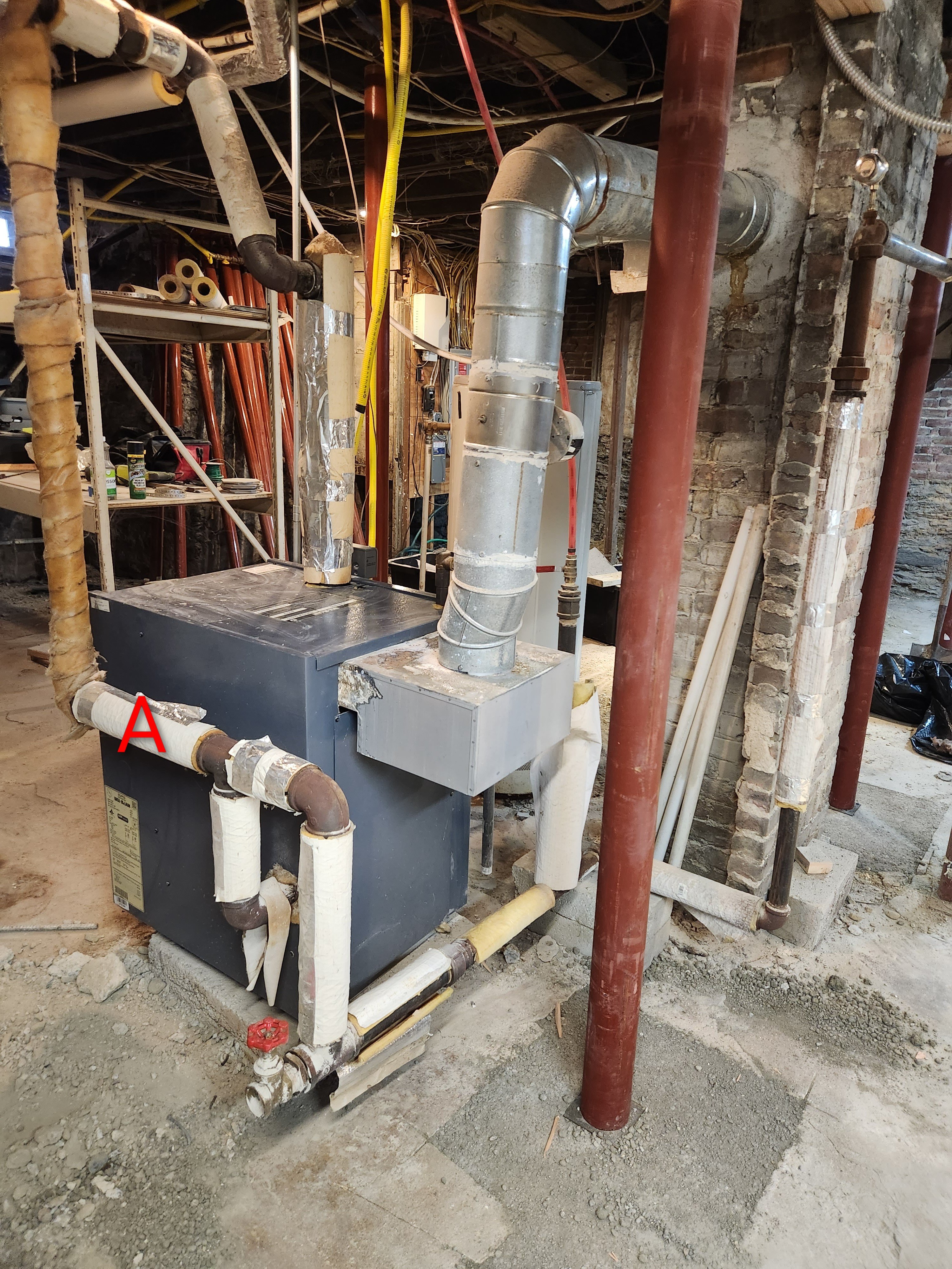

On that note, I've been looking at the near boiler piping and struggling to match it up with the diagrams I find online and in Dan's book. In particular, the pipe I've marked A in one of the photos below seems to be just above the boiler water level. The plumber who moved the pipe and cleaned the boiler noted that it looked unusual, but didn't comment beyond that.
Is this a functional Hartford Loop? Should I be concerned? For reference this is a Weil McLain EG/PEG-45 natural gas boiler. The previous owner had it installed when he converted from an oil-fired boiler 12 years ago.

    EdTheHeaterMan Member Posts: 11,911
    edited February 16
    Not At all
    Did you already pay for this? Then stop payment on that check.
    or did this come like this when you purchased the home?
    And how do you get in that basement with the steps removed anyway? 🤣🤣🤣🤣
    EBEBRATT-Ed Member Posts: 20,018
    No doubt you're struggling to match that to a drawing because it's all wrong. We see boiler all the time that are piped wrong but defy the odds and work fine.
    If everything is heating ok and there is no banging don't touch it.

    mattmia2 Member Posts: 16,285
    that is…creative
    Some may SCREAM! that you don't have a Hartford loop. I would not worry about that now because WM has a piping diagram in their I/O manual without a HL
    I'm not sure if you have a counterflow system or not, but either way, there is no HL in this diagram.
    there are more important things missing than the hartford loop especially since there are no wet returns. it may work ok if the water quality is good since it has so much rise in the riser from the boiler. you may have to skim it to get it to behave again after the oil from that new piping finds its way back to the boiler.

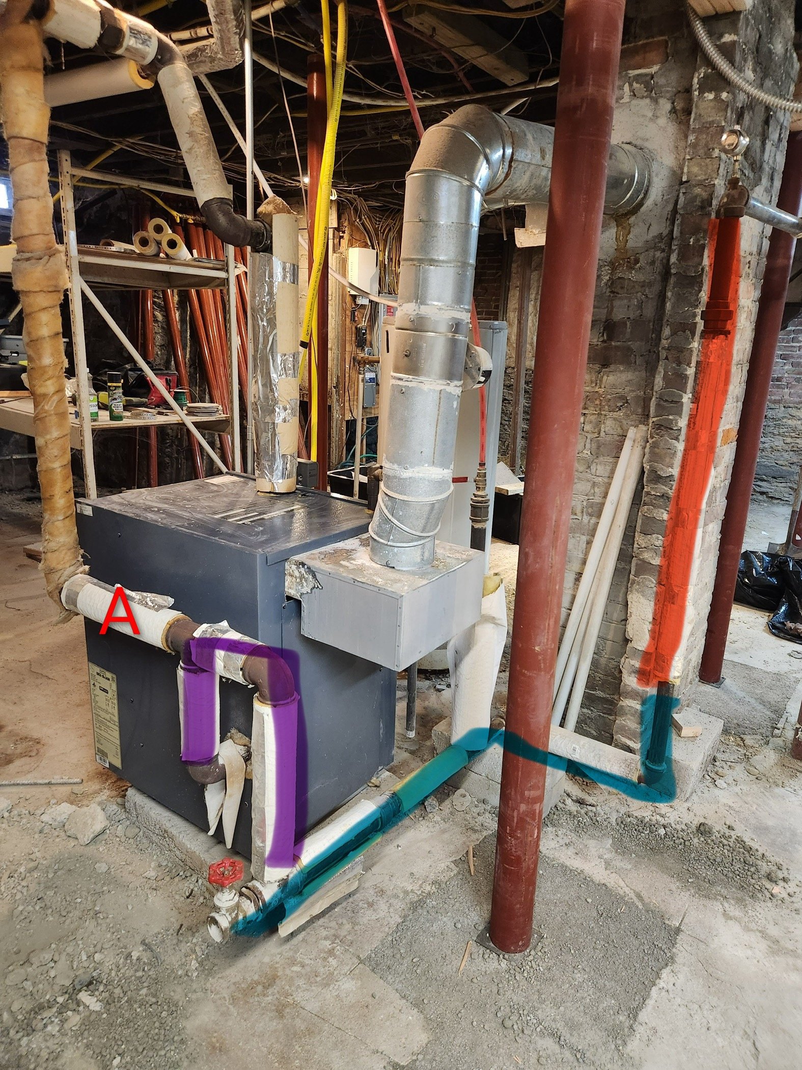

    ethicalpaul Member Posts: 8,578
    maybe I’m imagining it, but I see a Hartford loop and wet return. It’s just down from the silver main vent
    109A_5
    Can't see it Paul?!?!
    There is a pipe that is hidden behind a pipe that connects to a wet return just below the silver main vent. But no close nipple at some point just below the water line. Just don't see it.
    Regardless I stand by my previous statement: If it ain't broke Don't fix it.
    if you want to call it a wet return. it is really just moving the return connection from where it was on the old boiler to where it is on the new boiler. it has to go below the water line before it connects to the boiler somehow.
    end of main/drip: red-orange
    Wet return: teal green
    Hartford loop: purple
    109A_5

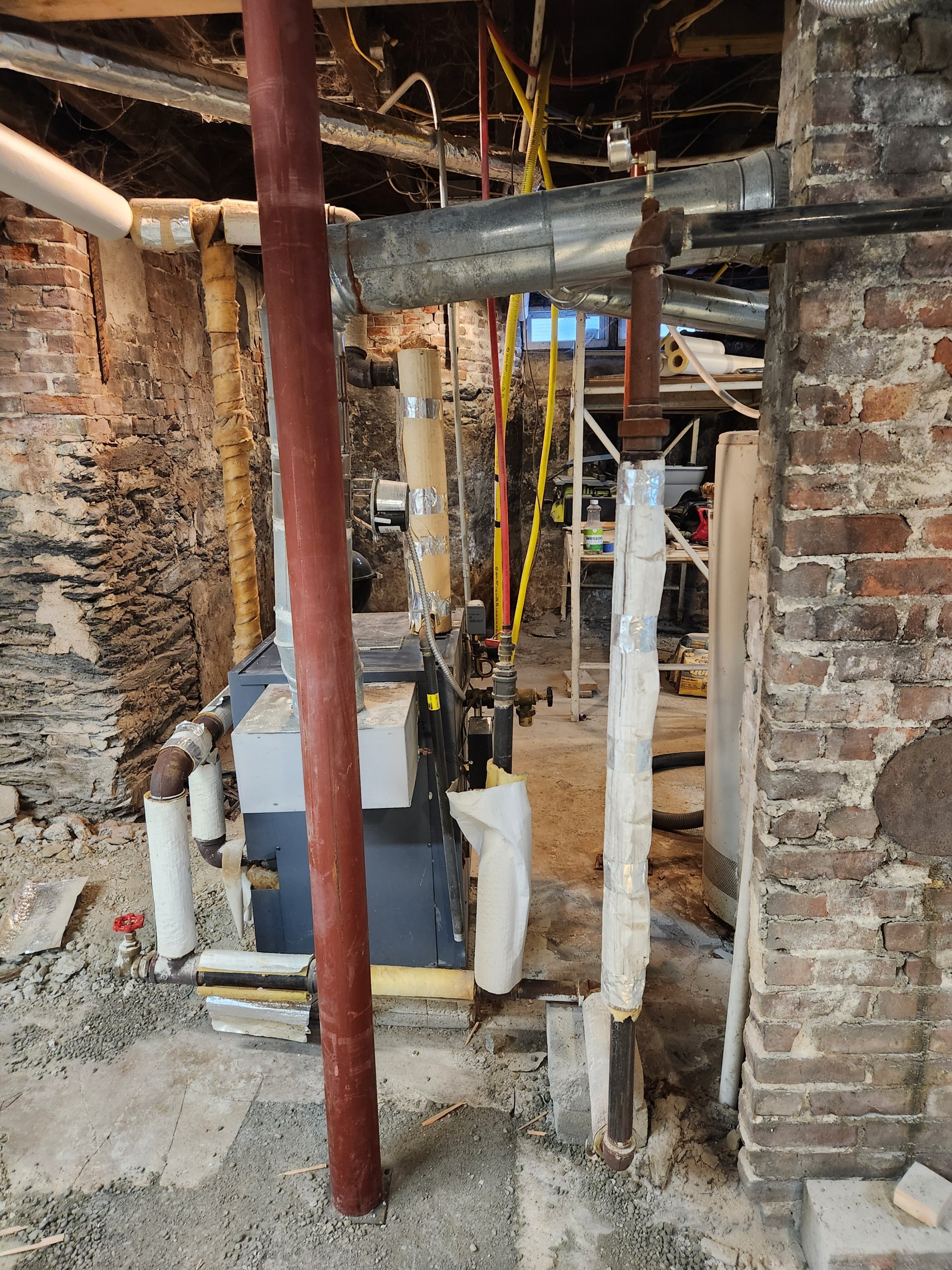

    109A_5 Member Posts: 3,822
    "A" actually is part of what is basically the equalizer, I agree if it does not hammer leave it alone. If the piping drives you nuts maybe wait to the summer and redo the near boiler piping.
  • 4GenPlumber
    4GenPlumber Member Posts: 90
    The choice of valves is also quite interesting. Globe valve on the return and a rad valve on the skim port. Rad vent as main vent. I am thoroughly shocked it works without banging. The structural issues you've described...and no lines sagging enough to puddle. Impressive?
