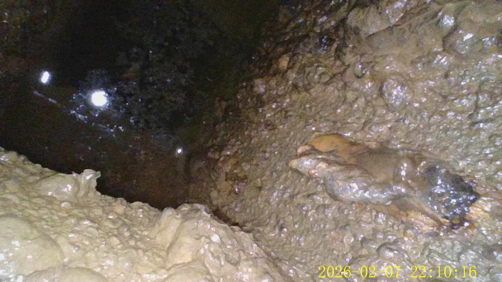

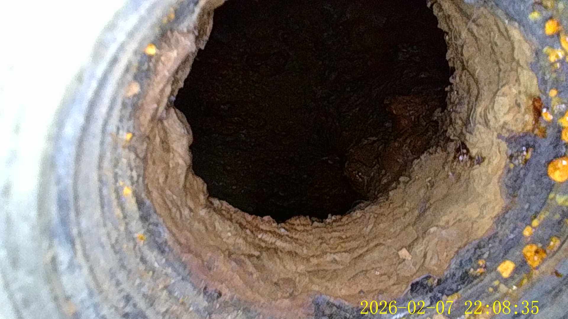

    azward Member Posts: 89
    The inside of the boiler is already coated with sediment. It rubbed on the finger like bright brownish pigment. It really needs a cleaning.
  • AdmiralYoda
    AdmiralYoda Member Posts: 798
    Year/Make/Model of boiler? Some pictures help too, a couple feet away from the boiler showing the controls, piping, etc. How does the water look in the site glass while its running?

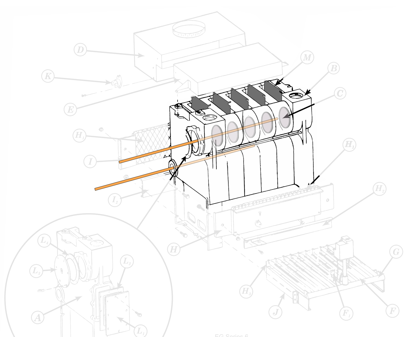

    It can only touch the sections on the two ends. There are 3 sections in the middle it cannot access
  • Captain Who
    Captain Who Member Posts: 883
    What if you make several with different curvatures to the left and right?

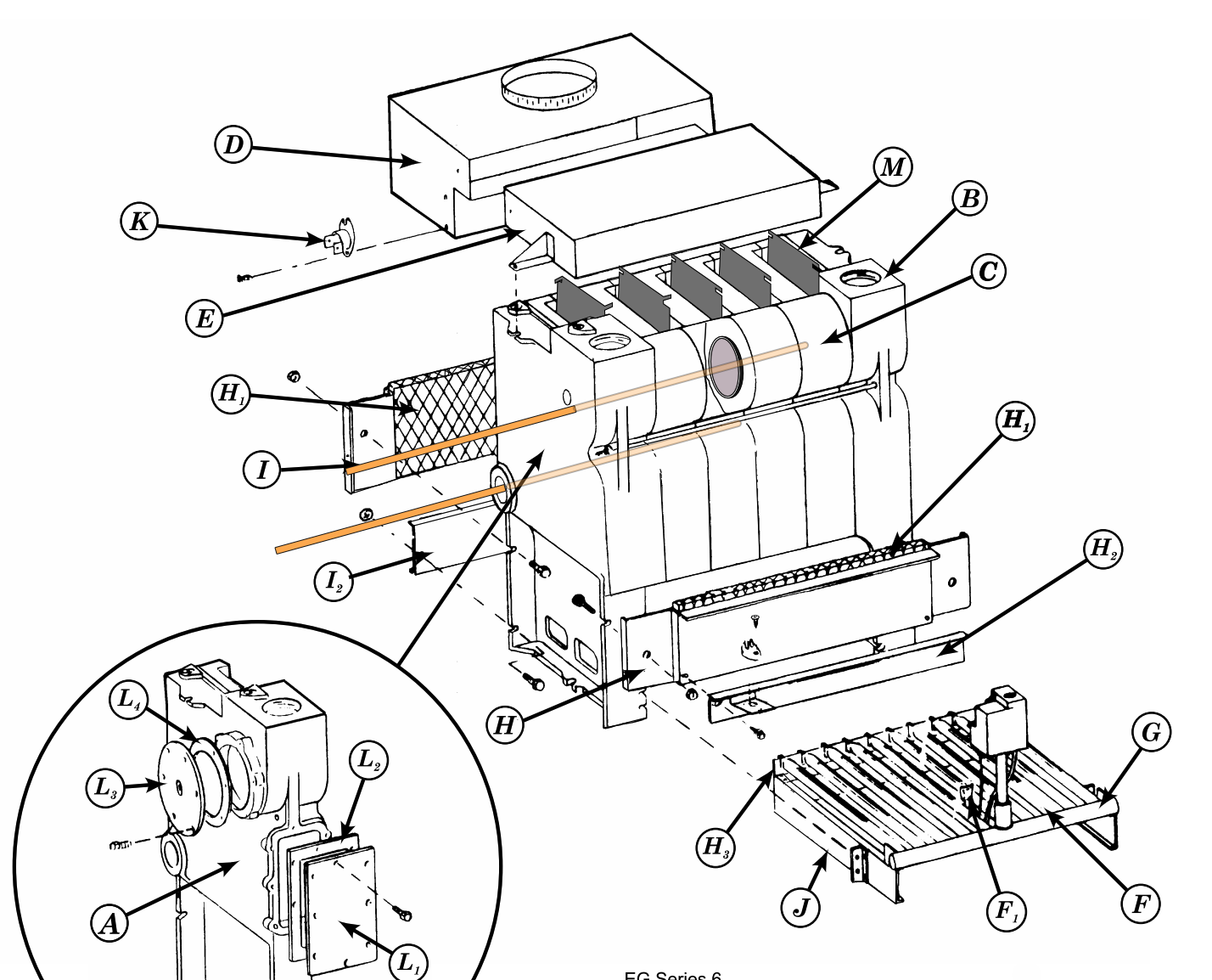

    EdTheHeaterMan Member Posts: 12,448
    You can get to each section thru the connecting opening at the top and the bottom of the boiler.
    Your home made sprayer just needs to be long enough
  • azward
    This is not covered in the operation manual I have. Is this the service manual? Could you provide a link? Remove the jacket right panel to get at the connecting opening?
    That illustration is from a Weil McLain EG manual. I adjusted some of the drawing to illustrate the internal openings between each section

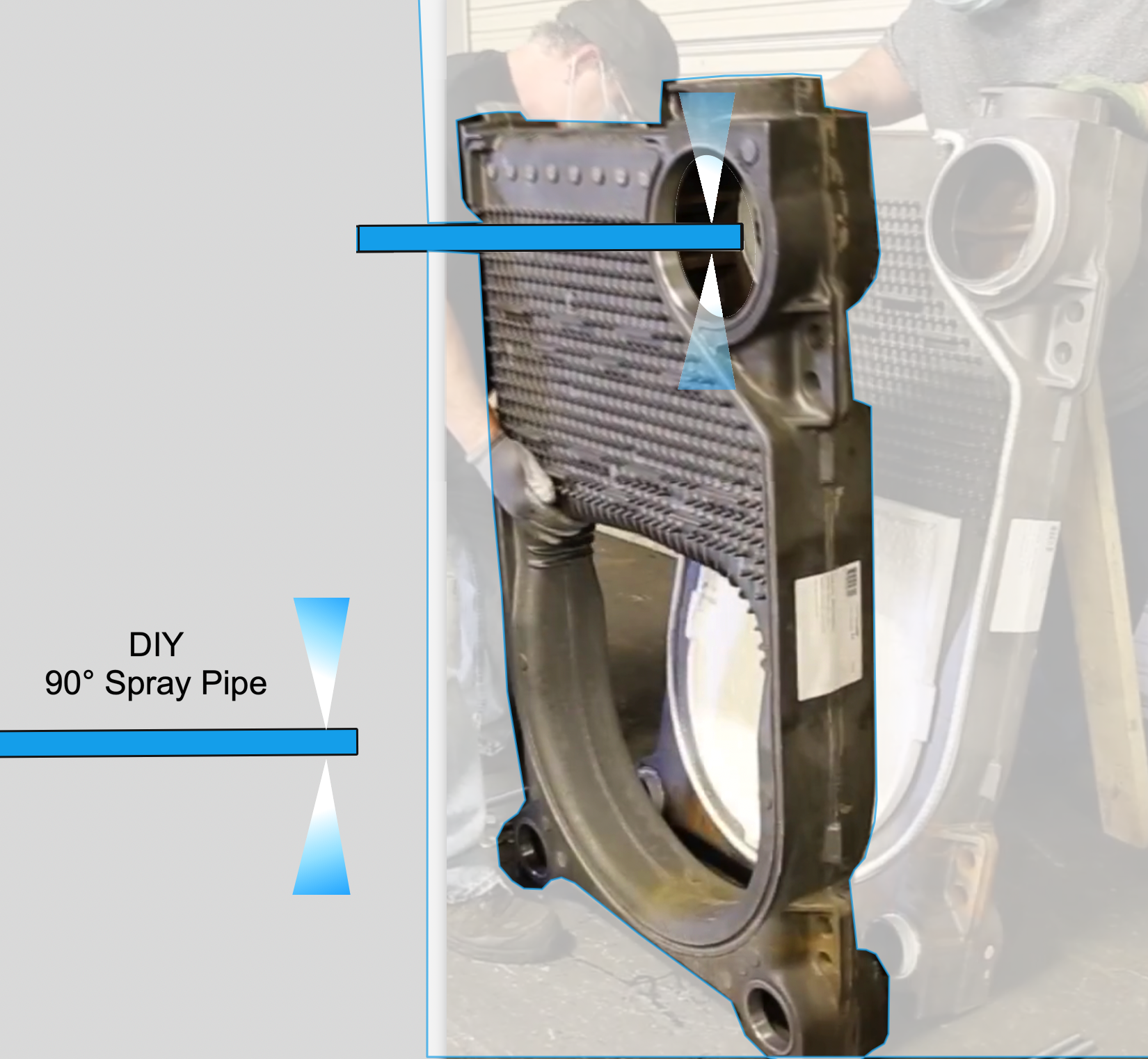

    each intermediate section has a large opening at the top and a small opening at the bottom that connects the sections together.
    Here is a commercial boiler that is being assembled in the boiler room. I have this one intermediate section highlighted with the DIY 90° spray nozzle inserted in the opening and soraying inside the intermediate section.
    as you can see the DIY 90° spray nozzle pipe is long enough to reach the first and last section form one end of the boiler. You will need to be able to twist and insert and withdraw in order to get the spray to knock off the sludge so it falls to the bottom.

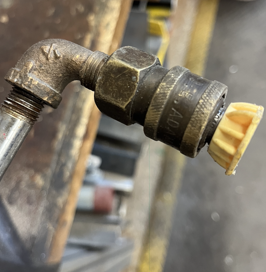

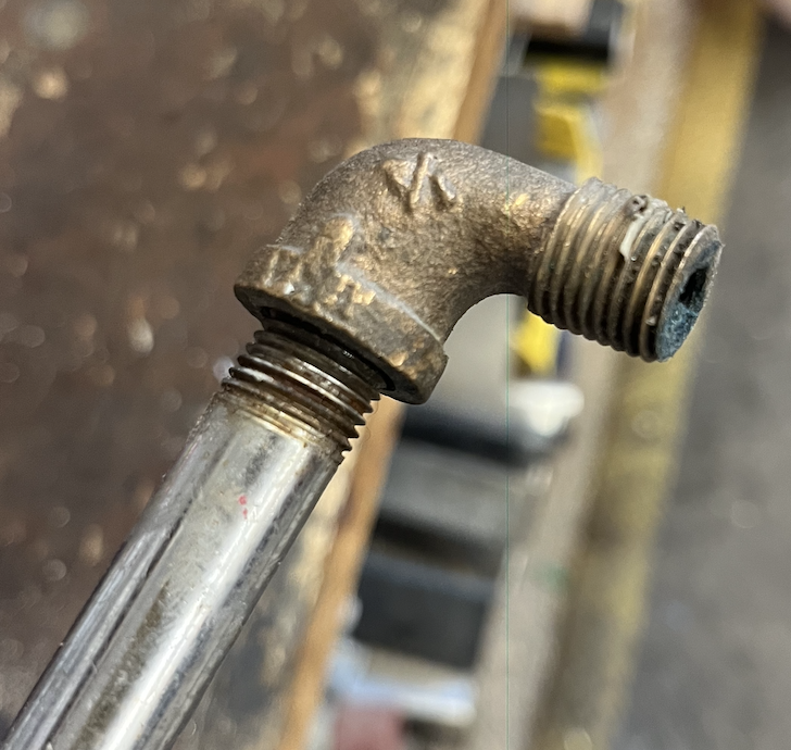

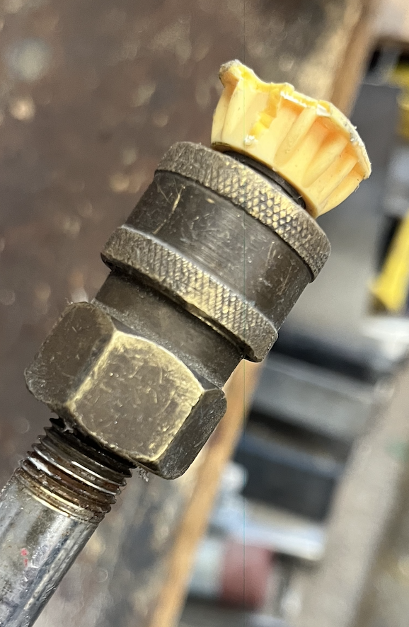

    hot_rod Member Posts: 27,709
    Maybe put an elbow at the end of the pressure washer wand.
    Probably fid a screw on nozzle, instead of this quick connect, o to shorten the length
    Screenshot 2026-02-14 at 9.16.58 AM.png Screenshot 2026-02-14 at 9.15.39 AM.png Screenshot 2026-02-14 at 9.15.25 AM.png
    EdTheHeaterManethicalpaulazward
    Great Idea with the street 90°.  Then Of Course you will need the camera on a probe to see if you have all the build up removed.  I think my Gastro-Intestinal doctor has an extra one if you need it.
