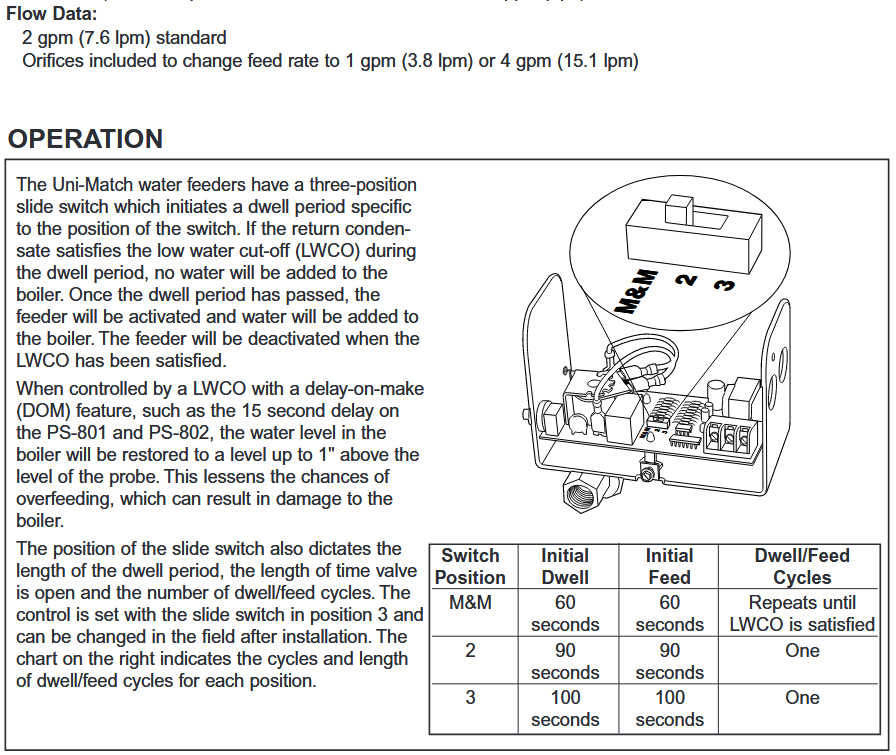

Current boiler is a Crown gas Steamer…
Not that old but it has a MM67 float type lwco.
The feeder is a Unimatch WF2-U-24
Customer complains that the feeder overfills each time lwco is triggered.
There are no settings on the feeder to limit the water.
VXT should allow more control correct?

    I remember dip switches in the Unimatch where you set it for the 67 ..

    It is supposed to have a 3 position slide switch to change the timing.
    The newer control has something similar and also has different orifices to change the flow rate.

    Im sure the orifices are LONG gone.
    That 67 switch is it. No delay or timing for cycle.
    if you need better control the Unimatch WF2-U-24 can be replaced by a VXT. If throttling the water thru the Unimatch WF2-U-24 is not getting you where you need to be.

    https://inspectapedia.com/heat/McDonnel-Miller-WF2-Water-Feeder-Instructions.pdf
  • kcopp
    kcopp Member Posts: 4,713
    Thanks. Confirms my thought that this "uni match" is not a good match for the system.
    109A_5 Member Posts: 4,290
    I would think with the correct orifice it would work great.
    The orifice with a VXT is about a Gallon a minute. If a Gallon a minute is too much a VXT may over fill the boiler too.

    That may depend on where the manual valve is. The orifice is probably in the correct position for the solenoid valve to work correctly.
    Was the float functionality in the M&M 67 verified to work correctly ? The M&M 67's water level range of 'Call for Water' to 'I'm satisfied' should be very narrow. Sluggish float movement may mess up any water feeder causing it to over fill the boiler.

    Is the fill time for only 60 seconds, does the orifice actually exist… Understanding the actual cause of the problem makes for better repairs.
    Would have been nice if the manual gave more information about the actual orifice size and where it is so you don't have to take the whole thing apart it check it.

    Looks like the orifice is on the outlet side of the solenoid valve. Thanks @Gordo

    I believe I was using the orifice information from the correct manual (link posted above), from the model number provided. I'm assuming it is 24 VAC burner circuit unit. Maybe the orifice was removed or the valve leaks.
