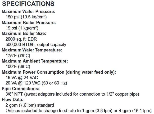

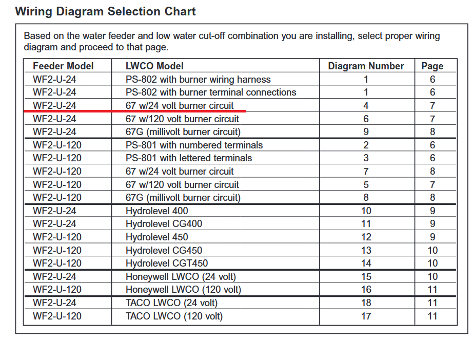

    https://inspectapedia.com/heat/McDonnel-Miller-WF2-Water-Feeder-Instructions.pdf
  • kcopp
    kcopp Posts: 4,735
    Thanks. Confirms my thought that this "uni match" is not a good match for the system.
    109A_5 Posts: 4,759

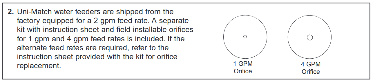

    I would think with the correct orifice it would work great.
    The orifice with a VXT is about a Gallon a minute. If a Gallon a minute is too much a VXT may over fill the boiler too.

    Is the fill time for only 60 seconds, does the orifice actually exist… Understanding the actual cause of the problem makes for better repairs.
    Would have been nice if the manual gave more information about the actual orifice size and where it is so you don't have to take the whole thing apart it check it.

    I have not started pulling the feeder apart but given that he has to dump water from the system Im sure they are missing.

    Looks like the orifice is on the outlet side of the solenoid valve. Thanks @Gordo
    McDonnell & Miller Uni-Match S-45 Valve Teardown. Water Feeder For Steam Boiler
    https://youtu.be/GD5QmoNLirU

    There is more than one uni match model. Not sure if the older ones had the orifices.
    109A_5 Posts: 4,759
    I believe I was using the orifice information from the correct manual (link posted above), from the model number provided. I'm assuming it is 24 VAC burner circuit unit. Maybe the orifice was removed or the valve leaks.
