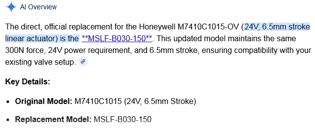

I have an older Stadler Viega mixing station. It has a honeywell M7410C1015-OV . It appears to be toast. I say this because I removed it from the valve and powered it up and the piston did not move. So I am looking for a replacement, I understand these are out of production. A replacement might be a Residio MSLF-B030-150. Google doesn't find any in the states. So here I am to see if anyone knows where I can get one of these guys or a different replacement.

    Many Honeywell M7410C1015 on eBay.com, most in China. Not sure what the -OV suffix means.
    Seems at least the stroke of the MSLF-B030-150 is different 8mm vs. 6.5mm for the M7410C1015.
    https://www.actuacontrols.com.br/files/M7410C1015.pdf

    hot_rod Member Posts: 27,451
    That is a modulating control, you just need an on/ off actuator.
    Pretty much any brand actuator will fit onto that manifold. Most are M30- 1.5 thread now. Some early Wirsbo were M28—1.5 and now they offer an adapter ring to fit the common M30 replacements.
    I doubt Viega actually made the actuator, sometimes you can find the actual manufacturers name somewhere on the actuator.
    So the threads are pretty much all common, there are a few snap on types, also.
    But the difference from brand to brand may be the pin stroke. The wrong actuator could cause the valve to not close completely, or not open fully.
    You could measure the stroke length with a caliper or accurate ruler. Some actuators list that travel length.
    Ideally you find an exact match, but any brand will fit and can be adjusted somewhat on the assembly thread, for instance.
    I have seen adaptor kits available in Europe to allow swapping of actuator brands, basically thread converters or spacer rings.
    Also you don't want to power a thermal actuator without having it attached to the manifold or valve. The thermal "motor" inside can push apart without having something to push against, and limit the travel.
