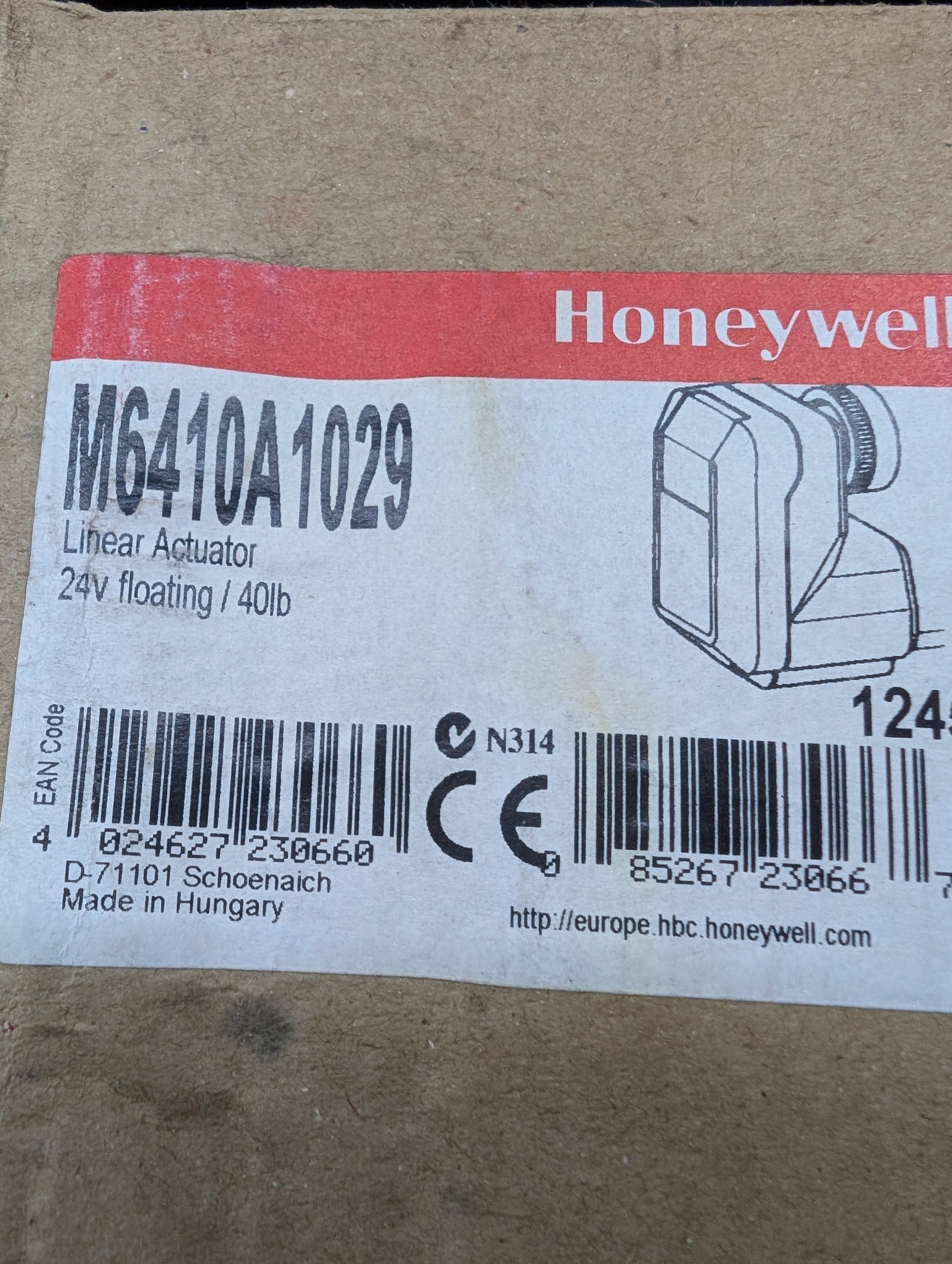

    i found a replacement / alternative Honeywell actuator on Ebay. And it didn't cost my first born either.

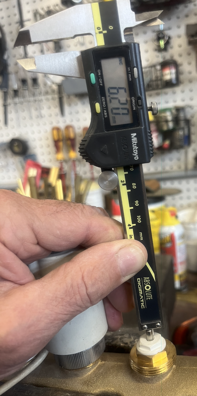

    From what I have found this is a pretty close replacement, right mounting collar, stroke is 6.4 mm the only issue I can find might be the force. This one is 180N (40.5 lb). Yeah it has been quite a time finding what I did. I am going to install it in the next day or so, wish me luck

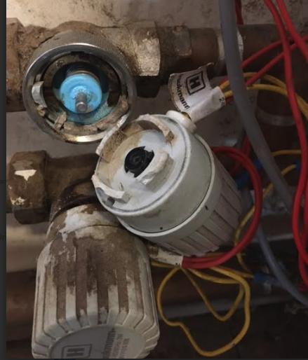

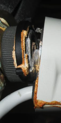

    What destroys actuators more than anything is the pins get sticky from bad water quality. Then the actuators tend to come apart.
    Or water getting into them :)
    You should be able to easily push that pin down with a flat piece of metal, the flat side of your pocket knife or a tough skinned finger,for example.
    If not clean the stem and re-lube the o-rings.

    Thanks for the tip. I can operate the valve pretty easily. No leaks, thank god. My issue is that the new actuator has a different thread pitch! There must be a difference in them from US to Europe? I might try to switch the nuts from the old to the new. Given that this is a mechanical actuator instead of a wax one, shouldn't I see movement of the stem afte a minute or so of running?
    hot_rod Posts: 28,789
    Perhaps that actuator is made for a specific valve with a special thread? With that floating 24v it is for a modulating control valve of some sort
    All the hydronic manifolds I have seen are 28 or 30 mm 1.5 pitch.
