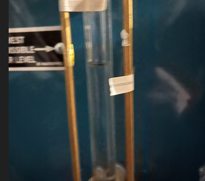

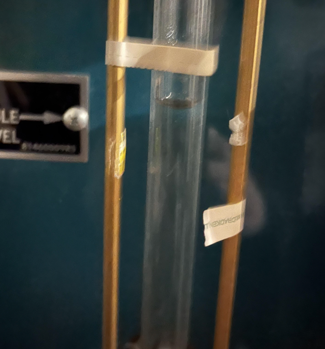

    ups3341 Member Posts: 9
    Thank you Edward .
    Does boiler water go down by itself?
    first photo i took 8:25pm the water above permissible water level.
    And take a photo again at 9:47pm just the boiler turns on.. water down are they normal?
    thank you
    EdTheHeaterMan Member Posts: 12,148
    That small drop is normal. That is because the water is changing into steam and going the the radiators.
    If the burner stops because the water level drops, then the water level goes back up because automatic feed valve adds water, then you will get higher water level after everything cools down.
    Does the water level stay at the higher level for a long time if the burner is off?
    Does the water level go down when the burner is off for a long time?
    These answers will determine if you have a leak under the floor.

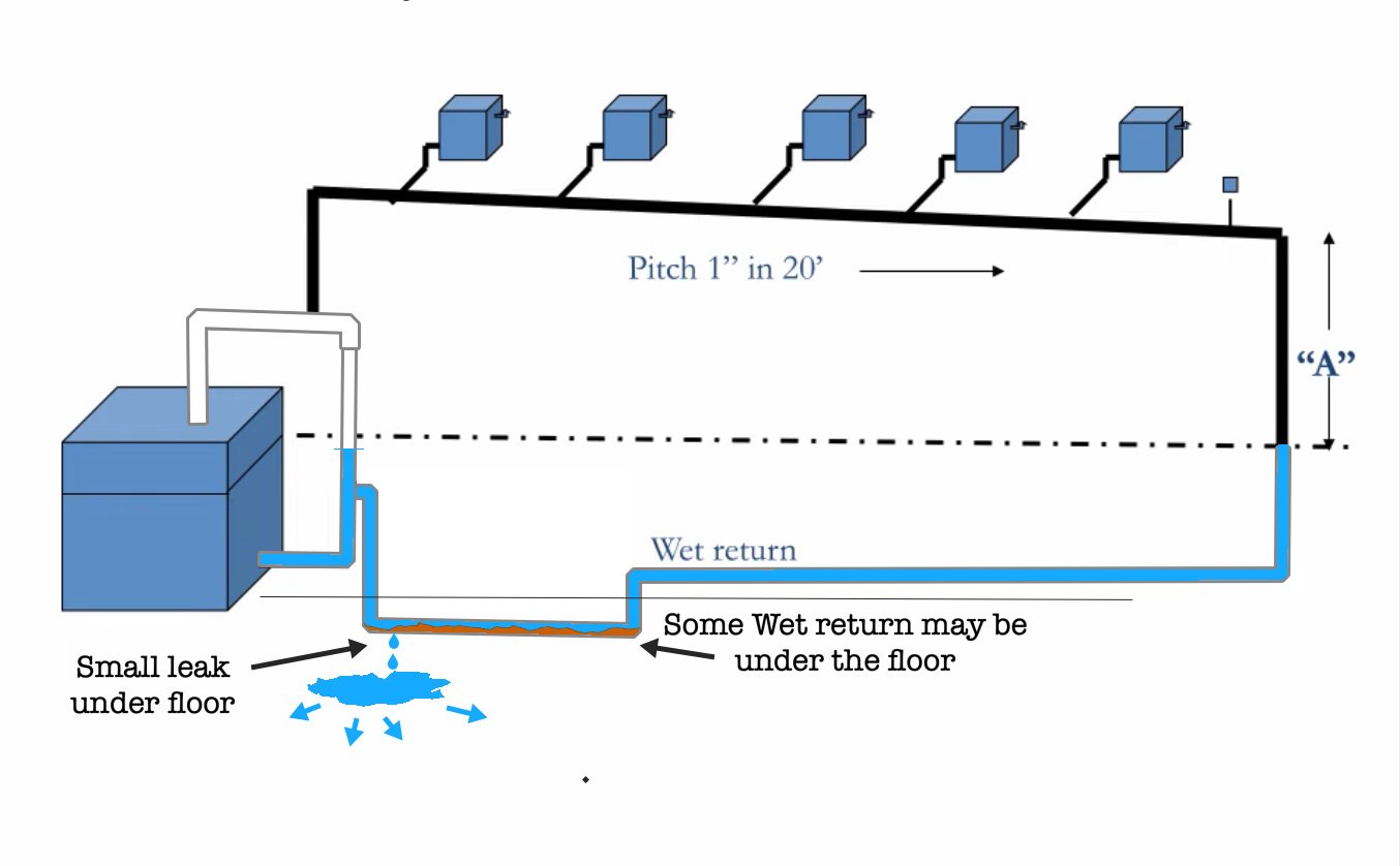

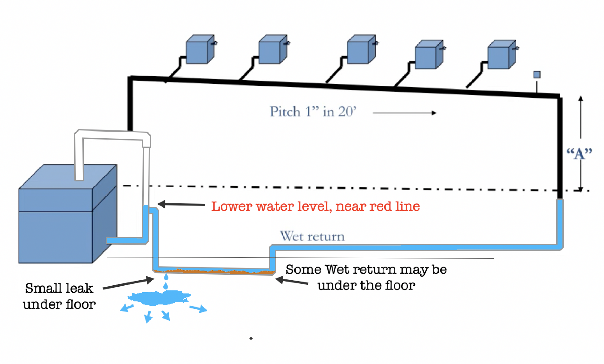

    This diagram may help
    1. The wet return under the floor may have mud and rust in the pipe that makes the returning condensate water come back slow
    2. Slow return water makes automatic water feed add water
    3. Water level goes up because the water feed add water and the condensate water also return to boiler.
    4. There is a small leak in the pipe under the floor. You can not see the leak.
    5. When the burner is off for a long time the boiler water will leak under the floor
    6. The water level goes to red line
    7. The water feed will add water when the water goes to the red line
    This is only one possibility. You need to have the wet return pipe cleaned and checked for a leak. That would be my first step.
