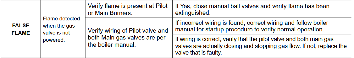

    The other thing is the "false flame" error means there is a flame when there should not be and the sensor leak may have nothing to do with that.

    According to what someone posted, the flame error is saying flame when there shouldn’t be. I haven’t worked on the series 4 yet but to me that means something isn’t closing the gas valve after the boiler is supposed to to shut down. Allowing the pilot or flame to stay lit. Have you tried cleaning the pilot assembly and checking it looks ok?The Temp/LWCO probe may have just been a separate issue happening at the same time

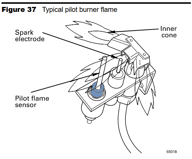

    I'd inspect the wiring for abrasions, being crushed or pinched and secure connections. I'd also inspect the insulation on the sensor probe for contamination or damage (the area of blueish shading in the image below), clean or replace if needed.
    If you have the proper test equipment (a multimeter or equivalent capable of DC microAmps) Flame Rectification current could be measured also.
    All assuming the flame goes out when actually expected every time, if a gas valve (main or pilot) is sticking open you may have to catch it in the act.

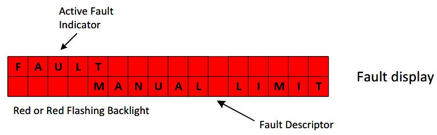

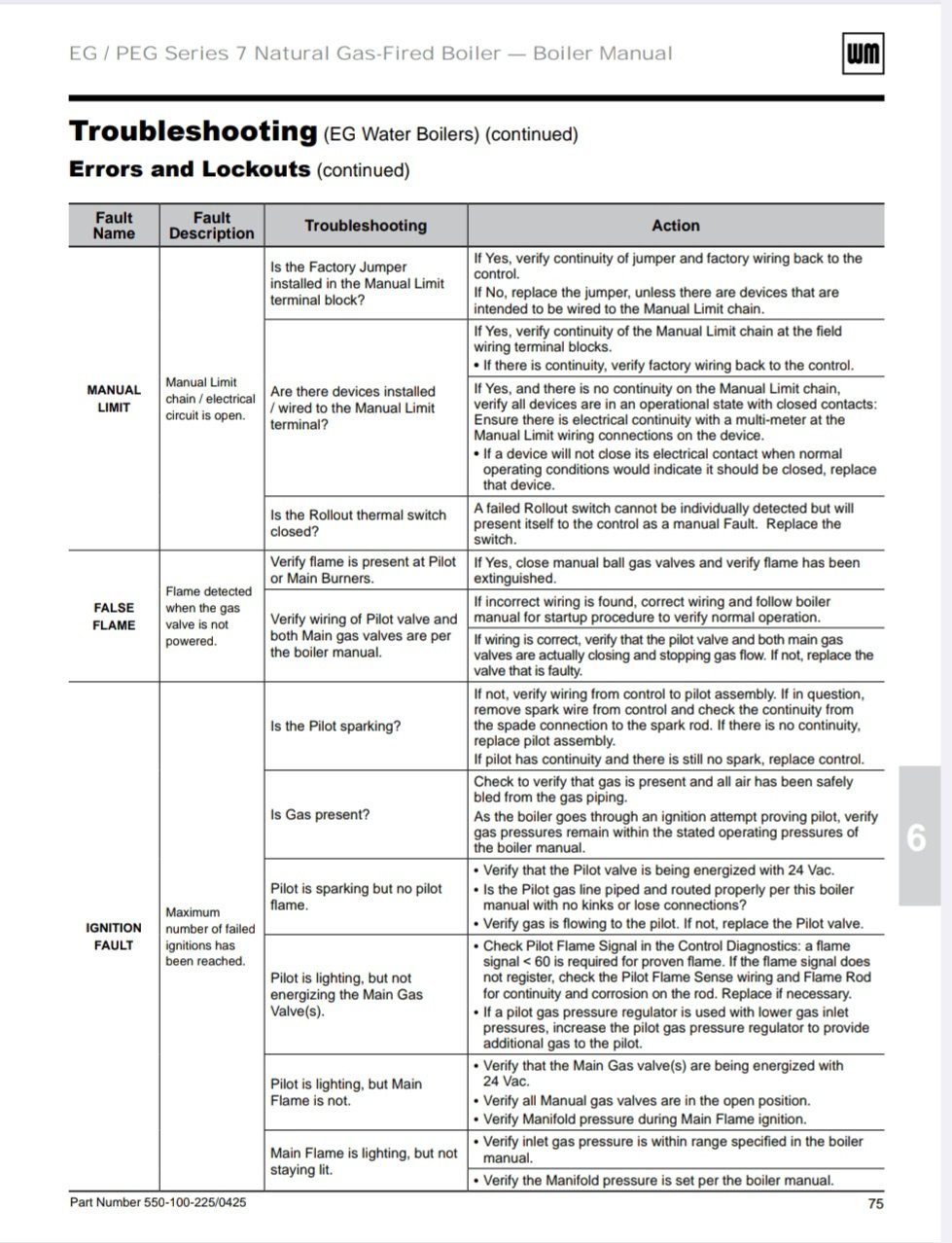

    What is the fault code when the rollout is tripped? Would it also indicate false flame?
    HVACNUT Member Posts: 7,338
    No. My WM Pro Tools app doesn't have the CGa Series 4 listed yet, but the CGi uses the same Unity-CI control board.
    You can turn off the power and remove the plate that the Rollout is attached to and set it aside so you can see if the pilot flame goes out when it's supposed to. When you turn the power back on to check, be careful to set the plate so the Rollout isn't touching anything but air. If it shorts out, its done. They used to give you a spare Rollout. You also should have the manual.

    thanks for sharing. i also remember seeing manual limit, is that another fault? need to pay close attention if it happens again.

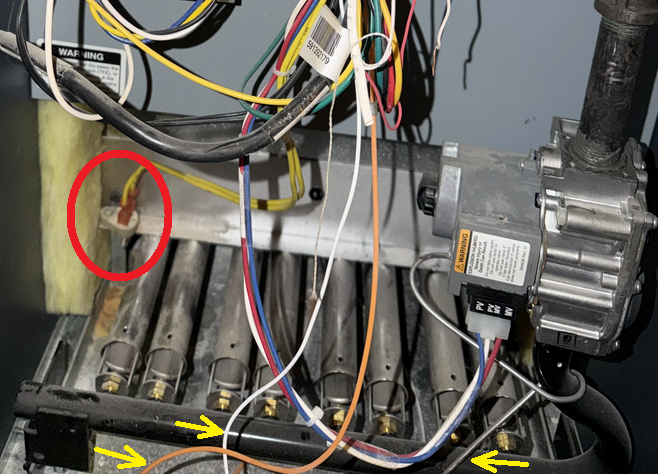

    109A_5 Member Posts: 3,737
    The Rollout thermal switch is actually a Thermal fuse. When tripped it would have to be replaced (Red Circle).
    These wires and aluminum tube (Yellow arrows) go down to the Pilot / Flame Sensor assembly.

    The thing is, the way I see it, the way gas valves are designed so the inlet pressure would actually help the valve close not keep it open. To me the only way the pressure would keep it open is if the pressure is so high it can actually open (or keep the valve open) against the solenoid's spring pressure. Maybe the internal regulator is bad, but still the incoming gas pressure should not be that high.
    And if the pressure was that high the burner may have other combustion issues.
