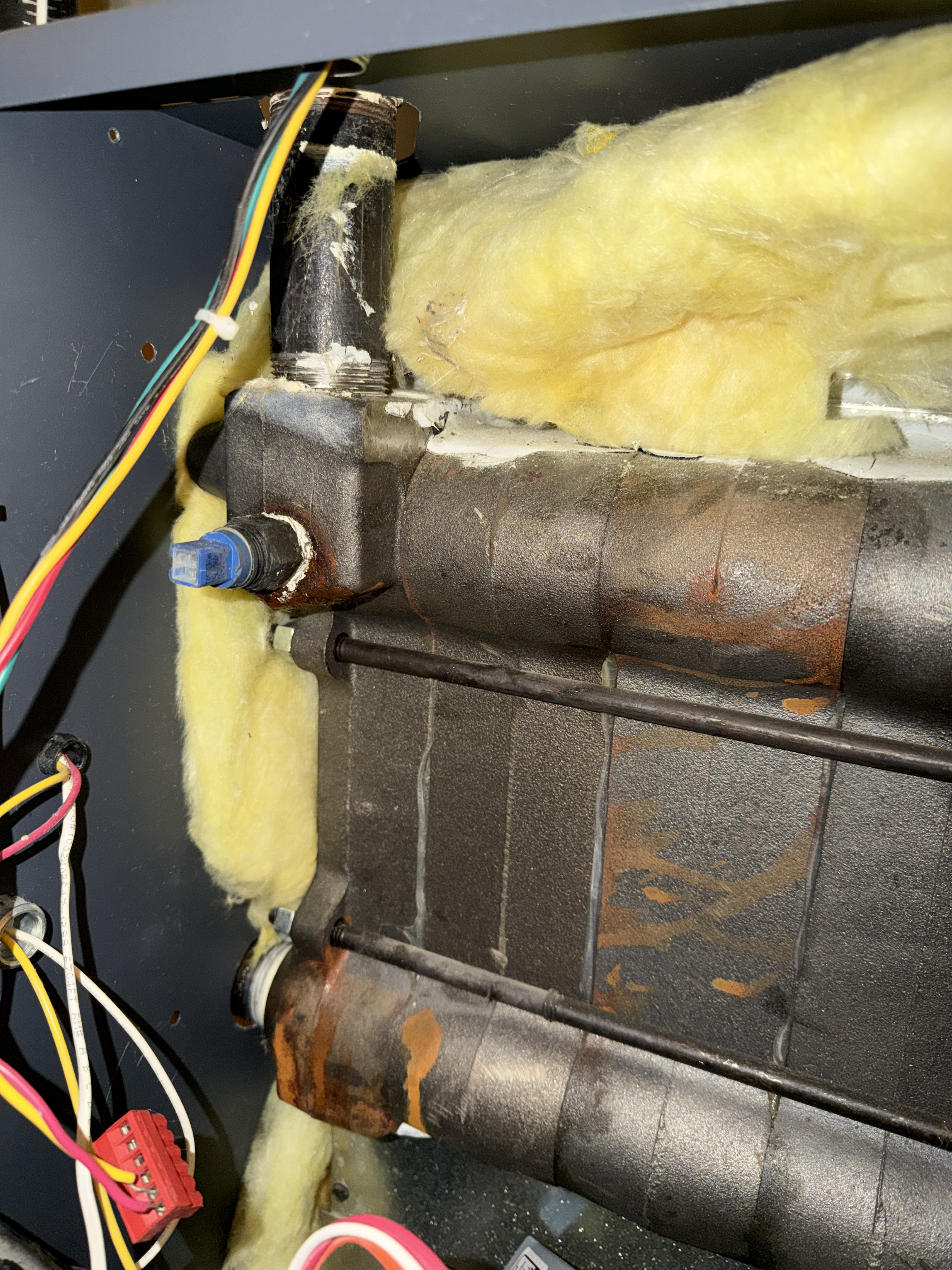

got a new boiler installed recently and today it threw a fault false flame. the installer came a notice there is water on the plug. the plug on the upper left and it leaks to the safety switch on the lower left. What do you call this plug? This was installed in the summer. Is it fixable?

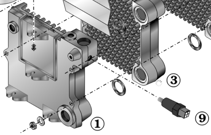

    HVACNUT Member Posts: 7,434
    The 4 pin plug with the 2 reds, a yellow, and a white is the Water Temperature/LWCO sensor.
    And it leaked to the bottom left? The Rollout Switch with the yellow wires?
    Once the Rollout blows, its done. It needs to be replaced.
    As far as the sensor, I wouldn’t assume that's where the leak generated. I'd look at the 3/4" tap in the block on top of the boiler, behind the supply pipe. There should either be an air eliminator there, or it should be capped. Something is leaking from up high and trailing down between the block and the jacket.
    I would start by shutting off the power. Fix the leak. Disconnect everything from the board, and dry everything well. Use a hair dryer if you want. Disconnect the sensor and dry the area and the connector. If the Rollout is still good, plug everything back in. Turn OFF the gas. Turn on the power. Raise the thermostat and see what the board does. If it goes through the whole trial for ignition sequence (without actual ignition, of course), then try with the gas on. ONCE!

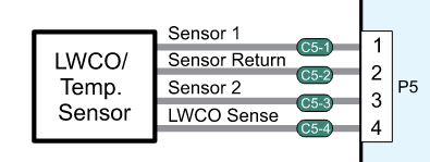

    WM would have the resistance specs on the sensor if needed.

    loadii Member Posts: 34
    The guy who installed the unit came out last night and tighten the temperature sensor and it worked whole day today. This evening it through the error again. I reset the boiler and it came back online.
    it looks like there is moisture around the teflone tape around the temperature senor.
    behind the supply pipe, it has an air eliminator.
    Will have them air eliminator.

    I turned the heat off and i can see water sipping out from teflone tape around the LWCO plugin.
    109A_5 Member Posts: 3,976
    If it is that sensor is leaking at the threads and not something up higher, at some point you probably will have to drain (or partially drain) the system, remove the sensor, inspect the treads (sensor and block), and if all looks good put it back in with tape and dope. This should be done before it turns into a corroded mess.

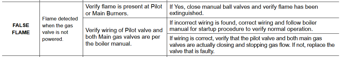

    The other thing is the "false flame" error means there is a flame when there should not be and the sensor leak may have nothing to do with that.

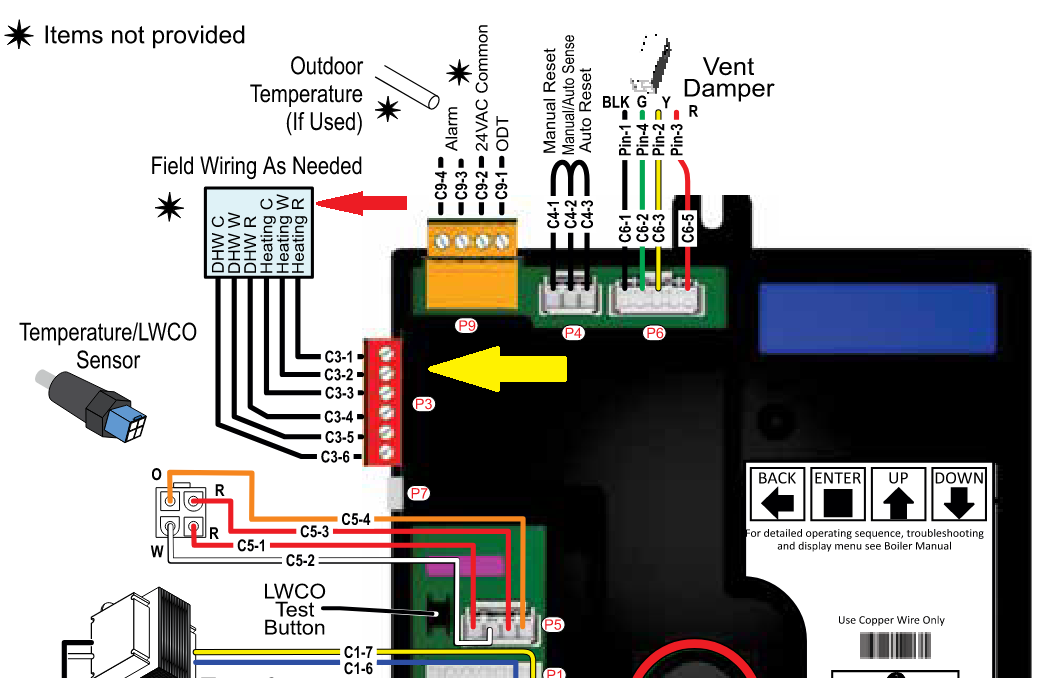

    also noticed there are 4 wires coming out from the guard dog low water device but only 2 wires are connected. it is connected to the transformer. where should the other 2 wires be connected to. please share any diagrams if you have it.

    From the manual for the boiler, looks like I can connect to the p4 limits. There is auto-reset and manual-reset. What is the recommended approach for the guard dog?

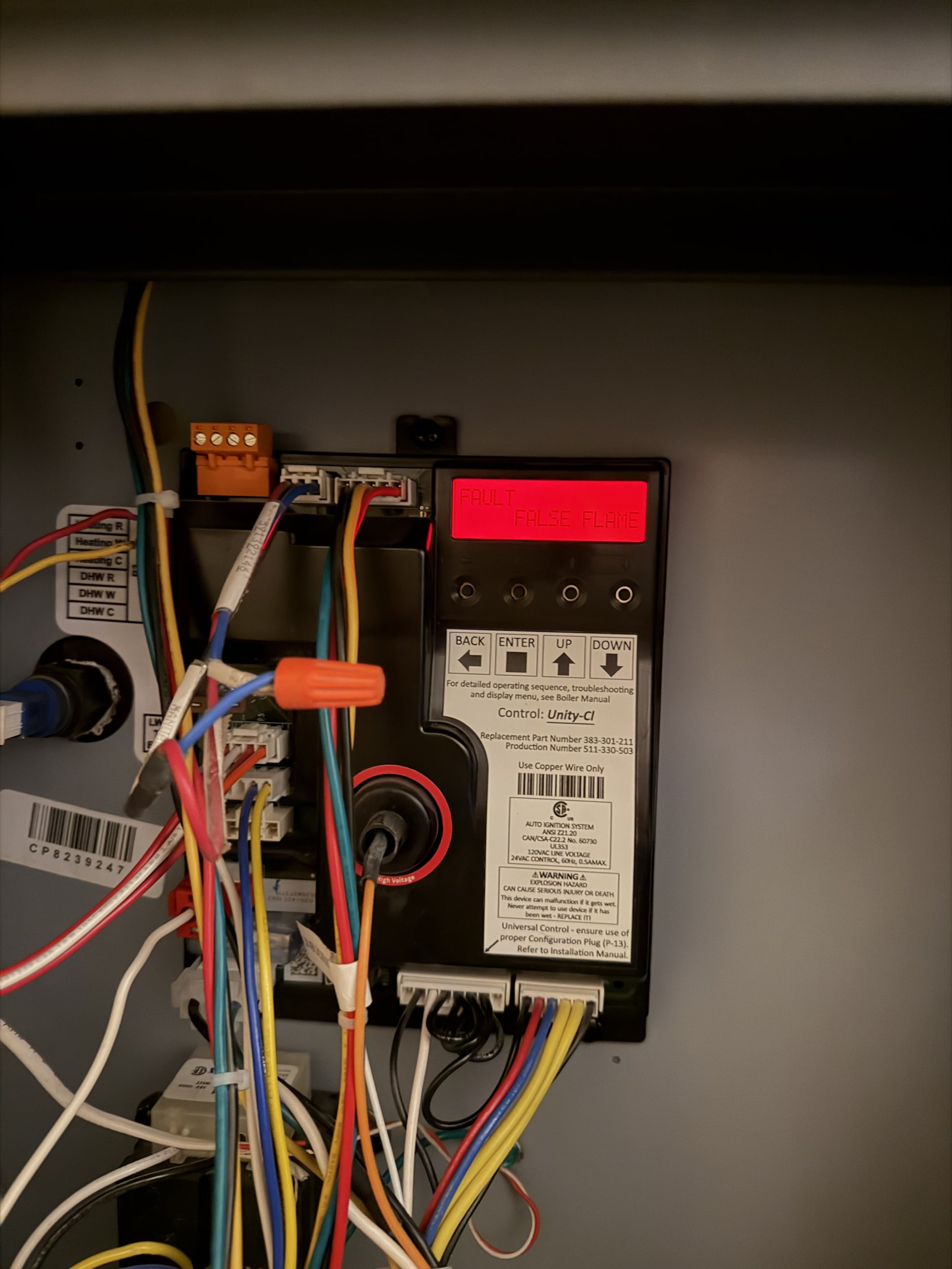

    don’t sessions any more water leak but it threw the same error again. where is the flame sensor located for the cga 5.
    Down in the burner compartment attached to the pilot assembly.
    The boiler is new, so unless its been burning terribly, I wouldn’t think that's the issue. What code is being displayed?

  • loadii
    The LCD turned red and it said fault false flame. I don’t recall seeing any code. Is the code on the lcd panel?

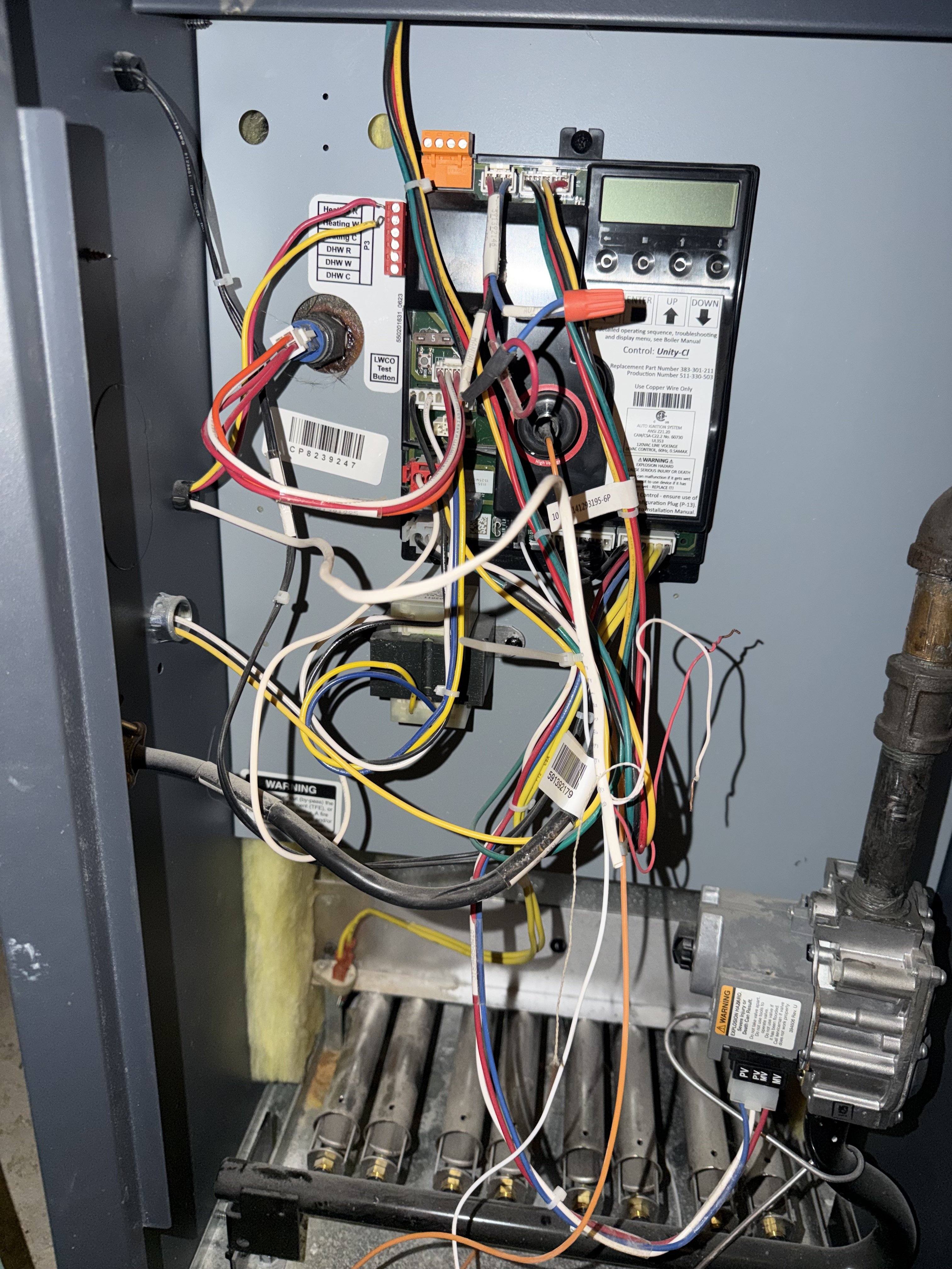

  • loadii
    thank you for the picture. super helpful. If the wiring is in question, would it cause intermittent faults? What is the most likely cause when it is intermittent?
    It would work for several hours with multiple cycles and then it would stop working. A reset will make it work again and the cycle repeats.
    I'd inspect the wiring for abrasions, being crushed or pinched and secure connections. I'd also inspect the insulation on the sensor probe for contamination or damage (the area of blueish shading in the image below), clean or replace if needed.
    If you have the proper test equipment (a multimeter or equivalent capable of DC microAmps) Flame Rectification current could be measured also.
    All assuming the flame goes out when actually expected every time, if a gas valve (main or pilot) is sticking open you may have to catch it in the act.

    Unfortunately, the CGAs are having issues with the left cast-iron sections leaking. On cold fires, water leaks directly on to the roll-out. We were forced to change five of them out under warranty. All within a year old.

    No. My WM Pro Tools app doesn't have the CGa Series 4 listed yet, but the CGi uses the same Unity-CI control board.
    You can turn off the power and remove the plate that the Rollout is attached to and set it aside so you can see if the pilot flame goes out when it's supposed to. When you turn the power back on to check, be careful to set the plate so the Rollout isn't touching anything but air. If it shorts out, its done. They used to give you a spare Rollout. You also should have the manual.

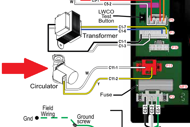

    The Rollout thermal switch is actually a Thermal fuse. When tripped it would have to be replaced (Red Circle).
    These wires and aluminum tube (Yellow arrows) go down to the Pilot / Flame Sensor assembly.

    It started last Saturday. contractor came and noticed there was water around the thread of the LWCO sensor. contractor tighten the sensor but then it tripped again but it didn't stopped the leak. contractor finally took the sensor out and apply dope and put it back in. immediately the next morning in tripped again but didn't see any visible water by the sensor. I reset the boiler, and since the reset, it has not trip again.
    When it had the leak, I can see water dripping on to the burner tubes. Also I can feel the water on the insulation behind where the circuit board was mounted.

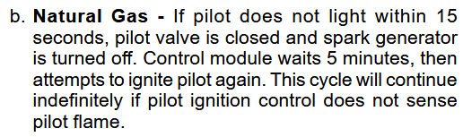

    What is the behavior when the boiler can't ignite? According to the documentation, it'll try multiple times and with some exponential backoff.

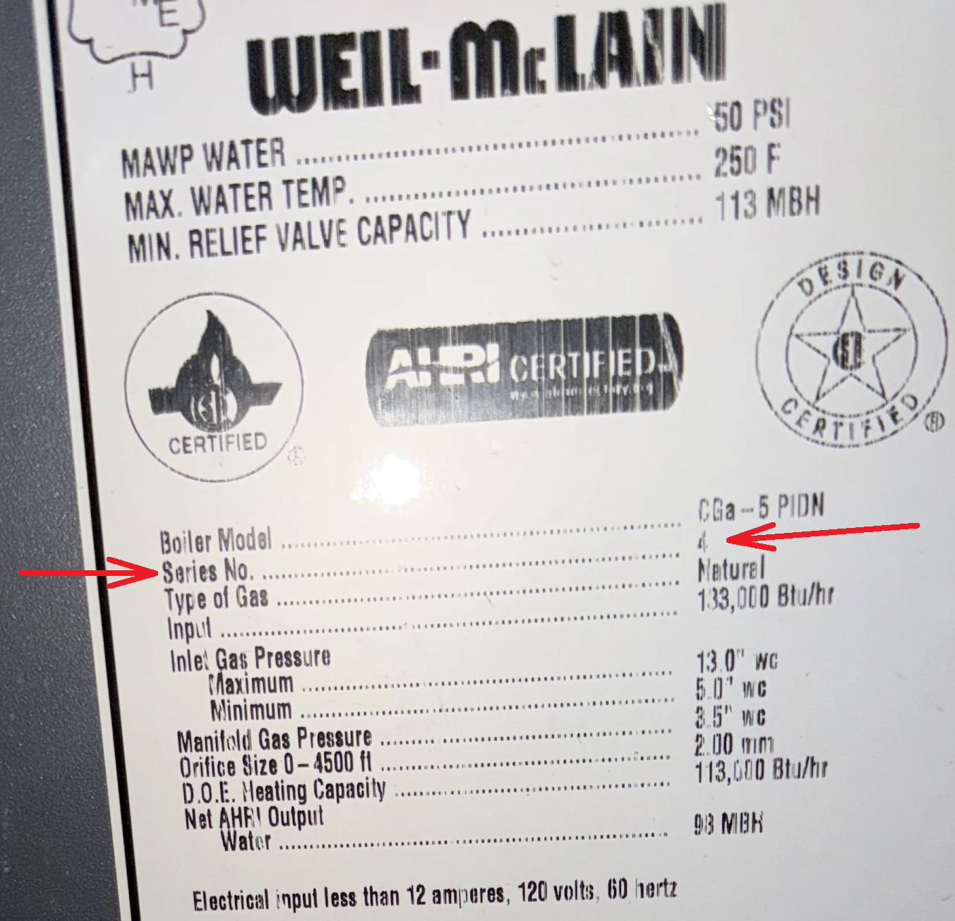

    With that controller is it a Series 3 or Series 4 ?
  • loadii
    i believe it is a series 3.
    ScottSecor
    Looks like a Series 4 to me. Curious, why do you think it is a Series 3 ?

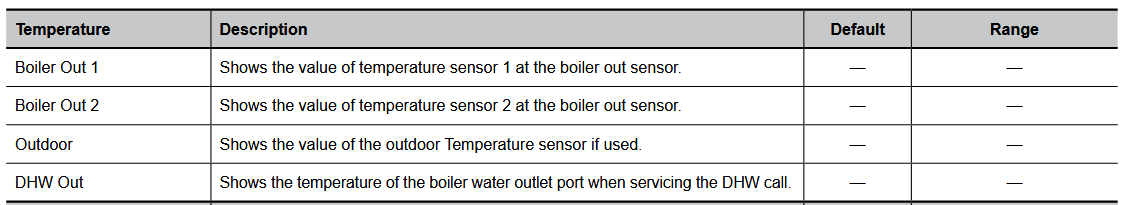

    The only two temperature sensors I saw in the diagram were in the LWCO sensor assembly. I believe they are for a sanity check, although I could not find an error message if one has an implausible reading or the differential is too wide.

    As far as the 'False Flame' error, is the boiler still under warranty ? If not the things mentioned previously in the thread should be checked, some of which may need some diagnostic equipment.
    For some reason the controller apparently thinks there is a flame present when their should not be. The actual presents of the flame may or may not be true.
