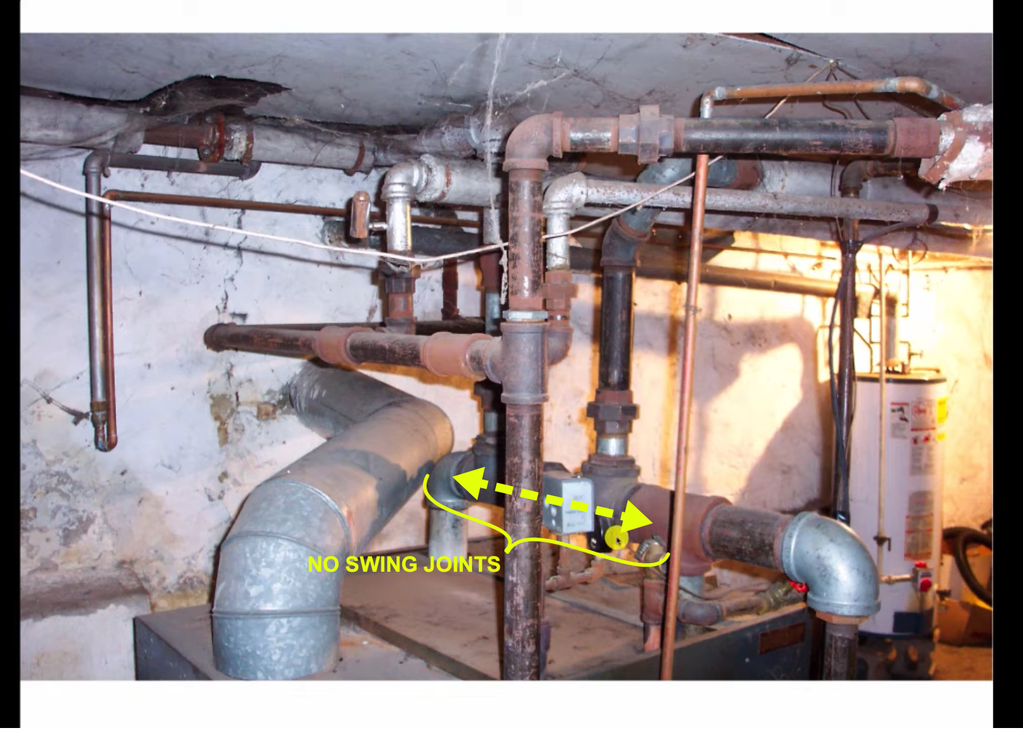

    EdTheHeaterMan Member Posts: 12,035
    edited February 4
    @Gabriel82 has been sharing information that is related to modulating condensing boilers. Of course knowing that it is a steam boiler would indicate that @ljh_2 has a boiler that has no secondary condenser coil or circulator pump. All this information does not relate to the problem with a cracked cast iron steam boiler. I don't mean any disrespect to @Gabriel82. It is kind of them to share their experience, however I don't want anyone to take the wrong information and use it to try to solve a problem they don't have.
    The first thing that comes to mind about 2 cast iron boilers "Cracking" within 10 years reminds me of this section of a Dan Holohan's Seminar on steam boilers. Look closely at the time stamp from 1:17:12 to 1:21:14. It stresses that the near boiler piping installed without swing joints can cause the sections to separate from the stress of the pipes expanding and contracting.
    There are no swing joint between the two boiler risers. this will cause the expanding pipe to act like a crowbar and make the sections separate in the direction of the yellow arrows.
    Click on the Seminar link and fast forword to 1:17:12 and watch the video to see what i'm talking about.
    Can you post a photo of your boiler's near boiler piping? If it is not correct and you put a new boiler in the same way, you may find that you will need another boiler in 10 years.
