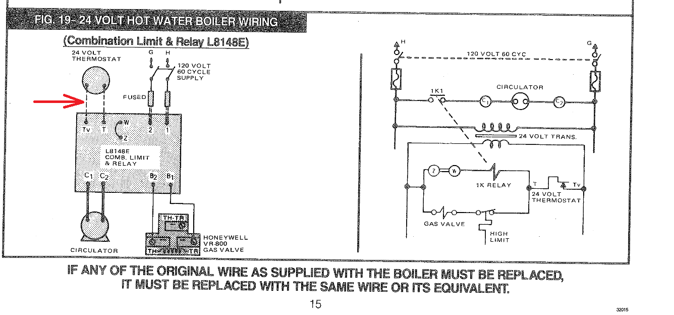

Hello – first post to this site …
I have a Crown Aruba boiler set up for radiant heat in the floor (3 zones) and it’s been working fine. However, there’s been a “mystery” ever since I had this place regarding the Zone valve. When the T-stat is kicked up a degree or 2 for a particular zone, the boiler fires up as well as the circulation pump. And the Zone valve (of course) opens during that time (I know because I wired in LED lights for all 3 zones to indicate the open/closed status).
As the system tries to reach the set point temp., it will come on and off several times. Initially, when the system shuts down, the Zone valve stays open! It may not be for several cycles (4-5?) until the Zone valve finally closes.
It’s almost as if the system is saying: “I’m trying to stably reach the set point temp. you chose on the T-stat but until I’m sure I can maintain that, I’m leaving the Zone valve open. Once I’m really sure, I’ll close the valve.”
If this is what’s really happening, where is the ultimate control for opening/closing the valve coming from? 🤔
Any thoughts are appreciated …

To me your use of the word system is too ambiguous, do you mean the boiler cycles on and off several times while the thermostat and the zone valve are still constantly calling for heat ?
If so I suspect the boiler is actually cycling on the high temperature limit. Since the zone can't dissipate the full capacity of the boiler.

OK to me the thermostat and zone valves are part of the 'system'. Since they are part of the heating 'system'. Other components of the 'system' are just a subset of the 'system'. Thanks for the clarification.
I still suspect the boiler is actually cycling on the high temperature limit. Since the heating zone can't dissipate the full capacity of the boiler. So the boiler (only) temporarily shuts down on High Limit.
As a test put one of your LED indicator devices across the High Limit switch in the Aquastat. So if the High Limit switch opens the LED turns on.
I would not leave the LED indicator device across the High Limit switch in the Aquastat permanently unless you are 100% confident that a failure of the LED indicator device can't disable the High Limit switch functionality.

Typically with a multi-zone system the thermostat(s) control the zone valve(s). The 'End Switch' (Auxiliary Switch) of all the zone valves are wires in parallel (Red wires). With any thermostat call for heat the zone valve opens and the zone valve's 'End Switch' closes, that activates the Aquastat and the Aquastat then activates the boiler's burner and also activates the circulator. The Aquastat is usually mounted to the boiler so it can monitor the boiler's water temperature.
The Aquastat provides safety and control functionality.
If the Aquastat's High Limit switch opens (boiler's water has reached the high limit temperature) it usually just shuts off the boiler's burner and the circulator continues to run so the hot water in the boiler can continue to heat the calling zone(s).
If the call for heat is still active and the boiler's water temperature drops enough the High Limit switch will close to activate the burner again.
One zone of a multi-zone system is usually just a fraction of the boiler's capacity so the boiler's burner may raise the boiler's water temperature faster than the calling zone can cool the water so the High Limit switch may trip.
You system may be different. Pictures of your system may help to clear up some of the questions.

The statements read this way to me:
- Call for heat and zone valve LED indicates a call for heat
- Zone valve opens (end switch signals boiler control)
- Boiler operates both the burner and the circulator pump
- Burner and pump both stop for some time but the LED still indicates the call for heat and the open zone valve
- The burner and pump come back on for some time and the LED still indicates the valve is open
- The burner and pump come back on for some time and the LED still indicates the valve is open.
- Steps 4, 5, 6, and 7 continue for several cycles.
- Call for heat is satisfied and the LED goes out indicating the valve closes.
This is not how it should work. The circulator pump should not stop while there is still a call for heat and the valve is open. If this is actually happening, then the boiler control is not wired properly or is defective.
I might suggest that the circulator is still operating and that is because those circulator pumps are very quiet and may appear as if they are not operating when they actually are operating. The following is a proper operation for your Aruba Boiler.

Thanks for all comments since my last post and I have an important update.
Firstly, as to the term "Aquastat", I was unfamiliar with that term when 109A-5 first brought it up. IMHO, "Aquastat" is not a generic term, but seems more like something that derived from a commercial source or a term used within the HVAC profession and it just caught on. There must be a better, more generic name for that controller box that is (in my unit) actually mounted on the end of a 1½” outlet pipe (off a Tee) for heated water to be distributed to the zones. (And when I earlier wrote (referring to the zone valve controllers): “They are mounted directly on the 3 Cu pipes that release hot water back through the (back) wall and into respective zones.” That should have been: “They are mounted directly on the 3 Cu pipes that allow hot water to return from the (back) wall and to return to the boiler”. (I had it backwards.)
Now that I’ve done the test this morning, I now realize that I may have no problem at all. Stay with me.
With T-stat for Zone 1 at 62°, I bumped it up to 64°. The entire system kicked on and, after ~25 minutes on that “climb”, it shut down (T-stat temp. reading 63°). The Zone valve remained open but I noticed something else I had never noticed:
The (German) Grundfos circulation pump remained on !!! This was exactly as posited by MEC and 109A-5 upstream in this thread. (Mechanically, this makes perfect sense in that, even if the boiler shuts down for “safety” reasons, the circ. pump should remain on to distribute heat out into the zone circuit.) So why did I lie and say that the entire system shuts down with the Zone valve remaining open? Because that great German circ. pump is SO QUIET it it’s imperceptible to the ear. So how did I discover it actually continued to run after the boiler shut down? I noticed years ago that I could not – with my ear – tell whether the pump was running (especially when the boiler is fired up). So I wired in (in series) a nifty 0-3 amp ammeter (mounted on a bracket right on what you like call the Aquastat). But I failed to check it when the boiler shut down – MY BAD !!
So in this morning’s test, as Zone 1 was slowly climbing to the set point (64°), the boiler shut down several times while the T-stat temp. reading stayed 63°. At these shut downs, the Zone valve remained open and the circ. pump continued to quietly run, pulling between 0.5a to 0.7a.
When the boiler would shup down, btw, the temp. gauge for the boiler read 165° - which I’m presuming is ideal or certainly acceptable.
Had I checked to see that the circulation pump remained on after the boiler shut down with Zone valve remaining open, I never would have made this post. Again – MY BAD !! However, I learned a lot of good stuff from various contributors - all of which I really appreciated. 😊

Aquastat I guess is a Honeywell (now Resideo) product name. Another manufacture calls a box with similar functions a Hydrostat. I would encourage you to learn more about your system so if it ever has a problem you can maybe repair it yourself. Every hot water system is kind of unique, but typically uses similar components to build it up. System pictures often greatly help us here to identify things.
If you take the cover off of your Aquastat (turn the system's AC power off first) the part number may be inside (like L8148E), there may be information on the backside of the cover also.
Here is an example below;
One Pipe System0 -
A more generic name may be a specialized temperature limit and relay or "Combination Limit & Relay".
Seems every trade has specialized names for stuff they deal with every day. Often it is just what the manufacture call them.
One Pipe System0 -
Aquastat is a Honeywell trademark name that has been colloquialized to mean immersion temperature controller, hydronic temperature limit control, or boiler high-limit / low-limit controller, including triple high-limit/low-limit, burner, and circulator relay controls.
In the case of your boiler, the generic term for your L8148 Aquastat relay is: immersion temperature high-limit, burner, and circulator relay, to be perfectly technical. That would be different from the L8124, which you might find on a boiler that has a tankless coil and therefore requires a low limit. The generic name for that control would be immersion temperature high-limit, low-limit, burner, and circulator relay, to be perfectly technical.
