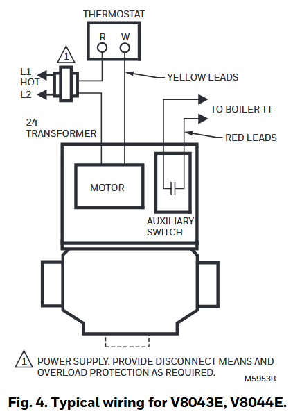

    Typically with a multi-zone system the thermostat(s) control the zone valve(s). The 'End Switch' (Auxiliary Switch) of all the zone valves are wires in parallel (Red wires). With any thermostat call for heat the zone valve opens and the zone valve's 'End Switch' closes, that activates the Aquastat and the Aquastat then activates the boiler's burner and also activates the circulator. The Aquastat is usually mounted to the boiler so it can monitor the boiler's water temperature.
    The Aquastat provides safety and control functionality.
    If the Aquastat's High Limit switch opens (boiler's water has reached the high limit temperature) it usually just shuts off the boiler's burner and the circulator continues to run so the hot water in the boiler can continue to heat the calling zone(s).
    If the call for heat is still active and the boiler's water temperature drops enough the High Limit switch will close to activate the burner again.
    One zone of a multi-zone system is usually just a fraction of the boiler's capacity so the boiler's burner may raise the boiler's water temperature faster than the calling zone can cool the water so the High Limit switch may trip.

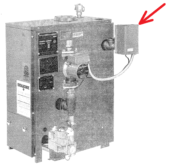

    mattmia2 Member Posts: 17,563
    can you show us what's inside the front cover? there is usually a built in aquastat that is in a well somewhere on the front of the boiler packaged with the boiler.

    I'm thinking you don't know all the correct names of the components making up your heating system. The "Honeywell (V80423E1012)" are the zone valves. The Red arrow in the image below points to the Aquastat and there is usually only one.
    109A_5 Member Posts: 4,226
    I suspect your system is like this image (it may not be) and the multiple thermostats and zone valves are inserted at the red arrow.
    I believe your system may be like or similar to this, showing only 2 of the 3 thermostats and zone valves for drawing simplicity.

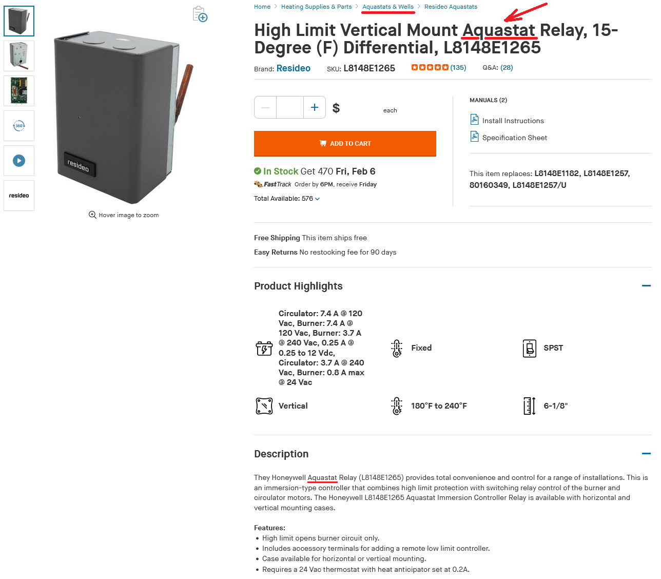

    Aquastat I guess is a Honeywell (now Resideo) product name. Another manufacture calls a box with similar functions a Hydrostat. I would encourage you to learn more about your system so if it ever has a problem you can maybe repair it yourself. Every hot water system is kind of unique, but typically uses similar components to build it up. System pictures often greatly help us here to identify things.
    If you take the cover off of your Aquastat (turn the system's AC power off first) the part number may be inside (like L8148E), there may be information on the backside of the cover also.

    A more generic name may be a specialized temperature limit and relay or "Combination Limit & Relay".
    Seems every trade has specialized names for stuff they deal with every day. Often it is just what the manufacture call them.
    EdTheHeaterMan Member Posts: 12,534
    edited February 4
    Aquastat is a Honeywell trademark name that has been colloquialized to mean immersion temperature controller, hydronic temperature limit control, or boiler high-limit / low-limit controller, including triple high-limit/low-limit, burner, and circulator relay controls.
    In the case of your boiler, the generic term for your L8148 Aquastat relay is: immersion temperature high-limit, burner, and circulator relay, to be perfectly technical. That would be different from the L8124, which you might find on a boiler that has a tankless coil and therefore requires a low limit. The generic name for that control would be immersion temperature high-limit, low-limit, burner, and circulator relay, to be perfectly technical.
    I kind of like the fact that the trade has decided to use Aquastat to mean all types of immersion temperature controls. That term rules out refrigerant immersion temperature controls, chemical immersion temperature controls, and just about every other temperature control that has nothing to do with hydronic heating.
    I also like to think of it the same way I like Royal® brand gelatin dessert, but I still call it Jell-O®, which is a trademark and brand name of a similar product made by an entirely different company.

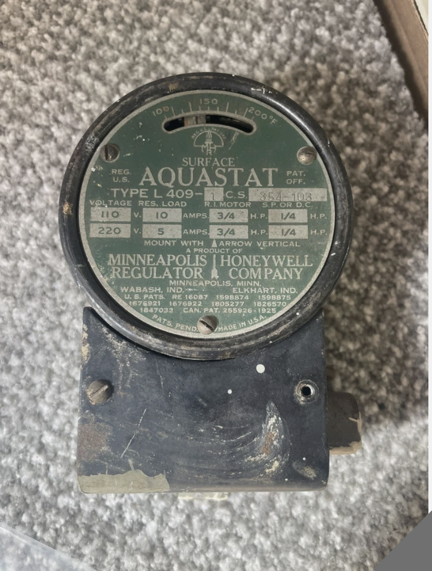

    You will need to go back to the 1920s to see the word Aquastat printed on a control cover.
    This was one that you might strap on to a pipe that is coming out of an old converted coal boiler. That's because Coal Boilers of the 1920s didn't expect to have oil burners or gas burners that needed high limits connected to them so there was no place to "Insert" the temperature probe. So the temperature was measured by the surface temperature of the hottest pipe near the boiler.
