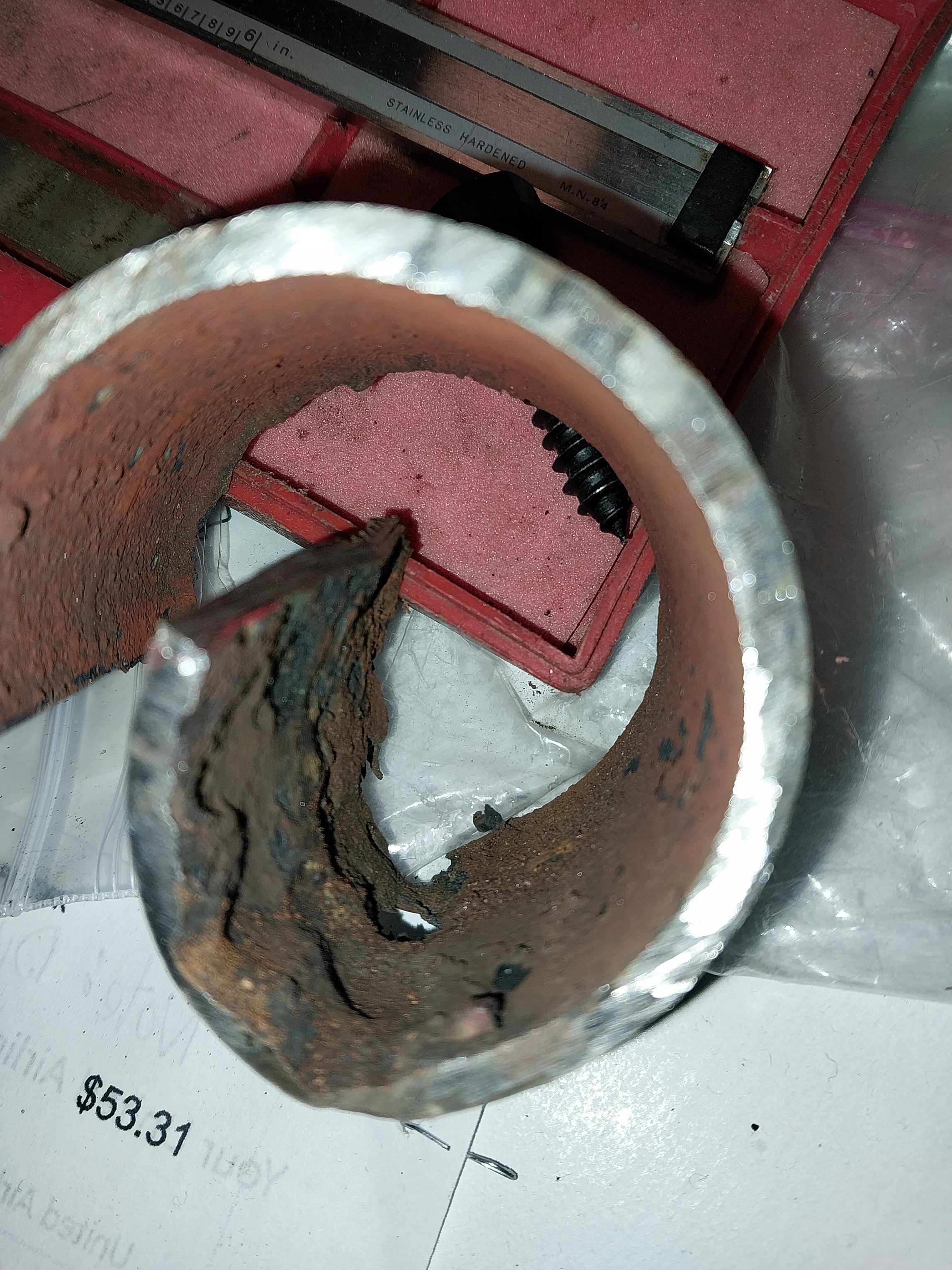

Good points, but also carbonic acid created in steam mains and dry returns (mine are brass though which is good) by the constant exposure of basically distilled water to air, which has a high affinity to absorbing CO2 which leads to carbonic acid causes corrosion of black iron pipes on the interior. I posted this elsewhere but take a look at this from my 16 ft. rotted steam main replacement job I did. Where did this rusted material go to? I think we all know the answer to that.
