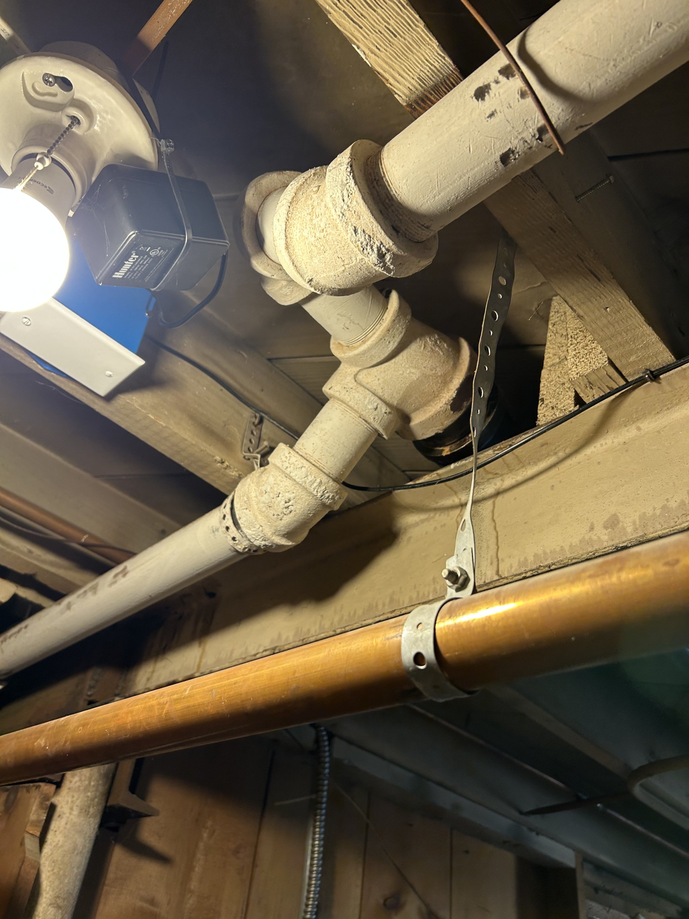

Thanks @Captain Who all good. A few people pointed out the option of adding a vent at the end cap of the abandoned blue line run but it's not an option. The cap was where a radiator in our dining room used to be, as in, they completely removed an entire heat source from half the house (the morons removed a radiator from the dining room and kitchen during reno) Perhaps one of the most insane things I've ever seen, so now half of the 1st floor is without a heat source…. INSANE. So I'm keeping it open to add a radiator back to the dining room at some point. No big deal, what's a few thousand dollars here and there?
Concerning the pitch of the piping, I did as much as I had access to (asbestos, bulkheads, walls, etc) and just said it is what it is. I strapped a few places I could and called it a day. I think I sill have some wrap insulation on hand, and if it's the right diameter I'll add it to my return pipe.
@Day_Tripper You and I could be in the same boat as far as maybe having Hartford Loop problems where it is too high. See Hartford Loop thread for my mickey mouse setup. I would prioritize checking and fixing that. I am relatively OK keeping my water level about 1 in. higher than NWL but only when water is pristine clean and relatively low in TSS particulates. Your setup with the shared main and returns with Tees I'm sure makes your system more unpredictable as far as balancing steam and return of condensate. When you have a threaded Tee I don't know how it will be possible to have downward pitch leaving both legs unless you have pipes that were purposely (or happy accident) threaded crooked and you index them properly for pitch. Your Blue line may be substantially counter-flow as a result.
