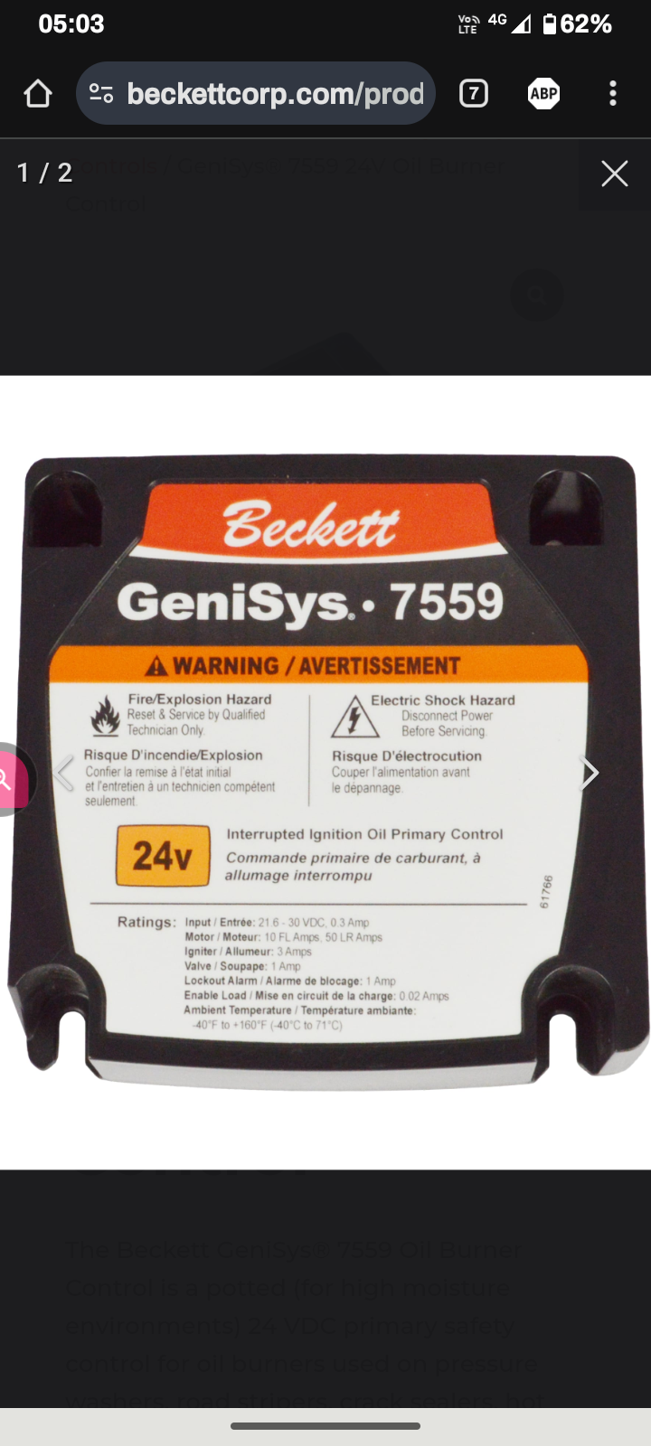

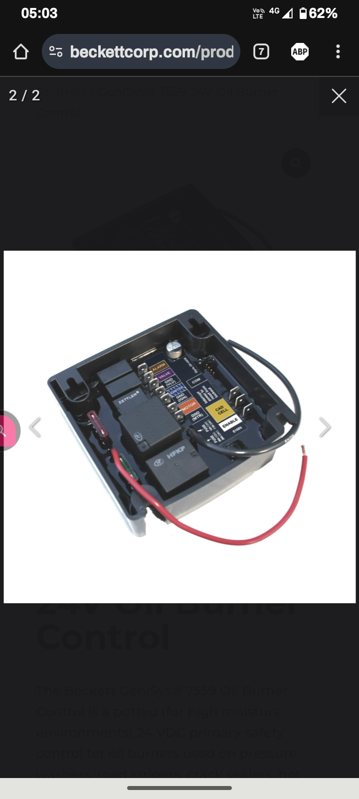

Can someone tell me if these motor/rotor problems happen in the 24V dc beckett burner?
Around here,in Romania Riello and some german brands(with blue flame low nox) are the most seen in oil or natural gas boilers.
In all honesty I haven't even seen a Beckett burner.
Although the way is designed seems a lot simpler to service than many other brands!
Thank you!
Beckett GeniSys® 7559 Oil Burner Control
https://www.beckettcorp.com/product/genisys-7559-24v-oil-burner-control/
