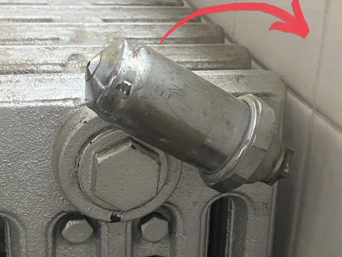

Looking for potential remedies for "sounds" from some of my radiator vents. I have a one pipe steam system…when i turn the heat up, especially in the morning…some radiators sound like an airplane taking off…hissing noises..Not all the radiators…just a few. side note..it seems to be from the radiators that look like "hot water radiators" and not the steam radiators…house over 100 years old. suggestions? different type of vents (sizes?). Thanks Alan

    here is the one radiator….a bathroom ….i have a cover over it….so you can see the vent and the tough spot it is in…any suggestions

    I believe the experts here might bring up 2 points for starters, I'll let them verify that first………
    1. The vent should not be at the top of the radiator, should be mid position of the radiator
    2. The vent is not vertical, it's turned to a certain degree
    ethicalpaul Member Posts: 8,359
    The location on the radiator isn't optimal, but is not affecting the sound.
    But the rotation of them could be causing them to make noise. Rotate them to vertical like @geemalar said

    with that "bolt" there, i cannot screw in the vent to get it vertical……do i have to drill a hole lower and then plug that top hole?

    If it's the pictured radiators you are talking about, they are fine for steam.
    If your upcoming photo of the vent side of one of those radiators shows no other port, then you can put a short 1/8" nipple with a 1/8" coupler and extend the vent away from the radiator a bit.
    But why can't you rotate them clockwise away from the bolt to get them vertical? I'm not understanding

    Vent should be below the halfway point on the radiator but to sort out whether the orientation is an issue with the vent you could for a few bucks get a 1/8" npt nipple and coupling to extend the vent away from the radiator a bit.

    1. so take a look at photo 2…that "nut" pertrudes out so i cannot turn the vent anymore
    2. i have a cover over that radiator so if i put on an extension then a vent,the cover will not fit …the cover is already pretty close to the side

    1. Rotate it clockwise to vertical (or are my eyes deceiving me in some way??)
    2. You can try other models of vents. Try a Maid O' Mist, they are pretty good and not pricey

    thanks….sorry…it is not turned all the way vetical because i have a cover that it is just over the top of the radiator…so if i turn the vent…it would hit the radiator….i think these wood covers were done way before my time!

    OK but you can at least rotate one of them vertically with the cover off to see if it affects the sound. If not, we can drop that item from our list of things to do
