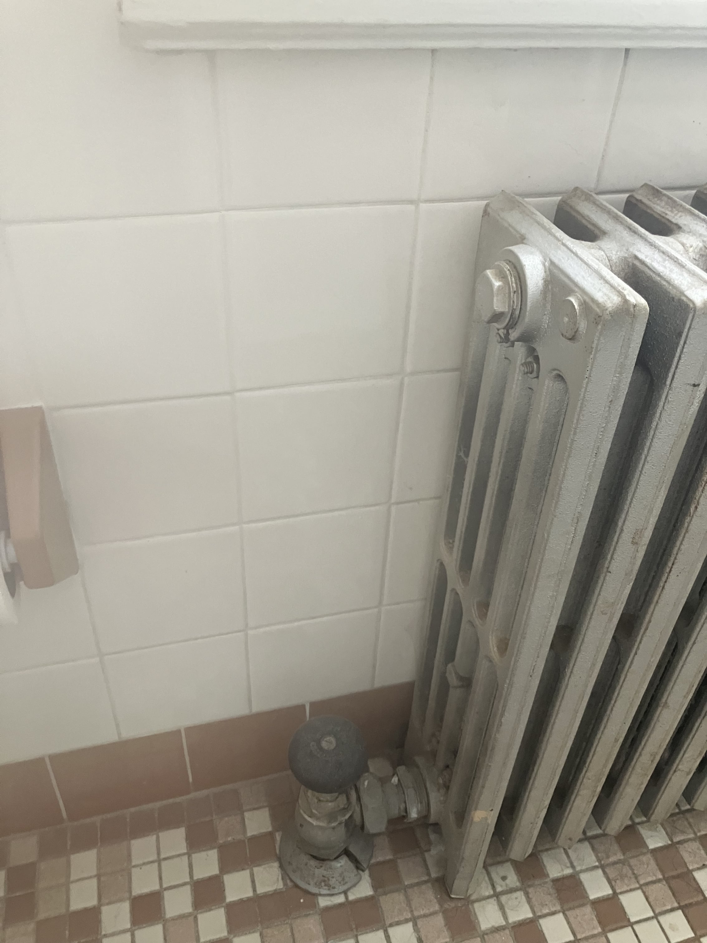

Looking for potential remedies for "sounds" from some of my radiator vents. I have a one pipe steam system…when i turn the heat up, especially in the morning…some radiators sound like an airplane taking off…hissing noises..Not all the radiators…just a few. side note..it seems to be from the radiators that look like "hot water radiators" and not the steam radiators…house over 100 years old. suggestions? different type of vents (sizes?). Thanks Alan

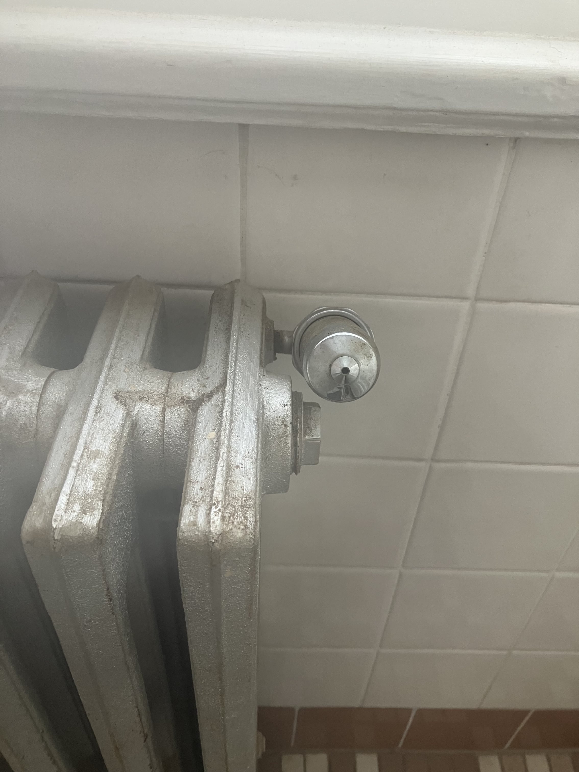

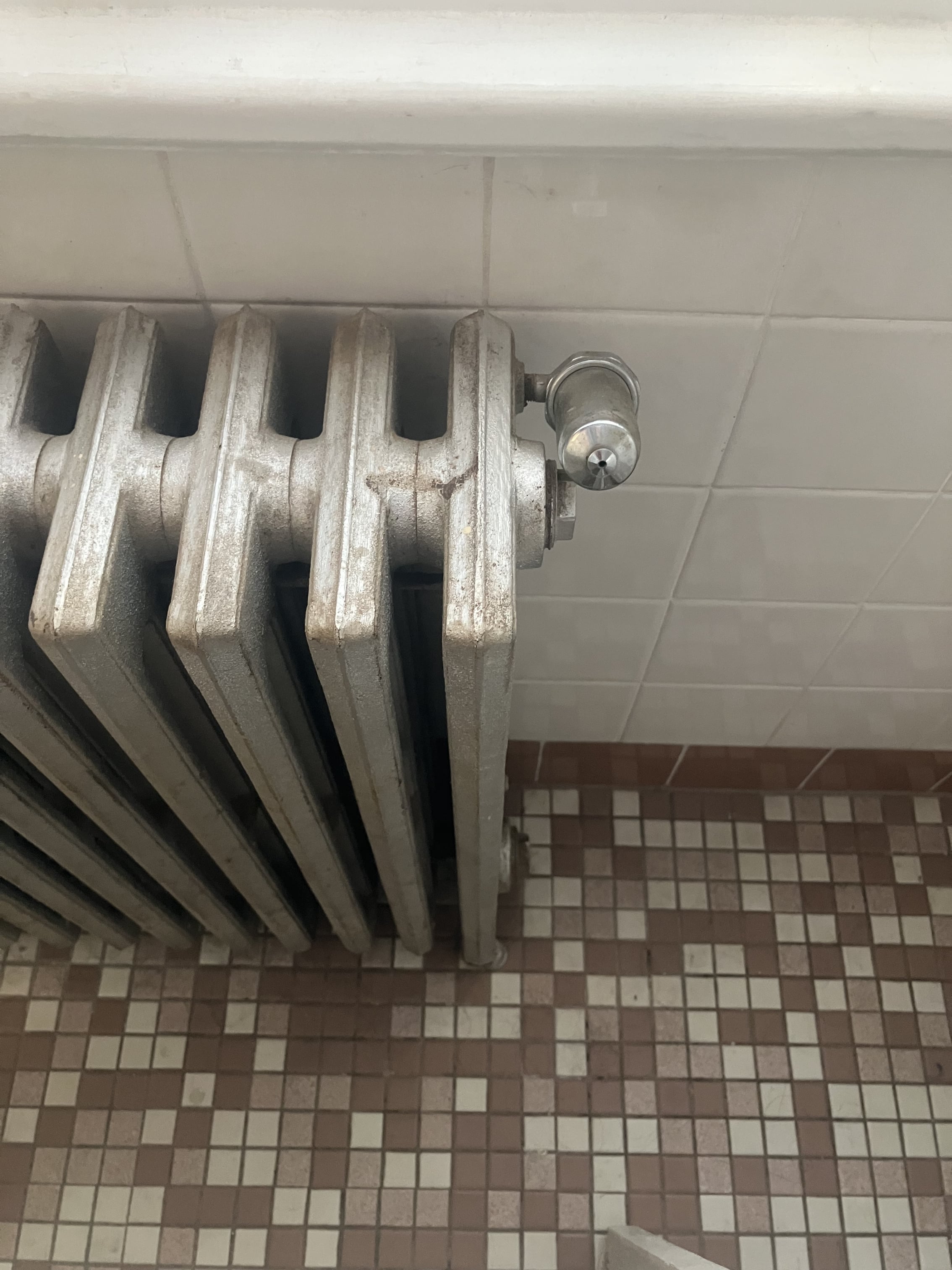

    alanm Member Posts: 149
    here is the one radiator….a bathroom ….i have a cover over it….so you can see the vent and the tough spot it is in…any suggestions

  • geemalar
    geemalar Member Posts: 98
    I believe the experts here might bring up 2 points for starters, I'll let them verify that first………
    1. The vent should not be at the top of the radiator, should be mid position of the radiator
    2. The vent is not vertical, it's turned to a certain degree
    ethicalpaul Member Posts: 8,741
    The location on the radiator isn't optimal, but is not affecting the sound.
    But the rotation of them could be causing them to make noise. Rotate them to vertical like @geemalar said

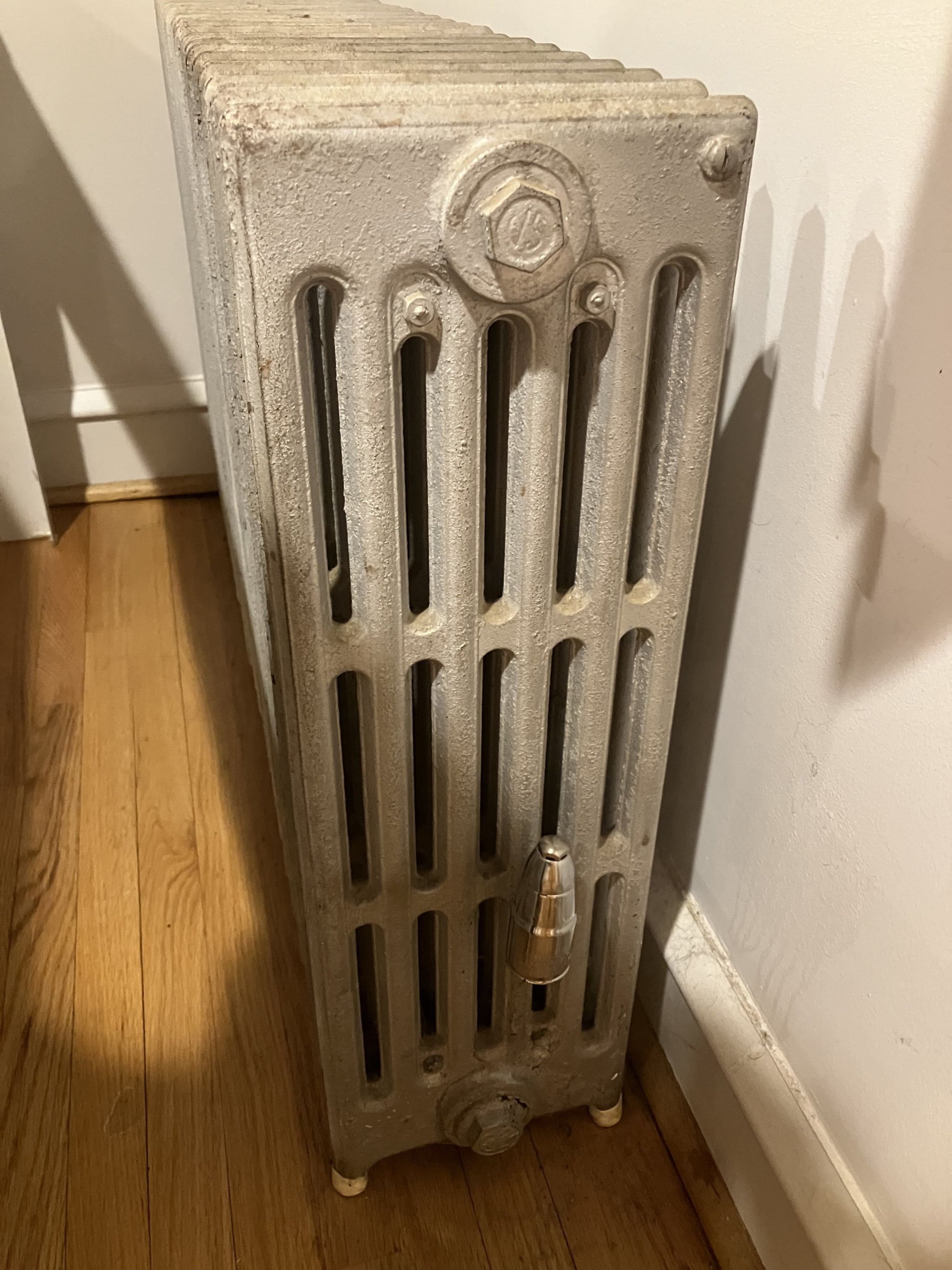

    with that "bolt" there, i cannot screw in the vent to get it vertical……do i have to drill a hole lower and then plug that top hole?
    Please show us a picture of the vent side of one of those radiators
    If it's the pictured radiators you are talking about, they are fine for steam.
    If your upcoming photo of the vent side of one of those radiators shows no other port, then you can put a short 1/8" nipple with a 1/8" coupler and extend the vent away from the radiator a bit.
    But why can't you rotate them clockwise away from the bolt to get them vertical? I'm not understanding

    thanks…so a few follow up to questions:
    1. so take a look at photo 2…that "nut" pertrudes out so i cannot turn the vent anymore
    2. i have a cover over that radiator so if i put on an extension then a vent,the cover will not fit …the cover is already pretty close to the side
    edited January 27
    1. Rotate it clockwise to vertical (or are my eyes deceiving me in some way??)
    2. You can try other models of vents. Try a Maid O' Mist, they are pretty good and not pricey

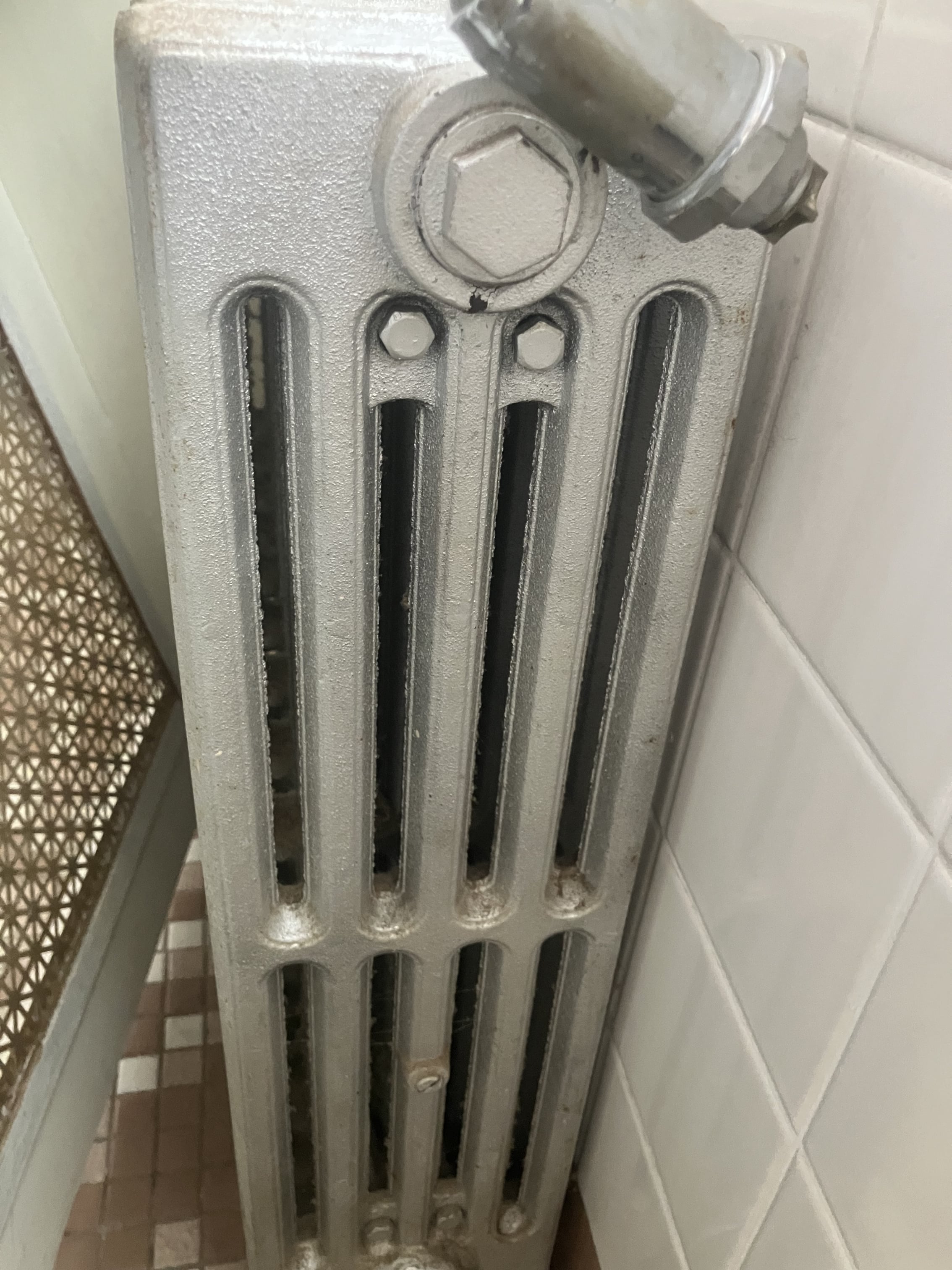

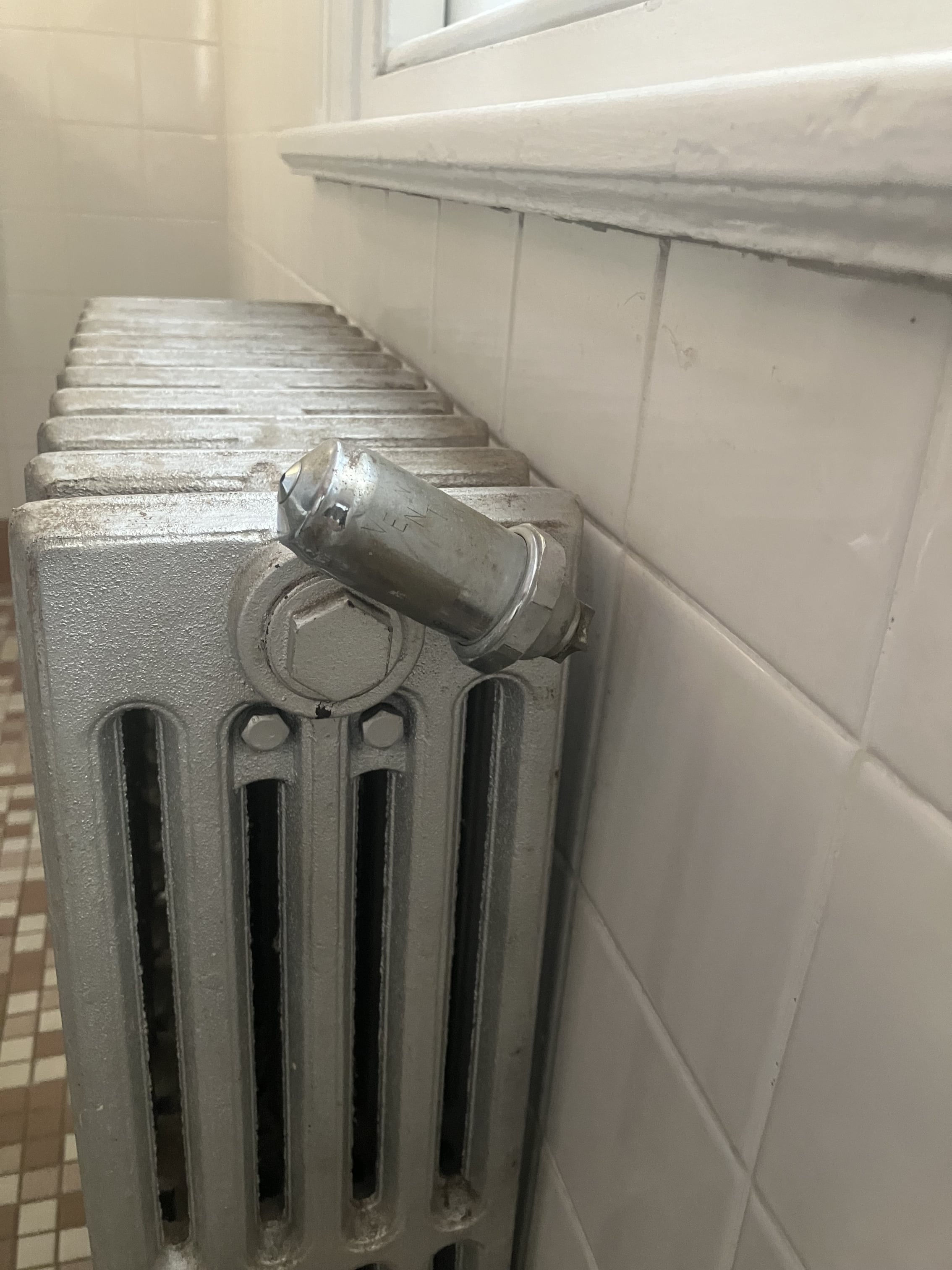

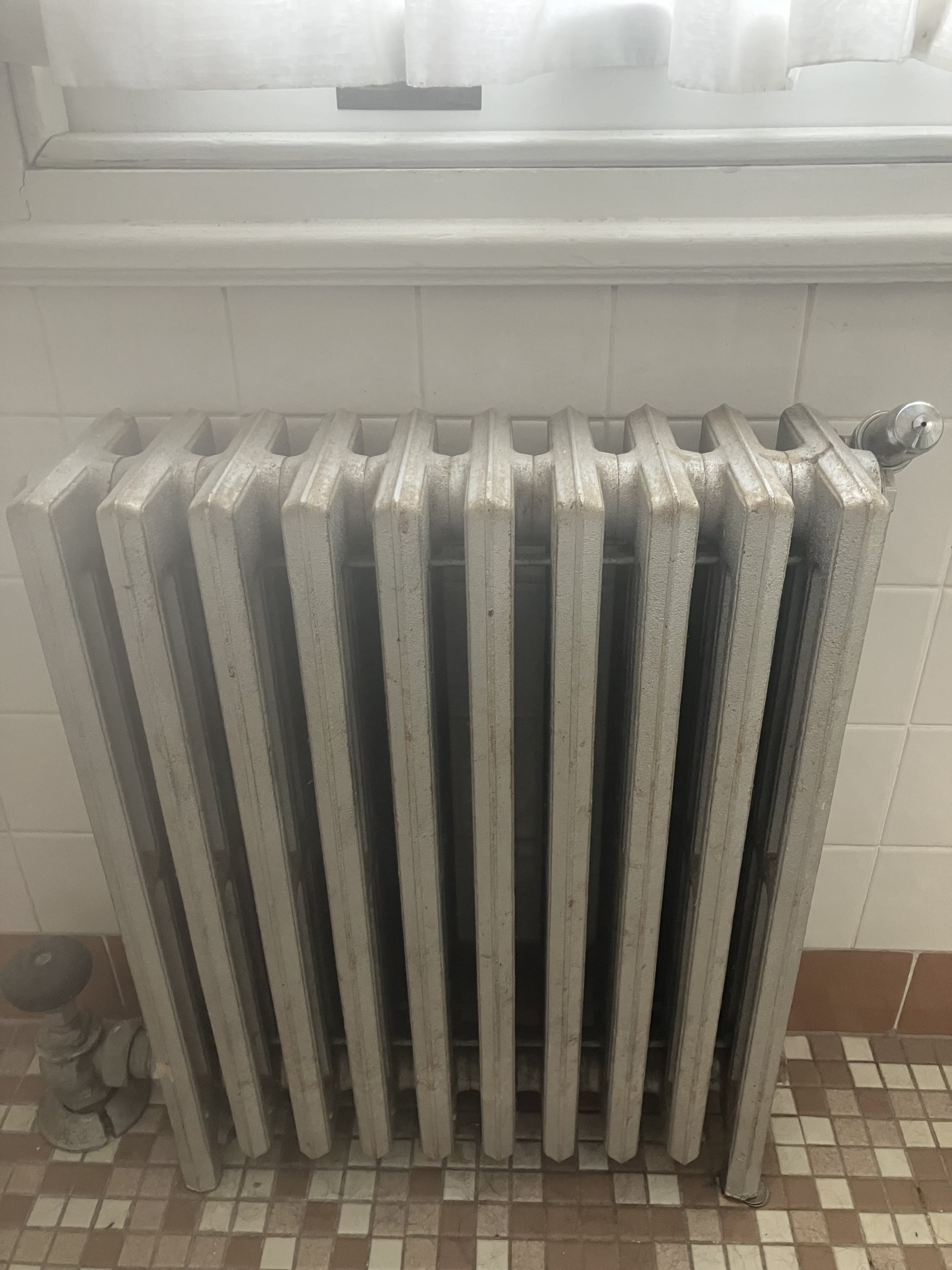

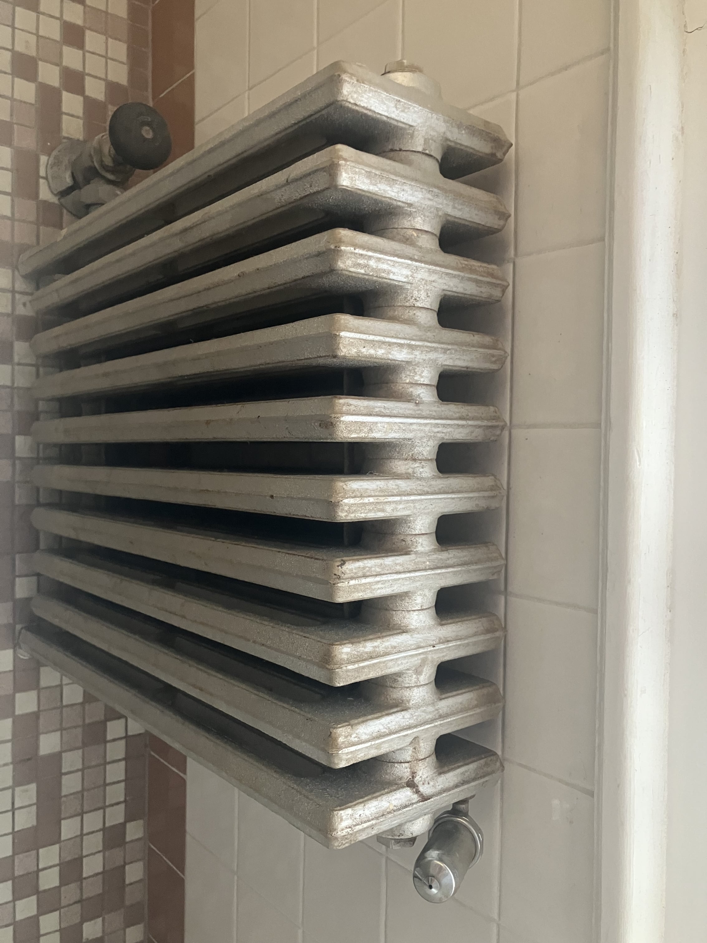

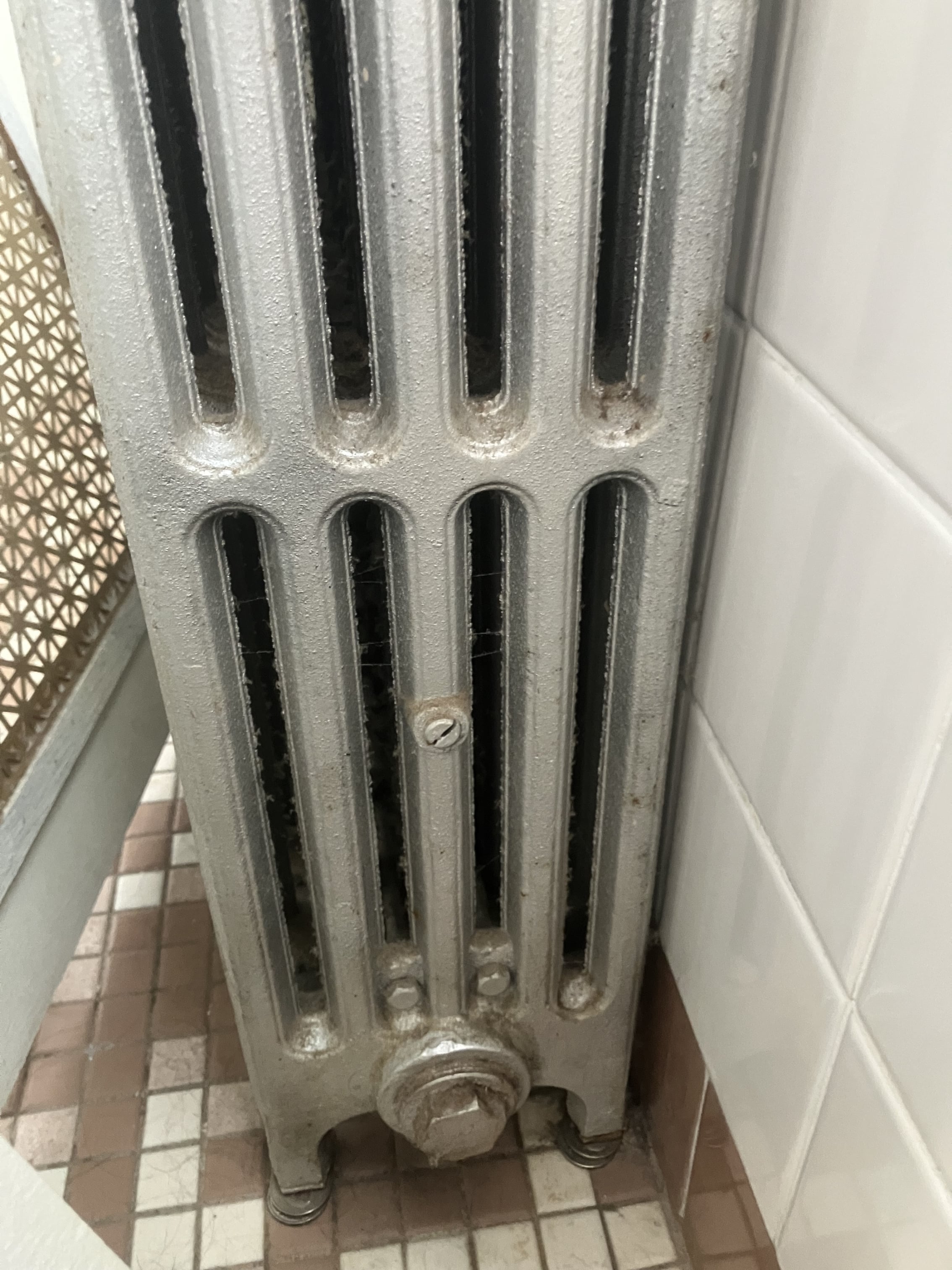

    here are some other photos
    so i was going to try the following:
    1. Take off cover, and put in anotehr vent…
    2. if that works…and i need to keep cover, try that varivalve vent; or
    3. looks like there is a spot midway…..can i block the top and put a regular vent in the middle?

  • Captain Who
    Captain Who Member Posts: 877
    Good for you. Photo 8 clearly shows the plug you need to remove to relocate the vent, which you probably know. I'd move the plug to the upper location, assuming it is same thread size as that Ventrite? vent.
    This is where the vent is supposed to go. But remember, this is unrelated to the hissing you are hearing. It will just make your radiator fill with steam better to have the vent down here

    how do you take the plug out…anything special? if this will not reduce the hissing/noise….what will this do ?
    edited January 27
    It might make it easier for you to correctly orient the vent with the cover installed.
    As I said, it will make your radiators behave more as they are supposed to in terms of filling with steam.
    Otherwise, it won't affect your hissing issue. The guys just mentioned the vent was in the wrong place because it's in all of our nature to point out problems when we see them in photos.
    You unscrew that plug with a flat head screwdriver, looks like from here. But it might prove difficult. Be prepared to drill it out and clean the threads if you go down this road.

  • Grallert
    Grallert Member Posts: 1,111
    I'd be very surprised if that plug comes of with out a battle. Sorry to say. It might but be prepared. That's why folks are suggesting simple turning the vent counter clockwise to vertical. The cover will have to wait until the plug comes out. It is the same threading as above though.

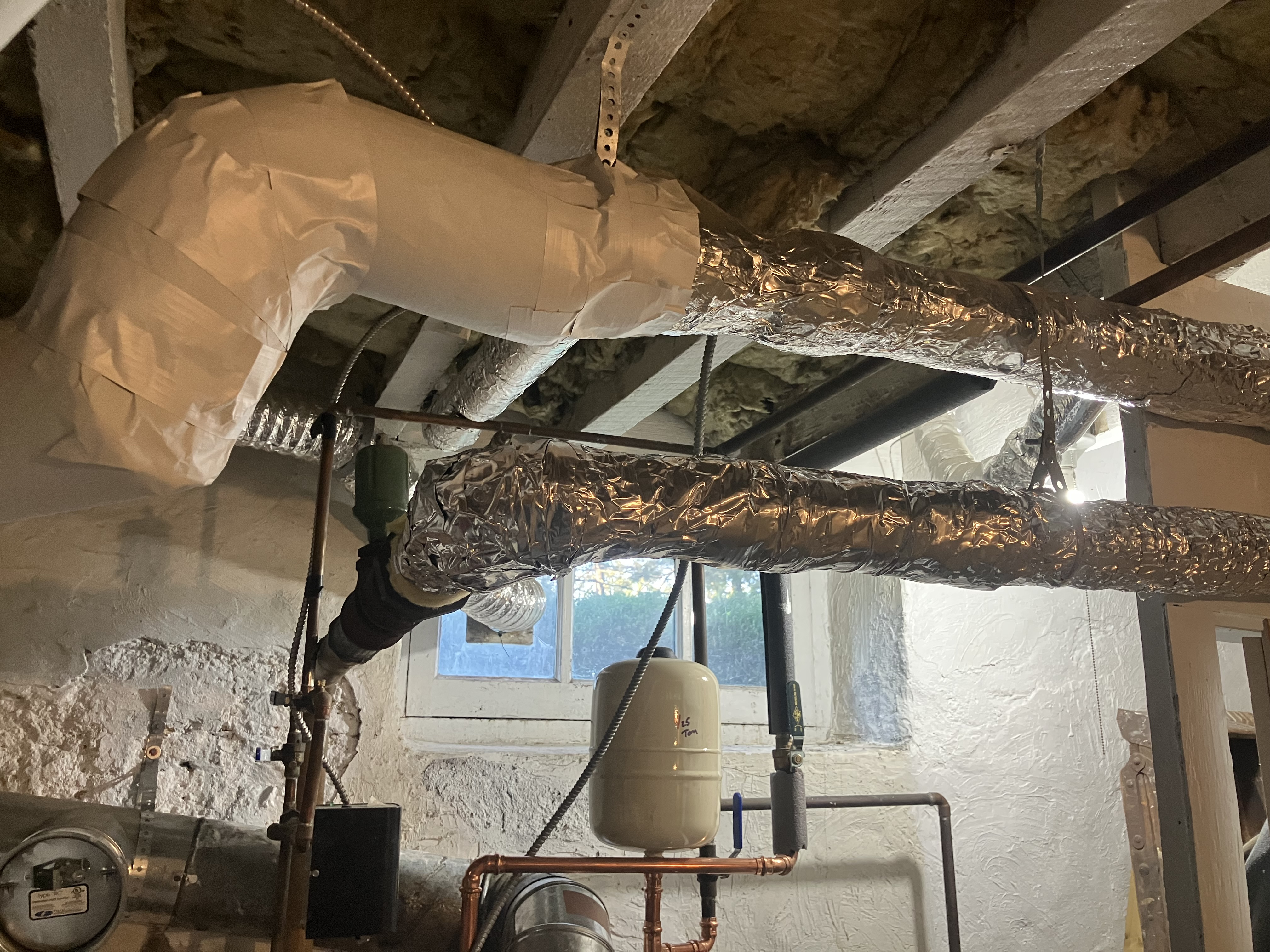

    I think @ethicalpaul and I have repeatedly asked you about your main venting. What do you have and how long and what pipe size are your mains? The single Hoffman 75 may be insufficient if it is working at all. Balancing as well as minimizing early cycle hissing starts there. You ahve also not clarified when in the cycle your hissing issue exists (i.e. from the point the boiler starts making steam onward, or only after the main vent closes, or only just before the radiator fills and the radiator vent closes, or after steam has reached the vent and it is not closing, or after the boiler shuts off… You also do not apparently have a handle on your overall balancing so I and others have suggested using economical but as reliable as any MoM vents for which you can easily adjust the venting rate with different orifice caps.
  • alanm

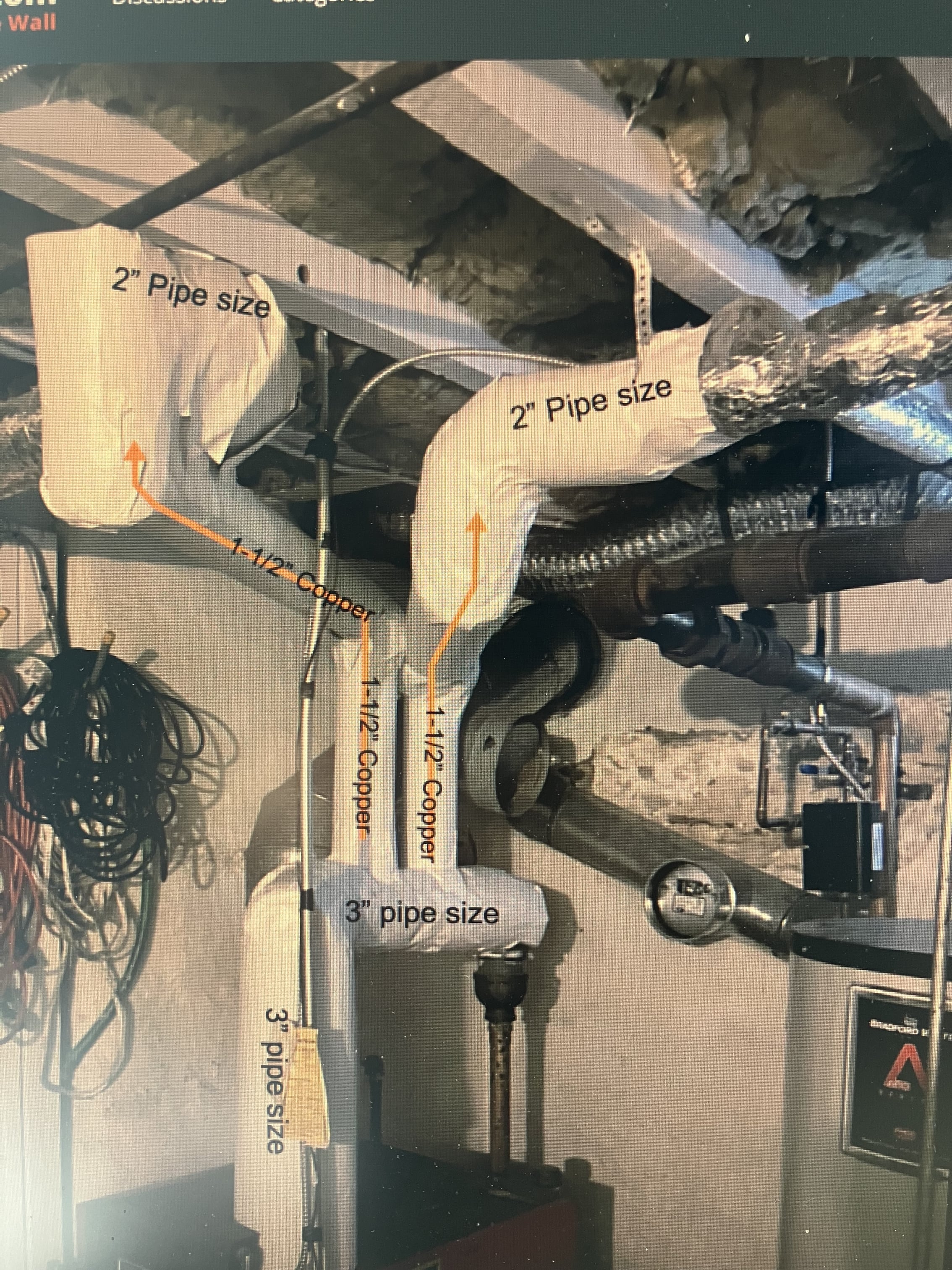

    thanks….here is photo of the boiler…some info
    there are 2 mains off the boiler….one (going to the "right" in the photo feeds a radiator on the 2nd and 3rd floor
    One little run feeds a radiator on the first floor
    the big main, going to the left in the photo takes care of all other radiators in the house (about 12). House heats up well and all radiators working….no hissing..When the few do hiss…seems to be when at night i turn down to about 69 degrees…and then in the morning…move to 71 and more if still cold.
    the "big" main runs probably about 100'…kind of like a sqaure in my unfinished basement (house is 30 x 40 — 3 stories).
    that Hoffman 75 main vent probably there about 10 years……
    your mains are long, even I would recommend starting with a Gorton #2 instead of that Hoffman
    The near boiler piping will work. Obviously the smaller copper pipe isn’t ideal but it probably isn’t hurting you

    What boiler mfg. and model and size? Need more pictures and angles. That equalizer looks undersized. I think those 1-1/2 in. supplies should be 2 in. Top of Hartford Loop close nipple needs to be min. 2 in. below the normal water level.

    ok….i am a novice…so what could changing the Hoffman main to Gorton 2 do?

    crown….model Ksz 200BOP

    It would increase the rate at which air was purged from your main piping as the steam pushes in from the boiler. This would let your radiators start to get steam at closer to the same time and let heat get to your living space faster on a call for heat. It would also reduce the amount of air that had to be pushed through each of your radiators' vents, reducing "hissing" sounds.
    This removal of air from your main pipes and your radiators has to occur each time the thermostat calls for heat so it's good if the time that takes can be minimized (within reason)
