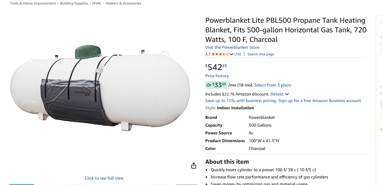

This seems like it might be a ridiculous question but,
How well do propane tank heaters work? The kind that wrap around like a girdle. Would that be a wash because the generator running it is pulling propane to do so, or does it gain you a lot more output?
1 -
I would think they would work — but I'd sure want a rat of safety devices on them. The vapour pressure of LP is very temperature sensitive…. but they would be a net positive. The trick iis to get the stuff to vapourise, which does take some energy — but a whole lot more is released by burning the stuff, once you get it into vapour form!
