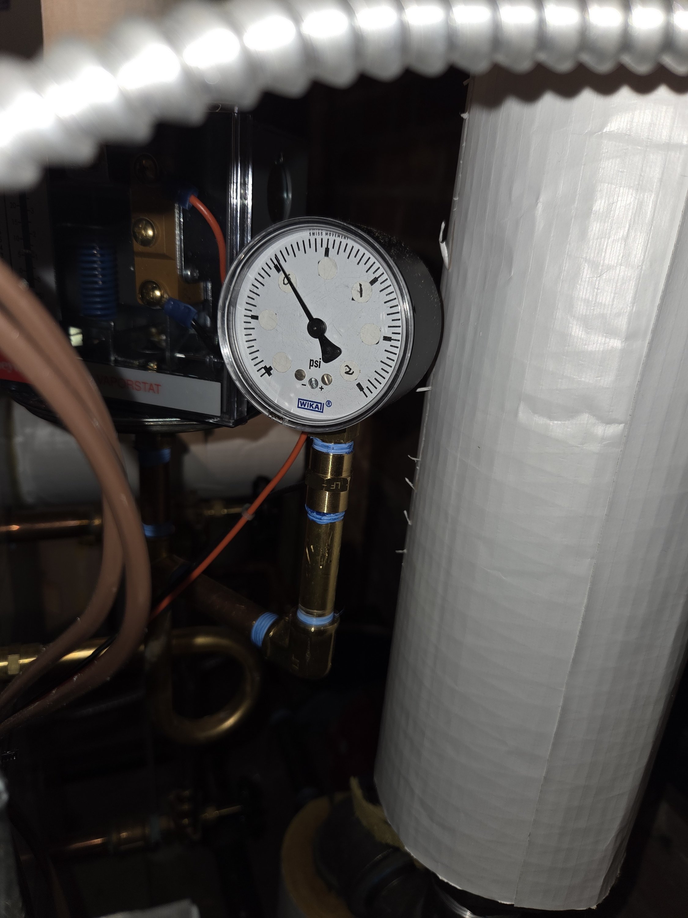

I have a single pipe steam boiler with a hot water loop for one radiator.
When the boiler satisfies the steam call, all the vents are locked because there is steam everywhere. Mains, each radiator vent, etc. So, pressure drops to near zero, but steam is good and nicely heating the house.
one issue tho is that hot water loop. the boiler is no longer calling for steam, but everything is closed. and that hot water pump is actually causing the pressure in the boiler to drop relative negative, showing about -1 PSI or so.
I have a 0-3PSI gauge, but it needle pops when going negative.
I tried adjusting the need to sit at 1 for the zero point, and put some stickers over each value, so I could re-label. I hoped that would help... but the gauge still makes an audible "pop" and the needle wiggles some when going negative.
Everything gets fixed instantly when the mains open up and equalize the pressure in the boiler.
two questions:
  1. do I risk destroying the gauge, and creating a "open" pipe if it fails? That would be worrying....
  2. is there a pressure gauge of this range (0-3) that can deal with that neg pressure occasionally?

    I don't think it's your water pump that is making the pressure go negative. Rather, it is just the collapse of steam after the boiler shuts off that makes your pressure go negative. This is normal operation.
    I haven't noticed my gauge having any trouble with this brief negative pressure, but if you're concerned you can put a ball valve under the gauge and only open it when you want to see the pressure.

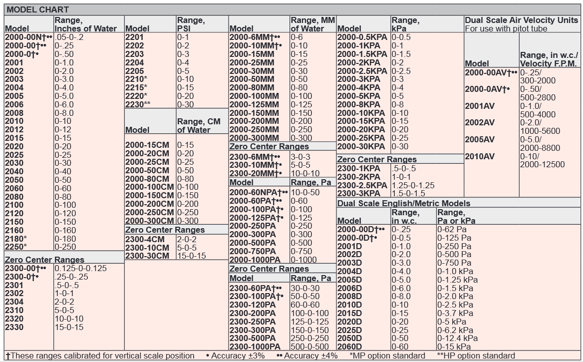

    Dwyer gauges including their Magnahelic can definitely handle it but one of mine is very similar to yours and it's OK.

    You might destroy the gauge, I can't vouch for that, but I don't think it will cause you any issue beyond that
    Honestly, your gauge already looks a little jacked up 😅 Is the needle no longer pointing where it used to?
    109A_5 Member Posts: 3,959
    Look in to a Compound Gauge, or a center zero Dwyer Magnehelic (eBay) .
    That 'pop' may already be the result of damage to the linkage.
    The pressure or vacuum would have to be pretty great to damage the gauge to the point where it would be open to the atmosphere.

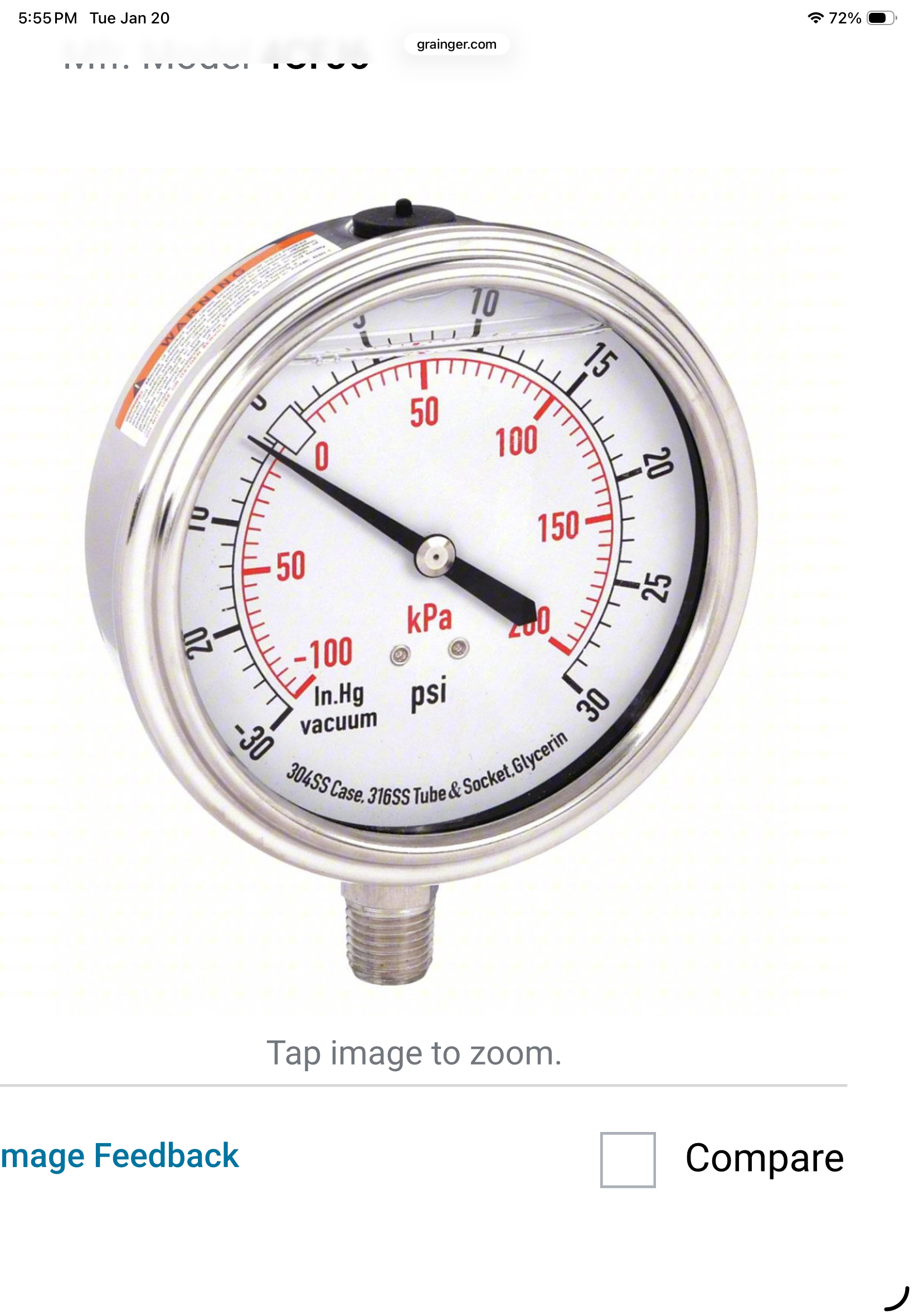

    Buy a 30-0-30 compound gauge if you want. The vacuum will probably damage the gauge.

    "center zero Dwyer Magnehelic"
    Those look perfect, but I can't find one that fits the range of -2 to 0 to 2 psi (or -50 to 0 to 50 in water).

    pretty much any gauge brand offers compound gauges. A liquid filled helps dampen needle vibration or sudden movements

    My boiler never goes over 2 inches of water column (0.072 PSIG). Maybe you can find a Compound Gauge with a narrower range than 30 PSI - 0 - 30 inHg.
    Or even with the 2202 0-2 PSI I'd be very surprised if the vacuum would damage the Magnahelic.
    https://www.mmcontrol.com/Dwyer/pdf/02-Pressure-2020.pdf

    Rather than using a 30-0-30 compound gauge, use a 30-0-15 compound gauge. The needle movement is exactly the same on either side of the zero.
    This is the gauge I usually see on the old 2 pipe steam systems I deal with.

    "At least 3 of us have suggested compound gauges".
    only ones I can find are like 30-0-30 gauges, and thats not low enough. I already have a 0-30 gauge on the boiler, as required by code (and insurance!).
