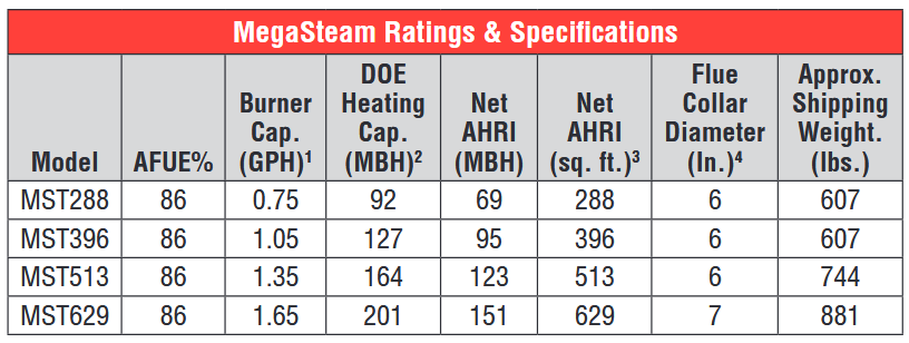

Hi,
A family member recently had an 80 year old oil burning steam boiler replaced in her 1000sf home and the new boiler is running 15 minutes when cold then less and less with each subsequent cycle. It ends up running for only 2-3 minutes then turning back off for one minute. It comes on and off this way until the set point is eventually reached. It’s going off on high pressure. The pressure cutout is set for 2psi.
My research suggests the boiler is oversized. We had the installer measure the 6 radiators and they came up with 180EDR but the boiler is 396. They should have measured before selecting but here we are. I was not involved in the selection, only after there were issues. I understand smaller steam boilers only come in gas now, which is not an issue if a conversion is the best route.
We challenged their selection and they tried to defend it blaming the vents. They replaced all 6 vents at the radiators and the 2 main vents in the basement and the performance was the same.
Then they changed the burner to a 288 and it got a little better but not much change. Same boiler block.
I’m pretty sure we need something in the 200-210 range and that we are still significantly oversized. By I’m not fully confident in what the pickup factor should be for a small house. Is 10-15% ok?
They still want to test more things (they have been vague about what else there is to test) but I’m at a loss for what other possible explanations there could be for this. I want to make a hard push to swap in a smaller replacement boiler, but looking for some reassurance before doing so.
The distribution piping and radiators are all existing so the only part that’s new is the boiler itself and the near boiler piping.
Greatly appreciate any feedback from the helpful and knowledgeable folks here!

    looks like there is a weil mcclain and burnham steam max that is close, probably is a peerless too.
    oops, i was looking at oil boilers but there were gas boilers mixed in too. there are small enough gas boilers, the smallest oil boilers look to be about 50% oversized

    If the 180 EDR is correct the boiler is double the size it needs to be. But as others have mentioned you probably can't buy an oil boiler that small.
    The smallest oil boiler is a Peerless which is about 288 square feet of steam.

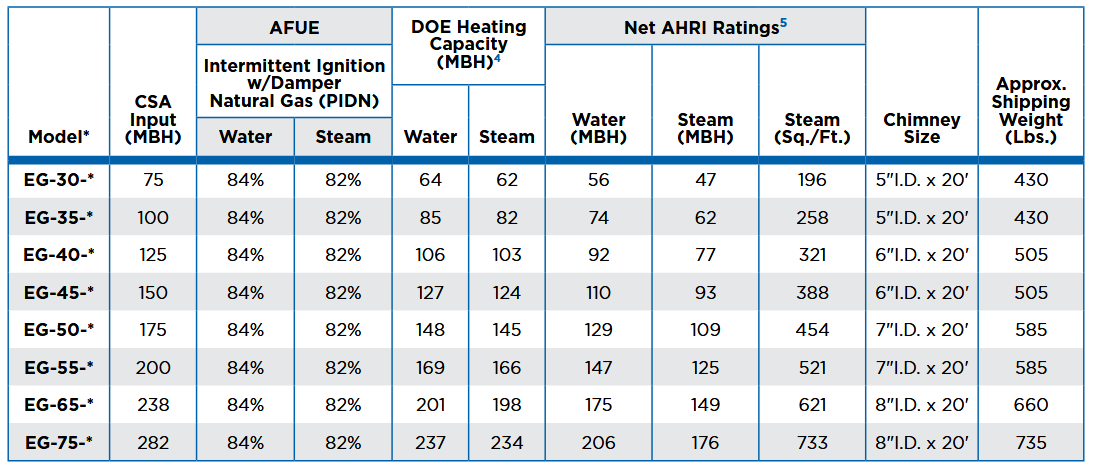

    Weil McLain has the gas fired EG-30 which is rated at 196 sq feet which would be the right size.

    @EBEBRATT-Ed Thank you I will look into the EG-30, sounds like it could be a suitable option. My preference would be a straight swap for something like this, hopefully we can make it happen. The timer is a solid backup plan. I'll see about getting some pics.

    you say that the new boiler is 396 ft^2 of steam but the mst 288 is 288 ft^2 of steam. It is still about 1.5 x the size it needs to be but it isn't as bad as if it were 396 ft^2.
    We see a lot of boilers that are very oversized although if it is the mst288 there aren't really better options for oil.

    I might have been unclear there. It was originally the MST396 and after we went back and forth about it for several weeks, we were able to get them to put the MST288 burner on it instead, which we understand is the lowest they can go for this boiler. It's more important to size it correctly than to commit to a particular fuel source.

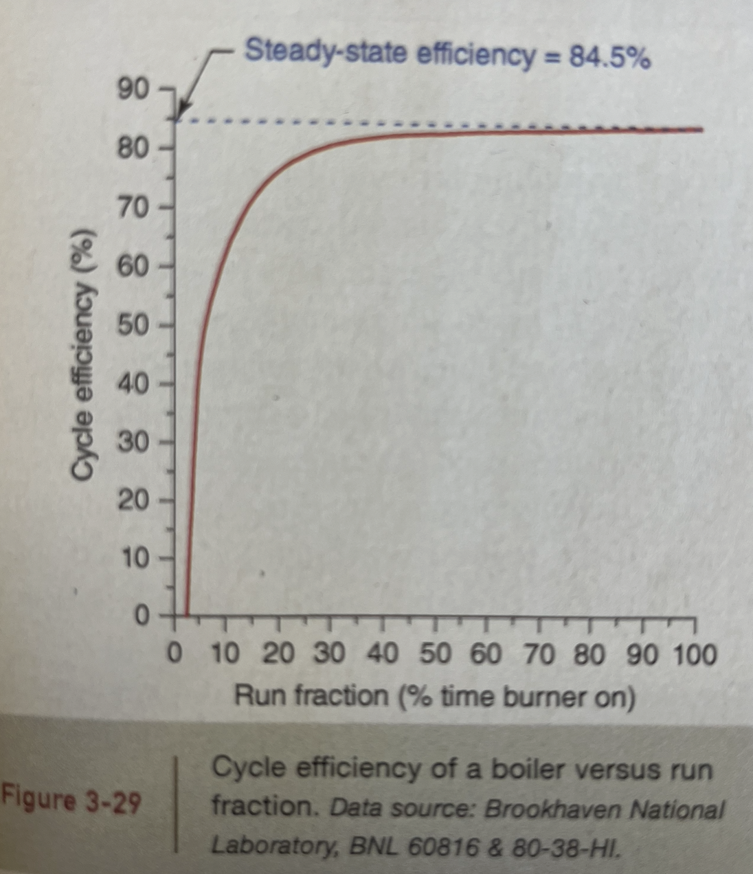

    Even a correctly, or exactly sized boiler is going to short cycle as 80% of the heating season you are below design conditions. Not much you can do about that with a fixed output boiler.
    The more a system is zoned, the ore potential for short cycling of the boiler.
    Buffer tanks are one option, controls to hold the boiler from firing, as long as you are not trading comfort for that option. High mass distribution maybe handles that forced off time better.
    Once it is up and running observe the cycling on a mild day to see the frequency.
    A few posters here have built data loggers to track the cycling.
    Excessive cycling drives down the boilers efficiency.
    The math looks like this if you are interested. Run Time minutes the boiler is firing/ minutes it is off before next on cycle
    8 minutes on, 15 minutes off = 23 minute time period 8÷23= .34 or 34% Run Fraction
    Plug that into this graph to determine the boilers efficiency. 84.5% being about the best efficiency. So that puts you at or just under 80% efficiency
    So boilers with 5 minute on, 5 minute off, 5%as an example, really drive efficiency down.
    A modulating oil fired boiler is what the industry needs :)

    Jamie Hall Member Posts: 27,164
    Uncommonly useful graph — hadn't seen that before. Thanks, @hot_rod !
    It also helps illustrate my point that a steam boiler which is cycling on pressure, provided that duty cycle is at least 50% on, isn't losing much efficiency during a given thermostat cycle. and provided the off time is short enough that the boiler doesn't cool.
    Now if you hold the boiler off long enough for it to cool down — even as little as 10 minutes or so for a smaller boiler — then you start over…

    In this case the choice of fuel does matter somewhat. Gas steam boilers are available in smaller sizes than oil fired as a rule.

    With something like the EG30 suggested by EBEBERATT, we would 260 gross compared to 222, or 17% over. This feels spot on.
