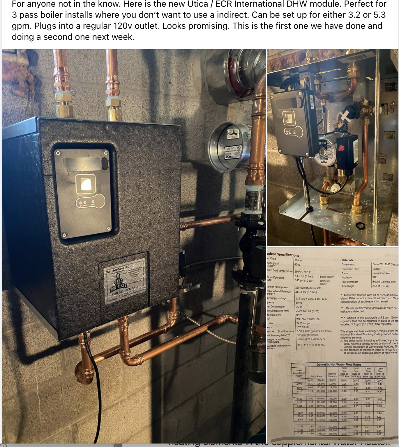

    Leave the electric tank as a pre-heat, breaker off, then feed one of these HX modules.
    It works like a tankless giving you continuous DHW, from the boiler.
    If the boiler ever fails, turn the electric tank breaker back on for backup DHW source.
    https://uticaboilers.com/wp-content/uploads/2022/02/240012960-DHW-Module-IOM-REV-F-WEB.pdf

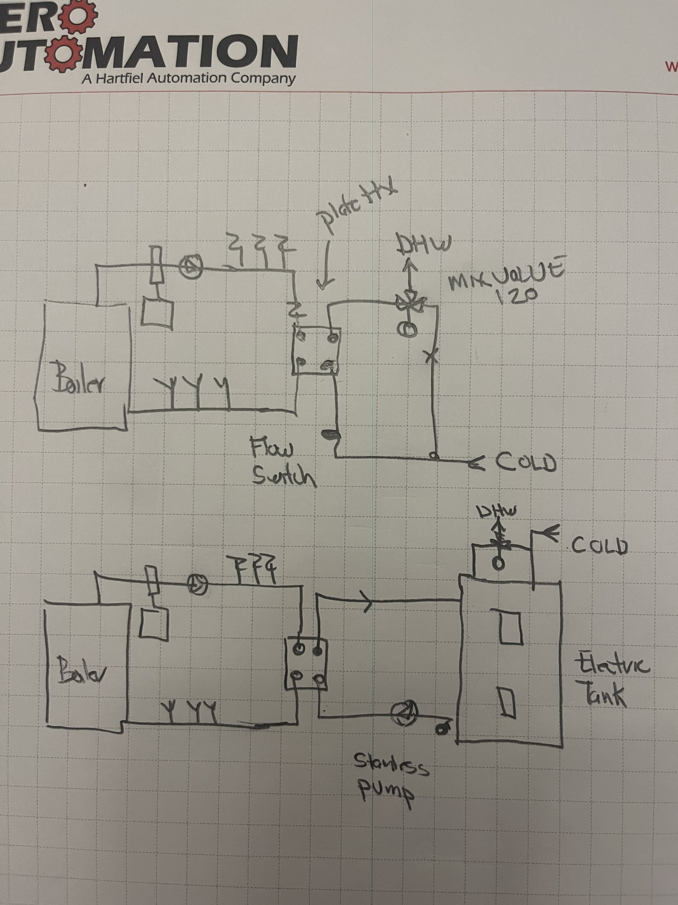

    hot_rod Member Posts: 26,907
    here are two options
    1st is basically a site built combi boiler built with a plate hx. A flow switch turns on the zone valve to heat DHW instantly. This has a bit of lag unless you keep the boiler at 150 or so, same as a combi boiler
    2nd option uses your electric tank as a storage, so the boiler always keeps the txnk how. So instant hw and also continuous hot at 3 gpm or so. Thus us pretty much how the EK systems are built
    This is basically an indirect with an external HX
    A flat plat heat exchanger is about 5 times more efficient than a coil in a tank indirect as you have two moving flows to transfer heat
    I have built a hand full of if these myself, never bought a premade module
    It is a plate hx, pump, flow switch on option 1
    On option 2, plate hx, pump, temperature control
    3 way mix valve to allow you to run the plate or tank at higher temperatures
    External plate HX are easy to clean or descale compared to coils inside a tank

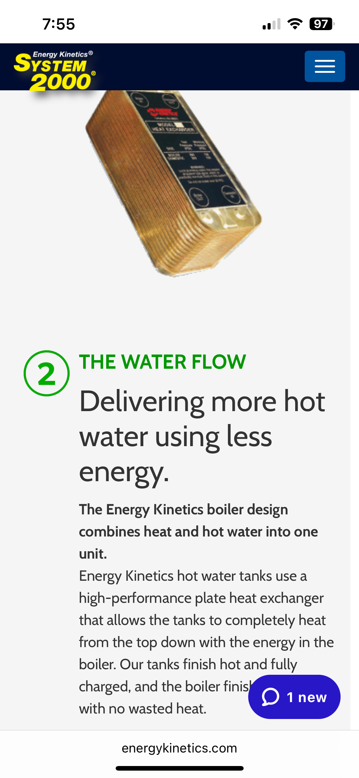

    Also info from the EK website below
    https://energykinetics.com/system2000-quietest-most-efficient-boiler/

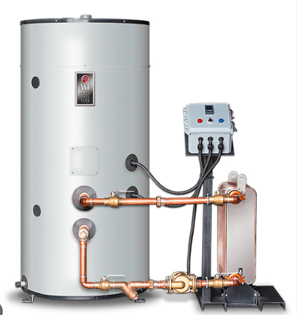

    There used to be some tanks pre-built with external plate heat exchangers back when solar was popular.
    Most of the tank manufacturers offer them more in commercial sizing applications. Niles tank for example.

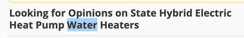

    pedmec Member Posts: 1,267
    A hybrid heat pump water heater is the worst water heaters. I can't even tell you how many have failed and are running in full electric mode. I can't overstate the amount of compressor failures that are out there. every manufacturers are having compressor failures. i just had to switch over one to full electric mode due to compressor failure and the landlords would rather wait for a complete tank failure than replace the water heater under warranty. Don't take my word for it. just look it up. A O smith has an error code that is turning into an internet joke.

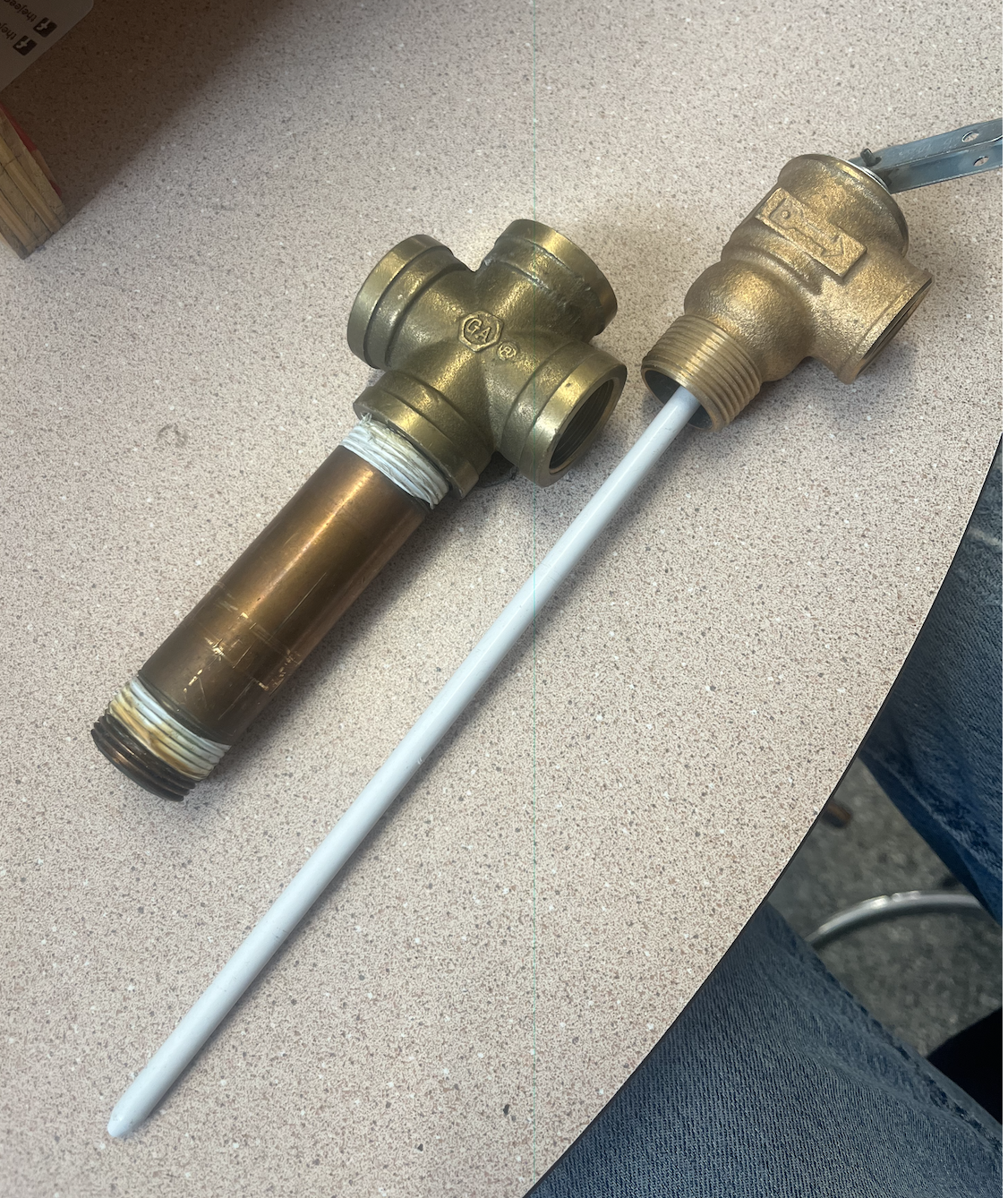

  • Forge_Fixer88
    Forge_Fixer88 Member Posts: 20
    @szwedj Would running the hot water in at the t&p valve get the same effect as modifying the dip tube?
    It is not uncommon to see the T&P port doing double duty.
    This cross gives you options.
    Use a T&P with a -8 at the end, giving you an 8" probe to reach into the tank.
    The nipple length depends on the tank insulation thickness, a 3-4" should work.
