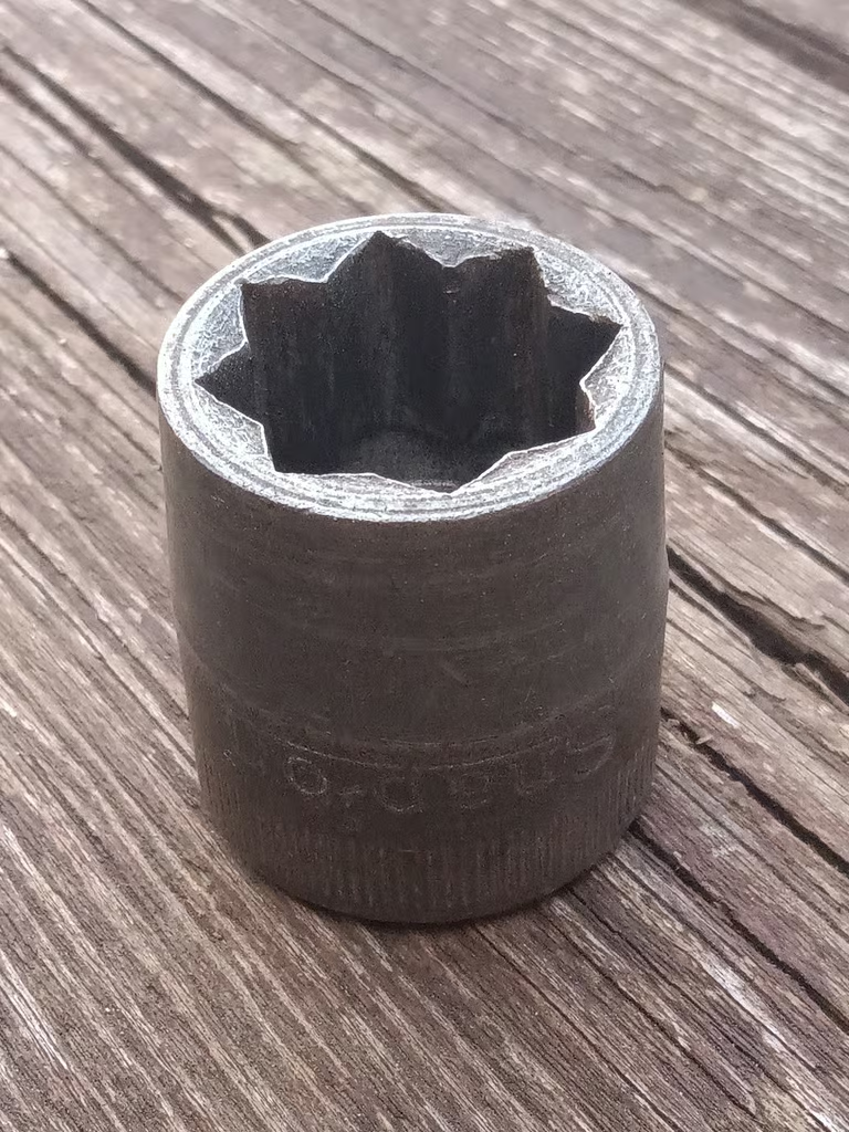

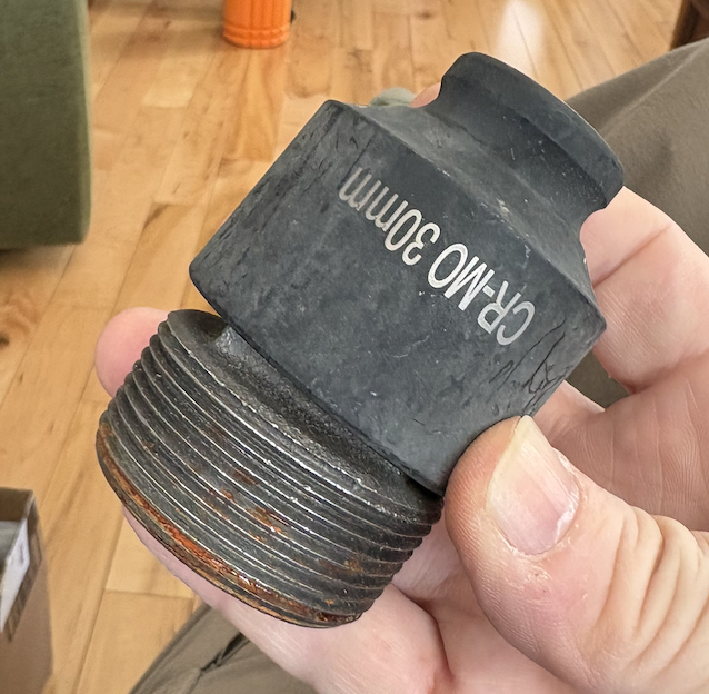

    In regard to impact wrenches, I talked a company into selling me an eight-point special order socket to get the squarehead plug out of my Weil-McLain boiler. I sweet-talked them into selling me just one, not 20!
    It took me about two minutes to get that socket off, in place since 1994, and I didn’t have to take the boiler jacket off to do so.

    To clarify, I had 400-500-ish pounds of boiler acting as the “counter-wrench” when I used that impact socket! ….

    The telecom industry uses 4 point sockets. I bought one a few months back, ½ drive ¾ square IIRC, got it on eBay.

    ethicalpaul Member Posts: 8,745
    8 point? Why not 4-point? https://www.amazon.com/dp/B0DQGWPNSM

    Back in the 1960 Snap On came out with Flank Drive sockets they have a slight round at all the points. This allows more torque to be put on the flats instead of the points of a hex bolt or fitting.
    Similar to what @ethicalpaul shows
    Later they made Flank Drive open end wrenches
    A Flank Drive 6 point impact would be worth looking for

    Of course, inside an 8-point is a 4-point waiting for its time to shine. And it did! ….
    109A_5 Member Posts: 3,959
    If you are using a breaker bar in a tight place an 8 point (Double-Square) socket may work when a 4 point will not. Its about the variety of usable angles between the square socket drive and the working end of the socket.
