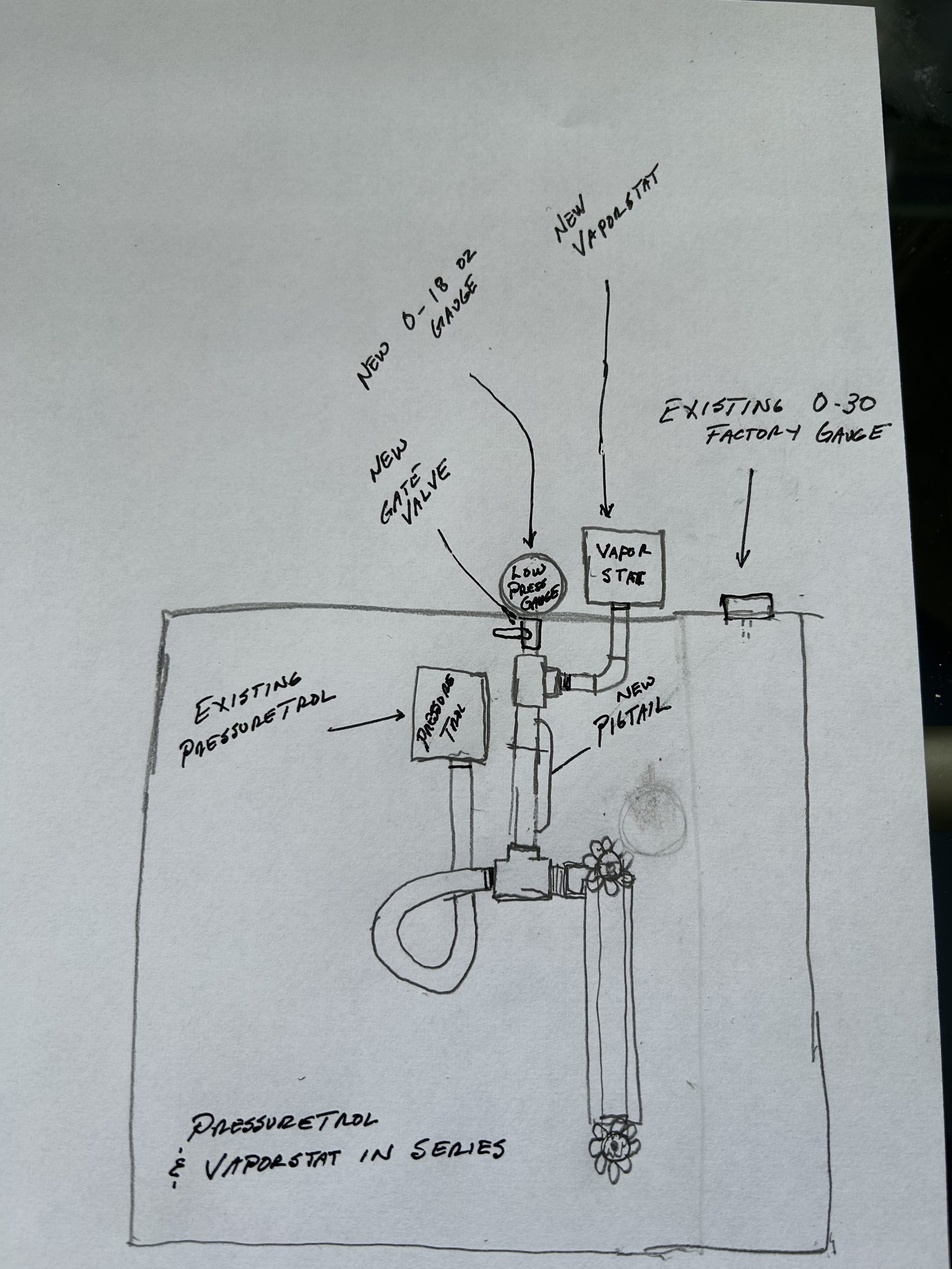

    Hello all, I have purchased a Honeywell Vaporstat, 0-18 oz. Pressure gauge and additional pigtail for the system. Does this sketch look the the correct way to install ? Thanks as always !! Bottom picture is current setup.

  • neilc
    neilc Member Posts: 3,140
    that can work, may need to move that wire bracket,
    while you're piping, disassemble the upper sightglass valve and make sure it's open and clear all the way back into the boiler, the glass protection rods work well, drain down and do the bottom valve also,
    water looks slimey, oiley in the glass, do you have a way to skim?

    mattmia2 Member Posts: 15,999
    i'd throw a couple unions in there so you don't have to disconnect stuff to take it apart.
    you can also make the water seal out of tees and ells and plugs such that you can flush it out by just removing the plugs.

    Thanks for the replies. Great idea on the unions. I did have the boiler serviced just a few weeks ago and the plumber added Hercules cleaner to the system. I will blow out and skim again while making the changes. Thanks again.
  • dcw1
    dcw1 Member Posts: 20
    Should all the new fittings be brass ?
    or large black iron but small brass fittings are better because they won't corrode. the large black iron would not be likely to clog.

  • Pumpguy
    Pumpguy Member Posts: 793
    I would suggest you add a pig tail to the vaporstat, same as you have for the pressuretrol.
    As drawn, the vaporstat doesn't have the water seal the pigtail provides to the pressuretrol.
    You could rearrange the piping so the one pigtail provides the water seal to both the vaporstat and pressuretrol.
    it does but we are looking at it head on in the drawing, it is called out but hard to see.
  • dcw1
    Yes it is a kinda crummy drawing but I am going to use one. Thanks for your input.
    Steamhead Member Posts: 18,319
    @Pumpguy said "You could rearrange the piping so the one pigtail provides the water seal to both the vaporstat and pressuretrol."
    I would not do this. If the single pigtail got plugged, it would block pressure to both controls. With two pigtails they both have to plug up for that same result.

  • dcw1
    Maybe my last comment was confusing. If you look closely at my sketch and picture I am using two pigtails. The existing pigtail for the old pressuretrol and a new additional one for the vaporstat and low pressure gauge.
