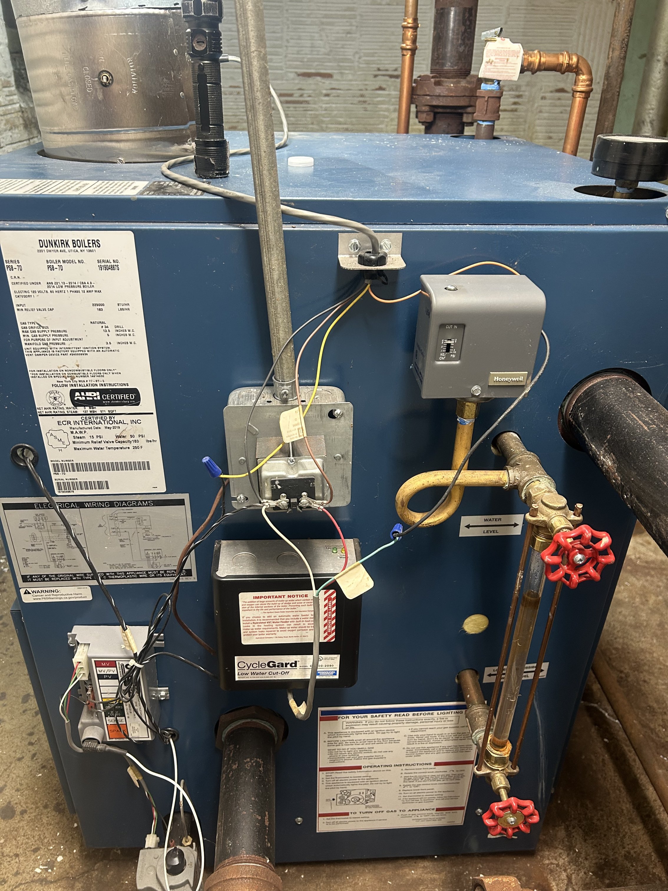

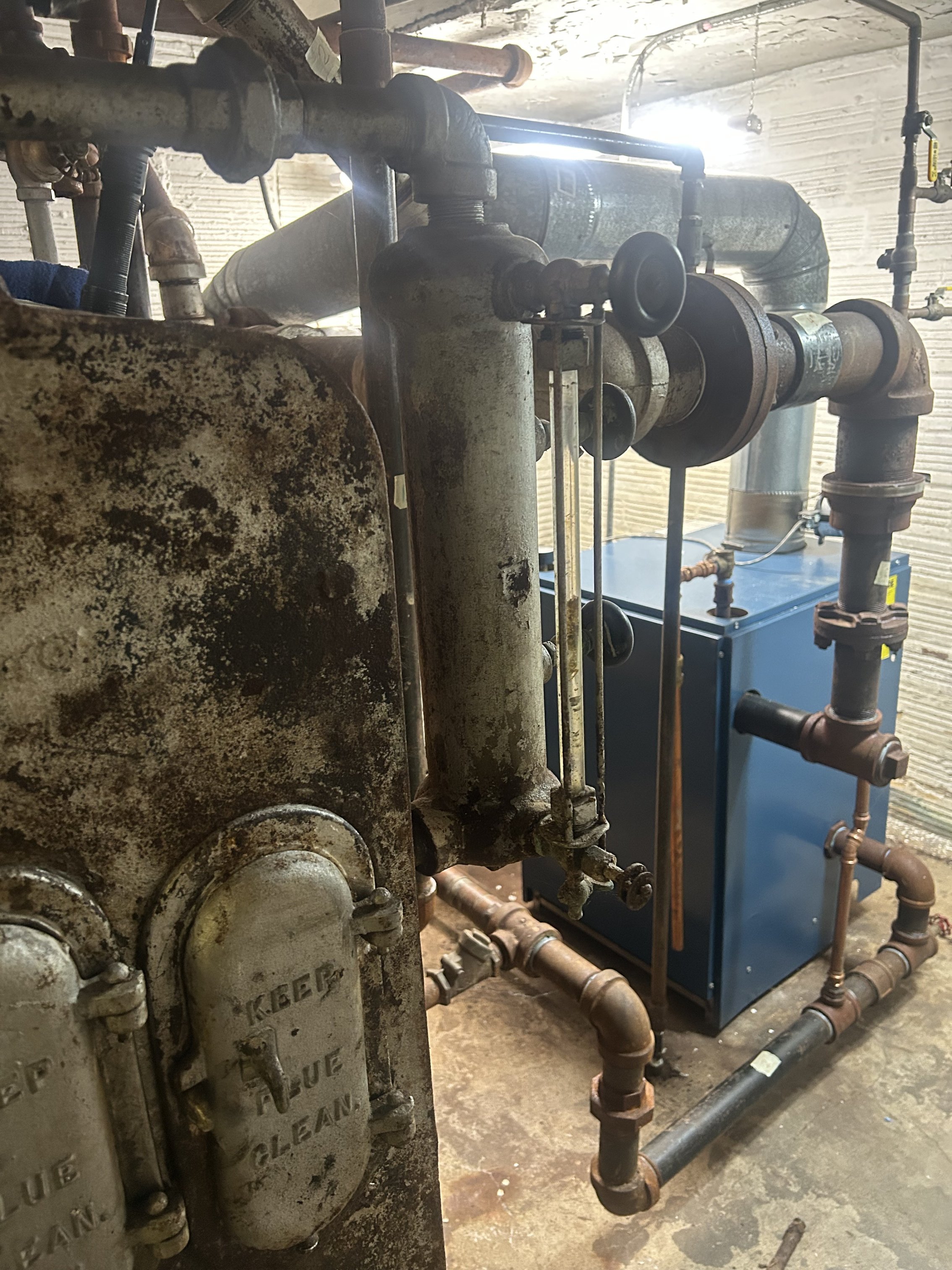

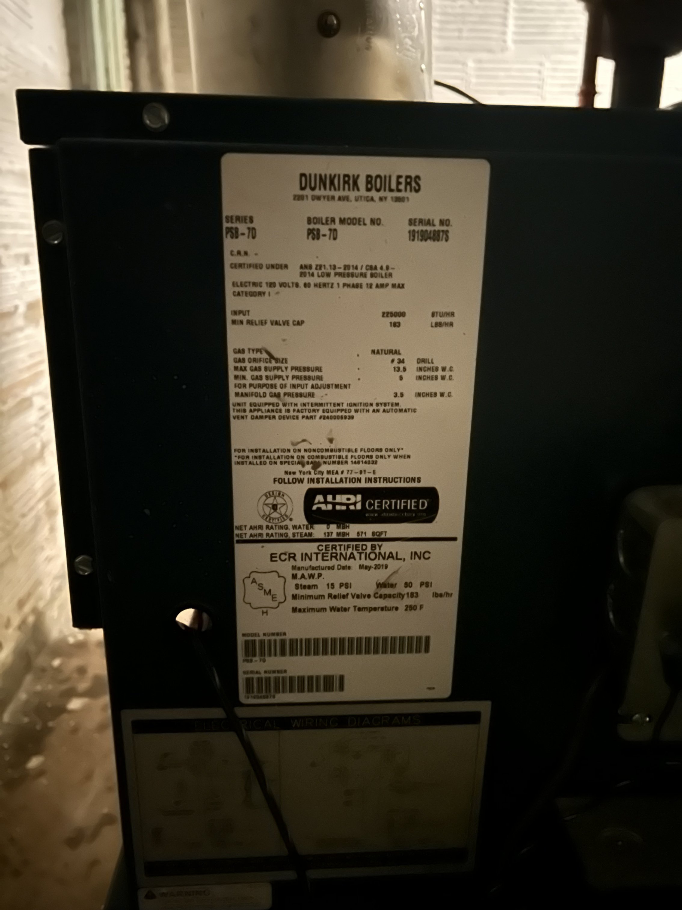

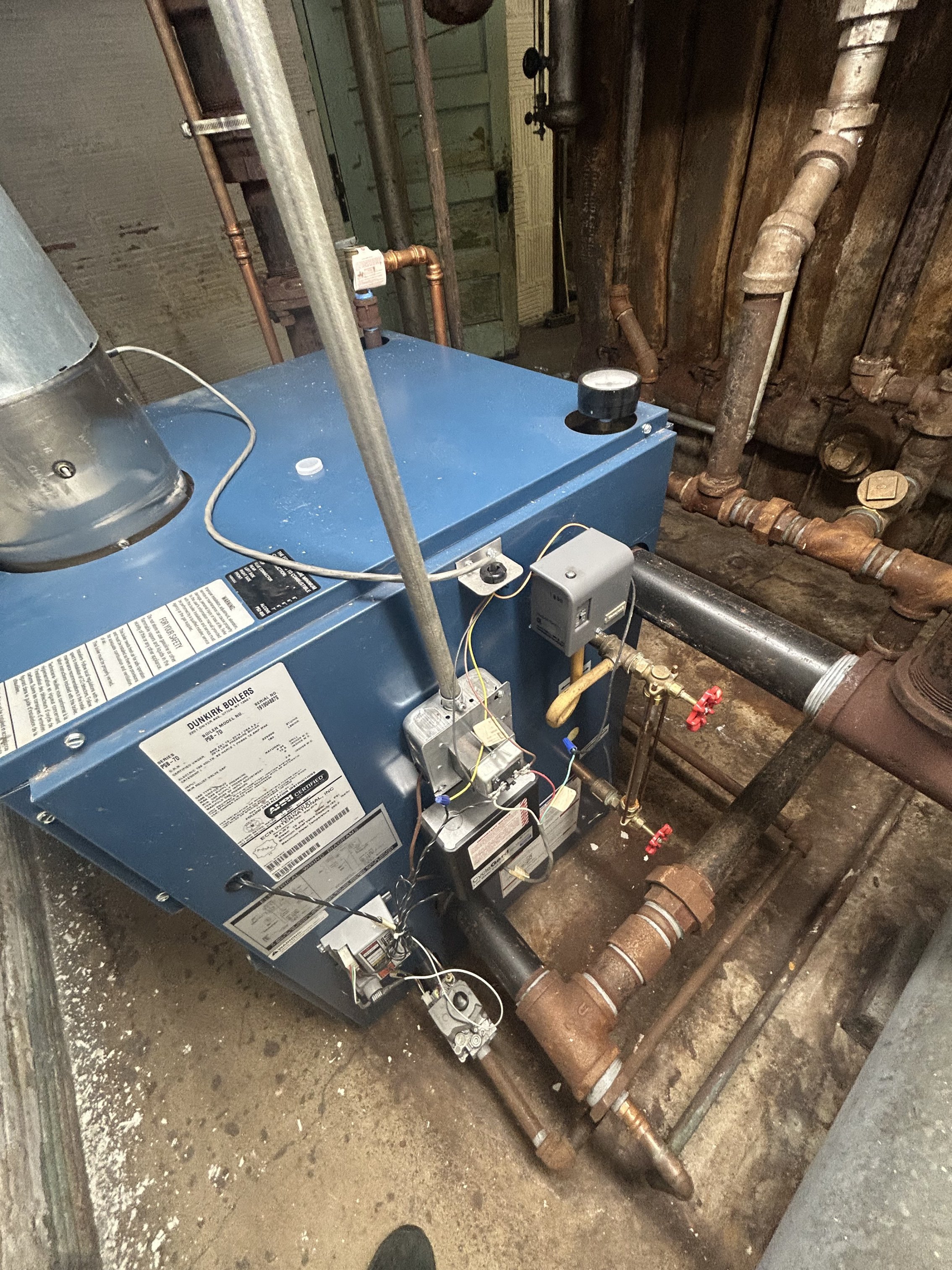

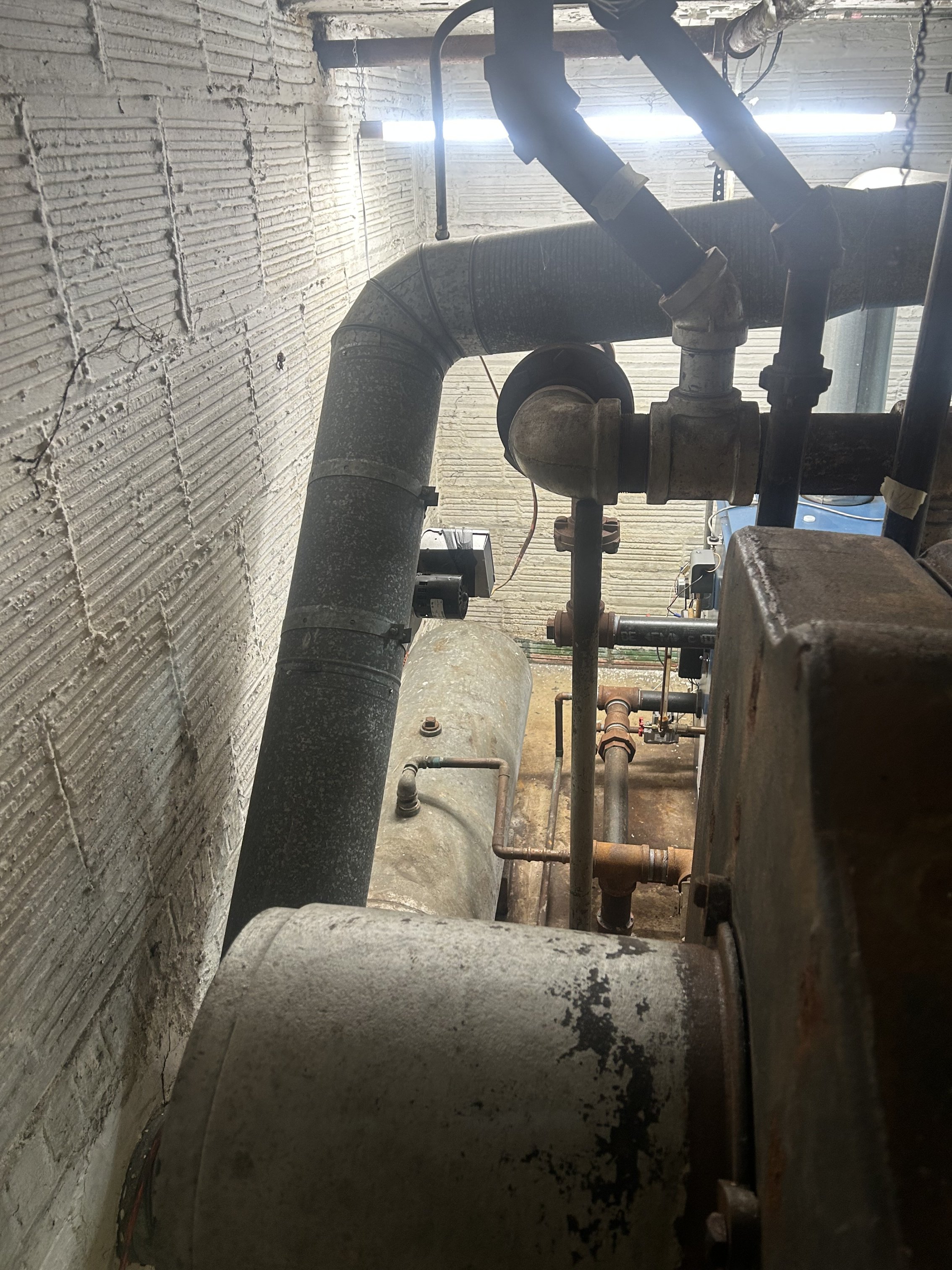

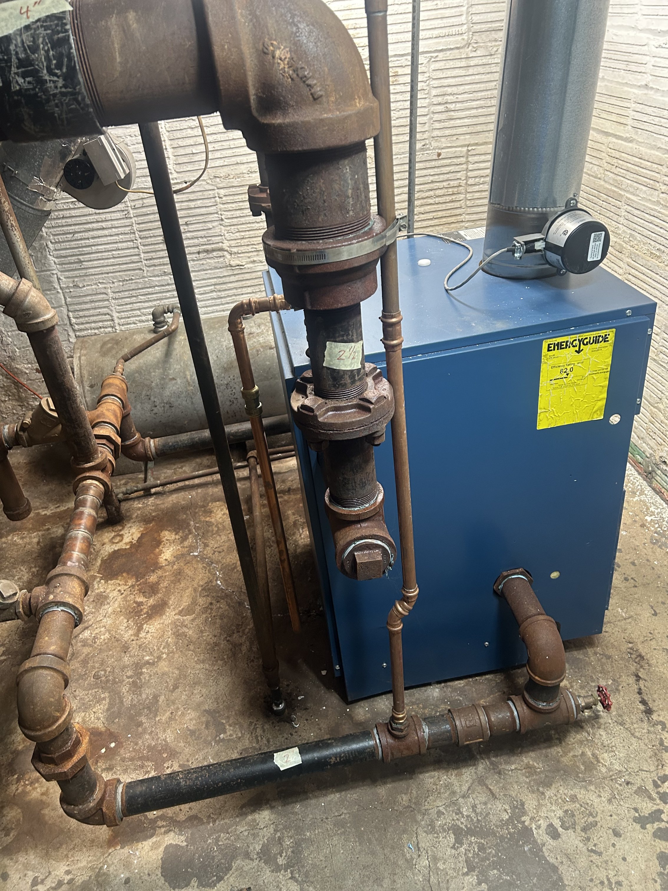

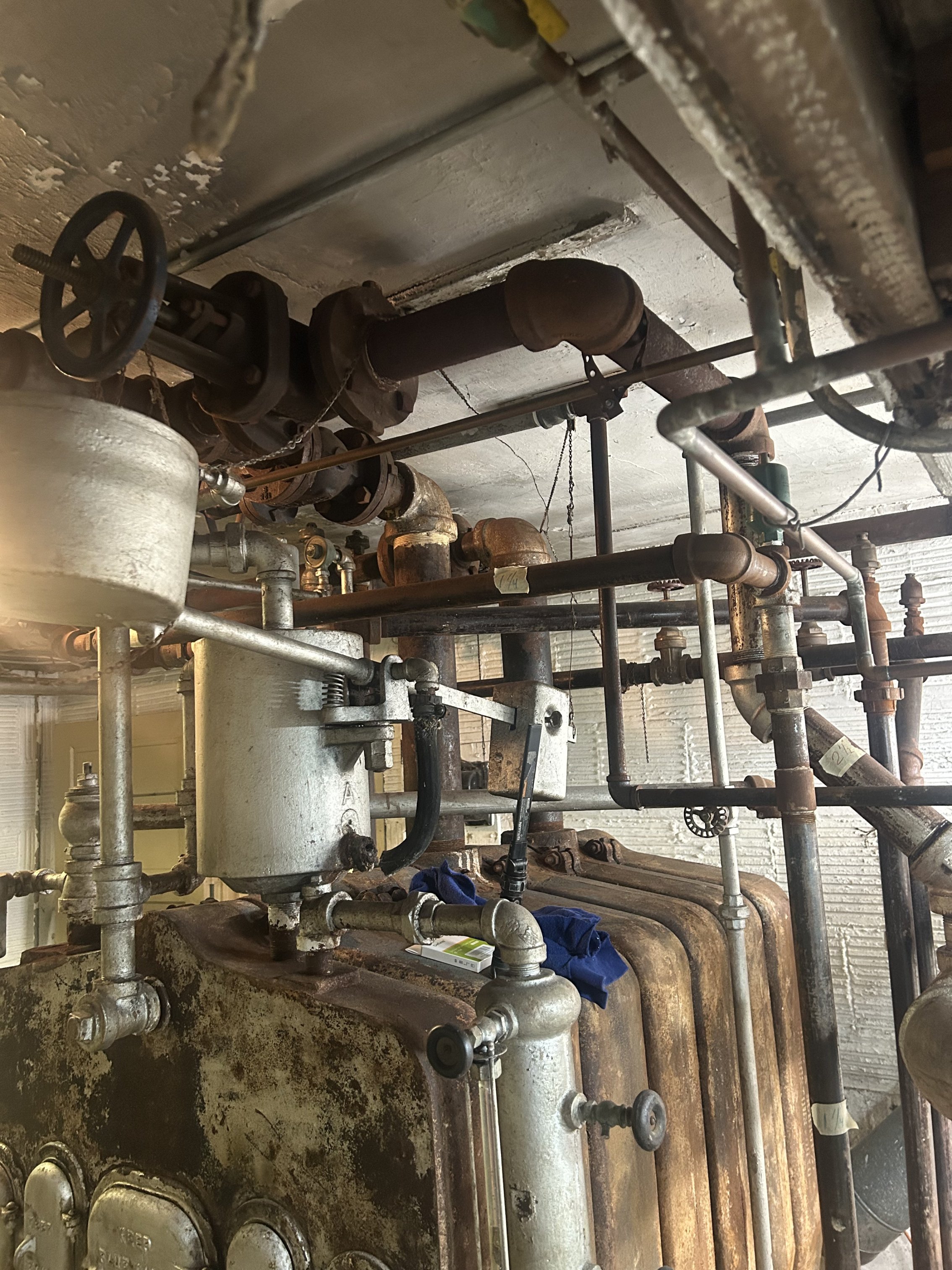

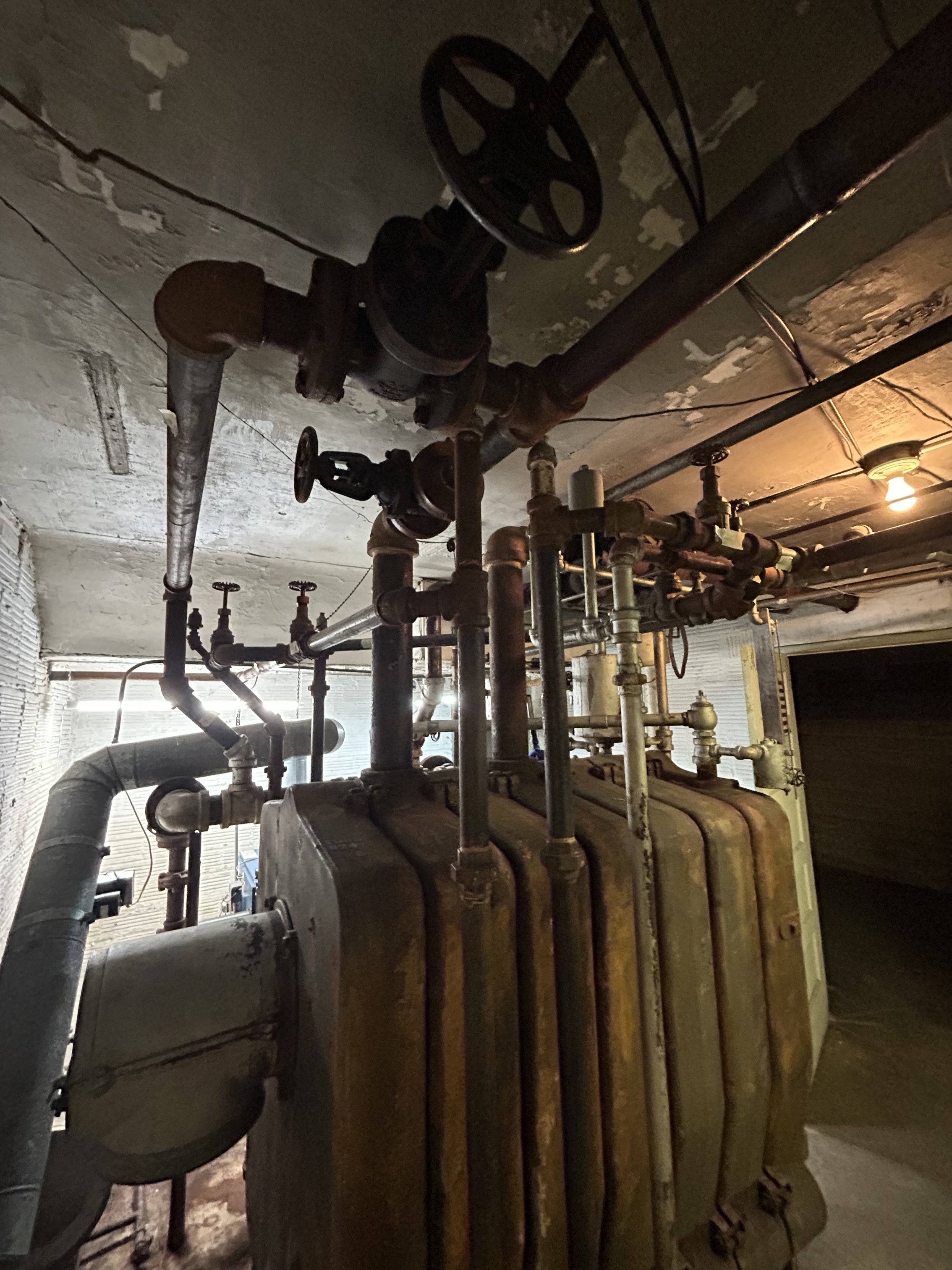

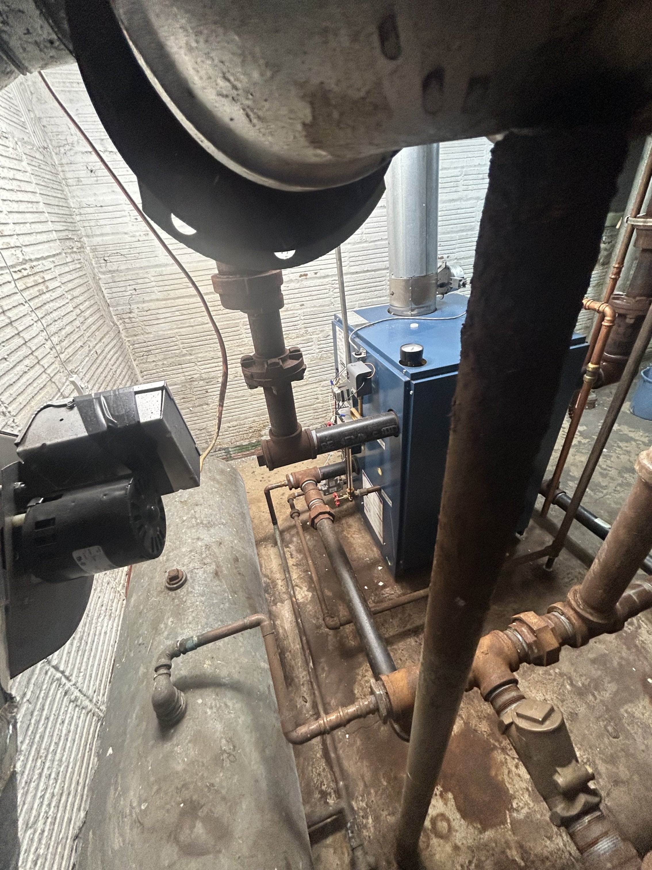

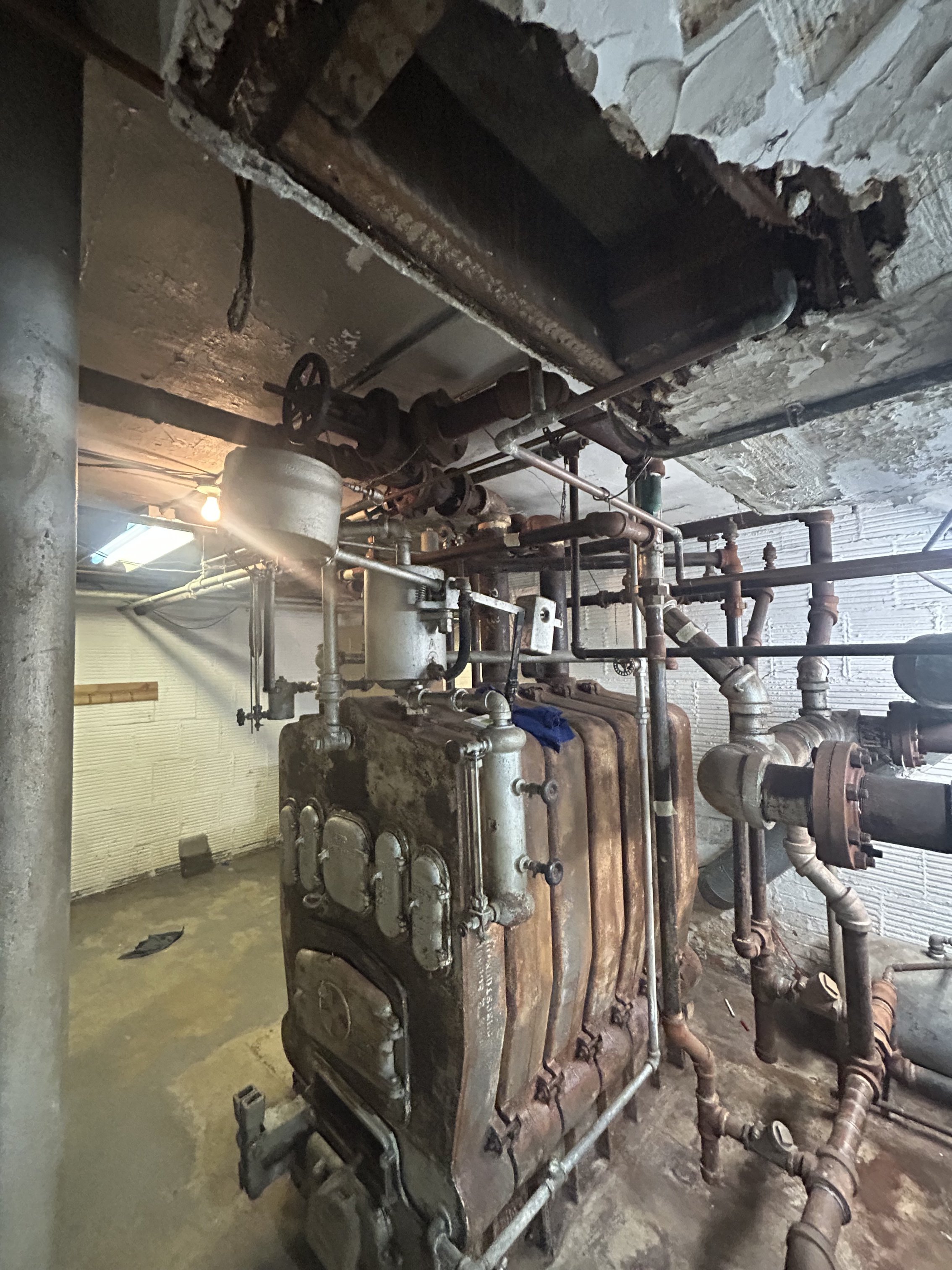

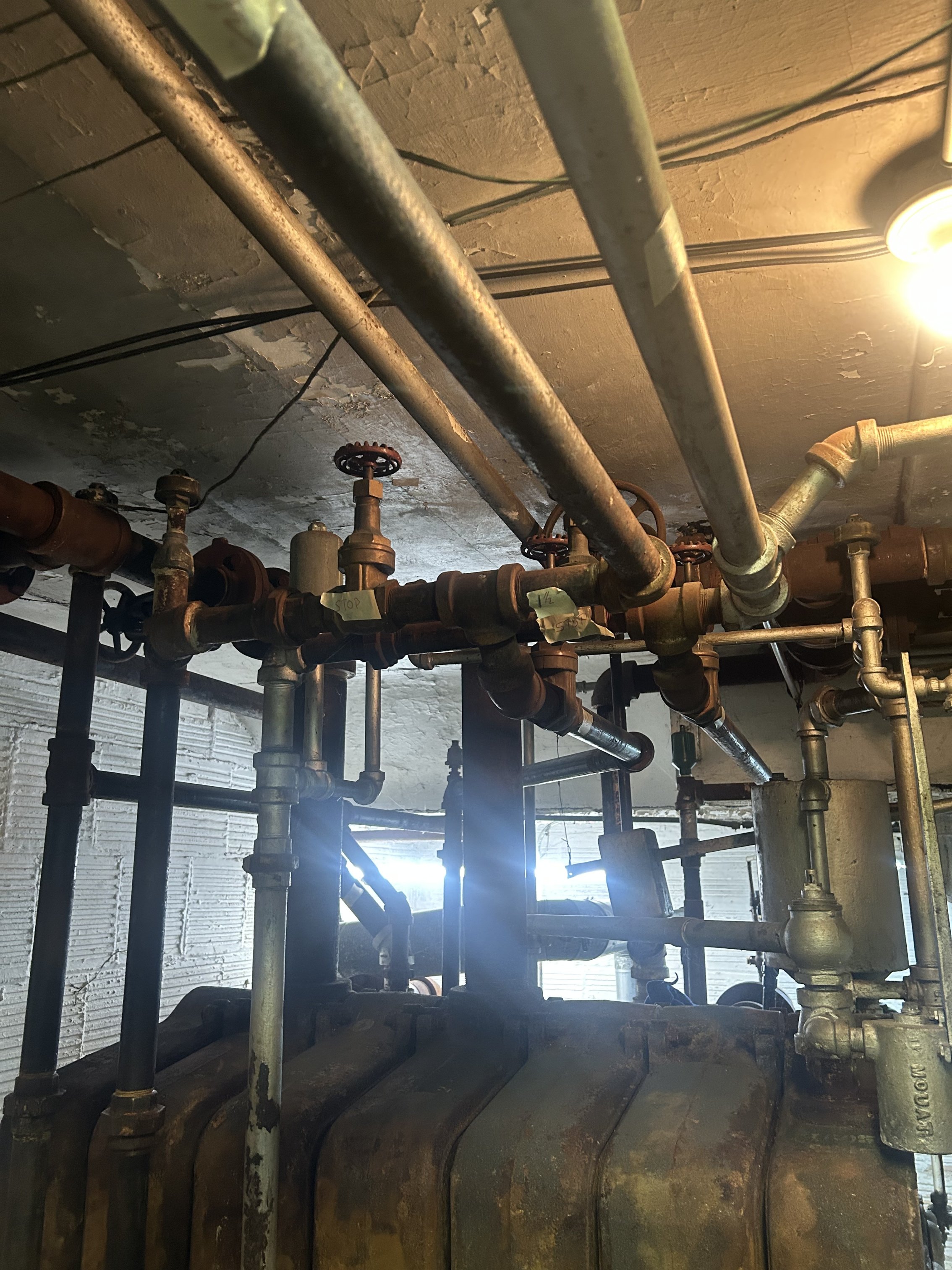

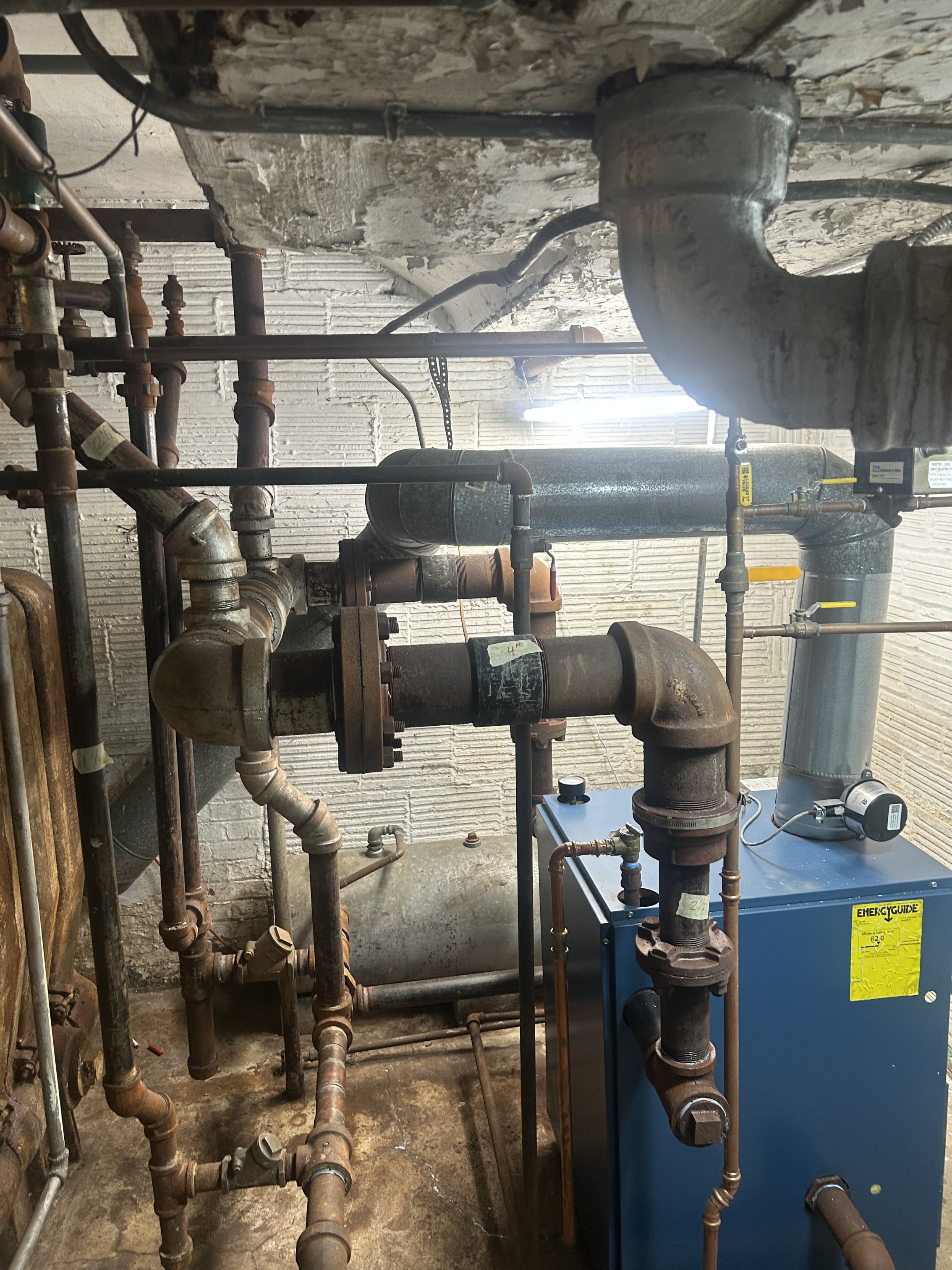

Thanks to all on this forum !! I am trying to make sense of this system in a 100 year old home my son purchased. The original boiler and it’s Mouat control system has been abandoned in place and a new Dunkirk gas fired Boiler has been tied in. The system still uses the original radiators, Mouat radiator valves and water seals. The newer boiler was installed in 2020 and uses a pressuretrol for its control and is set at several pounds of pressure. I have read everything I can find about this setup and know that the original design was to run at just a few ounces of pressure. I have purchased a vaporstat and low pressure gauge to incorporate into the system. I am attaching several photos of the system. I’m trying to figure out why the main steam headers go from 2 1/2” leaving the boiler to a 4” header then immediately back to 2 1/2” pipe. From what I’ve read I should install the vaporstat in series with the pressuretrol and install a low pressure gauge. Any help would be greatly appreciated in insuring that I’m on the right track. The home is in Northeastern Ohio and unfortunately just outside the service area of Gerry Gill. Thanks in advance for your help.
IMG_9973.jpeg IMG_9991.jpeg IMG_9975.jpeg IMG_9975.jpeg IMG_9976.jpeg IMG_9970.jpeg IMG_9963.jpeg IMG_9954.jpeg IMG_9940.jpeg IMG_9835.jpeg IMG_9805.jpeg

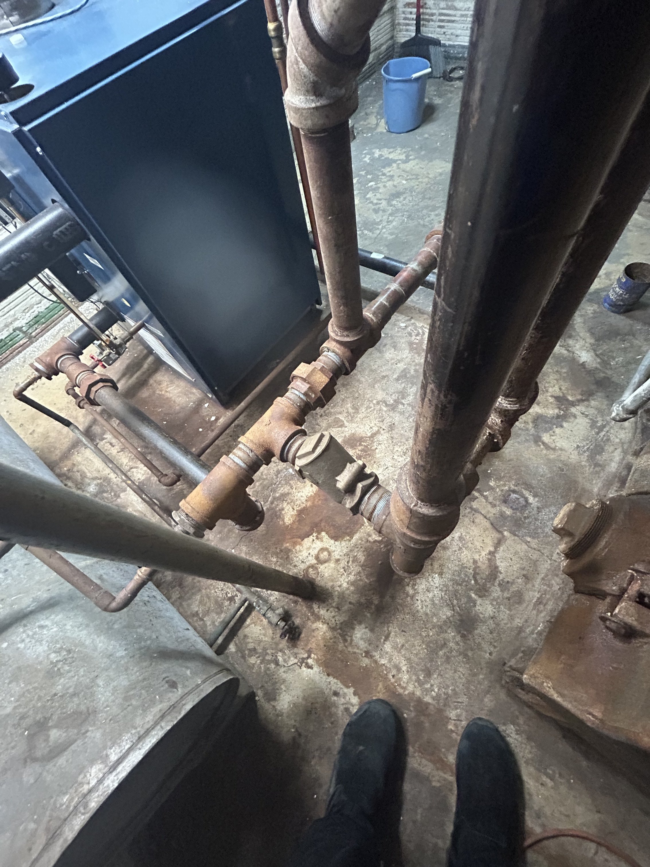

    Unfortunately the installer did not pipe it right. Don't know why they can't read the manual.
    You have the two boiler supplies opposing each other with the building supplies in between. Since the header is large it may or may not work ok.
    No Hartford loop but it may not be needed if that boiler feed tank is in use. Is that tank in use?
    What is the 3/4" copper coming off the top of the tank? That doesn't look right. There may be other issues not seen.

    I have one suggestion for you. Pay Gerry Gill (for his time at the home, his travel to and fro and his gas and tolls.) to come out for a consultation and report and you can have your regular plumber follow up on his recommendations and actual work. You will know exactly what needs to be done and he will save you precious time and money. You cannot find a more capable heating expert. Good luck and keep us apprised. Mad Dog

    Thanks for the responses. I have recently offered those things to Gerry and am hoping that he will respond. I am a retired Electrician and Electrical Contractor in Youngstown Ohio. I have not been able to find a plumber - heating contractor in this area familiar with vapor systems. Currently I am as mentioned reading all i can about the system I.E. Gerry, Dan H, Steamhead, Etc. The system is operating but I know not to its potential and is using a lot of gas. Just trying to help my son and his family. As far as the tank being operational it would be a guess. There are three mains and returns. One with a Hoffman 75, the other two have a Trane on them that I have posted on this site for identification help. I guess my main question is am I correct about the pressure it should be running at and the capacity of the main vents. Thanks again for the help.

    Your biggest thing is going to be the vapourstat. In series with the pressuretrol, which becomes a safety. Set the vapourstat at 7 OUNCES ctout, 4 ounce differential.

    IS YOUR FLUE PIPING HEADING DOWN INTO THE CHIMNEY???

    Yes it actually is. There is a set of stairs between the boiler and the chimney. There is a flue blower installed and I have checked to make sure there is no carbon monoxide issues. It’s very hard to see in the picture because it’s on the back side on this view.

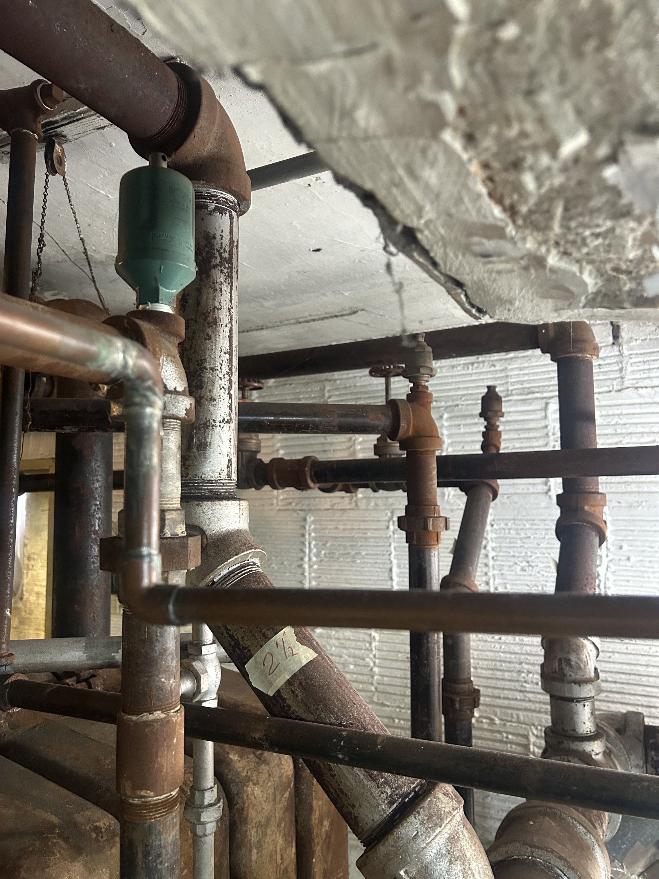

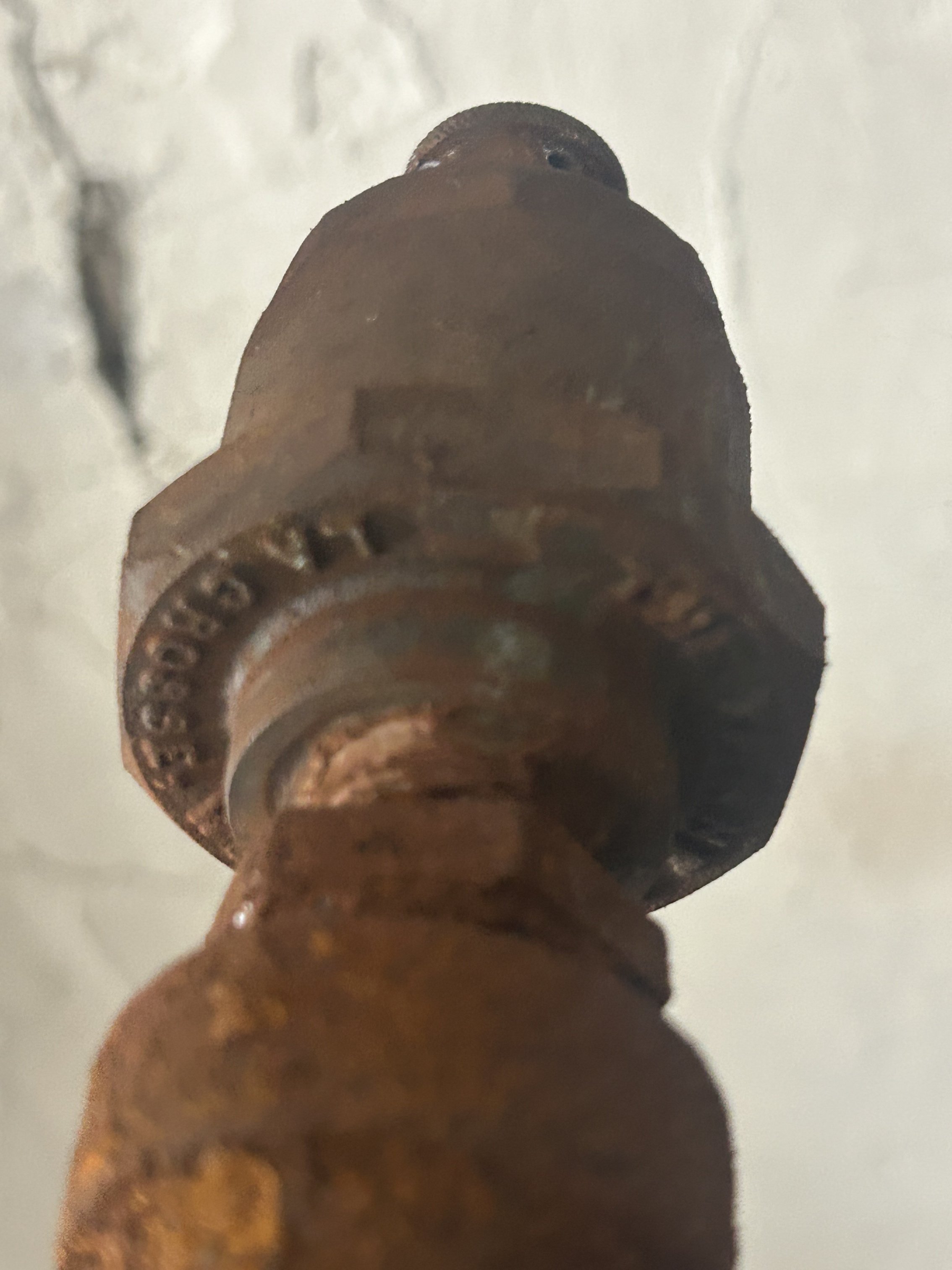

    The venting on this is too small. Get a Gorton #2 to replace each of the existing vents.

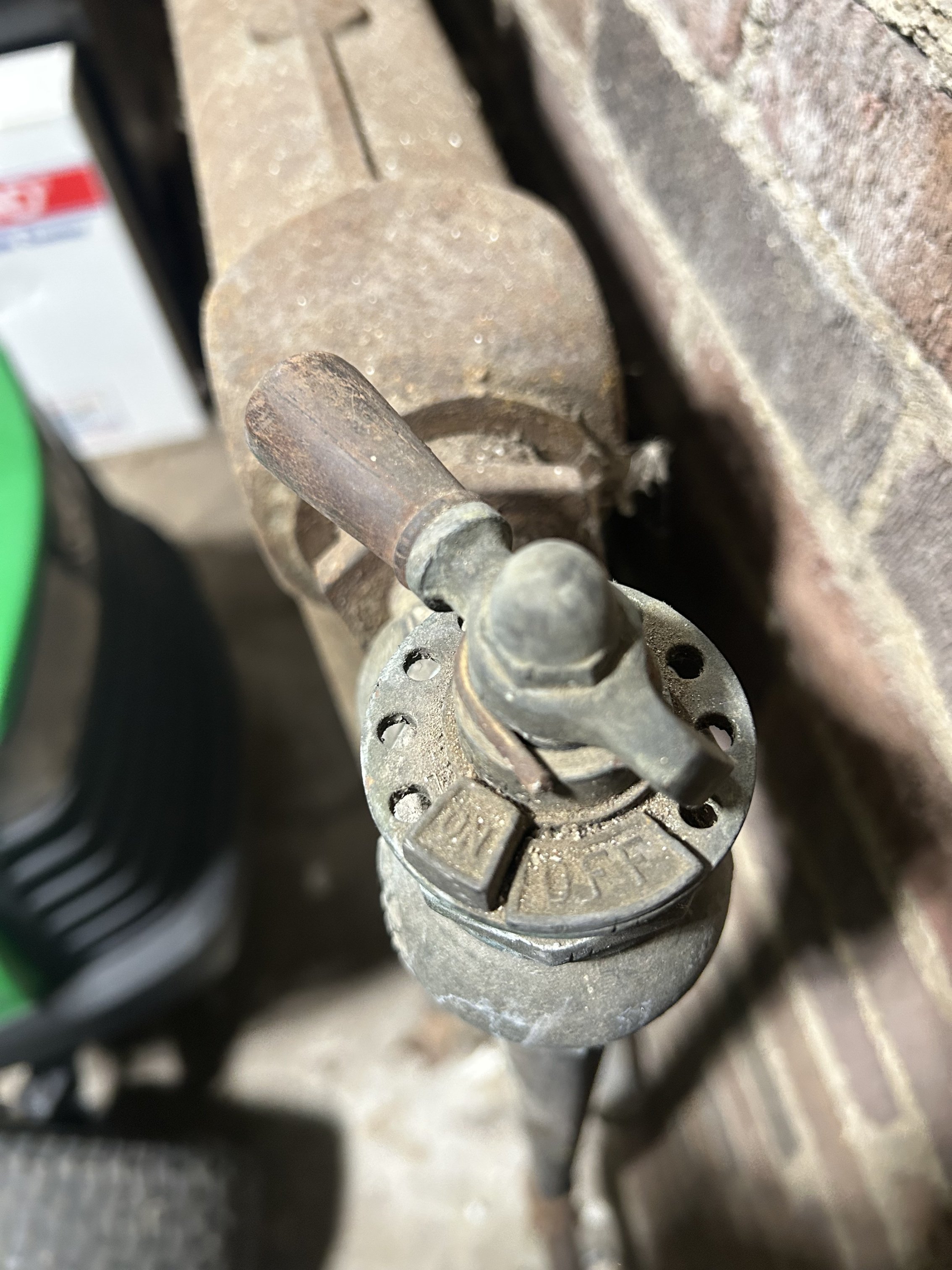

    do the other radiator valve have the pin in them? those holes are for a pin that sets how far you can open the valve to match the edr of the radiator. if they are all missing the pin, getting that set right is one of the first steps along with figuring out if you're building pressure and limiting it with a vaporstat if you are.
    new and large vents is probably a good step too. if the air can't get out you're going to burn a lot of fuel trying to compress it.

    The boiler is only five years old so it’s going to have to stay for now. I’m at a loss of understanding how a system can work without venting. As far as pins in the valves on the radiators I will have to check them when I go back there tomorrow. Thanks again for all of the help and input. I will post my progress.

    It can't, or at best will work poorly. There must be venting somewhere in your system? In a vapour system the most likely location is main vents at the point where the dry returns join and drop to the boiler. If the mains are vented by crossover traps to the corresponding dry returns, that's all you need.
    it is really hard to tell in that system what is connected and what is abandoned.
  • dcw1
    dcw1 Posts: 22
    Thanks for your comment mattmia. The old boiler and controls are all abandoned in place other than some of the large gate valves. Nothing runs through the abandoned boiler. The gate valve piping has been modified to remove the old boiler from the system. Thanks for your help.

    Mouat systems were high end and installed in larger homes in NE Ohio. My house is 3500sqft. I have a big boiler that barely burns 50% of the time to heat at -20F. I still can run it with no pressure ever and I don't think size means much as long as long as the boiler is big enough. Actually I think all the advantage goes to the bigger boiler with the right control.
    So I expect your new one is big enough. Give us the radiator count and EDR figure. Does it heat everything Ok?
    Looking at the Mouat sales literature it looks like that old boiler is in fact the original to the system. Quite a rare prize to have. I've attached the literature here if you don't have it.

    The original design had installed significant extra radiation beyond what was actually needed on purpose. It had lots of extra boiler too. That big old boiler you have still has the low pressure control on top which modulated the damper on the coal fire matching the steam production to the current demand in real time. The boiler never ran on "high" or "off" and the radiation was never close to full. Nothing about the size of the boiler was "critical". The steam production was continuously varying with the demand, all at ultra low ounces of pressure.
    What is important to note about the original design:
    1. Lots of extra installed radiation continuously partly filled never full.
    2. A big boiler intended to run in the middle of its range - there was no "high" speed and no "off" speed
    3. 3 ounces of pressure maximum was all that was required to deliver the steam in all states of demand(so why today do we need pressuretrols and vaporstats for this system????)

    Hello all, I have purchased a Honeywell Vaporstat, 0-18 oz. Pressure gauge and additional pigtail for the system. Does this sketch look the the correct way to install ? Thanks as always !! Bottom picture is current setup.

    that can work, may need to move that wire bracket,
    while you're piping, disassemble the upper sightglass valve and make sure it's open and clear all the way back into the boiler, the glass protection rods work well, drain down and do the bottom valve also,
    water looks slimey, oiley in the glass, do you have a way to skim?

    i'd throw a couple unions in there so you don't have to disconnect stuff to take it apart.
    you can also make the water seal out of tees and ells and plugs such that you can flush it out by just removing the plugs.

    Thanks for the replies. Great idea on the unions. I did have the boiler serviced just a few weeks ago and the plumber added Hercules cleaner to the system. I will blow out and skim again while making the changes. Thanks again.

    Should all the new fittings be brass ?
    or large black iron but small brass fittings are better because they won't corrode. the large black iron would not be likely to clog.

    I would suggest you add a pig tail to the vaporstat, same as you have for the pressuretrol.
    As drawn, the vaporstat doesn't have the water seal the pigtail provides to the pressuretrol.
    You could rearrange the piping so the one pigtail provides the water seal to both the vaporstat and pressuretrol.
    it does but we are looking at it head on in the drawing, it is called out but hard to see.

    Steamhead Posts: 19,007
    @Pumpguy said "You could rearrange the piping so the one pigtail provides the water seal to both the vaporstat and pressuretrol."
    I would not do this. If the single pigtail got plugged, it would block pressure to both controls. With two pigtails they both have to plug up for that same result.

    Maybe my last comment was confusing. If you look closely at my sketch and picture I am using two pigtails. The existing pigtail for the old pressuretrol and a new additional one for the vaporstat and low pressure gauge.
